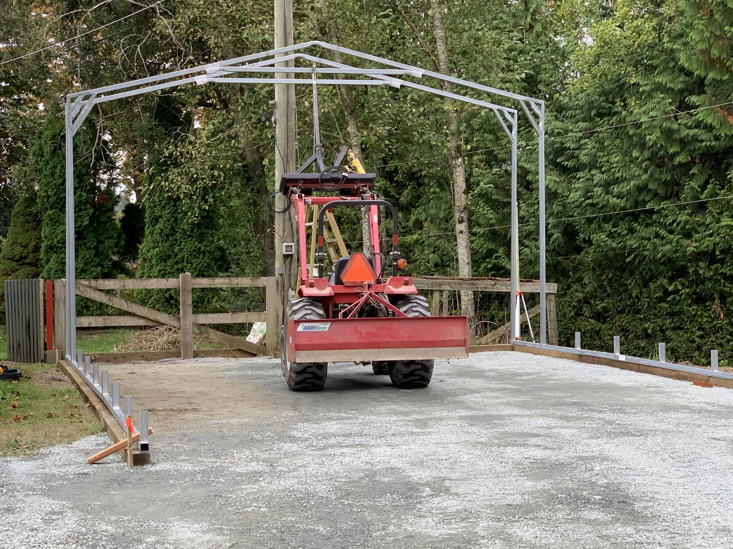

Do it. I did it with my little CK20 back in the day. Trusses for my 20x34 carport were all put in place using it. And I was working by myself... CK20 is rated at 1100lbs at the pins so really no different. only thing is make sure you've got a counter-weight on the back depending how heavy your machine is.

I've seen trusses delivered both ways around here. Set on the ground - set on the building. I have seldom used the Kubota M6040 to lift/set anything - up high. Anytime I start a project that requires lifting something up high - I worry about things. Like adequate counter weight on the 3-point - how level is the ground where I will be lifting - how soft is the ground where I will be lifting.
However you do it - be very careful.

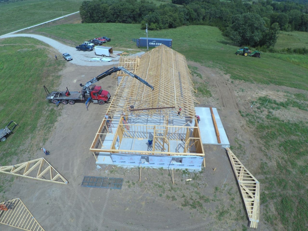

There's a local guy here that has a truck mounted crane with various attachments such as grapple/chainsaw. He trims trees primarily. But also has a jib to put on the crane for truss setting. He's called on the larger structures that the telehandlers can't reach.

Here's a pic of Cully's truck at work. You can see where the truss company unloaded the trusses. Locations determined by the builder.

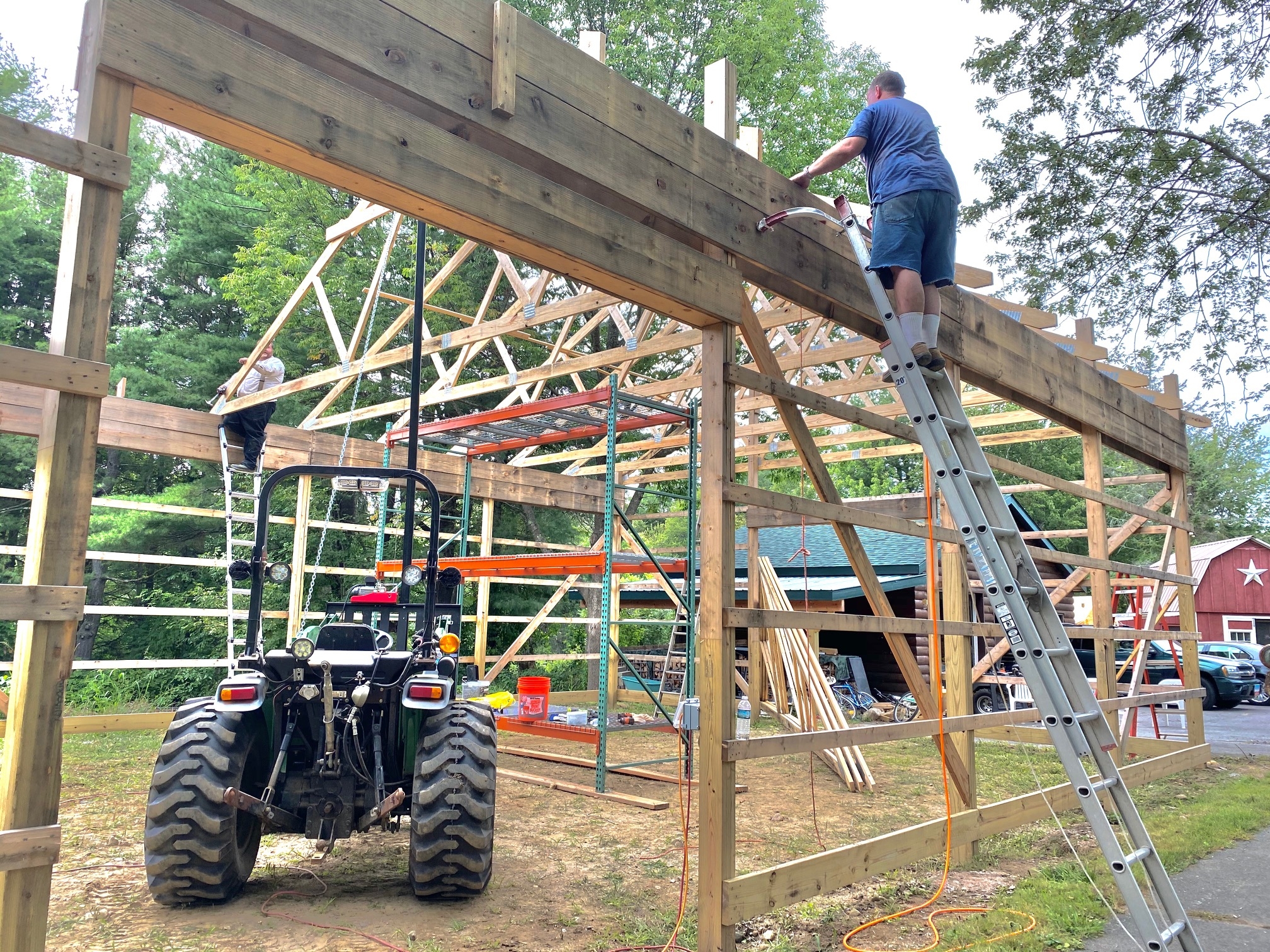

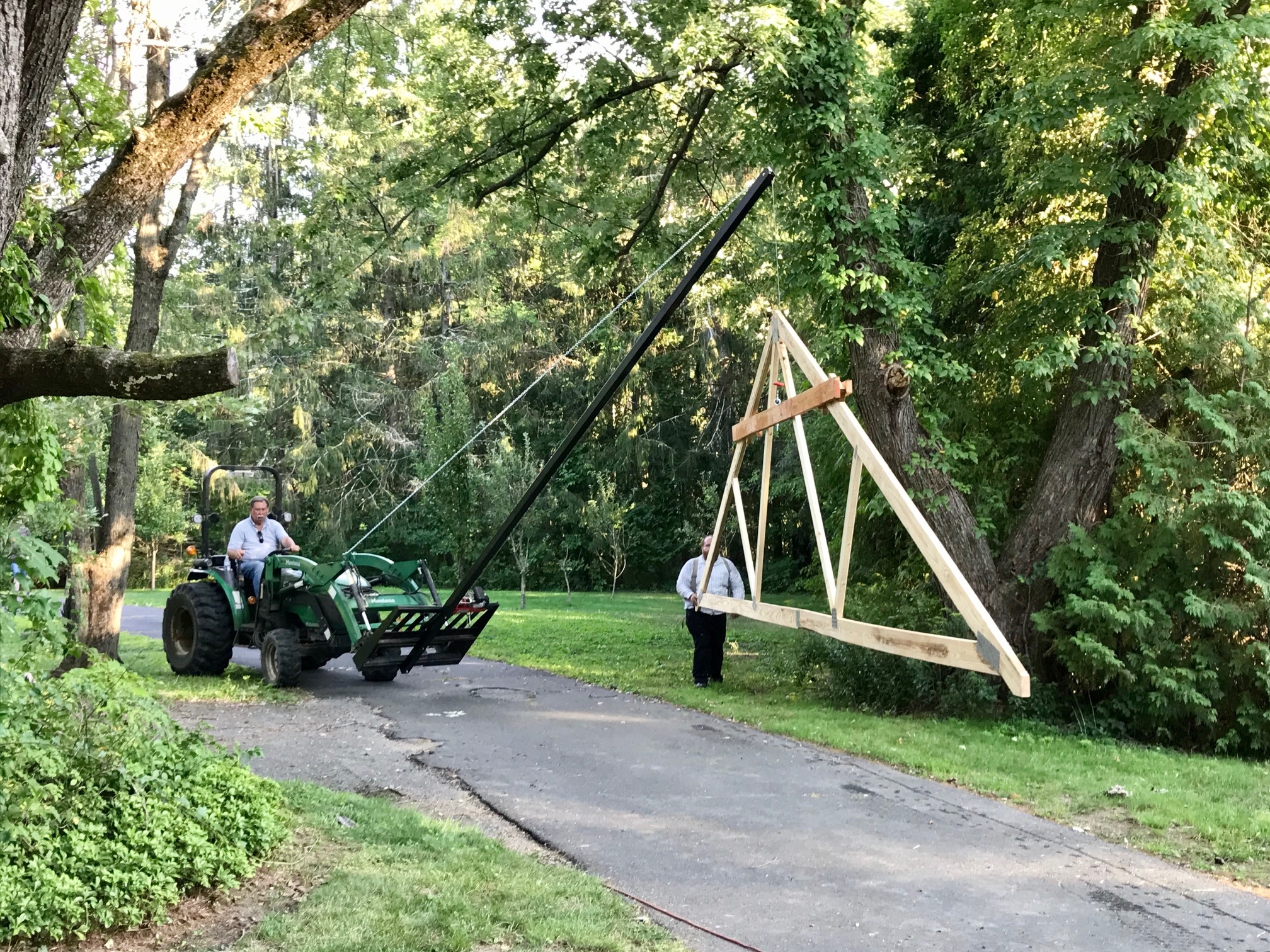

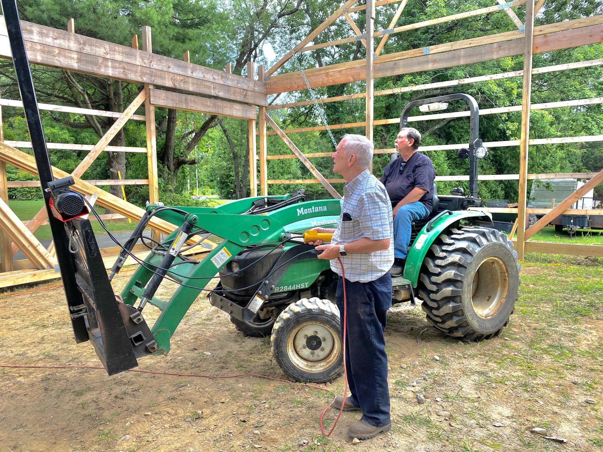

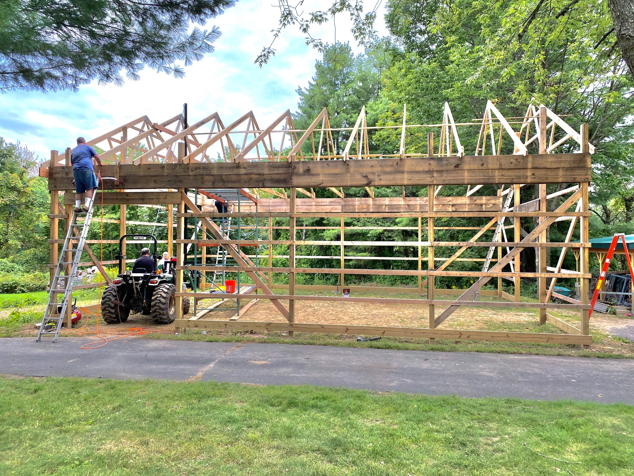

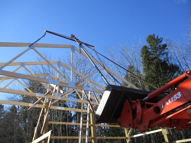

That was my other thought. I have a winch on the tractor and could easily put a pulley on top of the vertical pole. Right down the road they sell old telephone poles that could possibly work well.
I was also recalculating - I only need it 10' long instead of 14 since the FEL can lift to almost 8'. Perhaps 2 boards screwed together at 10' long would get me there. I think I have a 50#bag of feed - maybe I'll put that on the end just to test.
That is how we did it on my shop, mounted a HF winch at the top of a couple 14' ? 2x6's screwed and bolted together.
Stabilized it (triangulated) with tie downs to the sides of the bucket. Walls are 14', trusses were 30 feet long.
4/12 pitch (Similar to Farmer 495) I did make top and bottom brackets to attach the 2 by's to the Ford's bucket. It actually worked pretty well.

Should be a piece of cake. I set my ShelterLogic trusses this way with the vertical posts attached so they were heavier than yours and I have about a 1000 lb lift capacity. I have a 3 point attachment on my loader so I can use my boom pole.

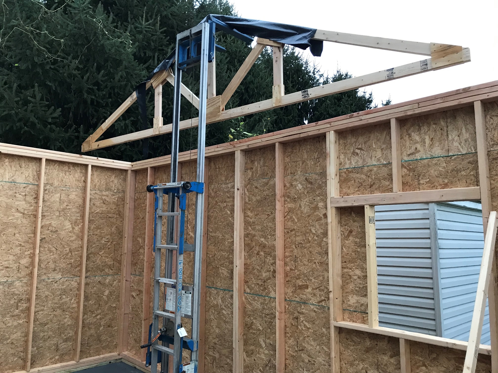

Pretty neat process you all have come up with.
For these smaller operations, without a bunch of people walking the roof, how do you unhook the truss from the boom you have up in the air with the tractor in use? Like in the picture directly above?
/ Lifting truss with FEL #38
I used a tow truck "J Hook", kinda like this:
You need to spread the lifting points as wide as possible, so maybe with longer chains if it's a real wide truss. Didn't have to climb up to un-hook anything.

My friend Cully, who's truck I pictured above, is very good with controlling his boom. If he has a single lift point on a truss he uses a chain with a slip hook. He holds the truss until the workers have it stabilized. Then he slackens the chain and jiggles the boom to get it unhooked. Swings back to the pile and hooks the next one. Is then waiting for the workers to signal him that they are ready. Goes amazingly fast. Cully carries a joystick box on a sling around his neck. He can hook them and hang them by himself.
If it's larger trusses he uses a boom with chains on each end. His truck boom is then chained to the middle of that boom.
