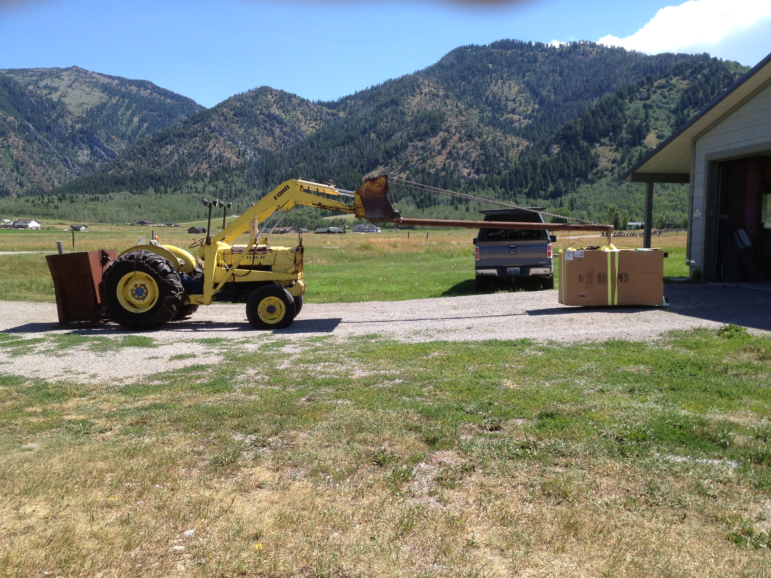

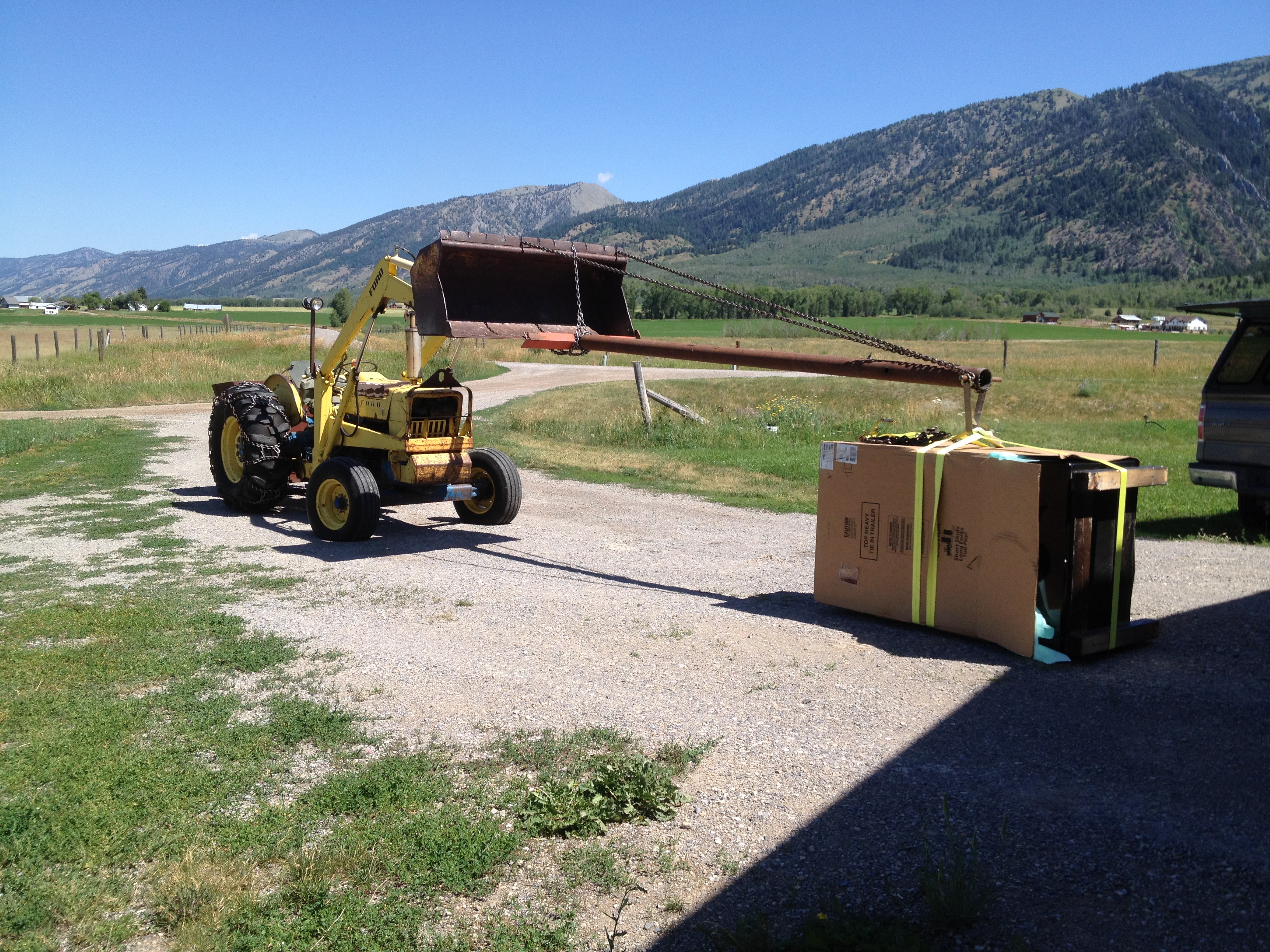

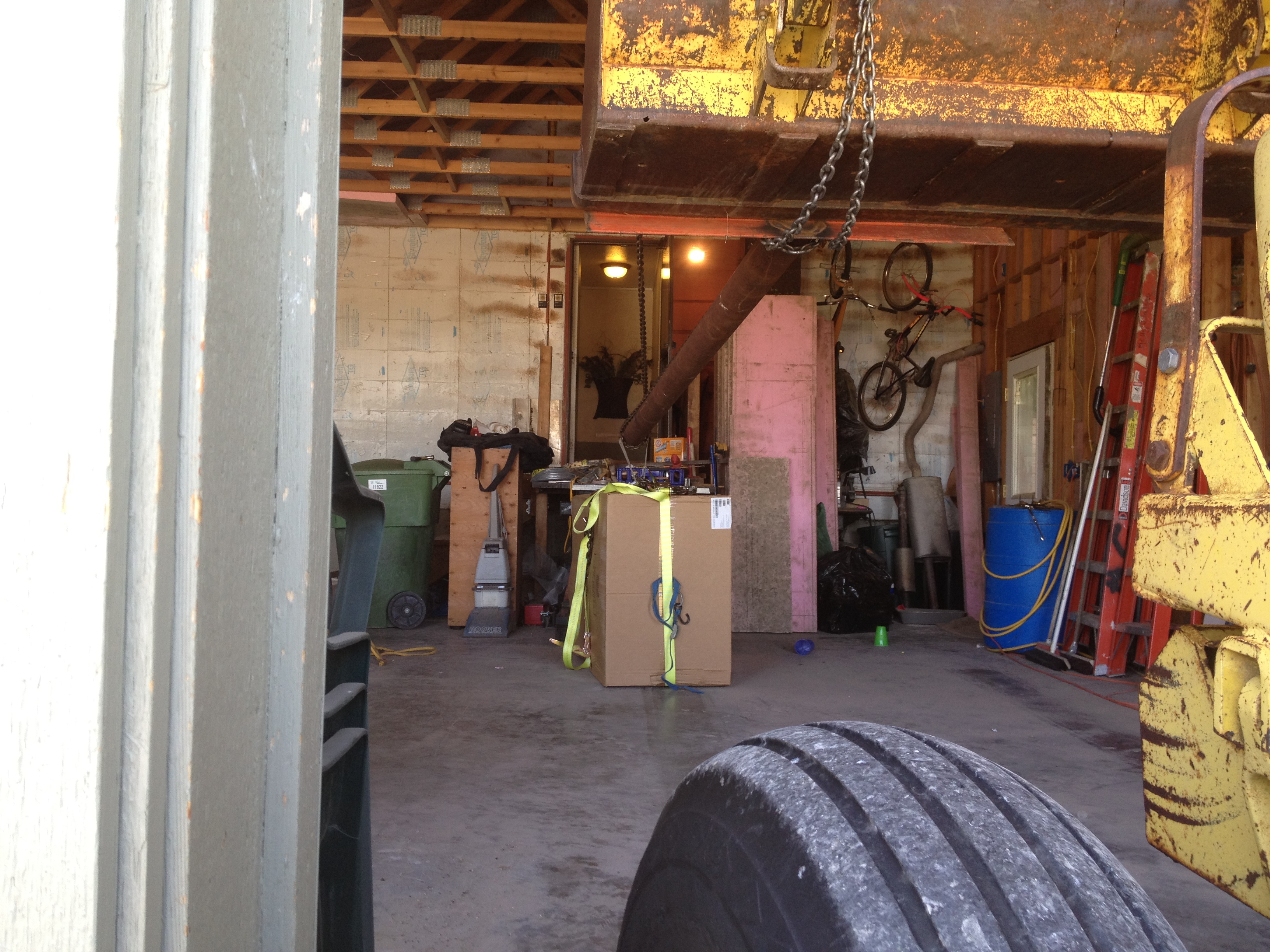

Here is how I added a boom to a previous tractor I owned. The boom is about 10 ft. long. I needed to stick a safe through the door between my garage and house and I didn't have any help. I just set the safe on the landing at the top of the stairs then used the ATV winch to lower it down the steps. Once it was at the bottom I just tipped it up on a set of rollers and moved it where it needed to be. A few years later I sold that property so I removed the safe using the reverse process. As I remember the safe weighed about 600 pounds.

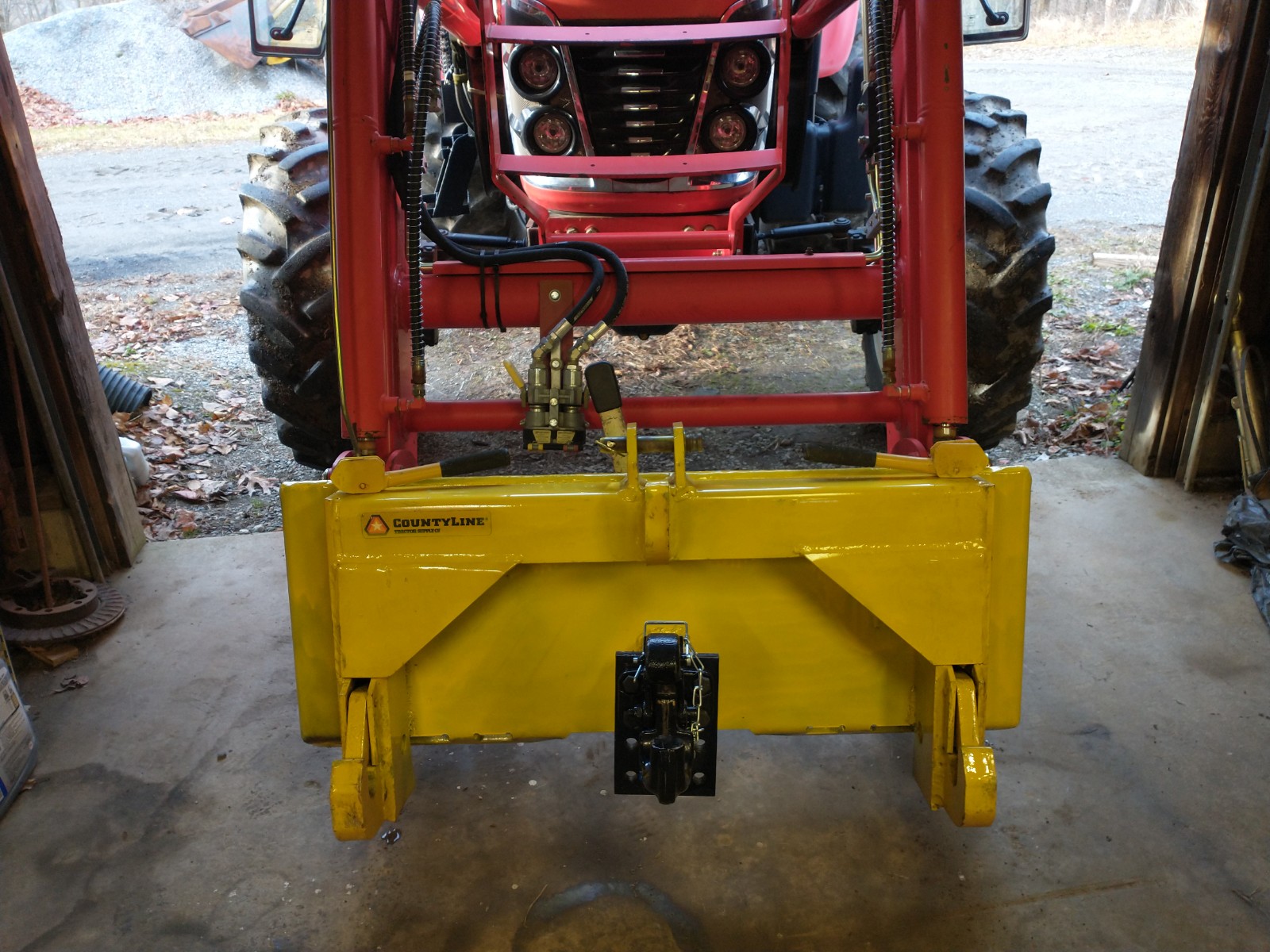

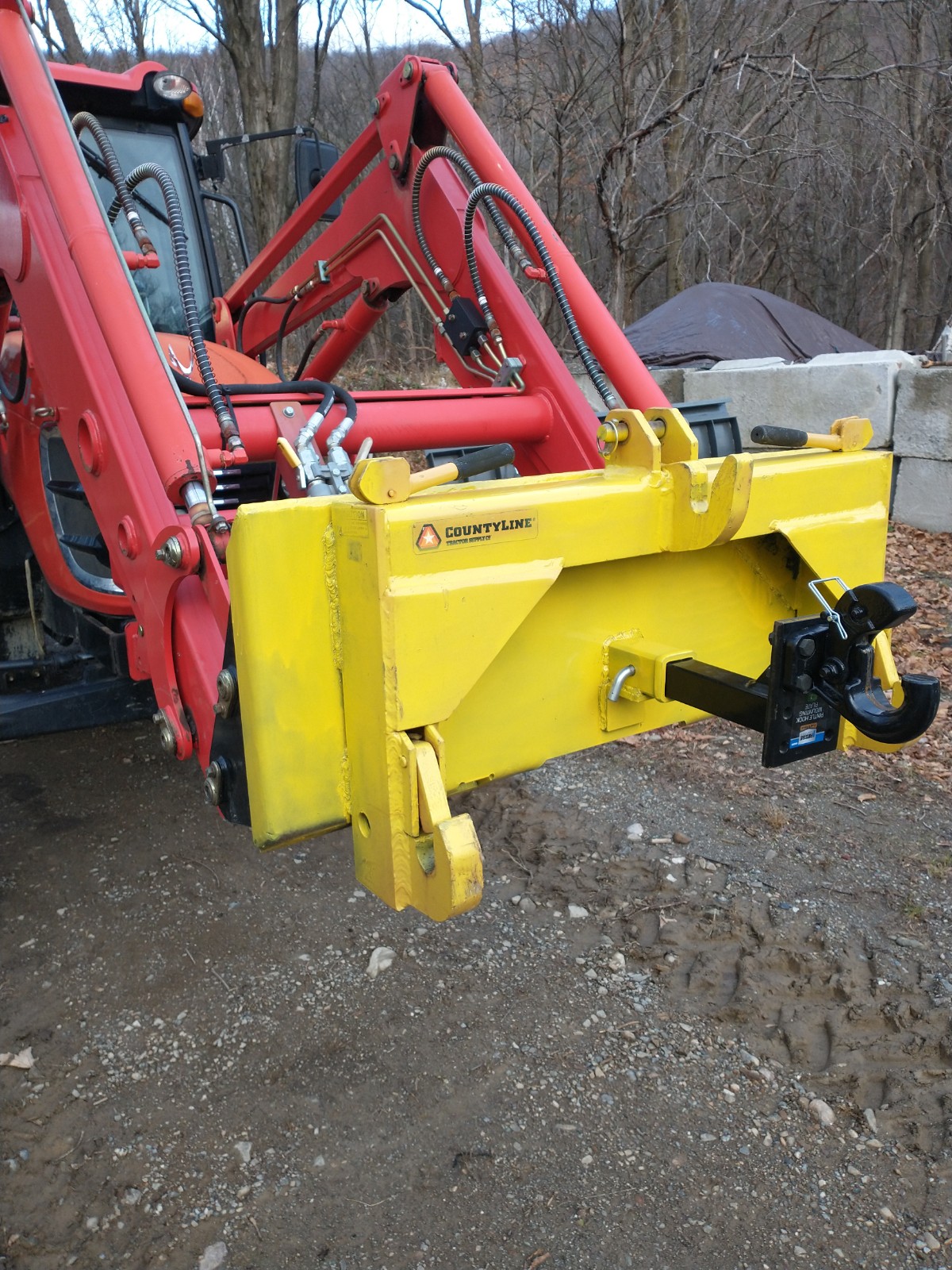

I would just use my ssqa to 3pt adapter and hook the boom pole to it. I can also use it to move any 3pt attachment and use the rear blade on the front if I want. It also works great to lift the rotary cutter up so I can work under it while I stand.blade on front 003_1.JPG

I would just use my ssqa to 3pt adapter and hook the boom pole to it. I can also use it to move any 3pt attachment and use the rear blade on the front if I want. It also works great to lift the rotary cutter up so I can work under it while I stand.View attachment 684026

I just swing the safety support brace into place at full height. Why not work on the underside while I stand?

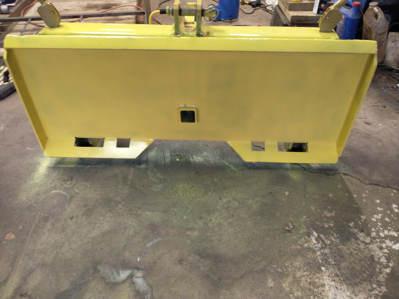

I have a SSQA plate with only a 2" receiver on it. I guess I could just slide in a length of square tubing for a boom. Having bought a 3PH boom pole some years ago I've never used it.
Remembered that I have a length of 2" 1/8 wall square tube leftover from my log arch build. I could weld a receiver to the top of my bucket. That might be easiest of all.

I would not recommend that there is not that much strength in that square tube,
make a mounting plate for the bottom of the bucket for the tubing with a pair of chains to the upper
corners of the bucket that way the chains carry the bulk of the load.
   / Need ideas for adapting boom pole to FEL/pallet forks #35
Add chains to any version for strength.
Either way it converts to shear/flex load to tension load on the chains and compression load on the tube.
Use what you have. :)

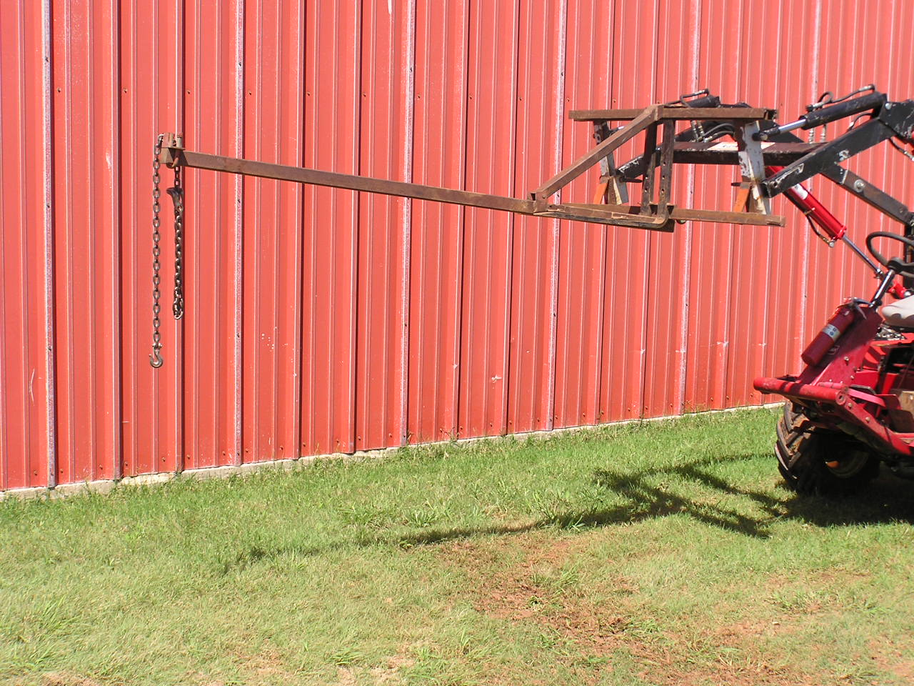

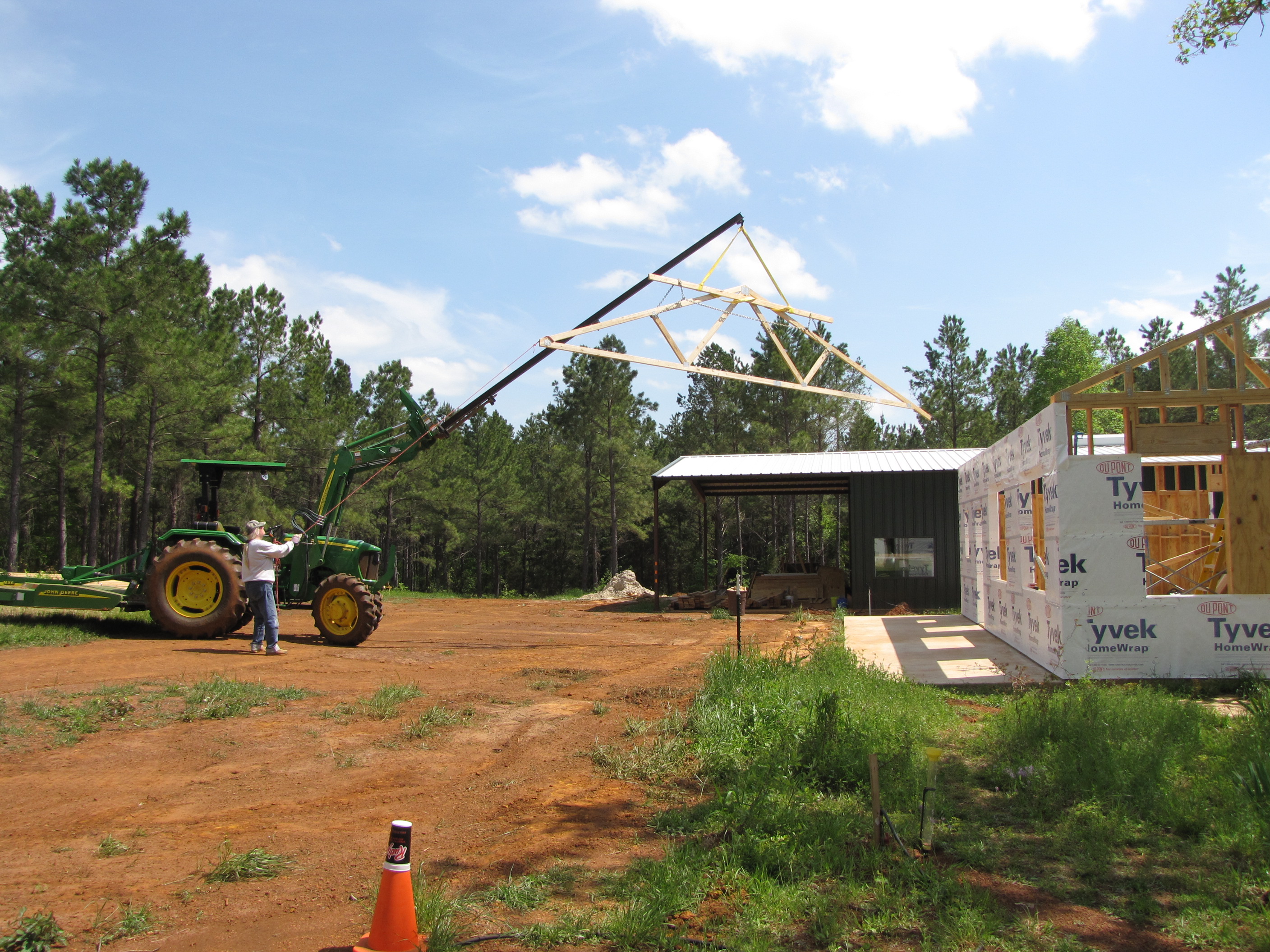

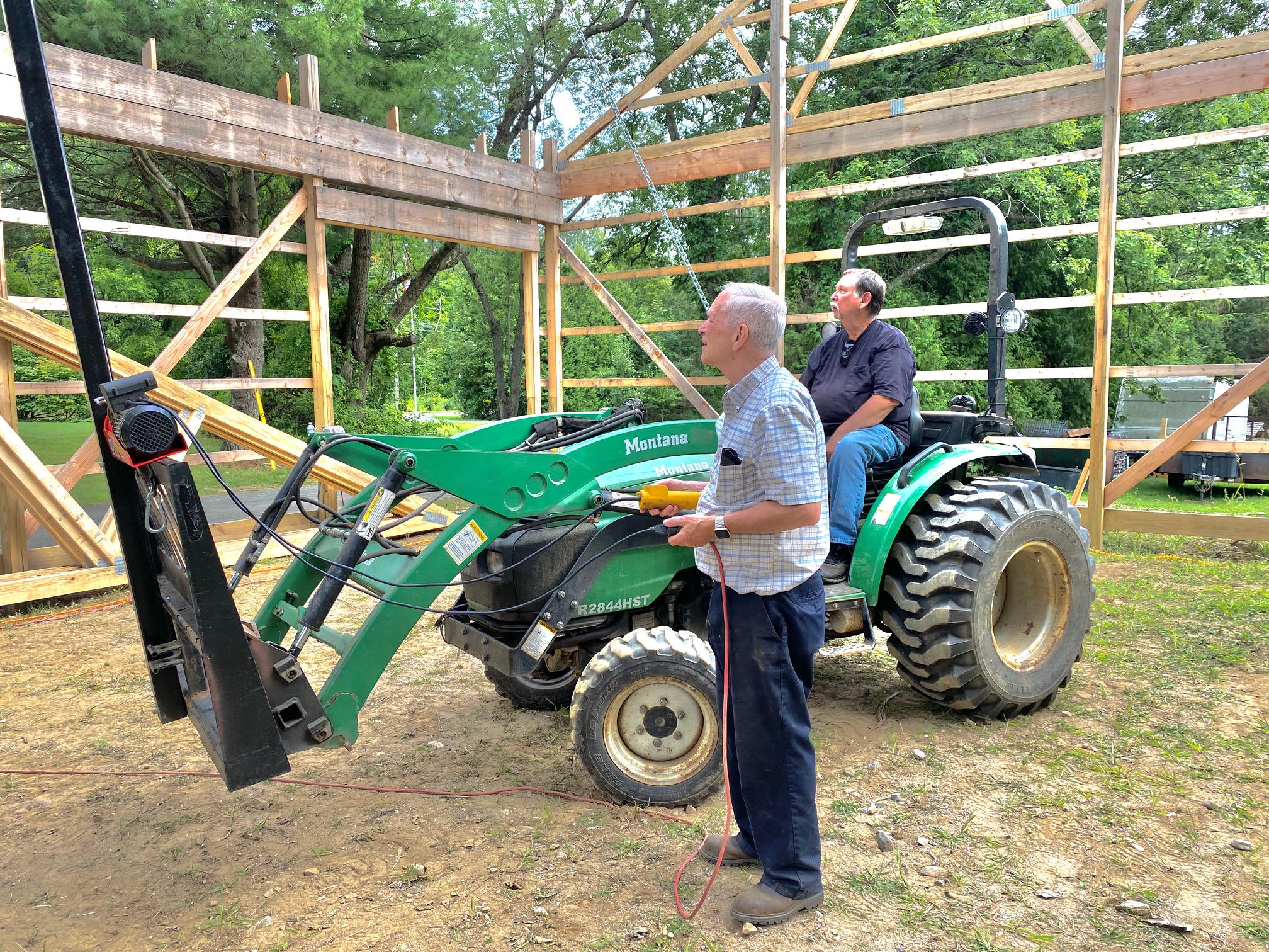

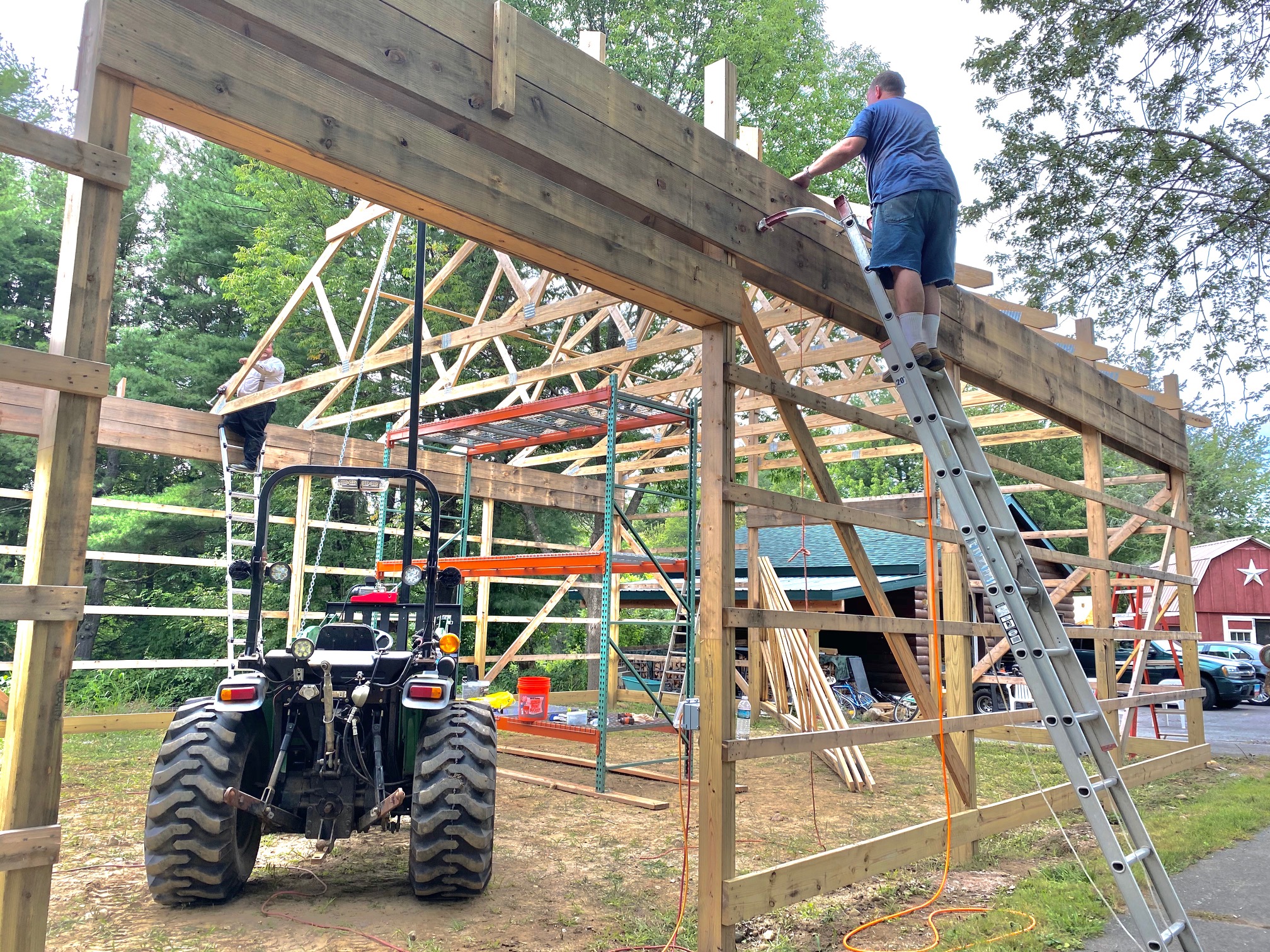

Here is away you can use the pole you have. I well try and make this as short as I can with pictures.
!st you have to have a hookup on the loader top as in pictures 1 & 2. Note one is welded on and the other one is bolt on, and the bottom part of it butts up under the lip. The part on the bucket has to be higher and a little fwd then what even size brace you use from bucket to pole.
#3,4, and 5 Weld a 3/8" or 1/2" X 2" on a peace of angle iron that well over laps the cutting edge of the bucket.
Then drill a 1/2" hole in the flat stock and bucket as far back as you can on the flat stock. I use a wing nut to hold it from coming out.
#6 and 7 is a weld on cat 1 ball assy. Part # on it was 011915 and I think I got from Agri supply. They have to be spaced so you can put one side in and just to be able to get the other side in. You can put spacers on the out side if you want to keep it from moving sideways before you pin it. You can also use a short pin on one side and a long one on the other side, that would give you more between the ball lower link assy.
NOTE. DO NOT USE A CHAIN FROM TOP OF BUCKET TO POLE.....YOU WELL GET BOUNCING AND CHAIN COULD COME UNHOOKED.
You end up with a angle iron and one bolt to put on before the pole. real easy and have done this way for 40 years. Different steel size for loads

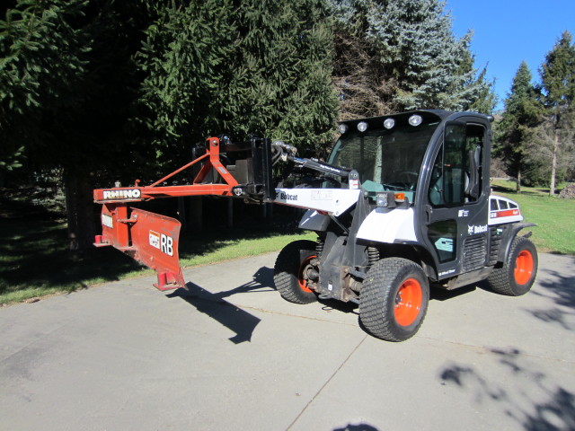

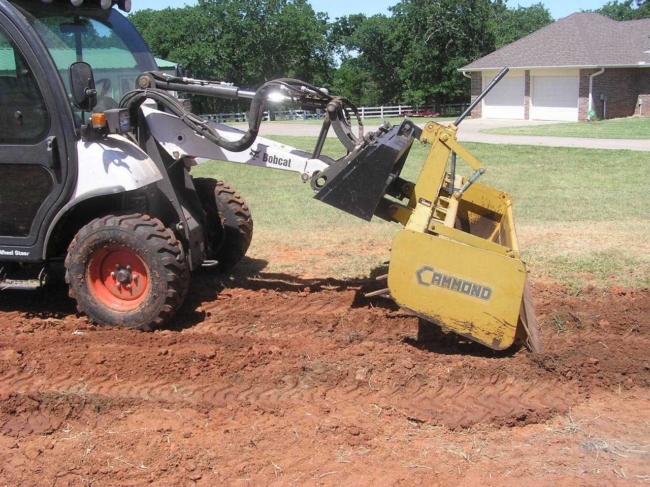

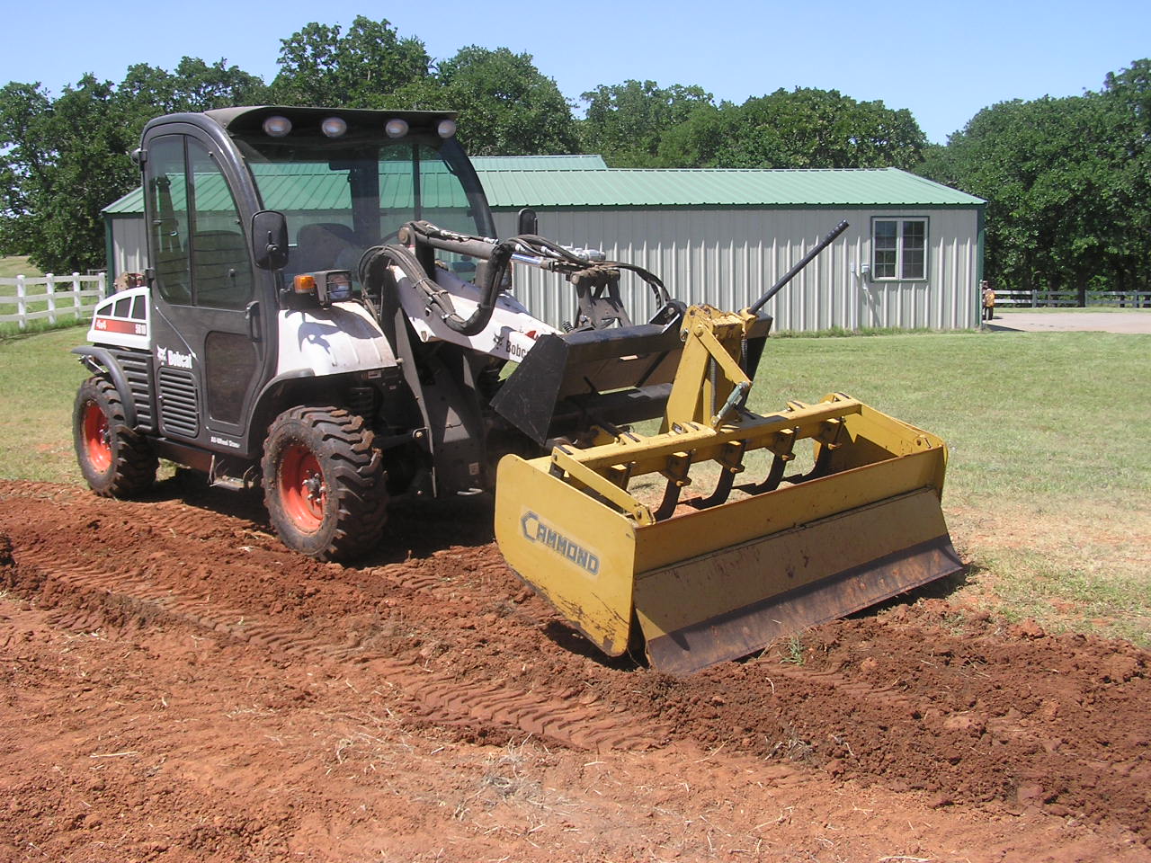

This gets my vote because you can use other 3 point implements on it. Would be very handy with a landscape rake.
I have one with extra rollback built in, that gets a lot of use:
View attachment 683866 View attachment 683867
The Toolcat must have a lot of lead in it's butt to handle that much load extended out the front. (with no added counterweight)
