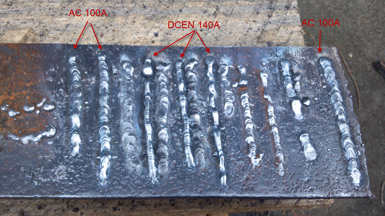

So Josh, now that you are welding some with a functioning DC welder, do you notice what we are all talking about with how much better DC welds than AC?
It's hard to say, Dex. I think so, yes, but at this point my skill level is low enough that all my welds look pretty bad, AC or DC. If the DC ones look marginally better, I can hardly see the difference! I will say that the arc is much easier to start with DC--not that it's hard with AC, mind you--and I do think I notice that the arc is "calmer" on DC, with a lot less spatter.
/ Thoughts on this used welder? #242
When you get a little farther along you will find you can run dc with a little more control than AC. From the looks of your welds they seem to be improving. It look to me like you need to push your welding rod into the puddle a bit more. I would also stick with a specific rod for a while to get the feel for hoe it welds. The easiest rod to weld with is a 7014 and it has to be run hotter than say a 6011. Get a rod amp chart and start with the recomended settings and adjust from there. Every welder is a little different so dont expect the settings to be the exact same. Watch the puddle and keep the arc length short, be consistant and keep at it.

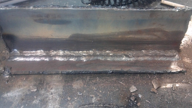

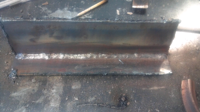

I went to an informal workshop put on by some local welders today. I think I really made some progress. There really is no substitute for seeing someone do it in person. Two tips that I took away were how to steady myself against the table, and to switch to 7018 rod. I had been avoiding 7018 because I don't have a rod oven, but even 7018 that hasn't been in an oven runs a million times better than 6011. With 6011, the bead is so terrible that I can't really see what I'm doing right or wrong. With 7018, the rod is working with me, not against me, and I can more easily see my progress.
Here are the first two passes of a T joint I did.

HA! Real welds! Ain't it grand to make a weld like that and look at it and say "wow that is more of what I had in mind".. Yes you gotta get set up with the TIG. Argon cylinder, 17V torch, and regulator.. I can help if you get stuck finding the stuff. Torch about $75, regulator about 25, Cylinder you are on your own, I bought mine a 125 cu.ft. for $210, (full) but the prices and rules vary so much per region. some places you cannot even buy one that big, you have to rent. It is cool once you kinda get on to it. You are really coming along, and it has been enjoyable watching your progress.
