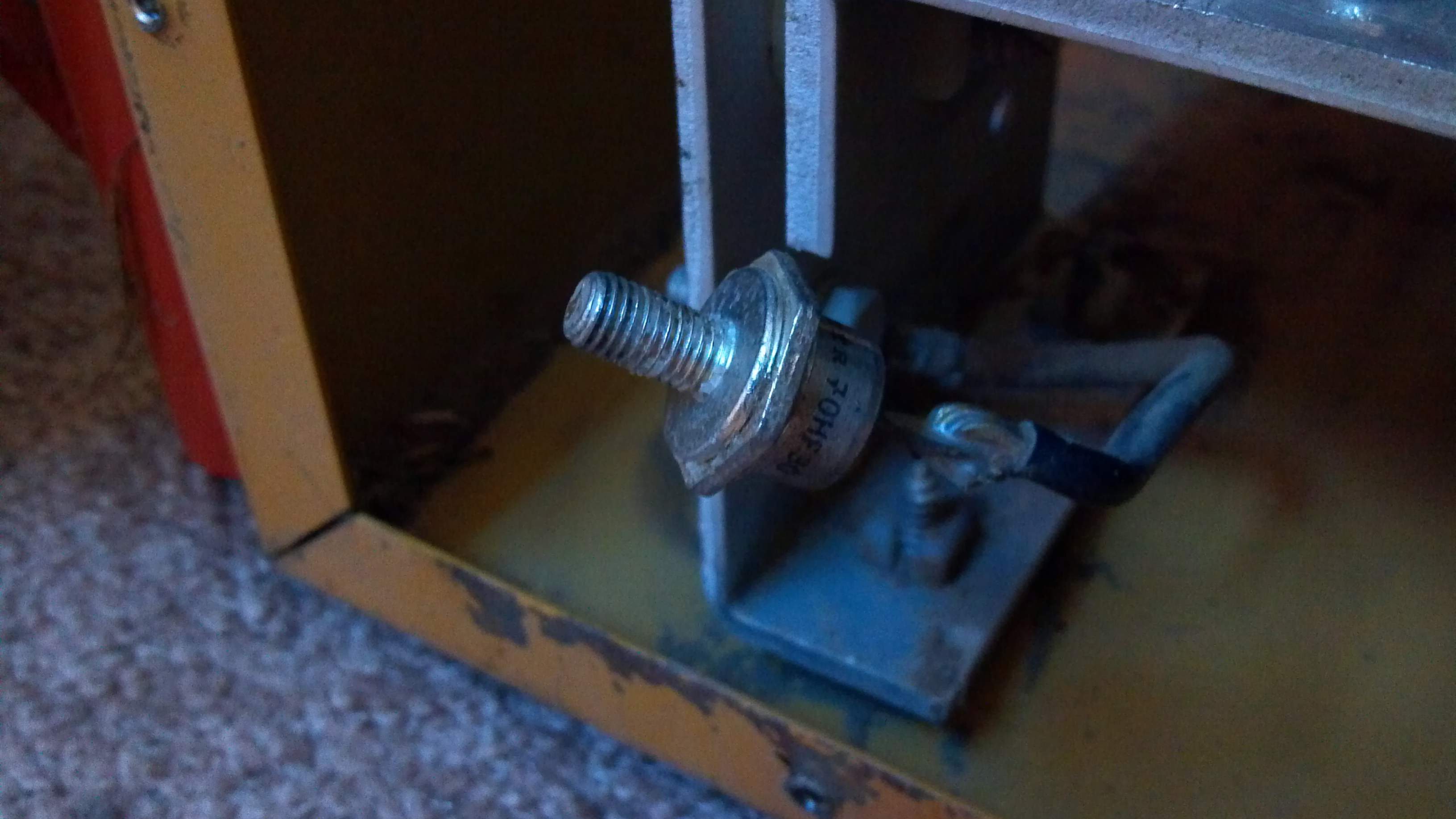

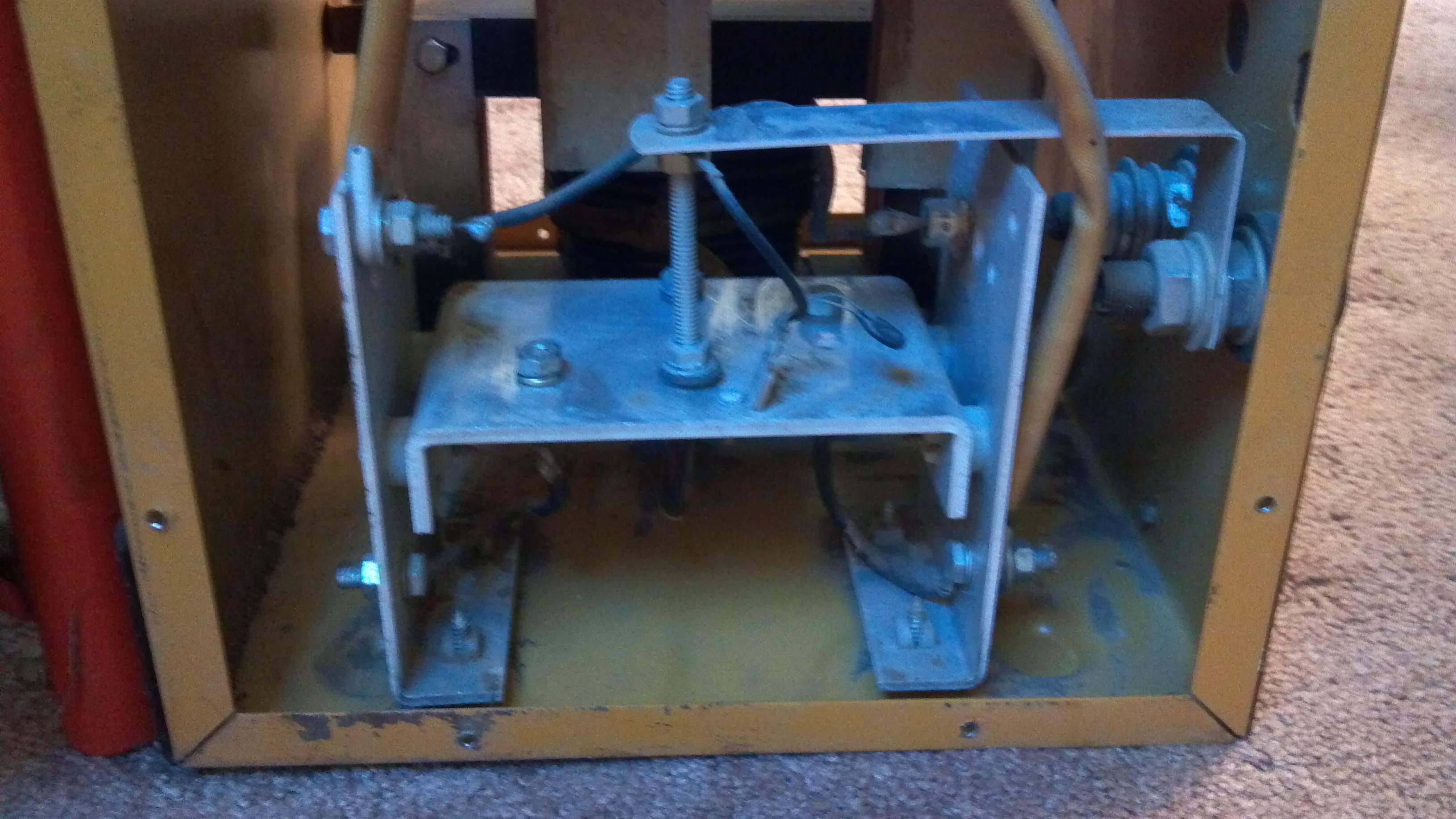

I went ahead and ordered the diodes just now. The originals were 70 amps and 300 volts. The closest match I could find was 70 amps and 600 volts, but in the interest of beefiness, I ordered a set of 85 amp / 600 volt diodes. It was a difference of $3 each. My Internet research suggests that the higher amp rating will make them more forgiving of heat and will increase their duty cycle (if not the duty cycle of the other welder components). The higher voltage will make them more resistant to damage from voltage spikes. I also got some thermal paste, which is supposed to significantly improve their ability to transfer heat to the aluminum heat sinks. With any luck, I'll be DC welding before too long!
/ Thoughts on this used welder? #212
I agree with your substitutions and reasoning. I hope you are welding DC soon too!

The diodes came today and I just got finished installing them. My little 30 watt soldering iron couldn't even begin to make a dent on those thick wires. I have a small butane torch that came with a soldering tip, so I tried that and it was even worse. I ended up basically brazing the connections with the torch's open flame instead of soldering them. I tried to be very careful not to overheat the diodes. On the last one, I must have been directing the heat somewhere other than where I thought I was, because the solder kept on not fluxing, and then all of the sudden I noticed that the body of the diode had taken on a slight brass color, instead of the gray steel that the others had. Oops! I quit heating it immediately and once it cooled down, it measured the same on the multimeter as the others. The rod will tell the tale! I'm about to go clean off a piece of scrap and run a bead.
/ Thoughts on this used welder? #215
Well let us know how you like DC welding. You will be surprised.
