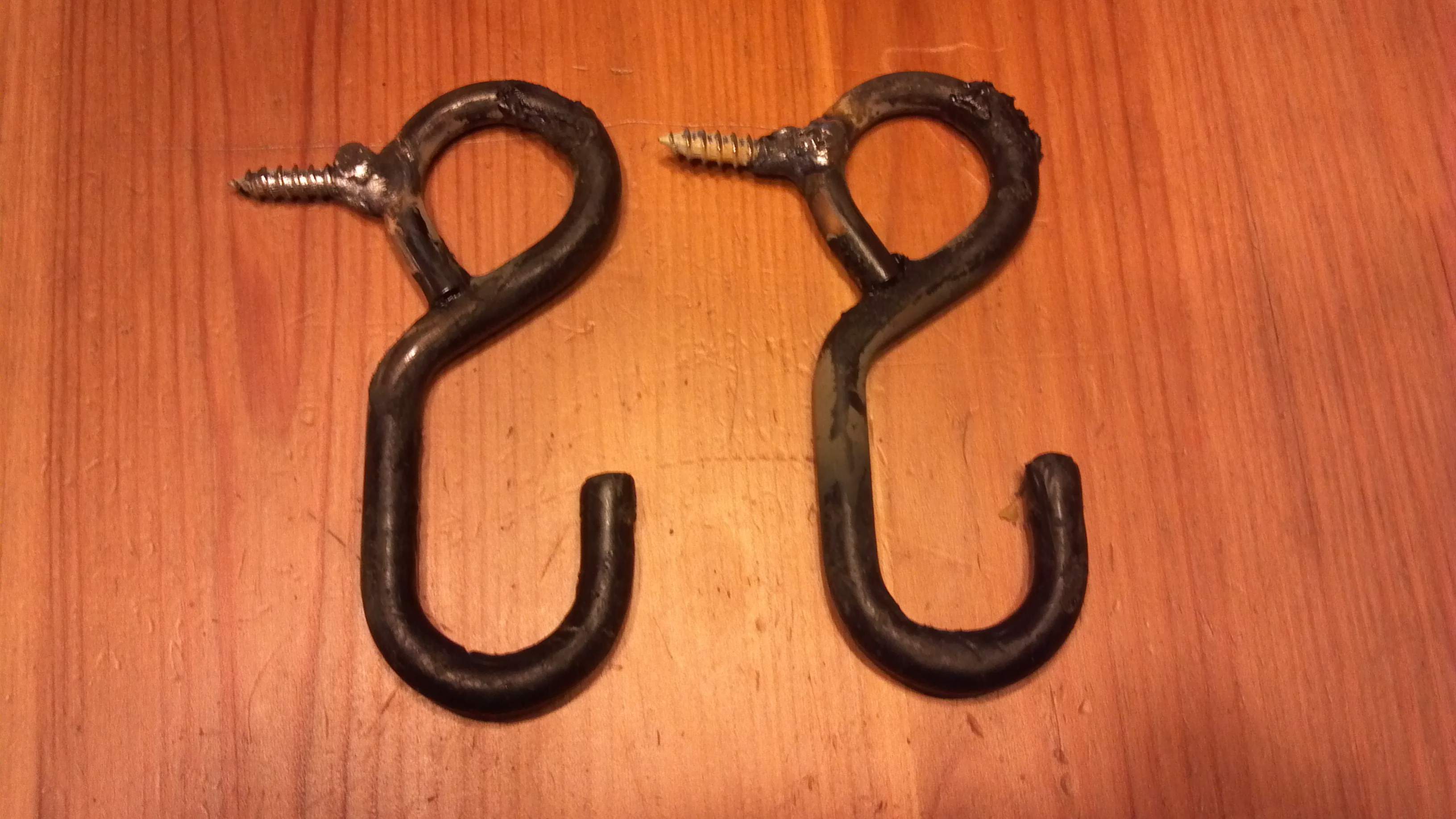

I had some hooks from some ratchet straps that had to be retired, so I put some screw threads on them so they could screw into the wall and hang tools from and such.
Don't bother critiquing the welds. They are total crap and I know it. But I twisted and pulled on them and they didn't wiggle, so I think they'll do.
BTW: AC 1/8" E6011 at about 120-130 amps.
Hey it is a start, and you made something useful.. you should be proud... heck I am.:thumbsup:

I think I would have done better with a smaller-diameter rod and if I had removed all of the plastic from the hooks, instead of just the plastic where I was going to weld (for better grounding). I think with a smaller diameter rod, I could have kind of worked around the base of the screw a little. As it was, I just sort of globbed on from both sides.

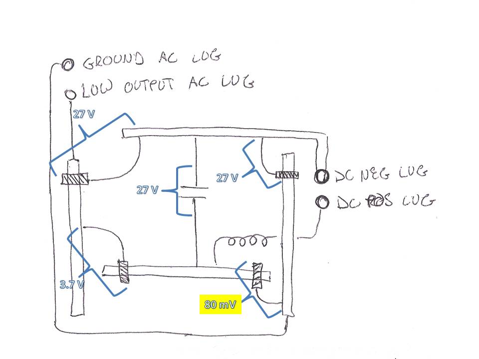

You're saying to crank up the welder and put a load between the work clamp and the stinger, then measure voltage where exactly?
Any and all connections. Set VOM to read volts, and apply probes to things that _should_ be in good contact with each other. If the connection is good, the meter should show near zero volts. I'm thinking bolt/screw connections.
Diode to heatsink.
Heatsink to choke.
Choke to socket.
Socket to cable.
Diode in / diode out.
Choke in / choke out.
You're losing power somewhere between the AC output from the main transformer and the output of the DC sockets. I'm starting to think it's got to be a poor connection.

Okay, CNCDan. Here's what I've got:
Everything that's not marked was between 0 and 1 mV. I also didn't do any measurements from the lugs out the leads to the load because of the clean 27 volts measured between the lugs, which is what was expected.
Now I'm not enough of an electrical engineer to make total sense out of all this, but one thing I do notice is that two of the diodes on one side of the circuit are at 27 volts, and the two diodes on the other side of the circuit are at 3.7 volts and 80 mV. One of these things is not like the other. Seems like the voltage across the diodes on the same side of the circuit ought to be the same. But I don't know. What do you think?

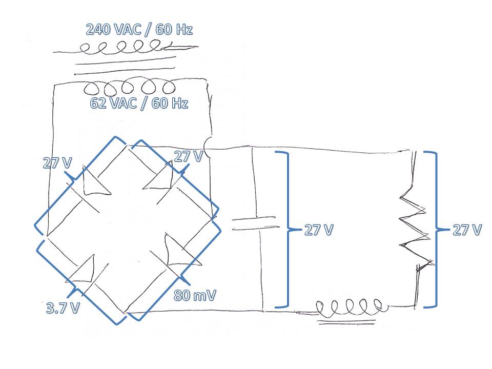

I did a little more studying, and I believe that I have translated the welder's circuitry to a proper electrical schematic. I tested the diodes and they're all the same polarity, so that will make replacing them easier if it comes to that. I'm posting the schematic here just for the sake of documentation. I wish I knew somebody who had the electrical background to look at this and tell me if it basically seems correct or not. I know there's somebody out there for whom it would be a piece of cake, but I don't know who they are or how to get a hold of them. Maybe I should post the schematic under a separate subject line to catch people for whom this thread has lost interest.
James: here is the result of the capacitor test you suggested. What I did was turn the welder on for about five seconds (with the light bulb in circuit as a load) to charge the capacitor and then turn it off and put the multimeter across the leads of the capacitor with the Ohms function selected. I did the test twice, reversing the leads between the two tests. Instead of trying to describe the results to you, I just took a video.
BTW, you said to "isolate the cap," which I'm not sure if you meant I had to remove it entirely from the circuit. If so, then this test is invalid, as I did not do that.

It is correct.
What you have is a very basic power supply that is used in many electronic devices. Just that this one is bigger than most. The transformer steps down the voltage, and increases the current. It also is designed to limit current. The four diodes in a bridge configuration rectify the AC output. The capacitor is like a battery and can store and supply a little current. It averages the highs and lows of the rectified DC current. The choke acts as a flywheel an keep the current more even.

I appreciate the validation of the schematic, Dan. Any opinion on the voltage across the diodes? Specifically the fact that two of them are at 27 volts, while the other two are at 3.7 volts and 80 mV? I have no idea how to analyze the circuit, but I can play the old game of, "one of these things is not like the other."
