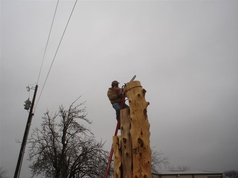

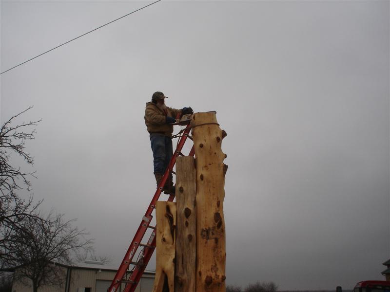

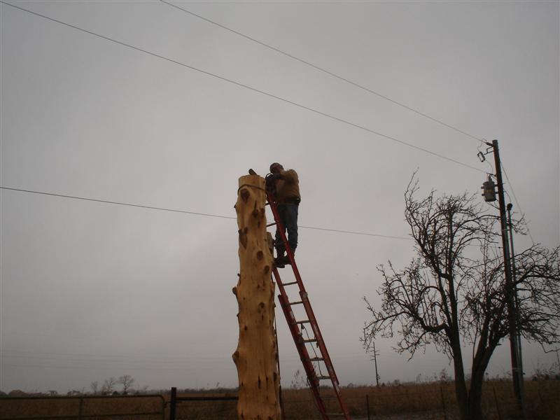

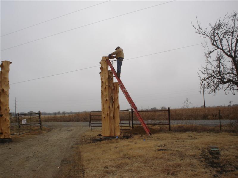

Thank you Eddie.
We didn't put the posts inconcrete. We dug three feet deep holes. We put down six inces of pea gravel in the bottom. Then we tamped in pea gravel to anchor the posts.
We did it this way for a couple of reasons. The first thing is we know that the sapwood will eventually decay even though we sealed it with Penofin red label. If we had put them in concrete they would have at some point developed gaps between the post and the concrete due to the decay.
The pea gravel has locked it in pretty tight. It also has a tendancy to wick away the moisture from the wood. When, not if, there is decay then additional pea gravel can be added to compensate for the decay.
After the posts were set I noticed one of them was out of plumb. We couldn't budge it without using straps and a ratchet. The pea gravel works in this situation.

I think in town, in a yard, and where most people water the yard at least some, the pea gravel is a good way to go. But down in Navarro County, I used the pea gravel for my fence posts when I built the fence around my garden. That was a mistake. That black land (Wilson clay loam, it was called) would get huge cracks when the ground got dry in the summer, the pea gravel disappeared into the bowels of the earth and my fence posts were standing in big holes until I filled in around them. We would literally get cracks in the ground in which you could have lost a golf club. Perhaps if we'd gone deeper, it might have worked.

Thanks, that's along the lines of what I was thinking when looking at your pictures. It's very dificult to get posts to stand up straight without allot of bracing at the top and anchors at the bottom unless they are down in the ground. I've racked my brain on a design for my gazebo's that will do this, but always end up with a short wall at the bottom with metal brackets in cement and angle bracing at the top to do this wtihout setting the posts in the ground. Every method has it's pros and cons.
