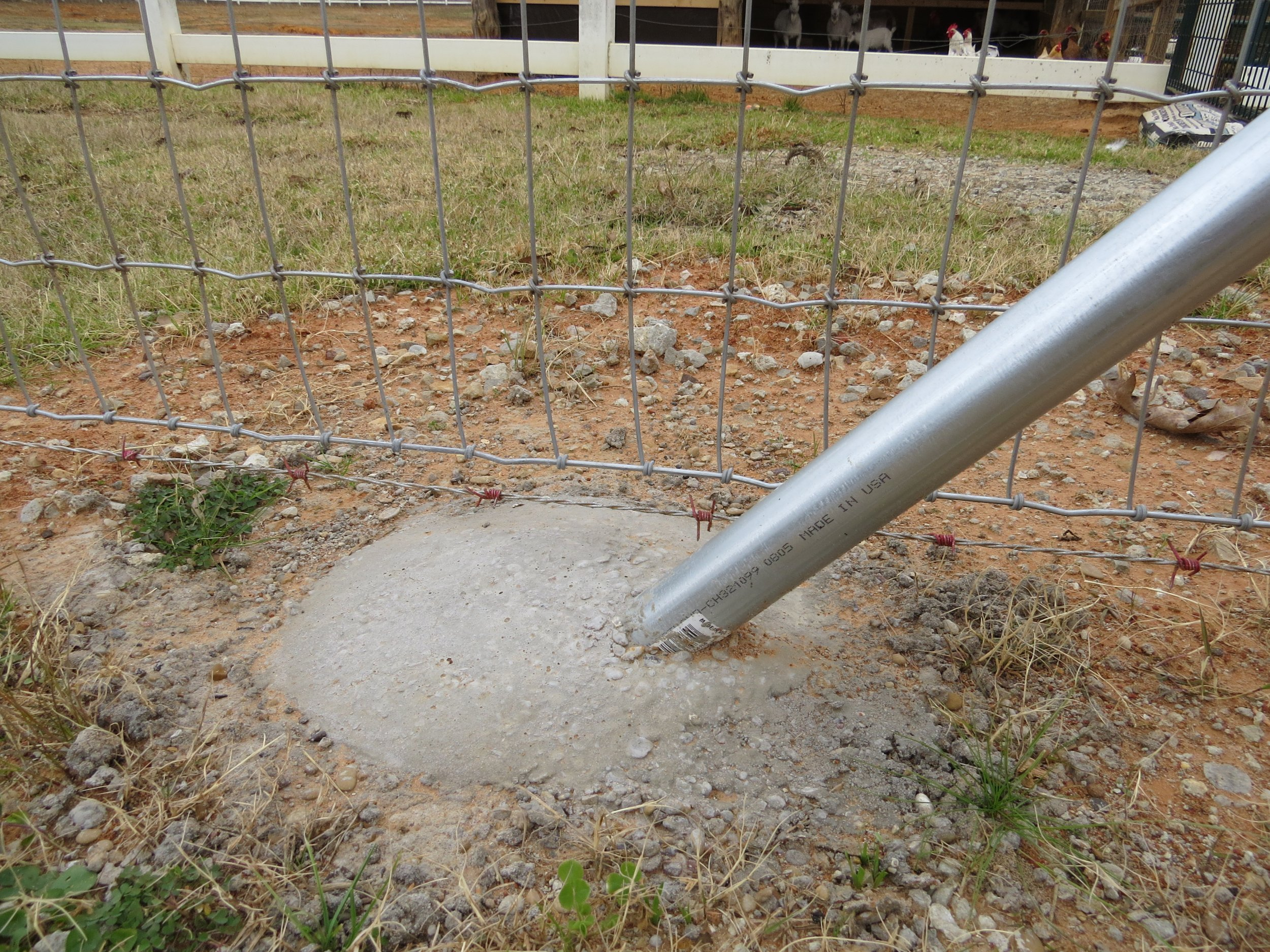

For the 15 acre goat pasture ran woven wire with non high tensile barb wire on top. Steep rough ground surrounding some kudzu. Dehorned all my goats. They could reach thru and kept the fence rows clean. A Great Pyrenees protected against coyotes and domestic dogs. Also put horses in there too and with barn run in stalls for goat only. Goats improved the pasture and cleared the woods. With some help eliminated the kudzu, multiflora rose, privet, honeysuckle and autumn olive.

I started out using the H design and changed to a double H design. The double H is still tight after more than 20 years. The corner posts on the single H's tend to heave. I wouldn't use barbed wire near horses. We used 2x4 no climb and 2 hot wires. Goats? Lol, I was so happy on butcher day when those goats got the knife!

The second post and the horizontal brace in the H design do nothing without the angle brace.
H design is used most in my area. Knowing the angle brace is key to success.
I've not saw it done like Eddie is doing it. I have no experience to base it's success on.
But then,,,, here in the great State of Missouri,,, we would cut the verticals on the woven wire and wrap all the way around the post tying each horizontal wire back onto itself. Same with barbed wire. The staples only keep the wire from sliding up/down the post.
You are correct about wrapping the wire. So much engineering has gone into this, too much to rely on staples..........

They have a good tutorial on fence building: Stay-Tuff | Home of the Fixed Knot Fence | Fixed Knot Fencing
Also, they recommend pulling the wire together from the middle on the ground. Then standing it up.
They use double H braces.
I learned quite a bit about building fence from an old guy that did it all his life. One thing I never forgot was, use short staples in old locust posts, you'll never get a long staple driven straight. The double H was from experience. You always remember the mistakes you make, especially when you're the one that has to fix them.
