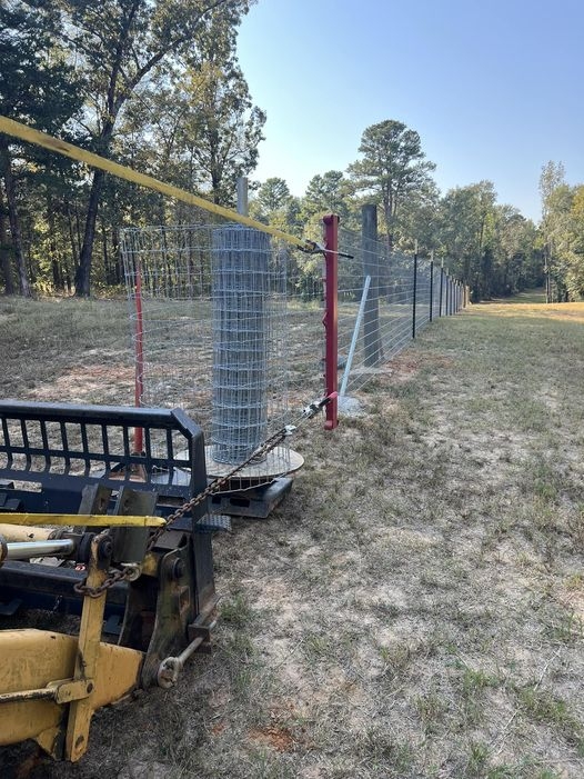

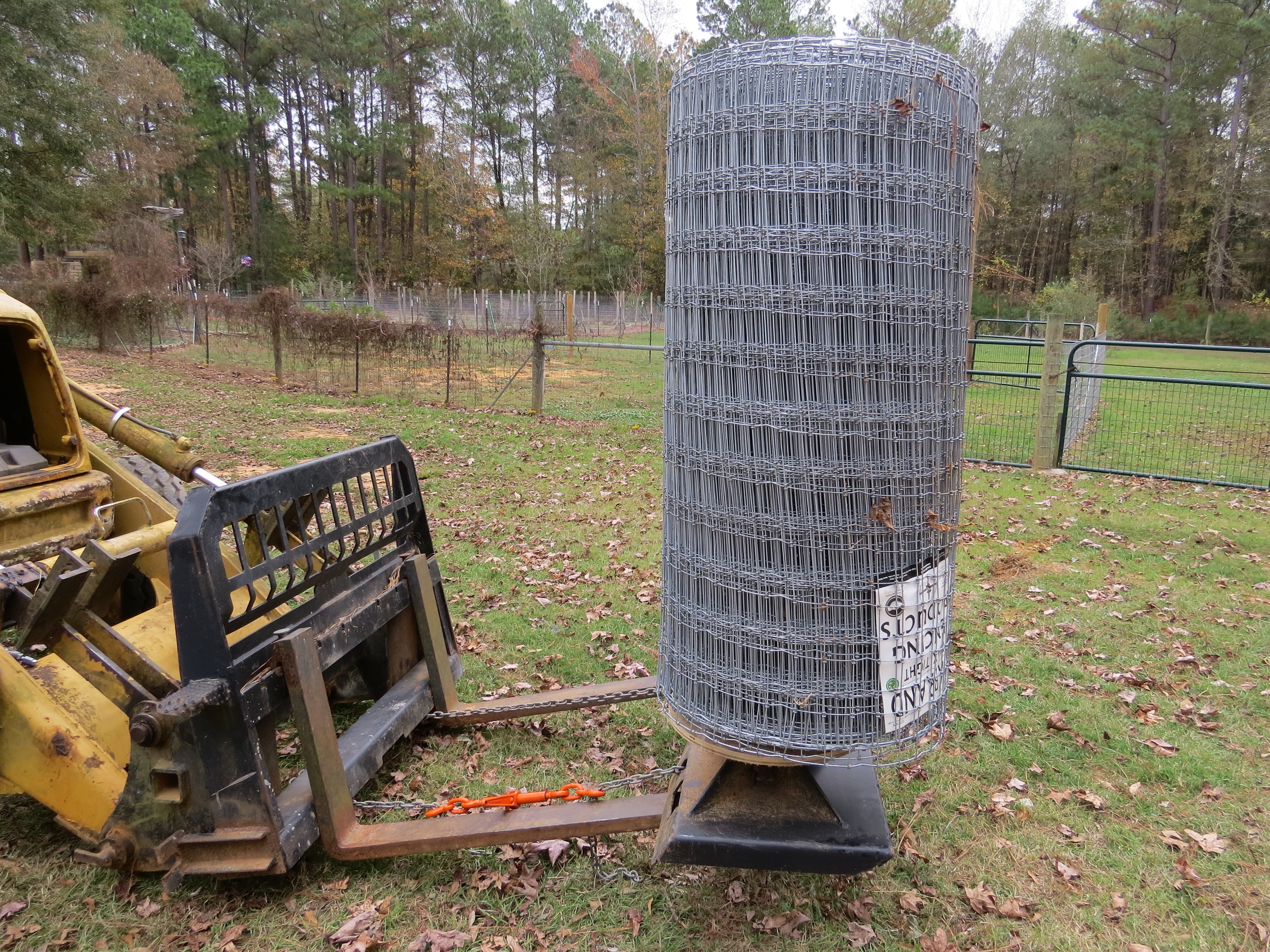

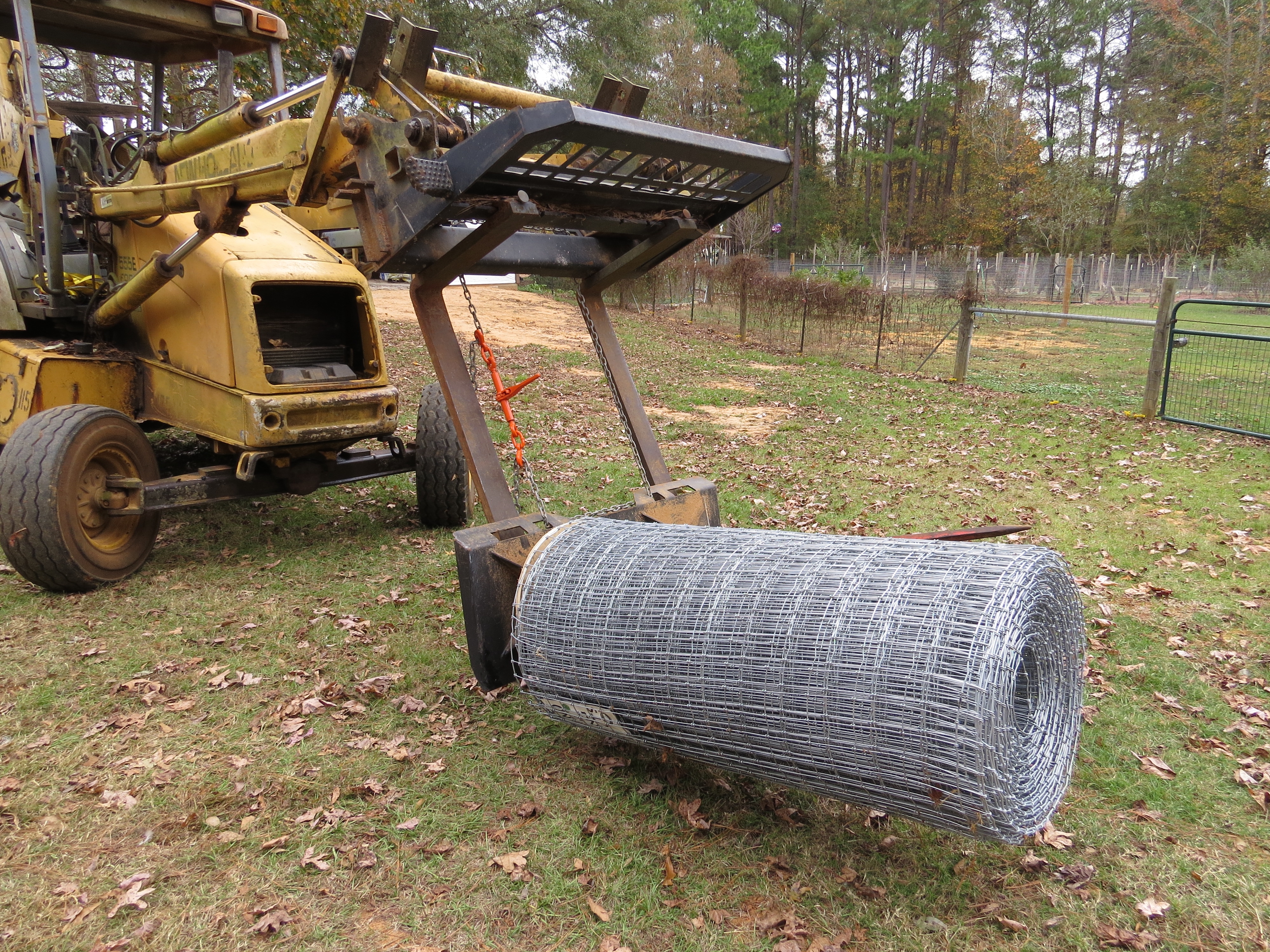

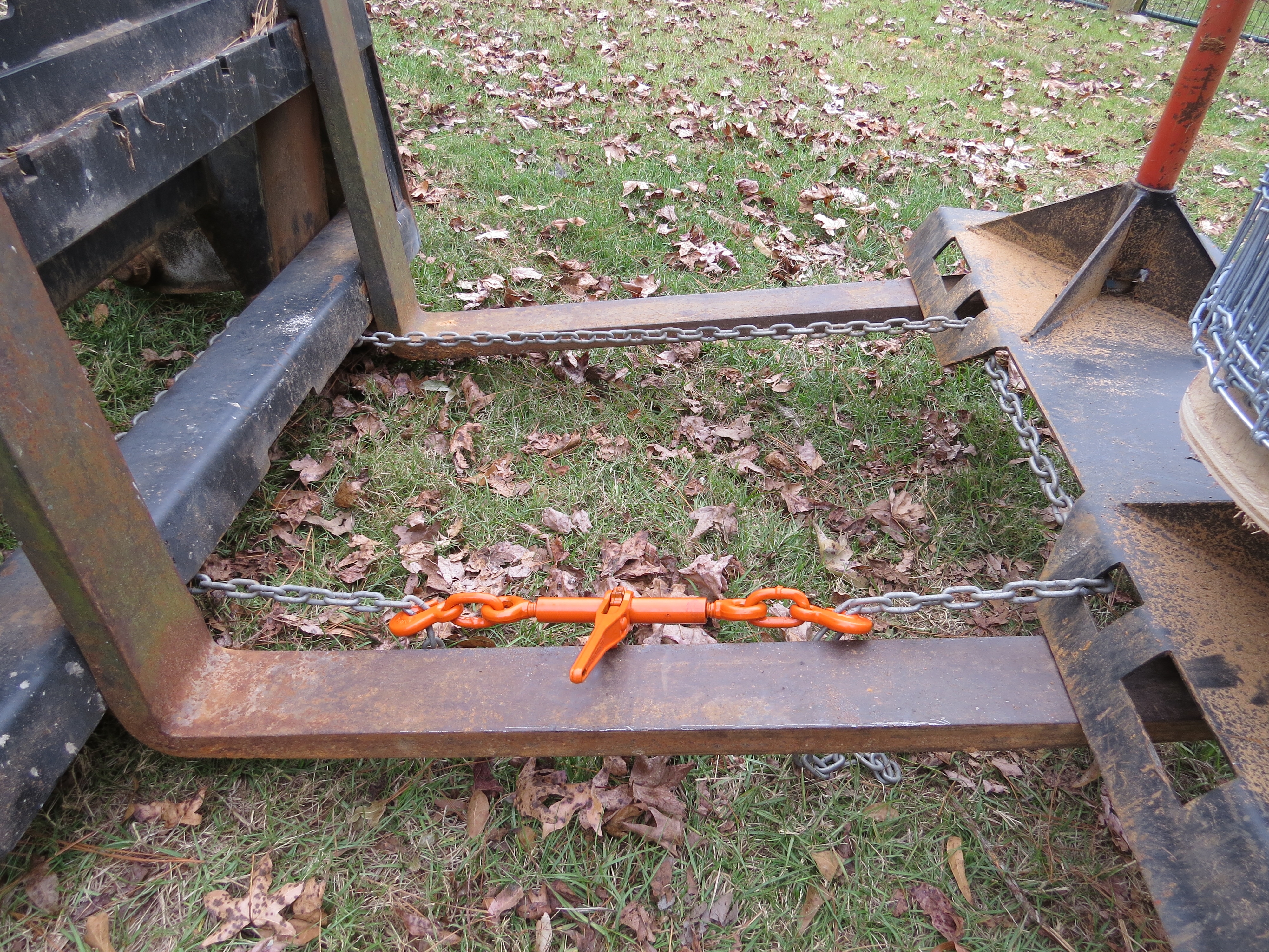

The 2x4 horse fence is heavy. VERY HEAVY!!! I didn't want to spend the money on the proper tool for unrolling it if I didn't have to. After looking at what I already own, I figured out that I can stand my hay spears up on the tips of my pallet forks, and hold it together with a chain and ratchet. Then I cut a plywood disk for the wire to spin on and a 2 inch pipe so the spear didn't get caught on the inside of the fencing.

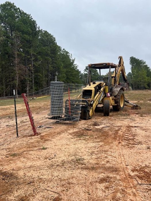

I staple the fence to the wood post with barbed staples. Then I drive the backhoe backwards to unroll it. Trial and error taught me to only unroll one roll at a time before stretching it and stapling it to a wood post.
I use two come-alongs to stretch it. The strap one is super long and it allows me to find something to anchor it to up high on the backhoe. The cable one needs a chain, it' short, but more powerful, and it goes on the bottom where I can attach it to the frame of the pallet forks.

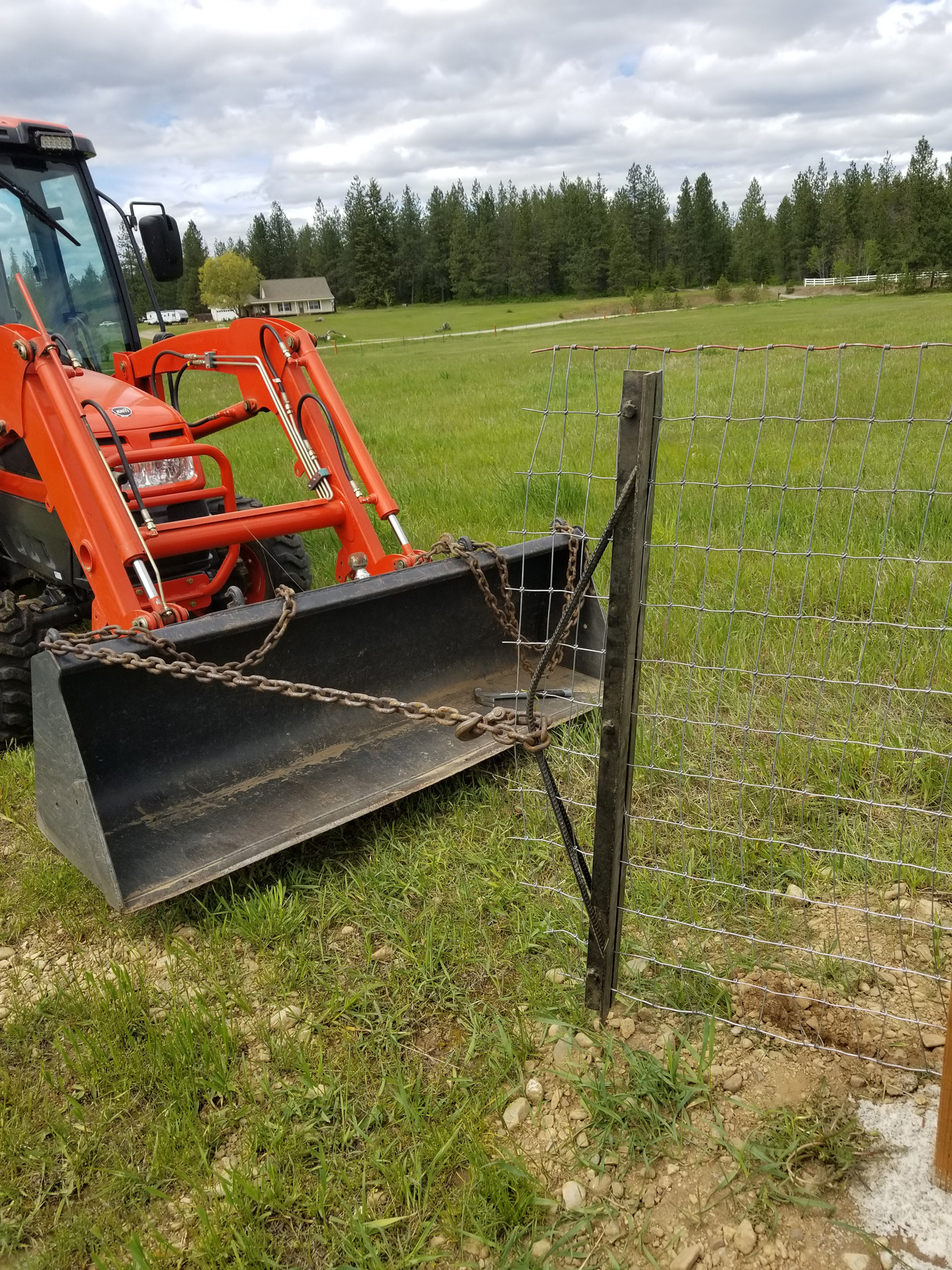

I tried tightening the wire by driving backwards, but I would either spin my tires and not get it very tight, or I would damage the wire and have to cut that section out. I did have to lower the outriggers to stop from pulling the backhoe when tightening it.

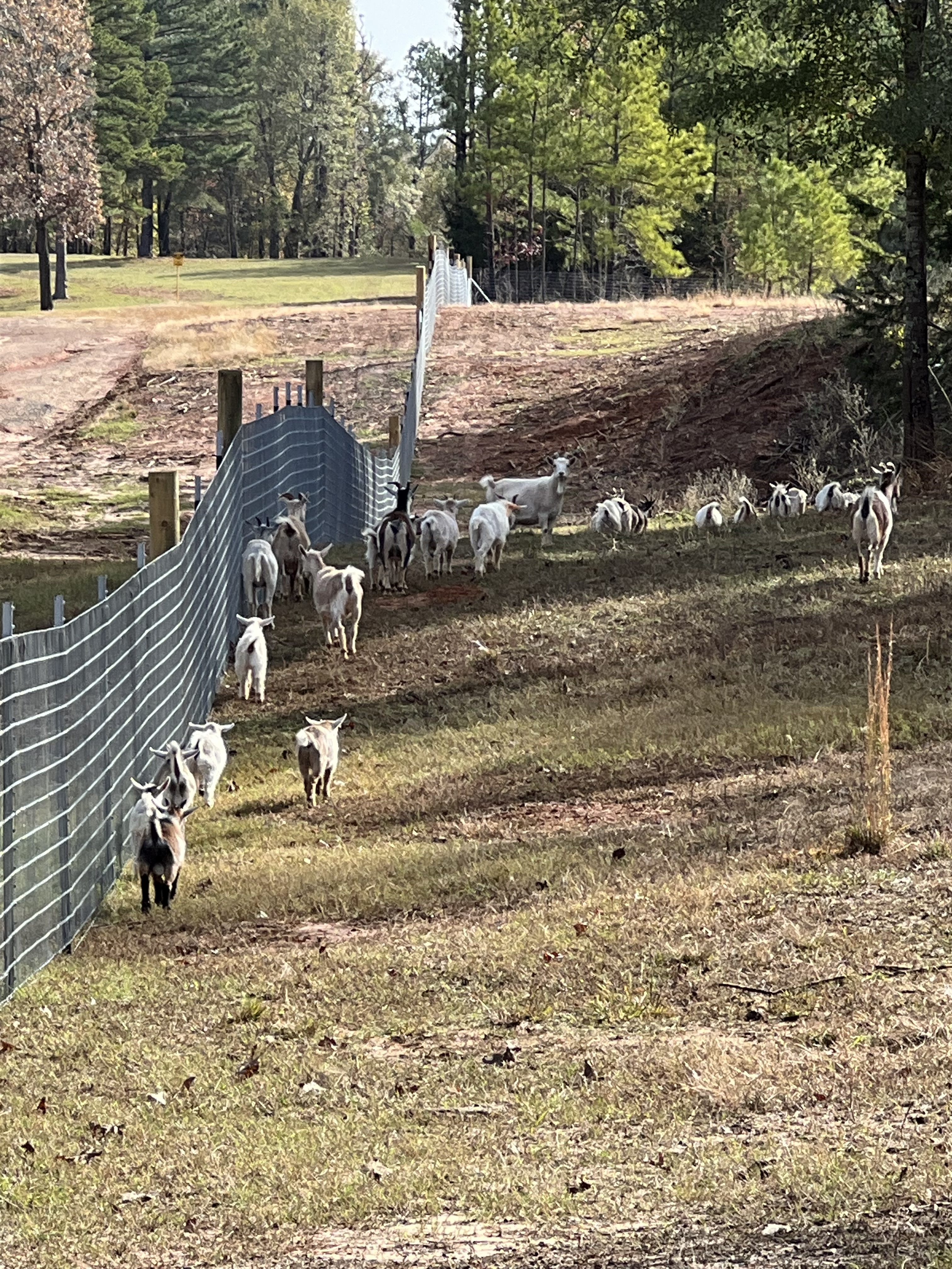

This picture and video was right after Thanksgiving. It's all enclosed, so that's good. I feel like I've been doing just one thing for the last two years and ignoring everything else that I need to do. But that's not true, my wife is a Nurse, and everything she needs done is life or death, panic to have it done right away. Some of it's for the dogs, other things are for her plants, and some of it is for my Mom and fixing stuff around the house. Working 5 days a week also gets in the way of getting things done!!!
The best thing about having it all enclosed is seeing my horses have more land to explore and feed on. Before this fence, they where on 8 acres with 4 rows of electric fence.
When I first cut the electric fence, they stood there watching me. I don't think they knew what to do. When I moved away to cut out another section of electric fence, one of them walked up to the opening, stood there for a bit, then ran through it real fast, stopped and ran back in!!! Then another showed up and they both walked through it and waited for the other two. Then they took off running, but where back in just a few minutes. It was fun to see their reaction!!!

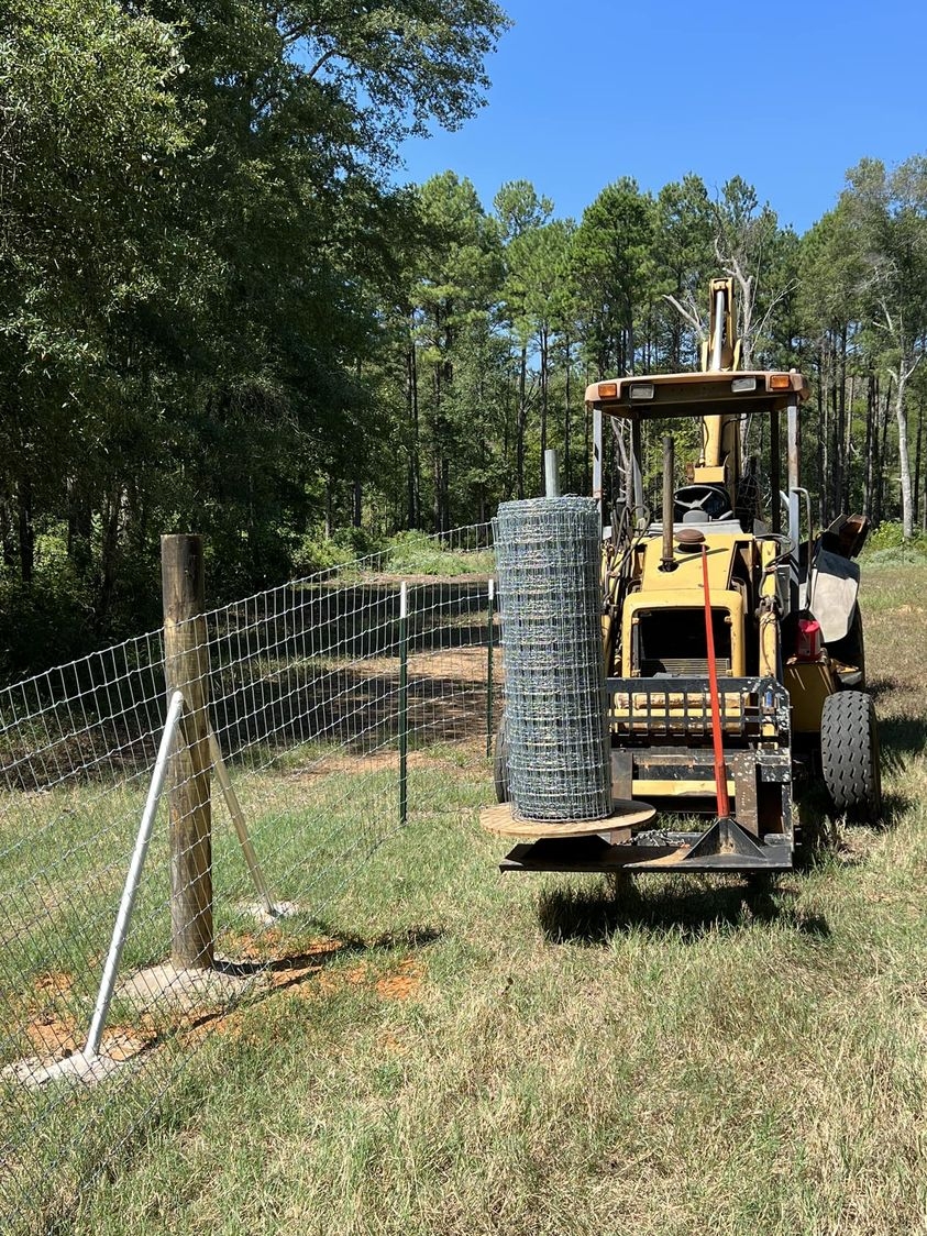

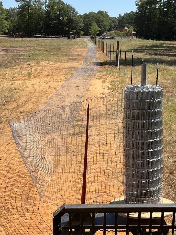

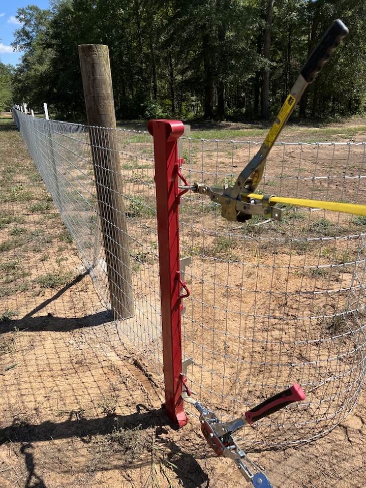

View attachment 1968742 View attachment 1968744 View attachment 1968746
At first I tried screwing, and then bolting a pair of 2x6's together to pull the wire on the fencing around my dog yard, but that would slip, break apart, or wear out. So for this fence, I bought a 4 foot Stretcher Bar from Kencove that worked great!!

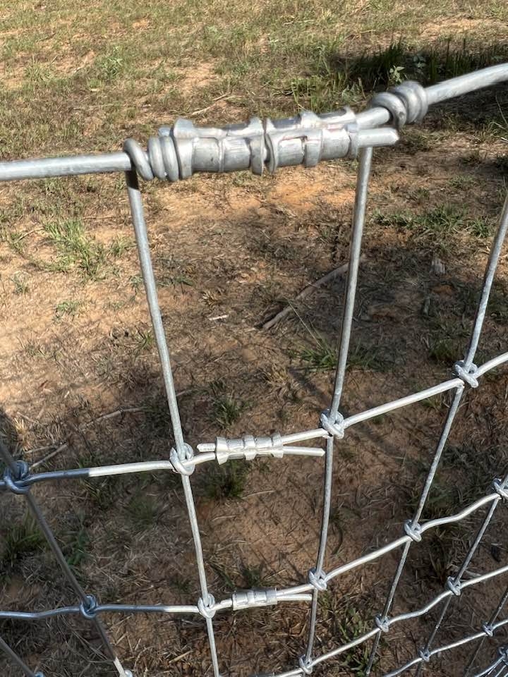

The thing I hate the most is connecting each roll together. I opted from crimps because they last forever. I don't trust any of the other types of connectors, and tying fencing is the worse thing ever!! The crimps work great, it's just painful to do all 13 lines every 200 feet.

Nice job with your improvised fencing equipment. I used the bolted 2x6 method as a stretcher, but as you say it can bend and break wires. I finally figured out this could be avoided by wrapping a few times around the 2x6 before stretching. This sacrificed about a foot of fencing with each stretch. The crimp ties are awesome and the easy way to go.

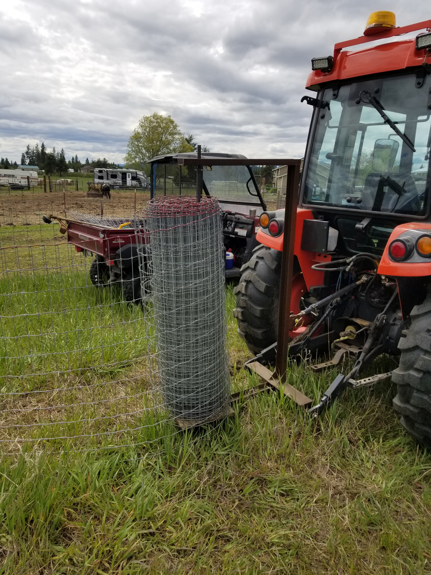

I made my own unroller and stretcher for 2x4 non climb myself. Made job way easier. I used wooden H Bracing myself. Installed main fence 25 years ago, all still tight and standing.

Your wire unroller is very similar to what I was thinking of doing if I was going to make one. But then I got crazy in my drawings and made it a double so it would be wider and closer to the T posts, and then I thought about having a hinge in the middle so I could move it from one side or the other. In the end, it really didn't matter what side it's on, as long as it unrolls!!!
