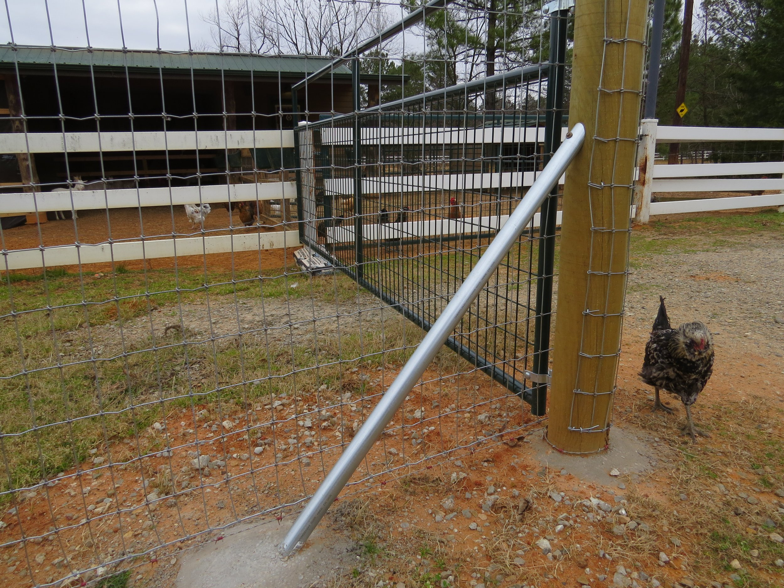

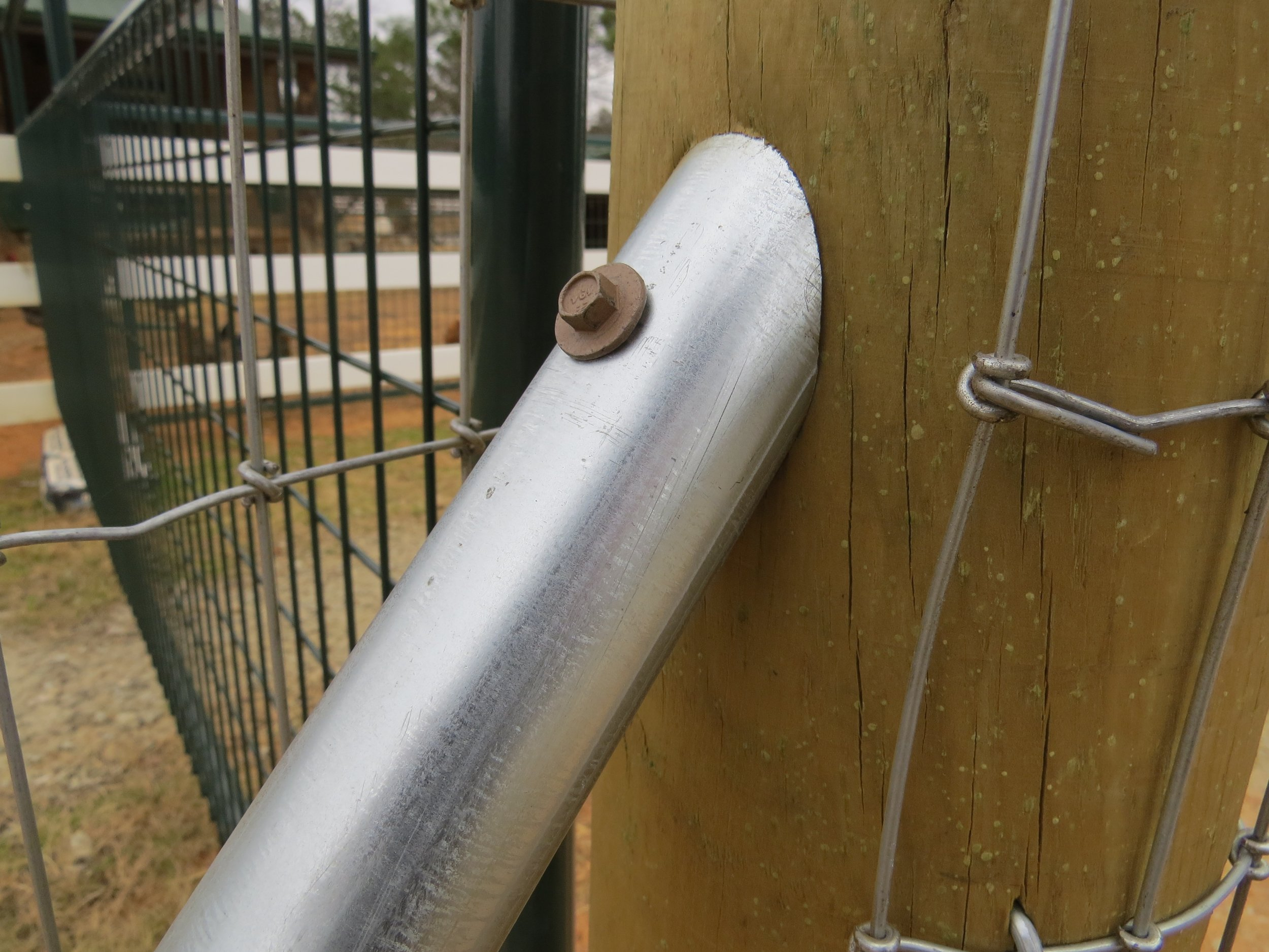

Thanks Eddie,
This is more or less as envisioned with the bolt into the post - thanks for all the detailed pictures too! Nice straight fence lines, and gates too.

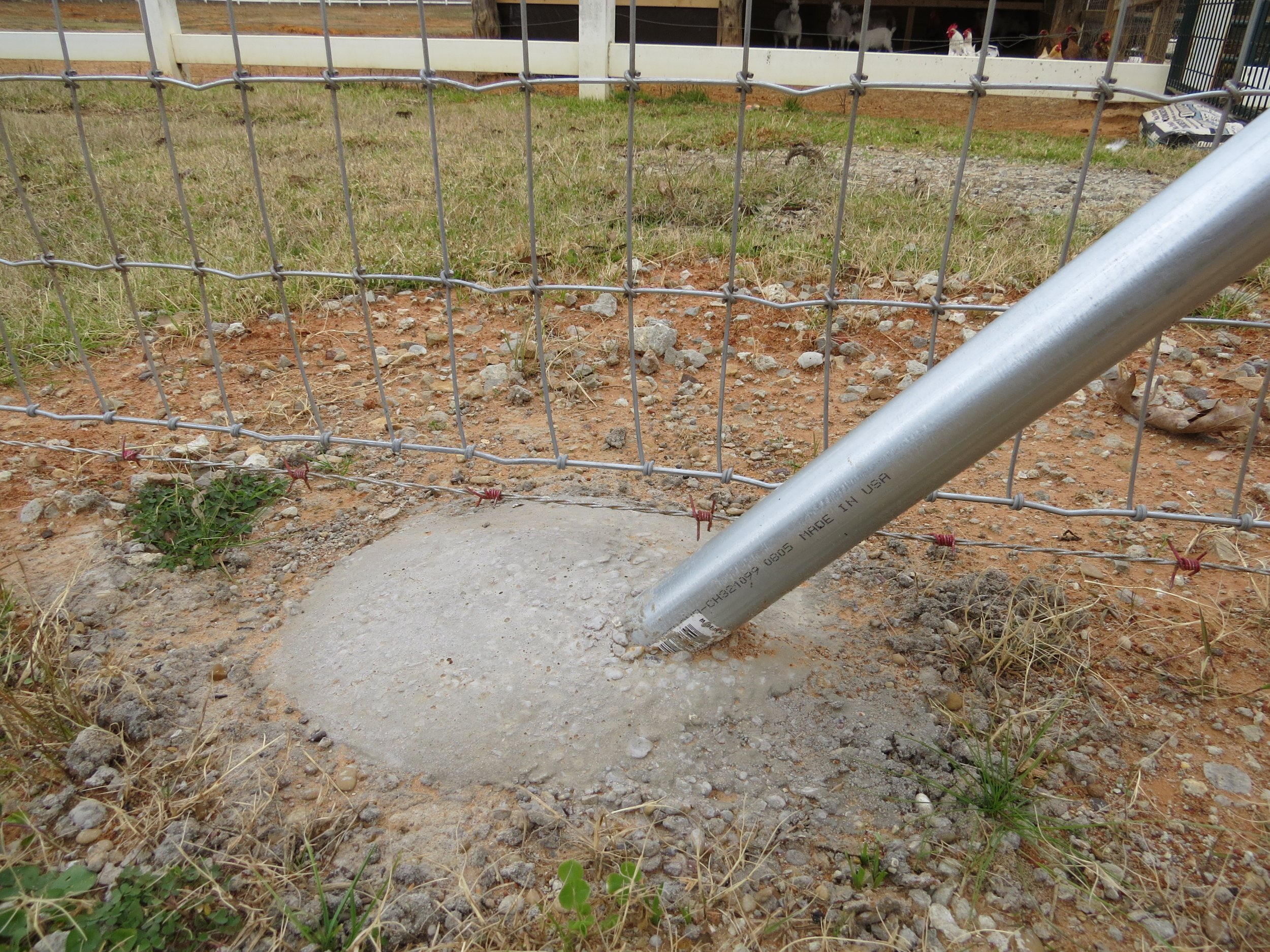

The forces on the poles are as follows: corner/end force is up, inner pole force is down. The concrete around the poles is to cause resistance. My post hole digger is 48", thus the reason for the depths. For the H, I drill both holes. The corner pole is pressed below the bottom of the hole by my tractor loader, guided by my wife and a level. The longer the horizontal piece, the less the lifting force on the corner, thus I prefer 10'. Concrete is 1/2 to 3/4 sack so that it grips the pole but does not fill too high. If the drilled hole were to be filled close to the surface, it no longer acts like a plug and can be pulled up more easily. The 15 foot spacing is because without noses and heads pressing through, such as allowed with a barbed wire fence, there is no horizontal pressure. All posts then only become a means to hold the fence upright - not to resist animals pressing through for food. After years, I have no leaning. 6 foot t-posts may have been sufficient.
I like the idea of barbed for the top wire. Without some type of deterrent, I have seen horses push a field fence down to 2 feet high. For the top wire I like 4 point wire to ensure anything necking over the wire learns not to do that. If pricked with each temptation, I would not expect continued attempts. I have tried electric wire for other situations and have only found it to be easily grounded or some other type of failure, so I avoid it entirely.
Observing your current implementation, with the 45 degree support against the corner, note that your corner will be exposed to tremendous vertical force. Your pasture wire will be tighter than your dog wire. For the pasture, calculation-wise, each wire above ground level (I count 13) will pull up on your corner by the same force as the wire tension. Therefore if the average wire is pulling 30 pounds, there will be 390 pounds of constant lift in all types of temperature and weather. Weather causes slight movements in the soil.
Another observation is the wire wrapping around your post. To quote a standard, the USDA specifications, if they were to pay for any fencing, requires each wire to wrap a post 2 times. I suppose this keeps staples from being the primary force holding the wire against the post. Even treated wood will soften and staples will loosen.

I went back and forth on how to do my corner posts and how to brace them. As a contractor, I've done quite a bit of framing and it's amazing how much strength there is in a single diagonal 2x4 in holding up a wall. When looking at H braces, I feel that the strength is in the diagonal wire that is holding the cross beam in place. Once the wire stretches, the H brace loses it's strength. My first plan was to replace the wire with a board going from the top of the corner to the bottom of the second post to lock it all together. Eventually I came to think that the second post and horizontal post wasn't even needed once you had the corner post locked into position. Then I wondered how to make the diagonal support brace stronger. That's where the pipe came in. It wont warp, stretch, rot or dry out over time.
To deal with the force of the fence pulling on it over long distances, I am stapling the fence to each of my wood posts, every 50 feet. I think this will give the fence enough room to expand and contract, but also relieve a lot of the pull created by a long run.

... As a contractor, I've done quite a bit of framing and it's amazing how much strength there is in a single diagonal 2x4 in holding up a wall. When looking at H braces, I feel that the strength is in the diagonal wire that is holding the cross beam in place. Once the wire stretches, the H brace loses it's strength. ...
You are right about the diagonals - in static situations. But for fencing you have soil which moves with the weather. The objective is to reduce forces that would cause the posts to move. Ground is not a static floor and the corner post is not truly anchored - like hurricane straps that might keep a wall corner anchored to the floor. And by forces, imagine an analogy where you have a free-standing wall. If a wind is pressing on the wall and you are on the other side, holding it up against the pressure, what are the forces? If you are holding it at a point 6' above the floor, you are acting like your diagonal fence brace. You are pressing at a diagonal angle, meaning horizontal but also vertical. If that wall was not heavy enough, you could not keep it from lifting off the floor. Similar forces are on your corner post.
As for the cross wire, the idea is to use multiple strands. I have a roll of barbless 12 gauge, which is a double wire. I then run a double loop for the diagonal, therefore there is a total of 8 wires. I take a 12"-18" of rebar and twist it at the center of the span to tighten it up, then stick one end into the field fence. Even with one loop, I have never witnessed loosening, but I have witnessed breakage due to excessive twisting if the loop starts too loose. And for function, the purpose of the wire is to keep the shape of the "H" constant.
As for the corner lifting force, the upward force is directly proportional to the distance between the post and the first object that touches the ground - your diagonal piece. This is why I make my H between 8 and 10 feet wide. Twice the distance means half the upward force on the corner. And the (edit: your) diagonal is being pressed longitudinally into the ground. The lower it's contact point on the corner, the more the force. Even if you surround that pipe with concrete, keep in mind that the soil around it will move with weather, so hopefully it runs deep and has a resistance to pressure well below the soil surface.
