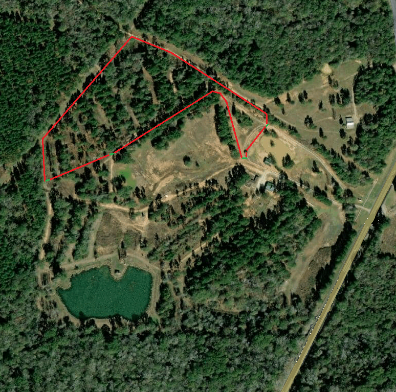

I currently have a couple types of fencing in place that I hate. The new pasture is outlined in red in the first picture. Green shows where the gates will be. I'm still taking out trees, but most of it is ready to go. The Google picture is several years old and it doesn't show how much that I've cleared since then.
The second picture shows what I want it to look like when it's all done. My plan is to be able to rotate the animals from one pasture to the other every week. They will have one week in a pasture, while the other 3 pastures will have 3 weeks of rest and growth. Then in the Fall, when growing season ends, I'll open all the gates between the pastures and they can go where they want until Spring. This will also allow me to spray for weeks and not have anybody in that pasture for several weeks. If a tree falls on a fence, I can keep that pasture closed until it's fixed. Hopefully I will remove all the trees that might do this, but I also know this is impossible and eventually I'll have to deal with a tree taking out my fence.

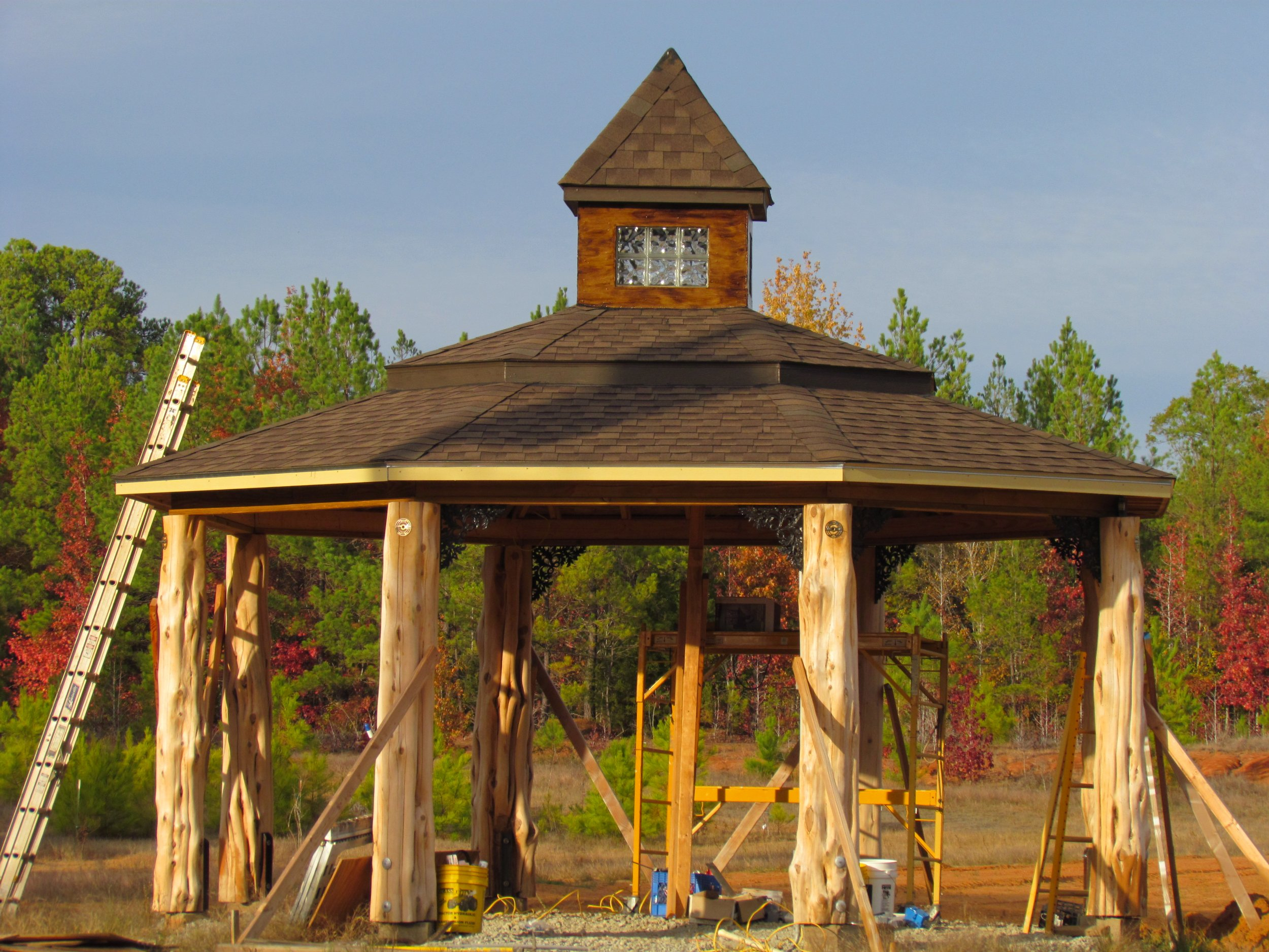

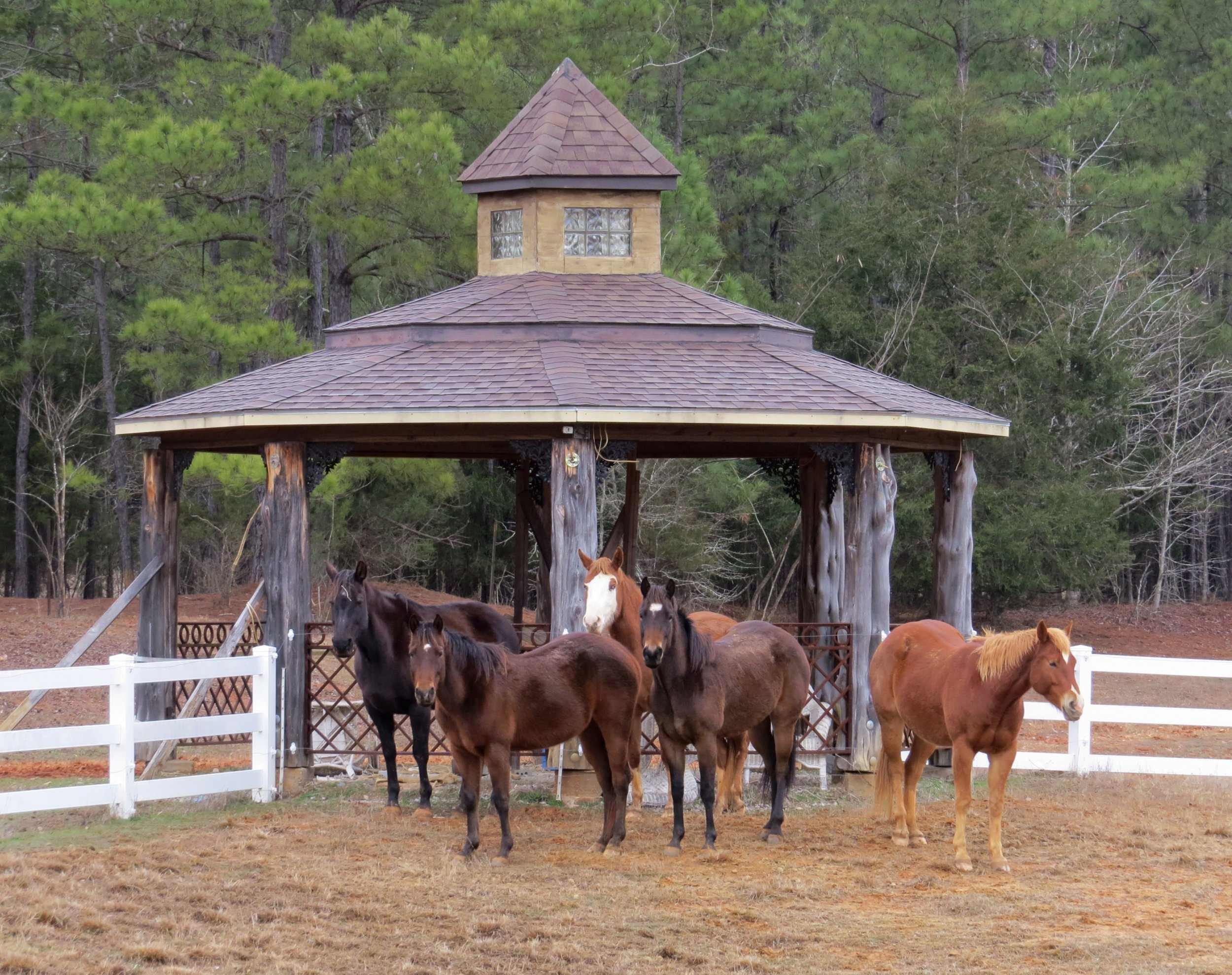

I have a gazebo that I started years ago, but lost interest in, that will be converted to the boy barn. I'll have to run power and water to the gazebo, but it's already close to there, so it's not going to be an issue. That will happen after I finish the first pasture. And the original pasture is 5 acres that has my barn and small pond. This will remain our feeding area. It also has the barn, which is going to become 3 times bigger. We will also create our handling area there, along with a holding area for goats that we are selling.
Is that the gazebo with the "one of a kind" crooked roof? That's a neat building.

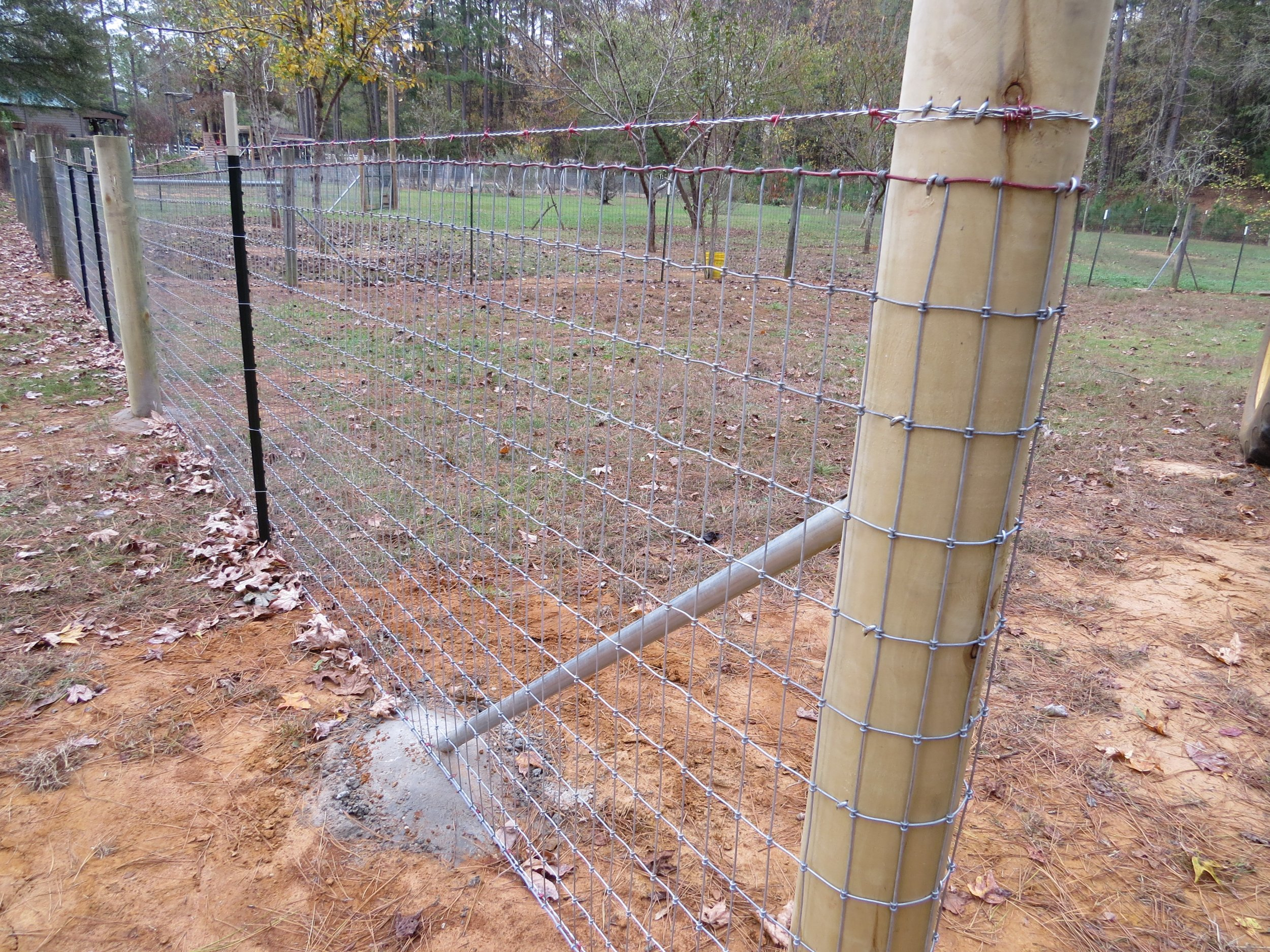

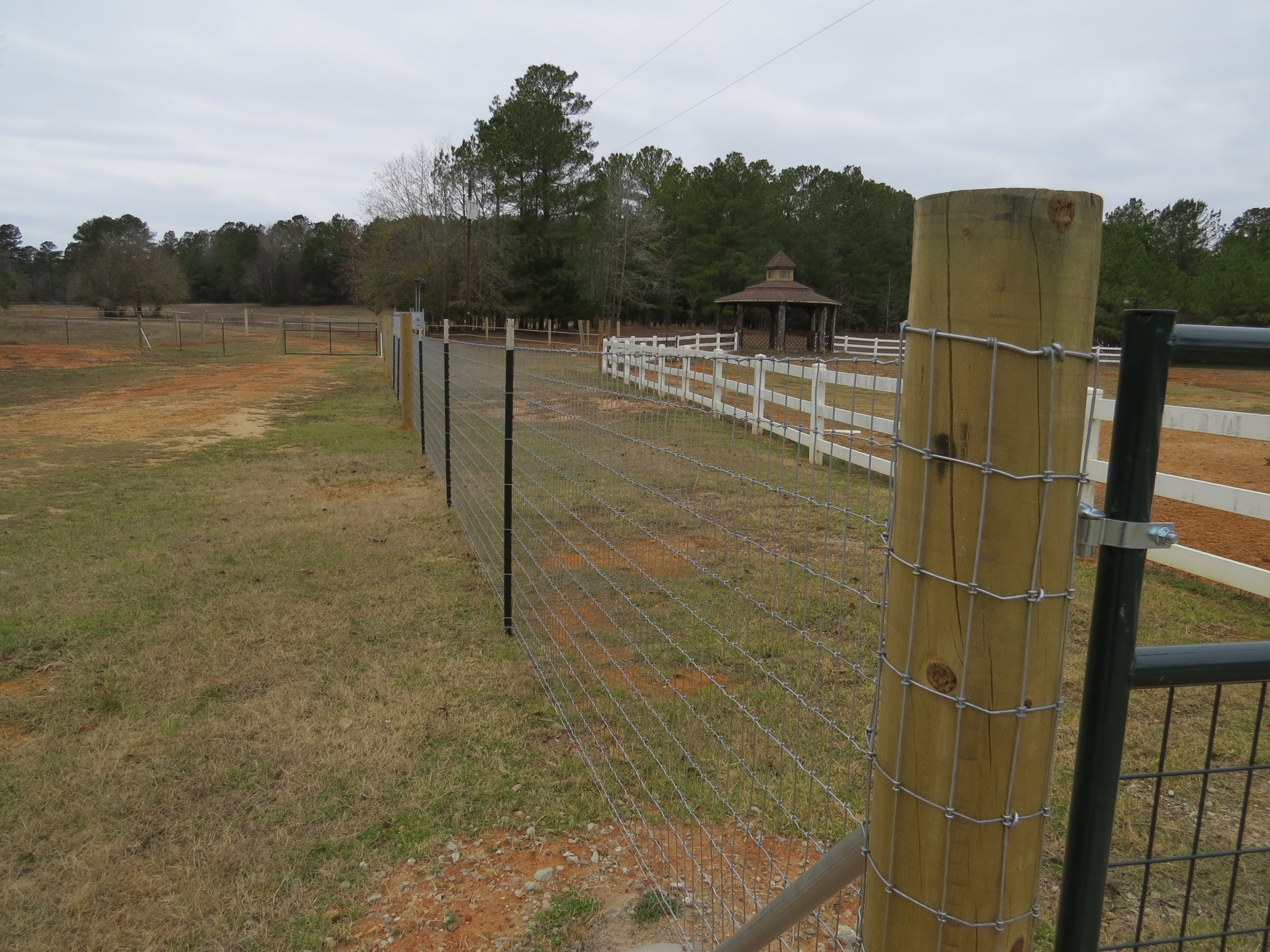

I'm buying 8ft x 6in treated posts for my corners. I'm also putting them in every 50 feet. The 6 foot T posts are 10 feet apart or less, never more.
I'm using 10 ft x 2 inch conduit for my bracing. I cut it in half at 45 degrees and bury the square end in the hole with a couple sacks of concrete to lock it into position.
The line posts are set in packed clay, except where I think I need more strength, and then they get concrete.

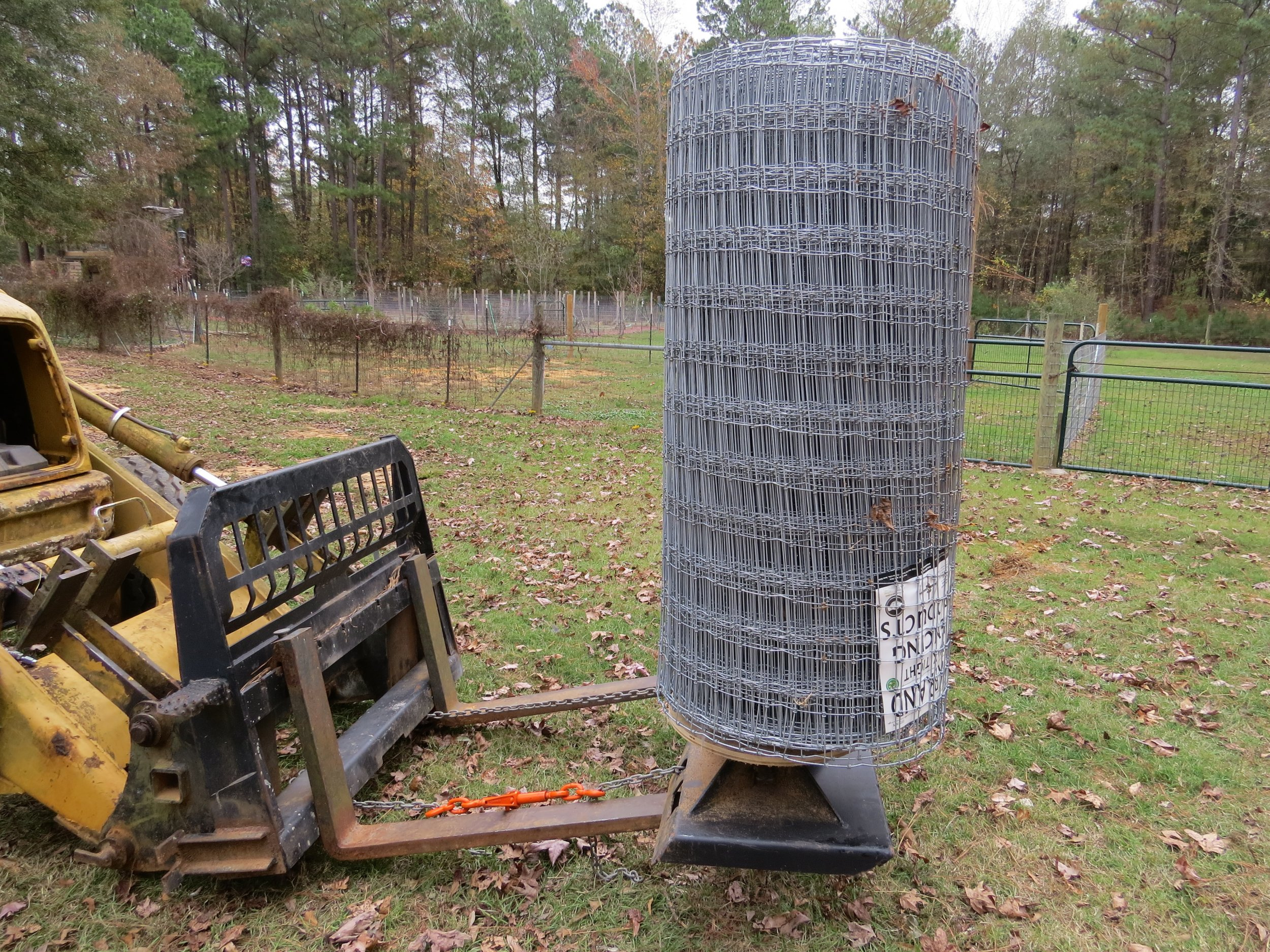

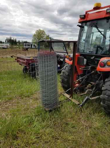

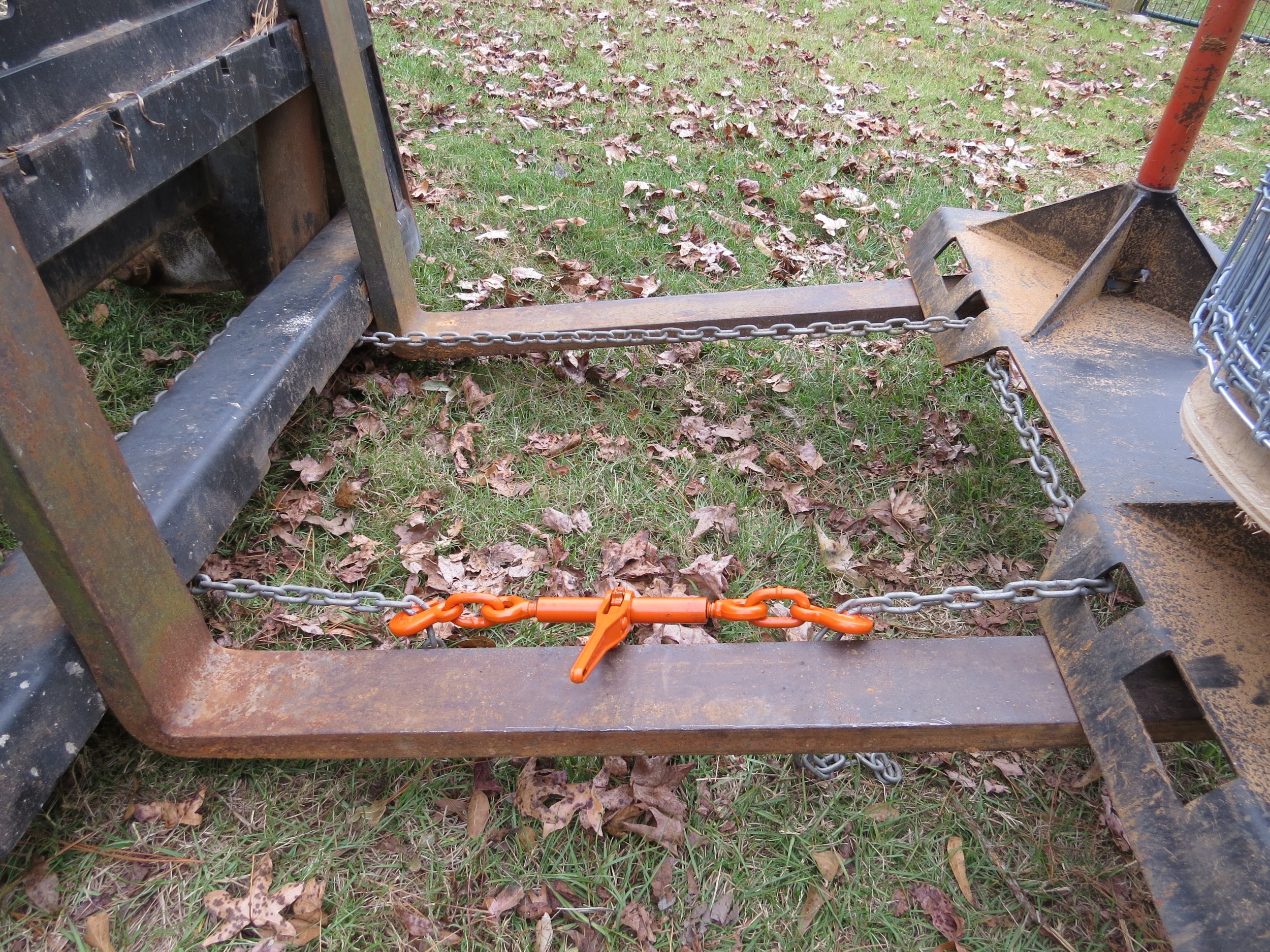

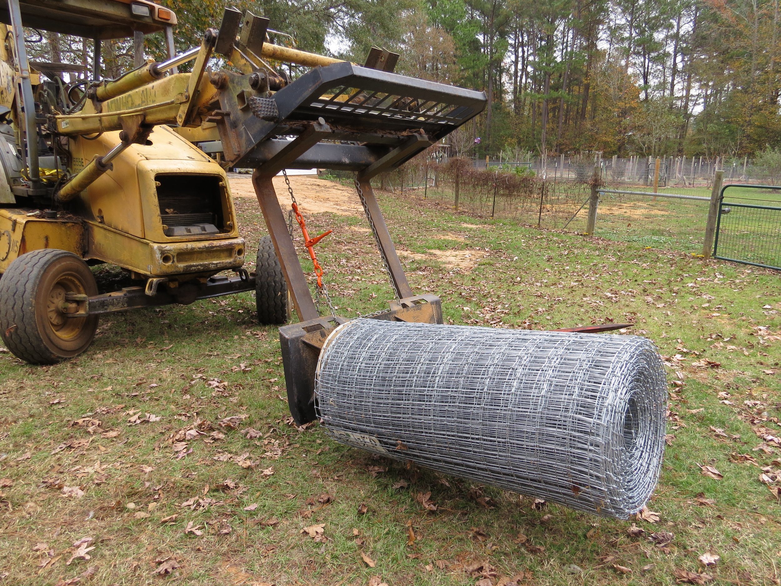

One of the hardest things about this horse wire is unrolling it. I watched a bunch of YouTube videos on how they do it, and got the idea to use my hay spears on the ends of my pallet forks. I cut a piece of 3/4 plywood to allow it to spin easily, and it works better then I had hoped. My plywood needs to be bigger, but otherwise, it's been a huge success!!!

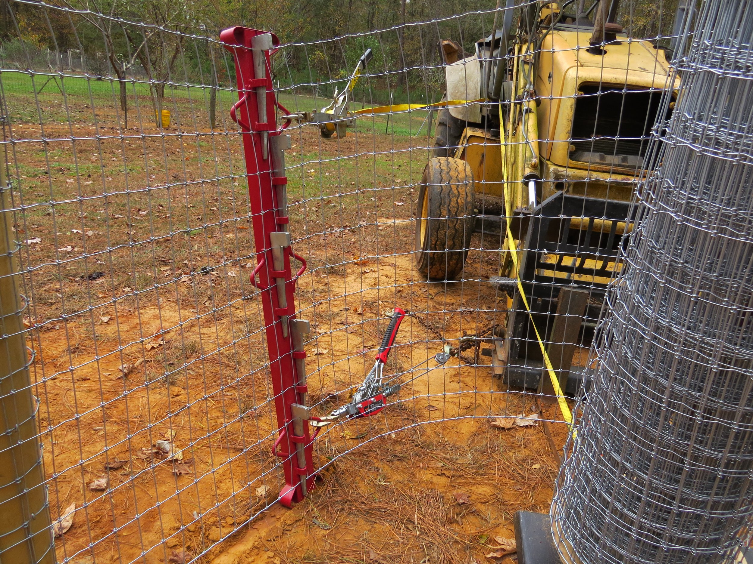

I bought a fence stretcher from Kencove that works great. I tried screwing 2x6's together, over the wire, which works, but it's not ideal. This was money well spent. I use two come-a-long's to get it tight and then staple it to the wood posts. I'm able to do this by myself, which is how I prefer to work.

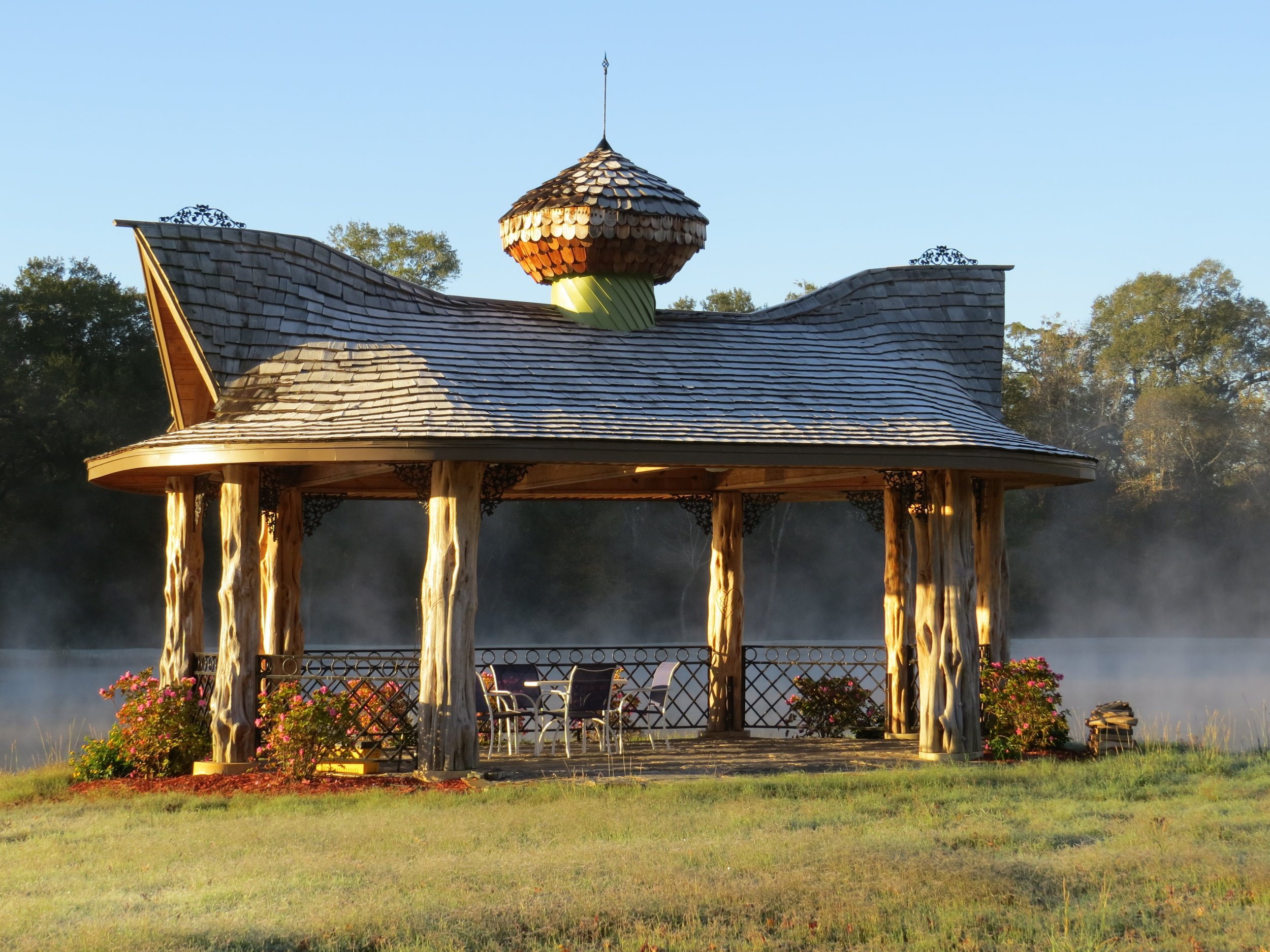

No, the boy boat barn gazebo was my first attempt at a gazebo with logs from my place. My original thought was that it would be a nice sitting area that was close to the house. Reality is that I'm not a sitting person and there really is no use for it.
For the last couple of years, I was planning on tearing it down. If I had some spare time, it would be gone by now.
It wasn't until we figured out where to put the fences, that we realized this could be converted into a boy barn. I'm going to close off 5 sides to keep the wind out. Two sides will keep the metal railing and that's where we will feed the boys. I'll built a trough of some kind on the other side. The remaining side will be where the hay bale is placed so it remains dry. I expect it to pretty much block the opening with just enough room for the boys to get in and out of there.

This is the gazebo with the crooked roof. We call it our Wedding Gazebo. If you look at the satellite picture, it's at the end of the peninsula at the big pond.

Eddie,
Nice project, and like the 45* anchor method on the corner/end posts. How do you attach the pipe to the post - a drilled hole, drill and lag? Can you include a pic of the post side connection?
I'll be doing a similar fence project this summer (small vs yours) only 7-800' and plan on using 2x4 fence and will do wood corners/ends and steel intermediate posts.

Eddie,
I'm using 5 inch exterior LedgerLok's to attach the pipe to the wood posts.
https://www.lowes.com/pd/FastenMast...erior-Structural-Wood-Screws-50-Count/3294886
The white fence is coming out once I have the horse fence up. I'm going to use it along the road, where I think it will look nice. I'll also run the horse wire behind it, so the white fence wont actually do anything except hide the horse fence and give me a nice look.
You can see the unfinished gazebo in the background. This will become the boy goat barn.
I still need to run the barb wire on the top of the fence, but that's not a big priority right now.
