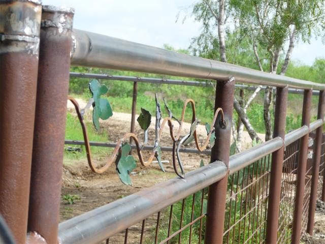

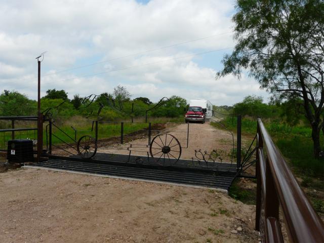

These past eight days have flown by. Today was bye day. But before Harvey left he started to put the icing on the cake. Remember the leaves I traced out on metal and Harvey cut out and Bobby and I welded stems to and the Harvey forged curves and texture to last week, (breath), well this morning before Harvey packed up, he attached a section to the entrance fence to see how it would look, IT LOOKS SO GOOD!
below are a couple of pictures with the vines, leaves and a flower, I'll post again when we have the remaining 14 sections all up and painted.
The entrance turned out perfect. We only had a rough idea going into this project but the entrance now captures the wildscapes and wildlife and like nature you have to look to see it. The added touch of the grandparent's old metal just makes it that more personal, and now there is a story to be told about the gate.
Thank you so much Harvey, Glenda, Bobby and Mike!

TxDon,
Nice looking gate you got there.
You got any paint secrets you want to share? I've got a big corral project coming up next year that will be too big to sandblast, so I'm looking for ospho or something like that to use.
/ This, that, and the other #446
GaryBDavis, I got Harvey's secrets so don't tell anyone. The galvanized hog panels were primed with Kiltz exterior oil base paint and the rusty wagon wheels were primed with ospho. No special primer was put on the other metal. Then everything gets a coat of a 50/50 mixture of Rustoleum brown rusty metal primer and Rustoleum glossy leather brown paint.
After that I might put a Rustoleum hammered bronze or copper. I pre-painted the leaves Rustoleum hunter green and the flowers will be a two tone mustard yellow. That is about as far in the future as I can see now.

Funny thing, rust. Some clients want it. They don't call it rust of course, it's patina, thank you.
As far as I'm concerned it's all about preparation. But even when you prepare the best you can it can still happen. Some people believe powdercoating is the cure. The problem powdercoating has it's applied with an electrostatic process. Electrostatic paint or powdercoating can have issues with sharp edges and inside corners, repelling instead of attracting.
I've found the fifty fifty, Rustoleum rusty metal primer/Leather brown combination a durable finish. The brown seems to give the UV protection and the primer provides the adhesion.
If Gary's rust problem is severe then I believe he will continue to have rust issues no matter what kind of process he chooses to use against it. I've had one client that went after his drill stem pipe fence (all I provided was the labor on that job, his pipe) with some very expensive stuff they use on off shore rigs. The last time we talked about it he told he had wished he had listened to me and paid the extra bucks for galvanized pipe in the first place because he still had rust issues everytime he turned around it seemed.
Oh, one other thing an old painter once told me about painting metal, "it don't rust under a run".

Preparation is one of the more important steps and often the key. Once you get good clean metal and a quality paint on it, you can recoat every 8 to 10 years with minimal preparation (no sandblasting). Spray it to keep the thickness down and you can get several recoats and at 8 to 10 years between, that's a pretty good amount of time.
For my corral project, I think I want to try ospho and an aluminum based paint as it blends with the galvanized cattle panels.

Gary, I've had very poor luck with aluminum based paint. It either rusts right through very quickly or it chips off easily.
Many years ago a client brushed and cleaned a pipe fence. Then they primed it with aluminum based paint. They then painted it white after the aluminum had weathered a bit. Less than a year later the aluminum was coming off in sheets taking the white with it.
You can buy cold galvanized paint by the gallon. It's expensive, probably two hundred plus per gallon by now. You have to use xylene for thinning and the first time you pick up a gallon you will think it's nailed to the floor. It's that heavy.
