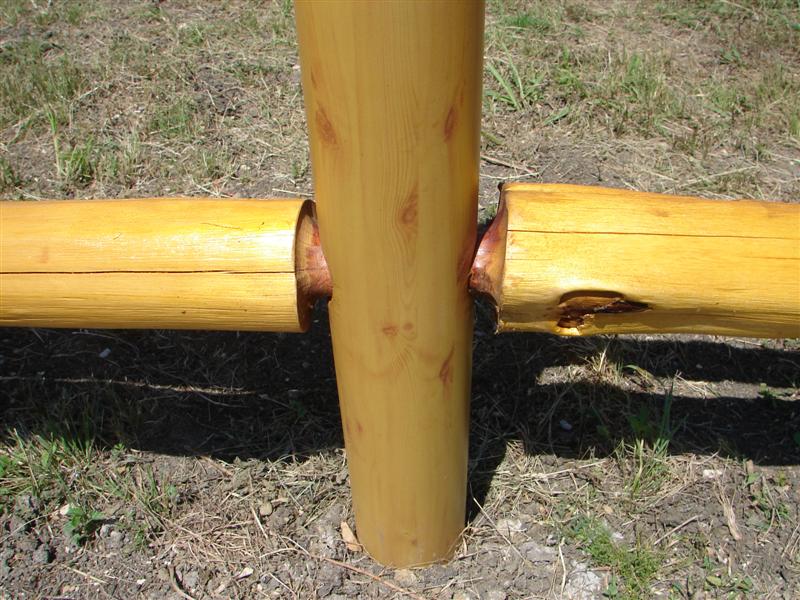

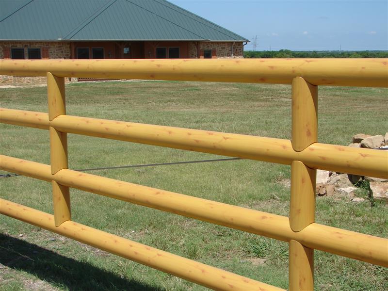

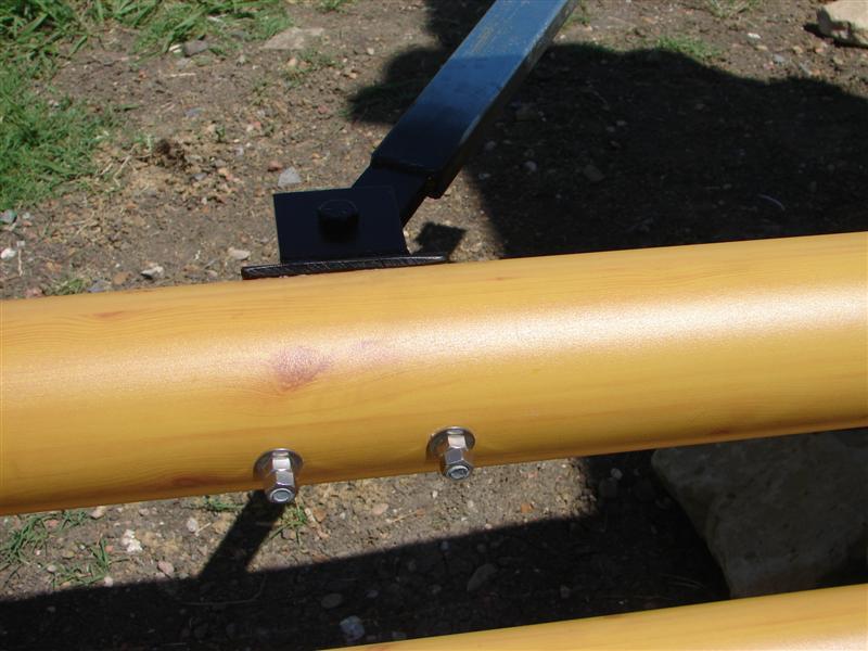

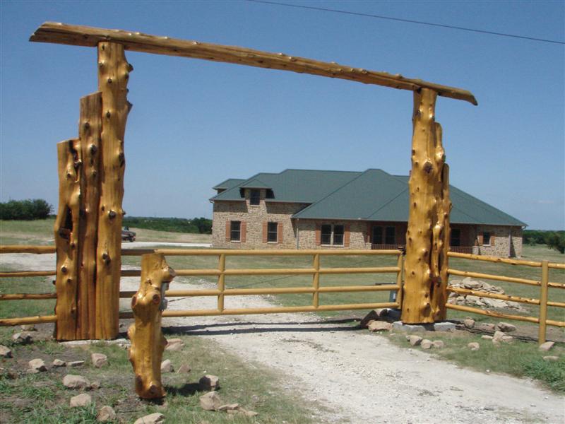

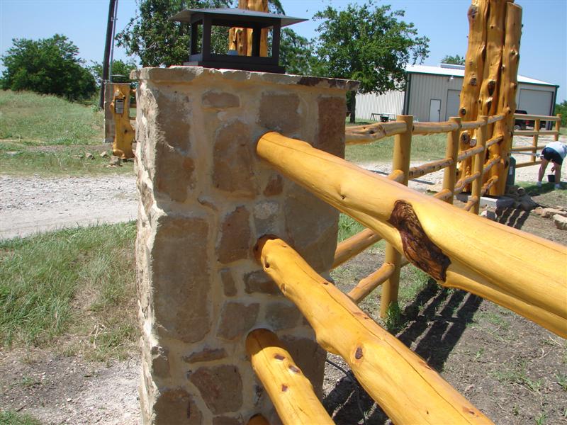

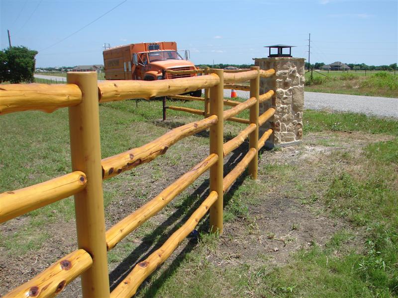

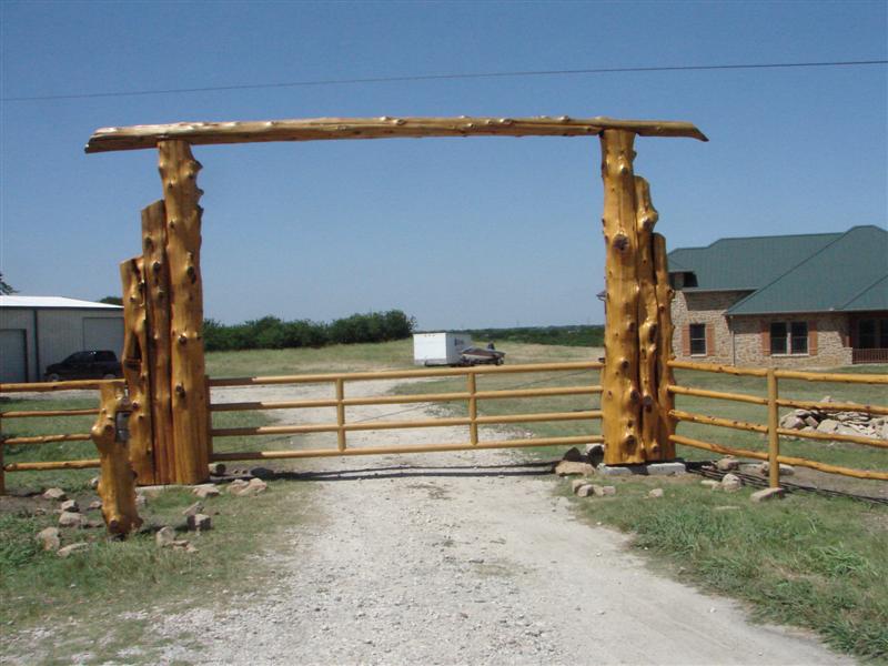

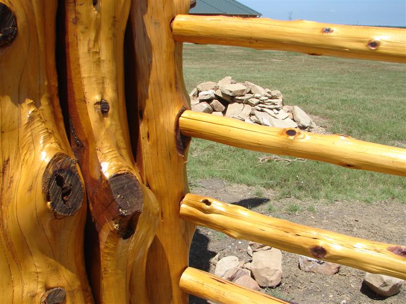

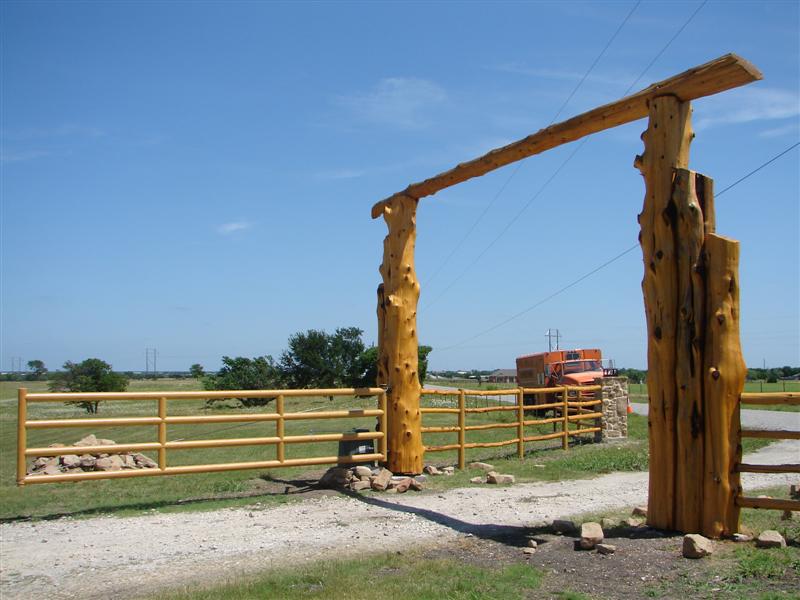

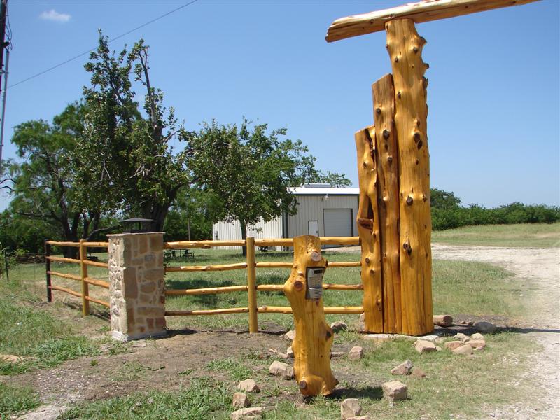

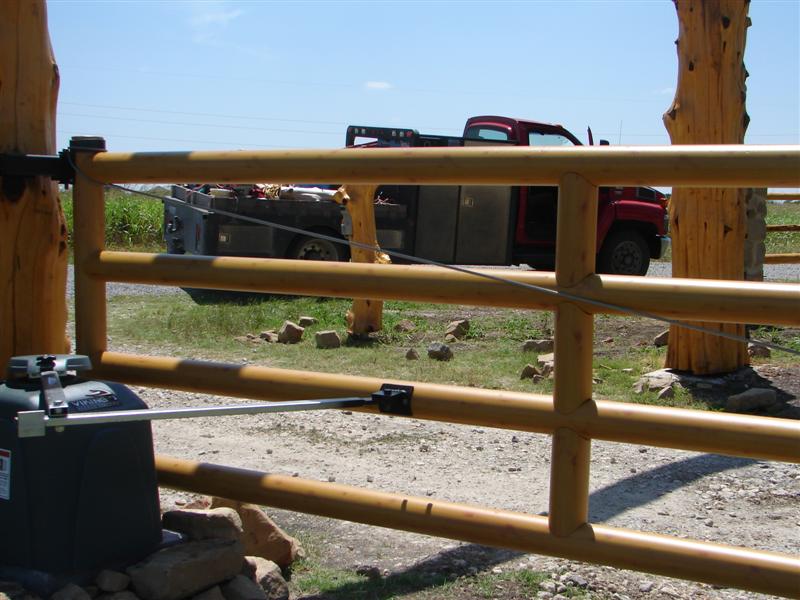

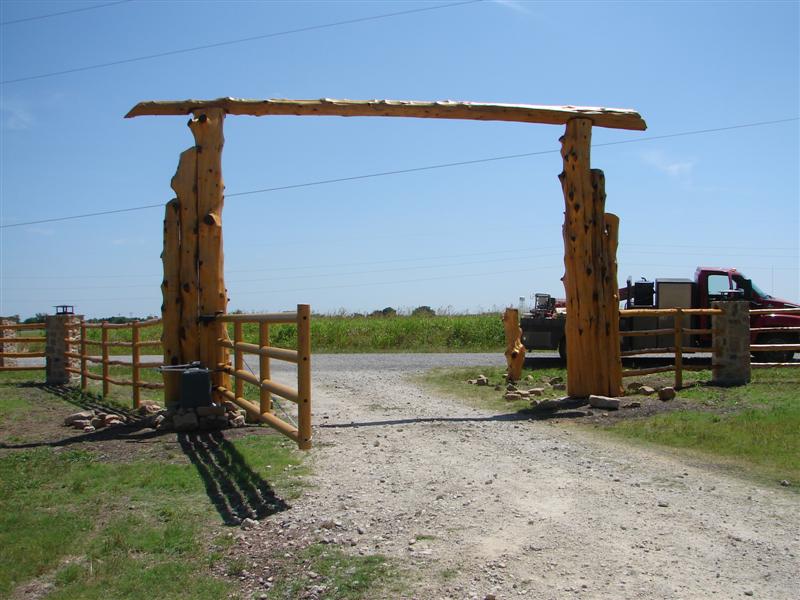

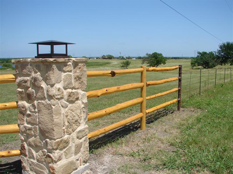

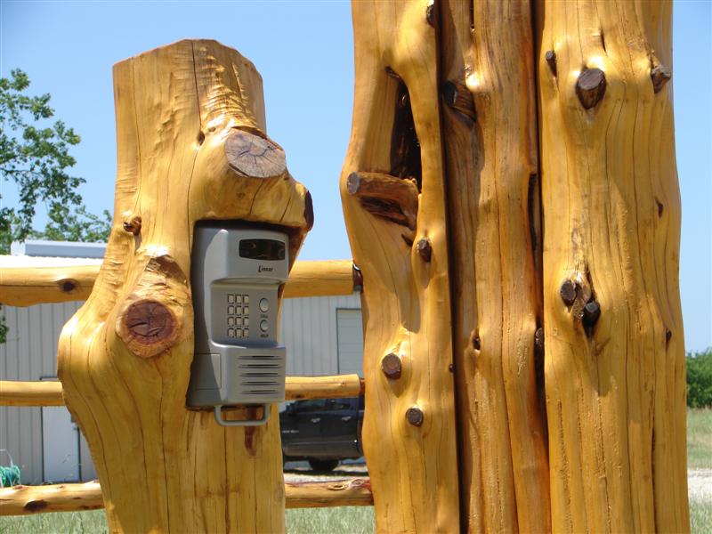

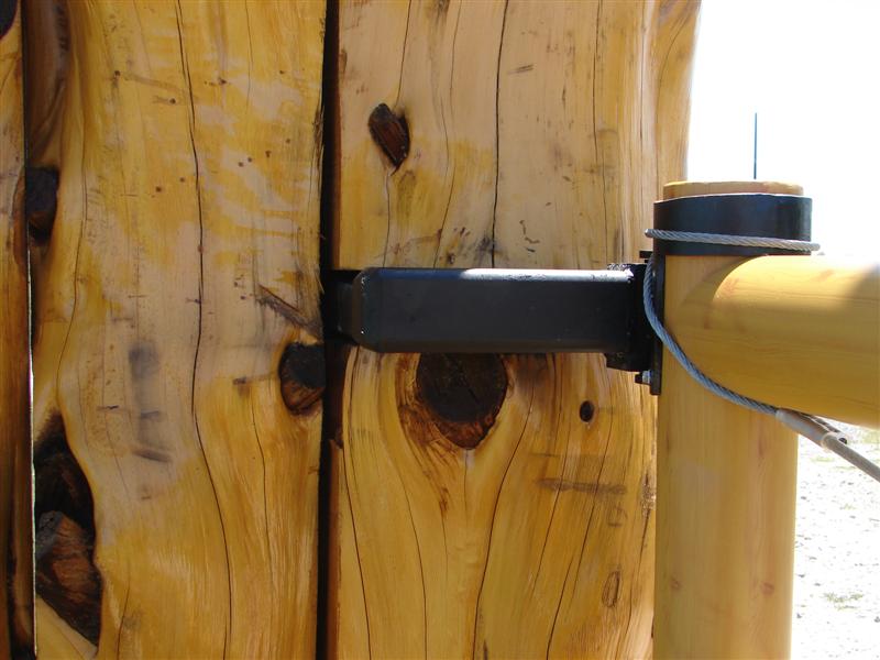

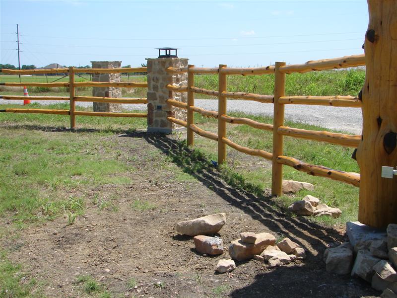

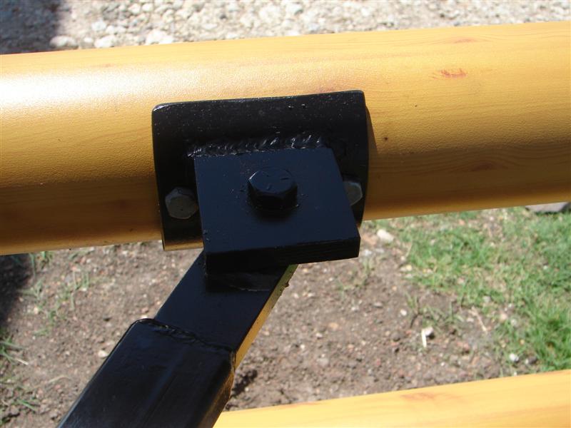

All good things must come to an end. So it is with my first big timber entryway.
Saturday we brushed on one coat of Penofin Red Label. Wood Finish Many thanks to Tina Nelson at Penofin for her help not only with deciding the right product, but locating the best vendor. One of the advantages I had with her was this thread. She was able to see exactly what I was doing and I think she liked it.
We added Bug Juice WW Environmental Bug Juice to the Penofin to give it some bite back for the carpenter bees.
Tina helped us with the color to match the powdercoated posts and gate. With one coat we were dead on. The second coat puts us off a shade in the wrong light. In the right light it's still dead on.

We (client, my wife, and me) brushed on the stain. Maybe it's just me being selfish but after hand picking the trees, cutting them down, hauling them out, powerwashing off the bark, sawing, fitting, assembling, all of it hands on, I just couldn't see spraying on the stain.
Here are some more pictures of the details.

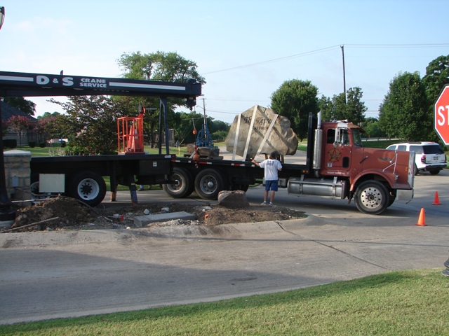

This is the project Bobby got to visit.
Typically when a rock sign like this is installed they fill a hole with concrete and stab a part of the rock in it. When the concrete is set up you are ready to go.
What I did was build a footer with steel plates tied to the rebar going into the piers.
I drilled holes into the bottom of the rock and mounted plates to it. These were big holes and substantial plates. In fact the sign, all forty five hundred pounds of it, rode over to the job site from the stone yard on the plates.
The crane placed the sign on the plates in the footer and I welded it up. I carved out the backs sides of smaller stones to hide my plates. When I was done the landscapers made it all pretty.
