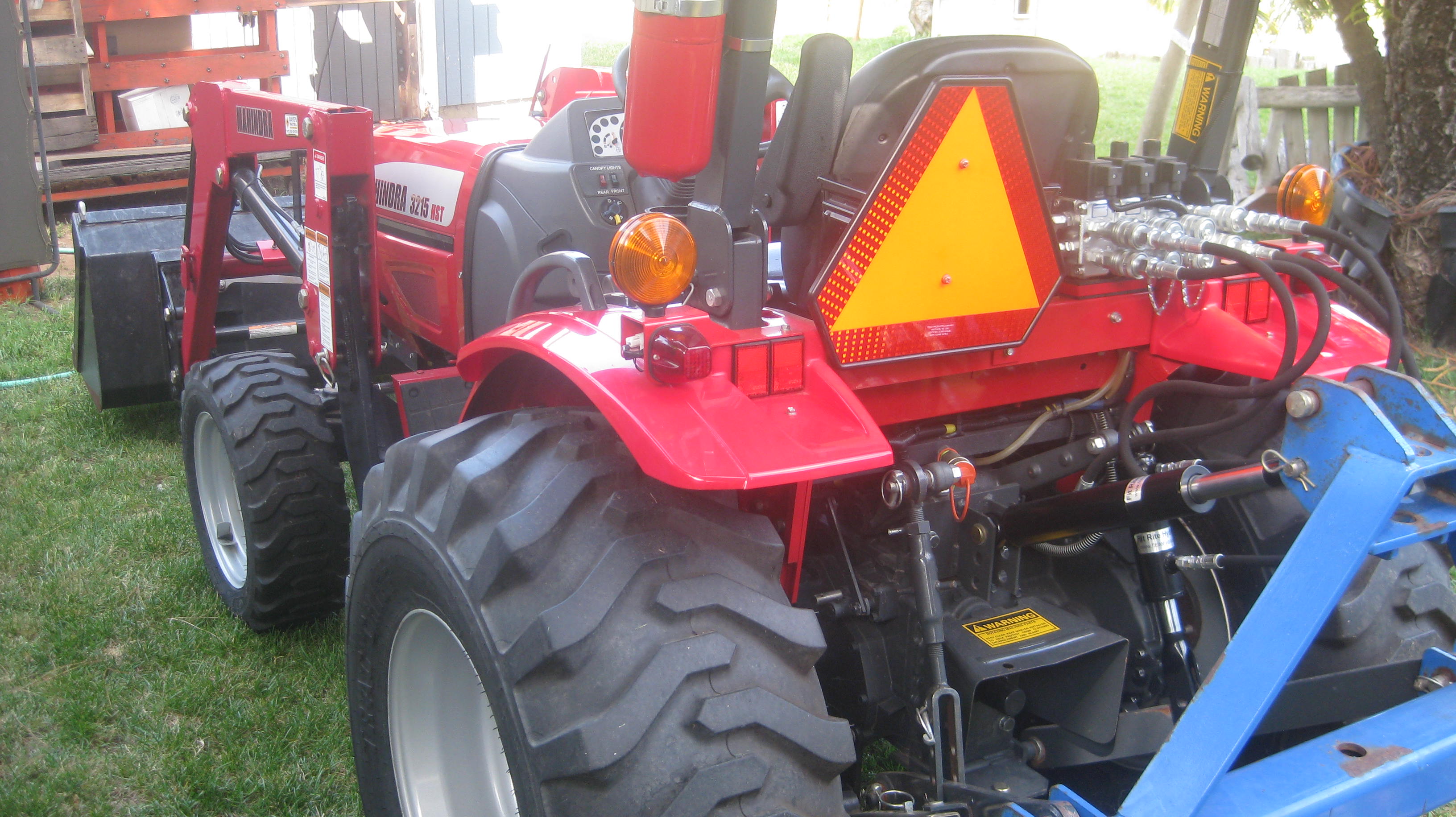

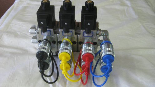

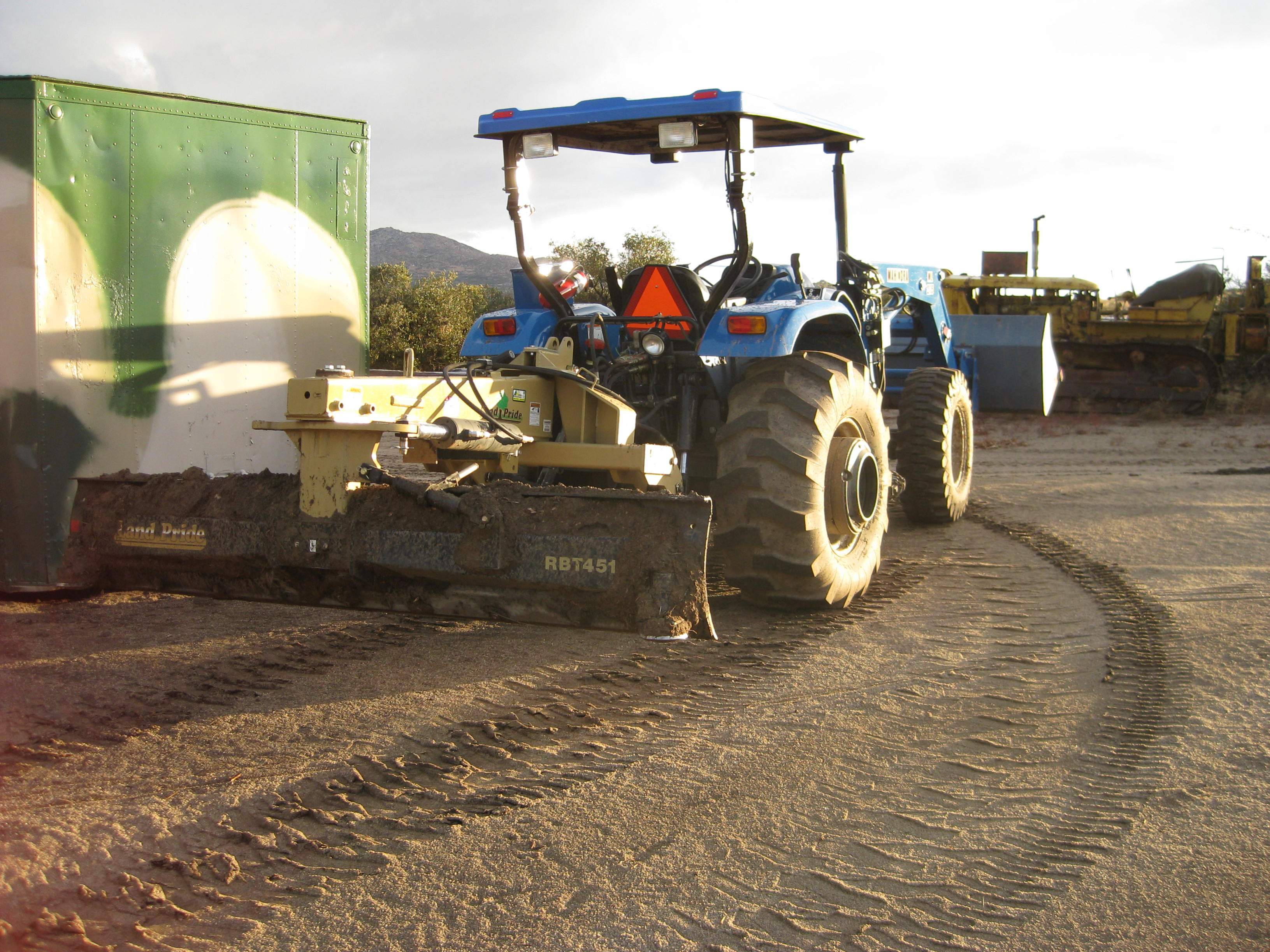

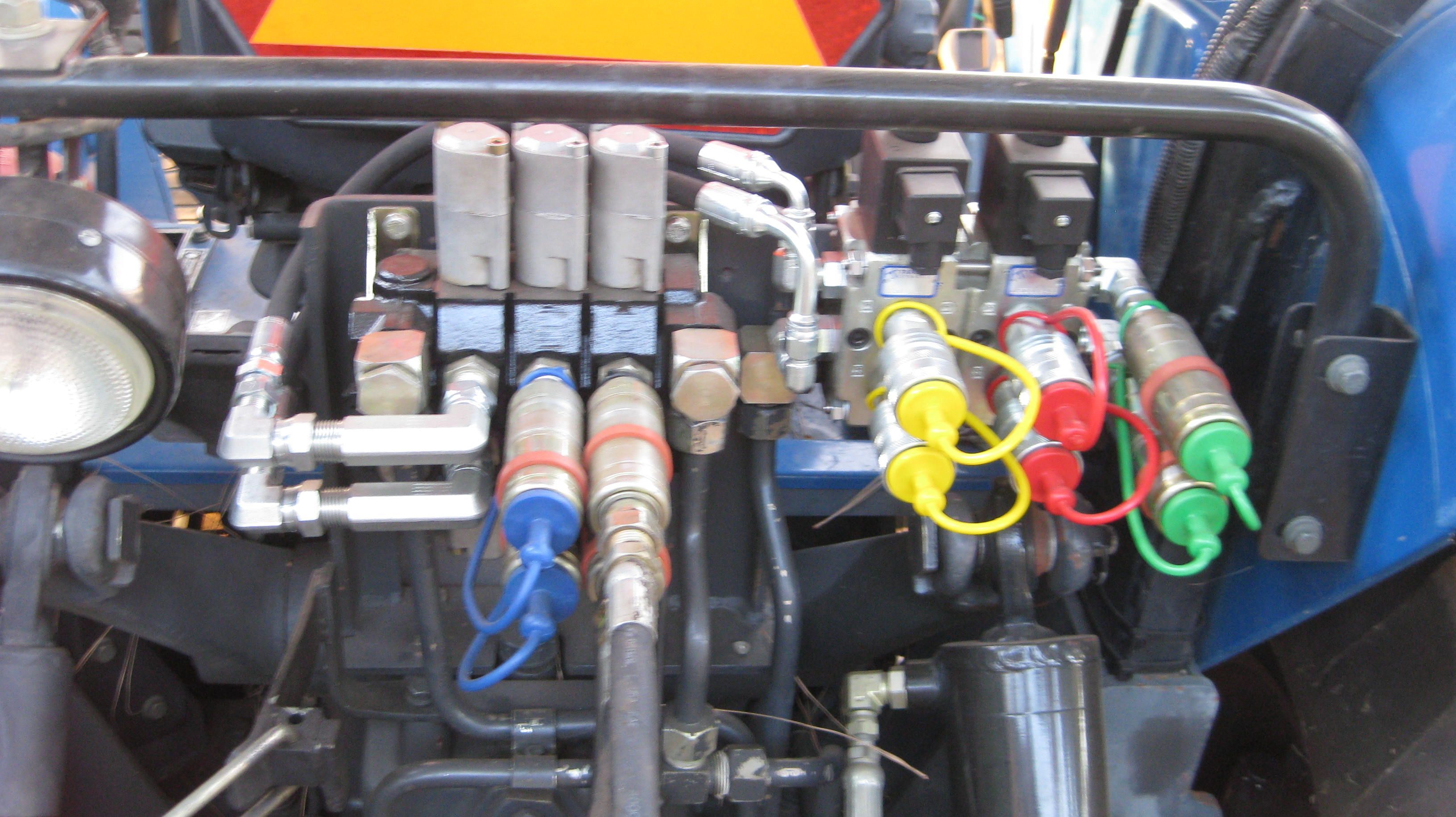

Is your to be hydraulic rear blade your only attachment that needs to be adjusted? If you put a top & tilt set on the tractor, you then have front-back and left right tilt capabilities for every implement that you use. Get the rear blade with hydraulic actuation for blade angle and offset and now you need 4 separate sets of outlets. You won't need the blade tilt capabilities to be hydraulic because you can do that with the top & tilt set for the 3pt hitch.
I have 5 sets of rear remotes on my larger utility tractor and 4 sets on my smaller (clean-up tractor).
Put a triple diverter set on your tractor and you should be set for pretty much everything. :thumbsup:
I've had a couple of customers that needed 6 sets of rear outlets to be able to operate what they had, one of them even had a 3rd and 4th function for his loader for a total of 10 separate :eek: sets on his tractor. :cool:
