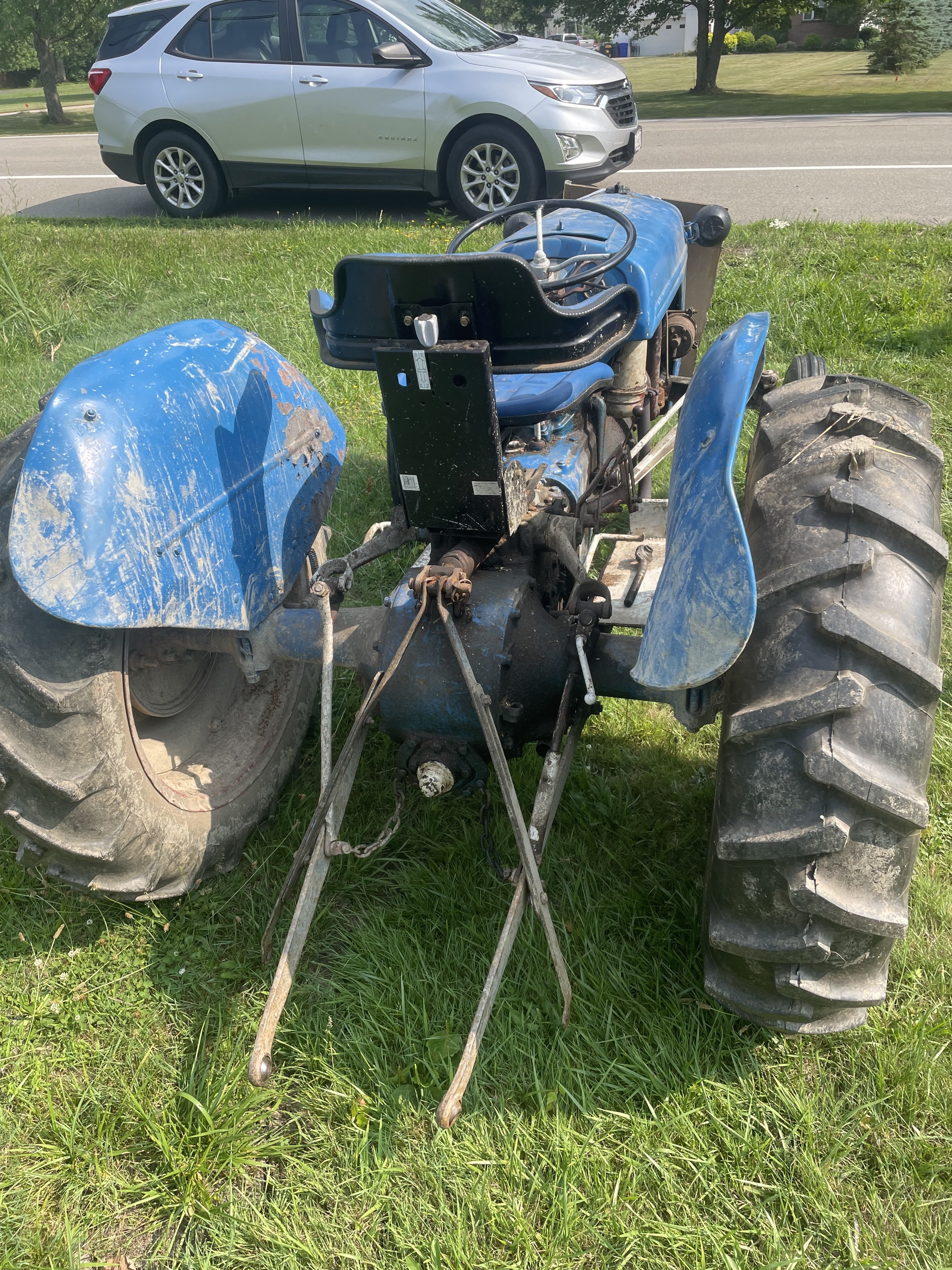

I drove by the 9n for sale, on my way home from work, a couple days ago. The price on it was marked $ 100 more than I sold my non-running 8n for, plus “or BO”.
If it runs ok, the hydraulics work, and it’s been converted to 12 volts, I’ll offer $ 100 less than I sold my non-running 8n for. Lots of “ifs” there, so it most likely won’t happen. There’s always a chance though. It sure would be nice for planting corn, and some of the other “odd jobs”, so that I don’t have to keep taking the bushhog off of my Deere.

Very much so. It has both original top link adjustable side brackets with it, that can be used to hold the position for a mower or bushhog, and it also has the original pto cover on it.
I also like the blue paint, comfortable newer Ford seat, and low reverse gear that the 9n’s had. That will be nice for moving material around, scooping in reverse, with my pond scoop.
My 2 row cultivator and planter have separate depth control on them, and the carryall pretty much works only full up or full down. I see no problems with the lack of position control on the 9n.
I still won’t buy it unless it starts and runs ok though. All the tires hold air and the back right looks like new.

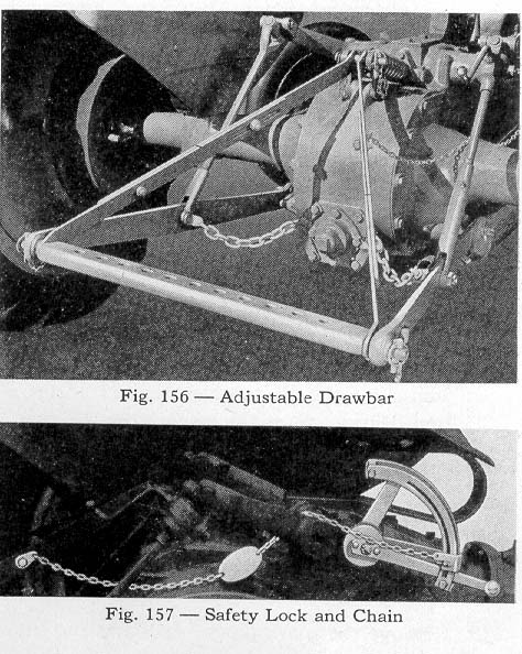

Those side brackets are not intended to hold an implement at a certain height. They are called drawbar stays and are there to be used with a cross drawbar to keep it from rising up.

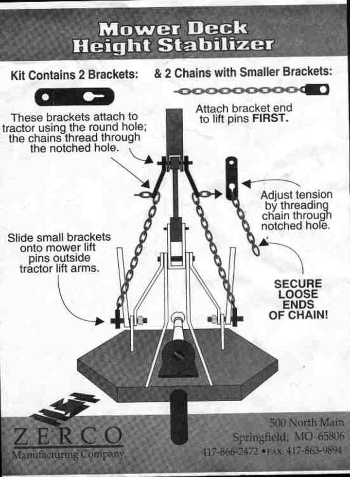

You can use limiter chains to keep your mowers, or any other equipment, at a set height. They also allow you to raise the mower, set the limiter chains to hold that height, and turn off your PTO so you don't have the blades turning as you return to the barn.

Assuming I get it, I doubt I’ll ever use any pto implement on it. If I need to, I’ll try making up some limiter chains, and definitely get an overrunning coupler. It looks like they can still be had for $ 75, which is about what I paid for the one for my 8n about 30 years ago.
Like I mentioned, I’ll mostly be using it on the corn planter, cultivator, and carryall, none of which will miss the lack of hydraulic positions control, like the 8n had.
