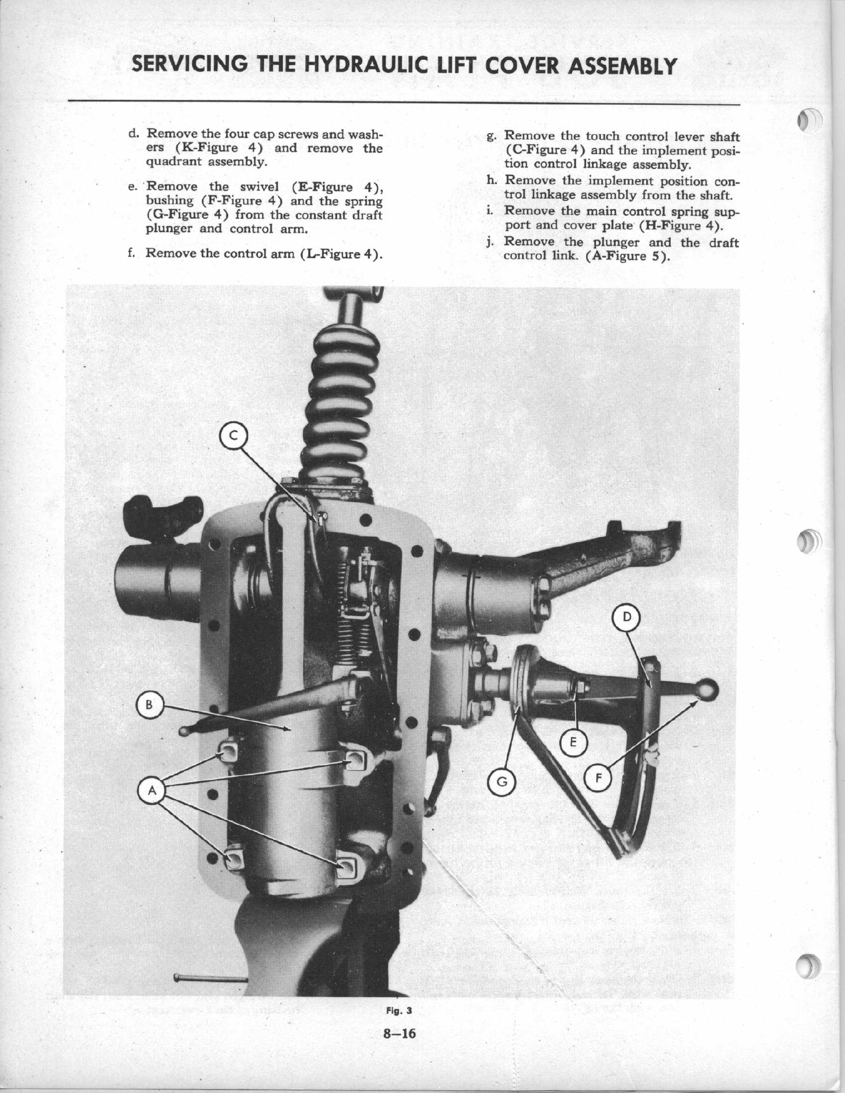

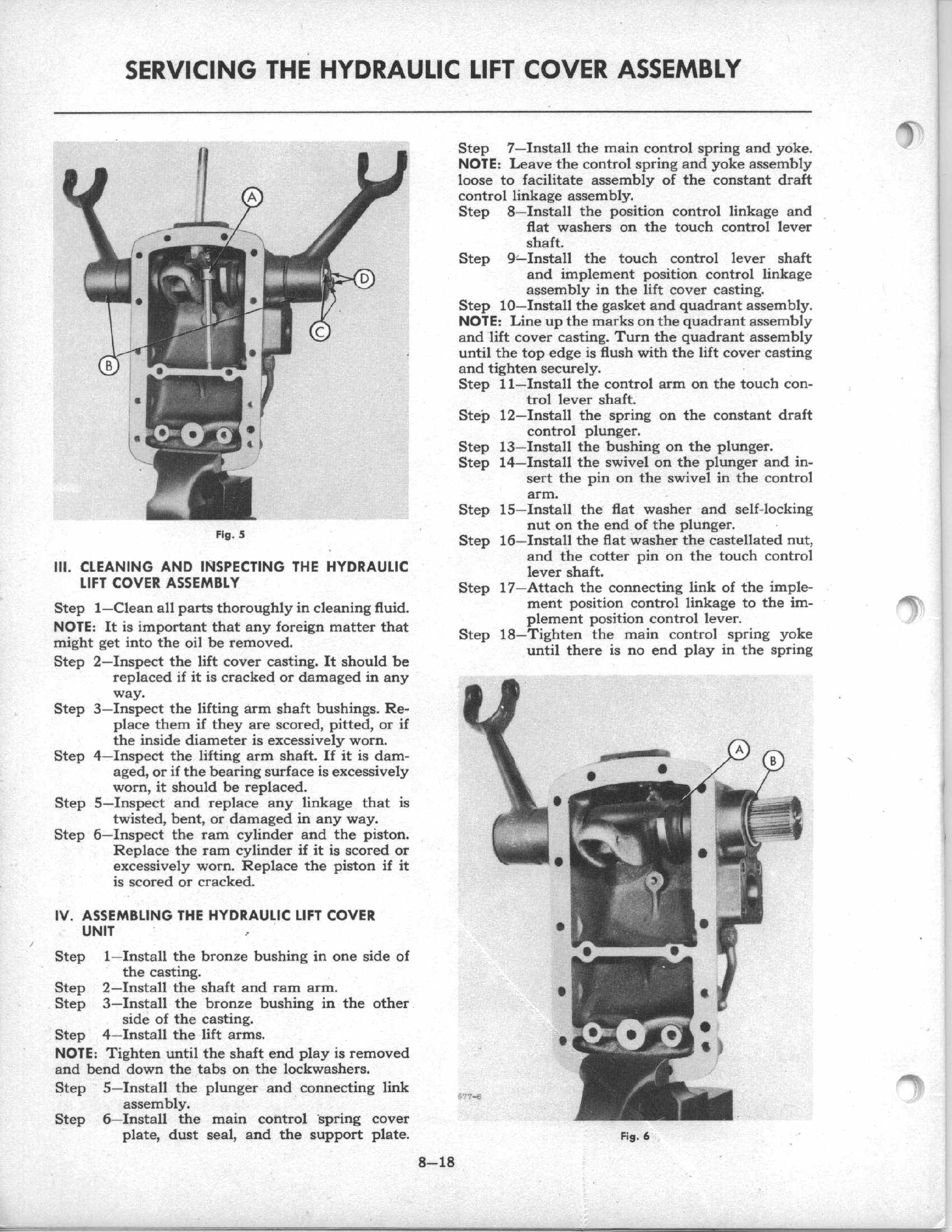

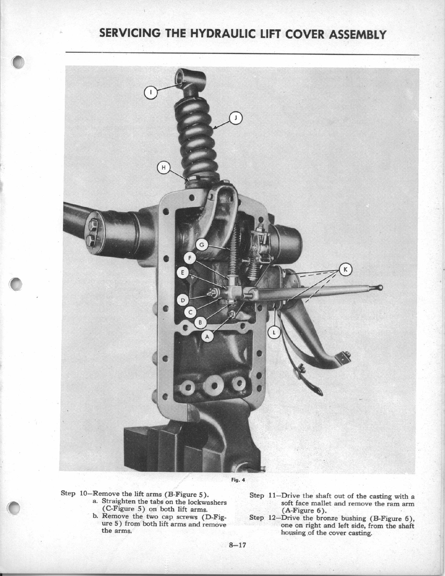

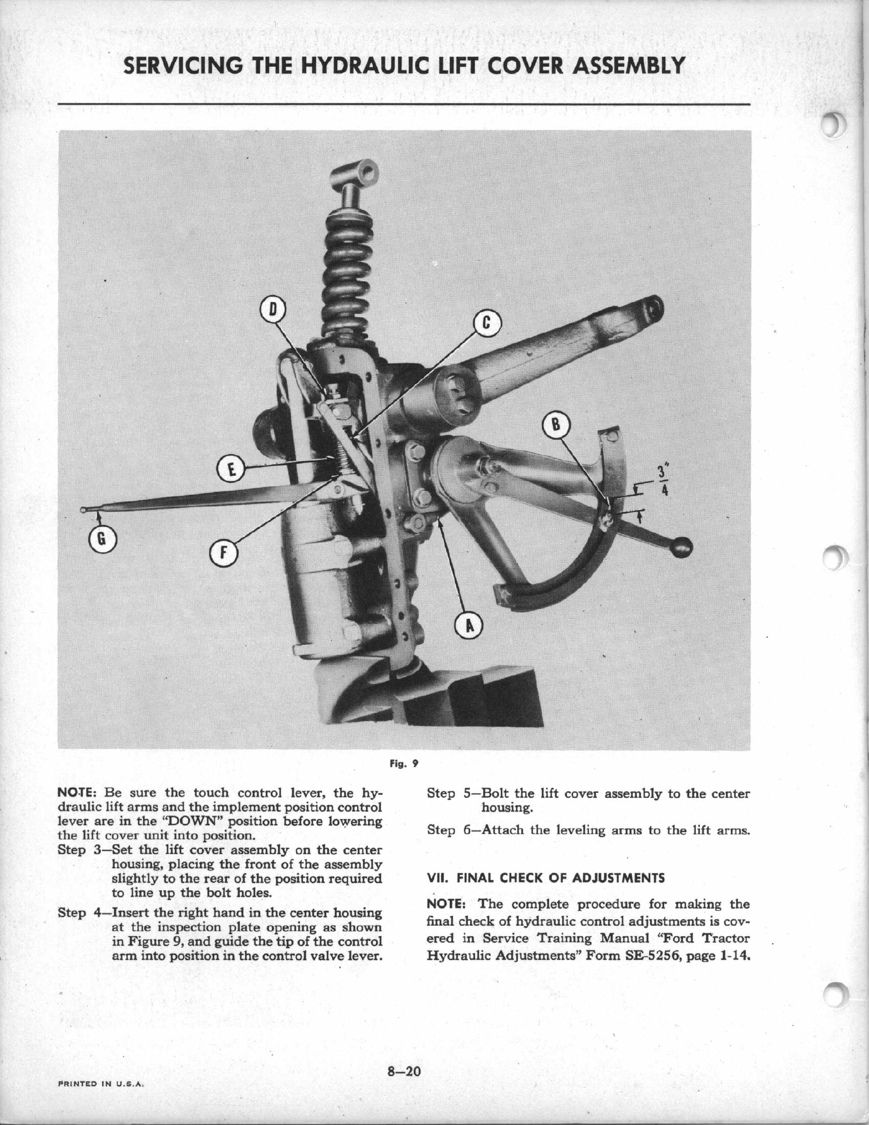

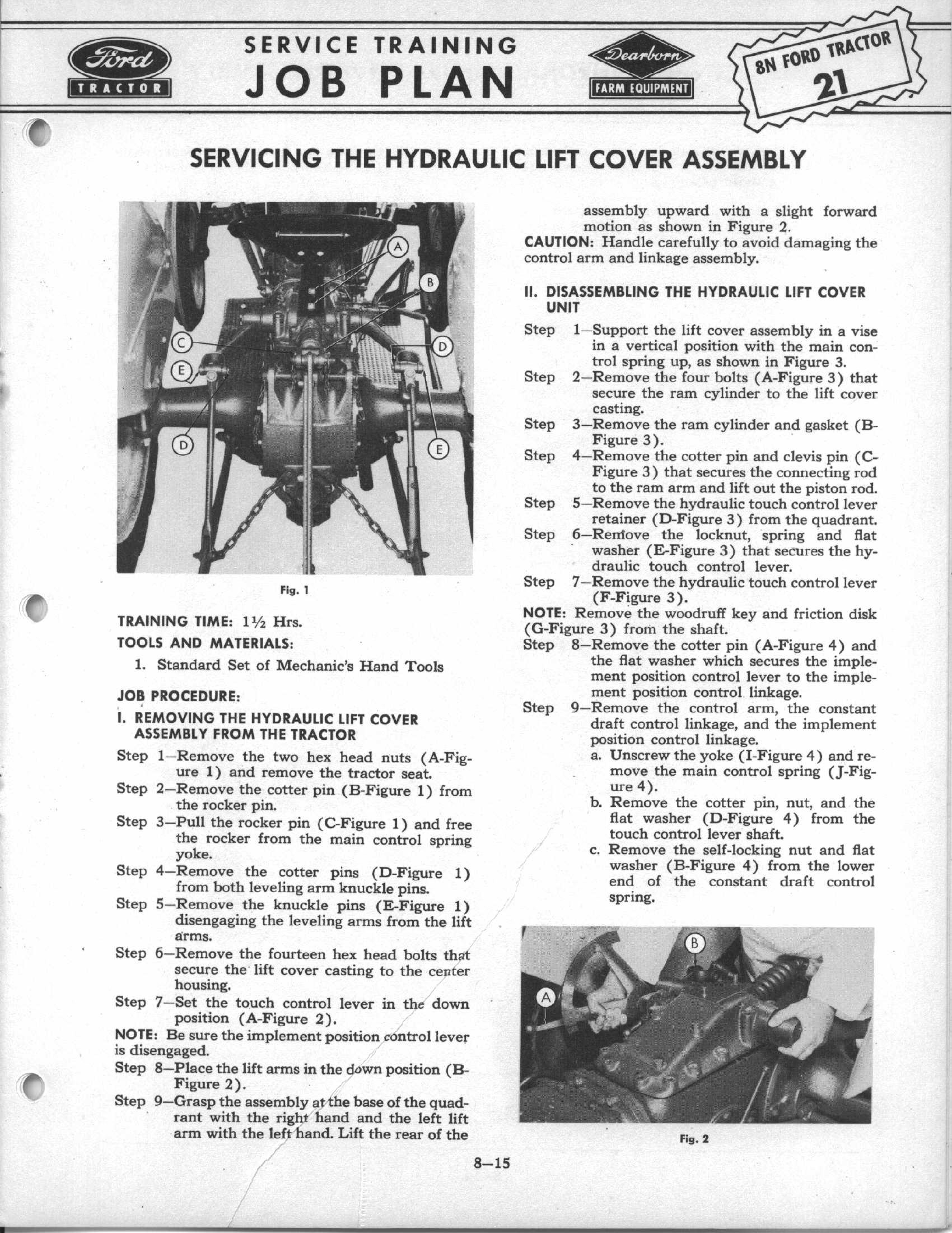

You only use the top hole for light cultivation tasks. He obviously has hosed the draft control linkage up by doing that. A chain hoist/cherry picker is nice, but one reasonably strong man can handle it easily. You may need a BF pry bar to break the cover loose once you remove the bolts.

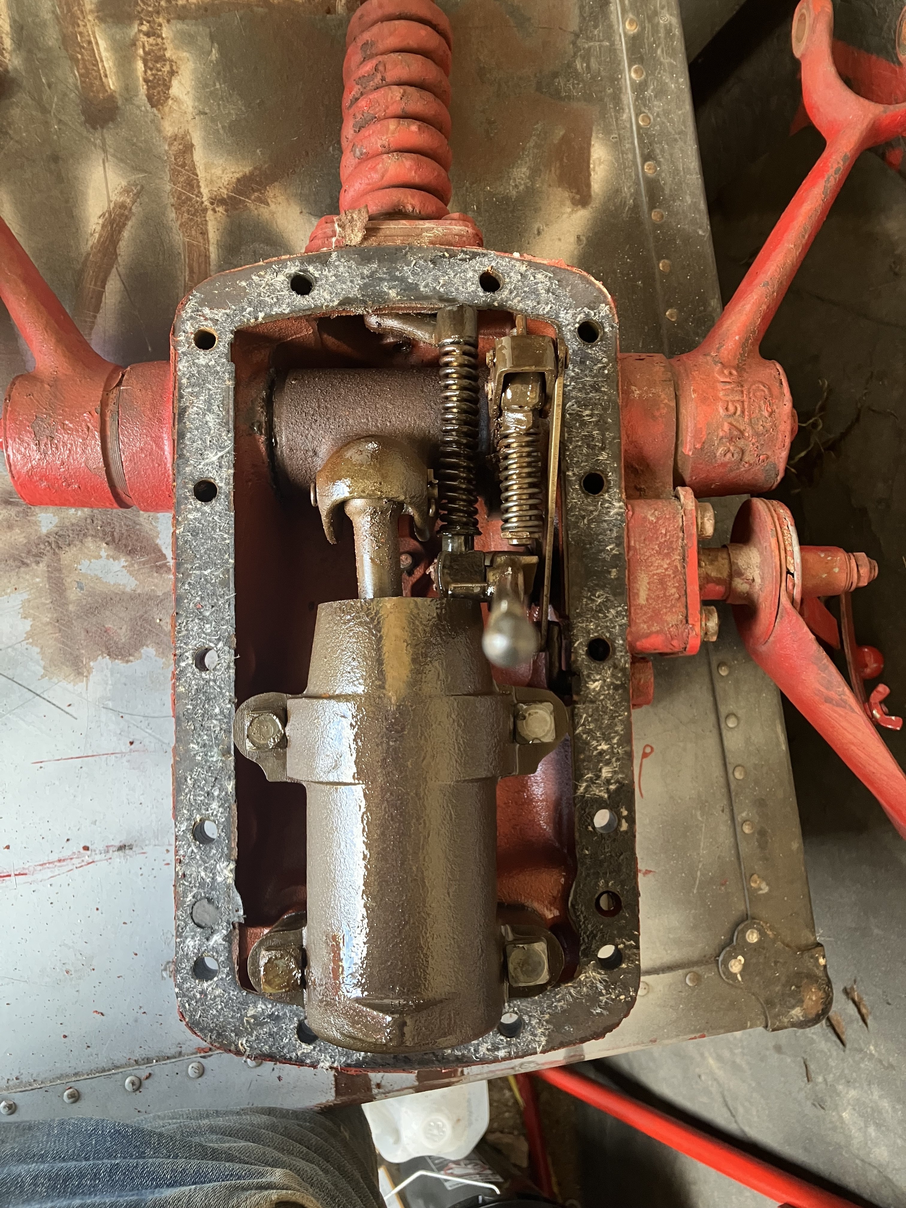

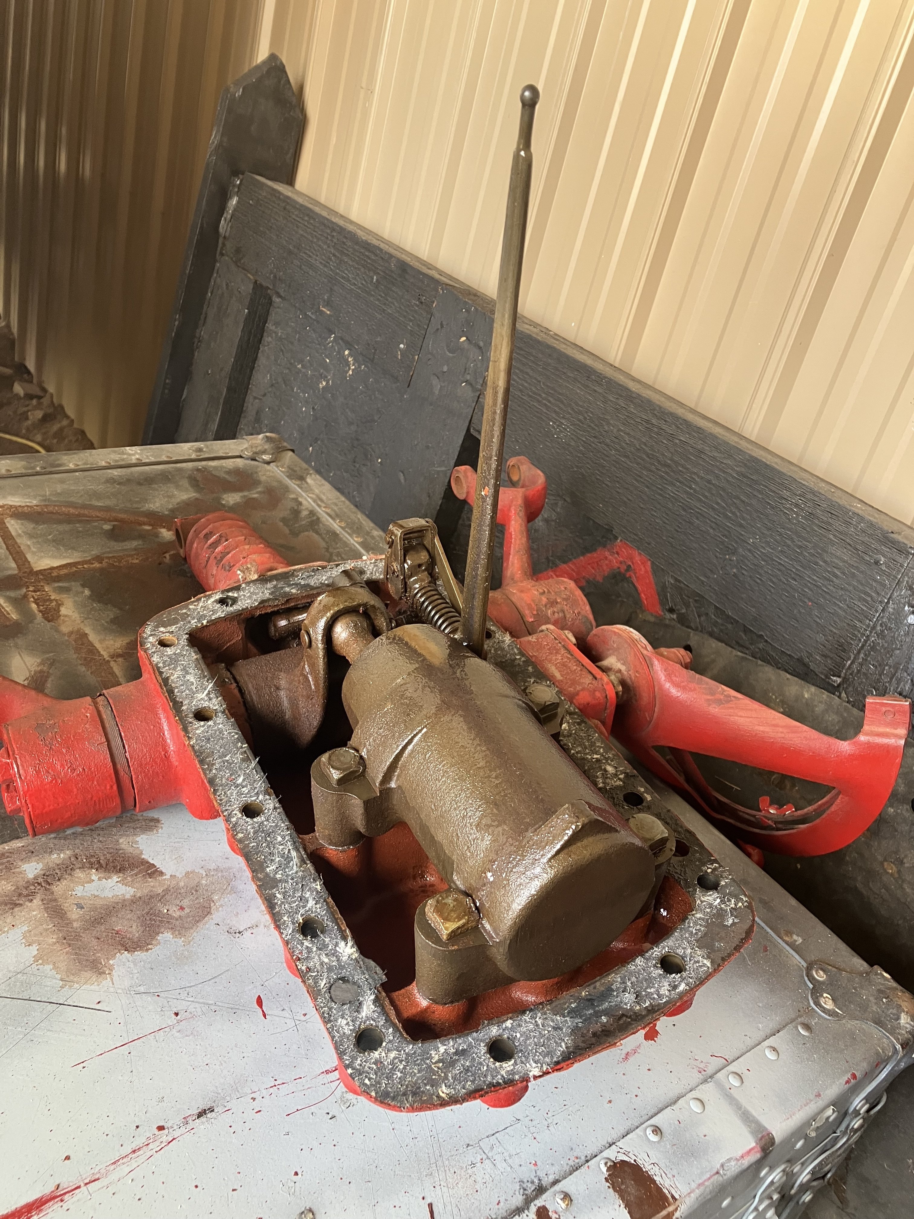

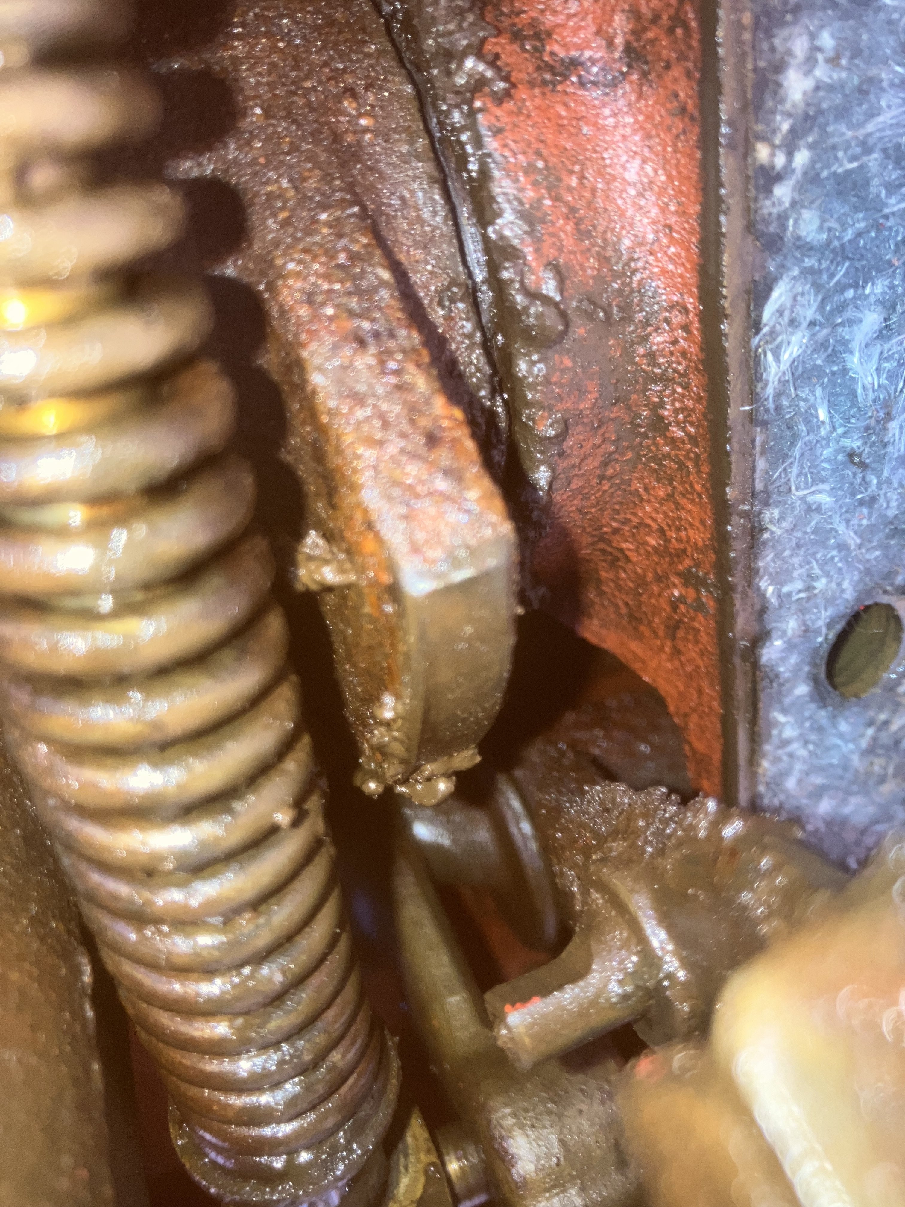

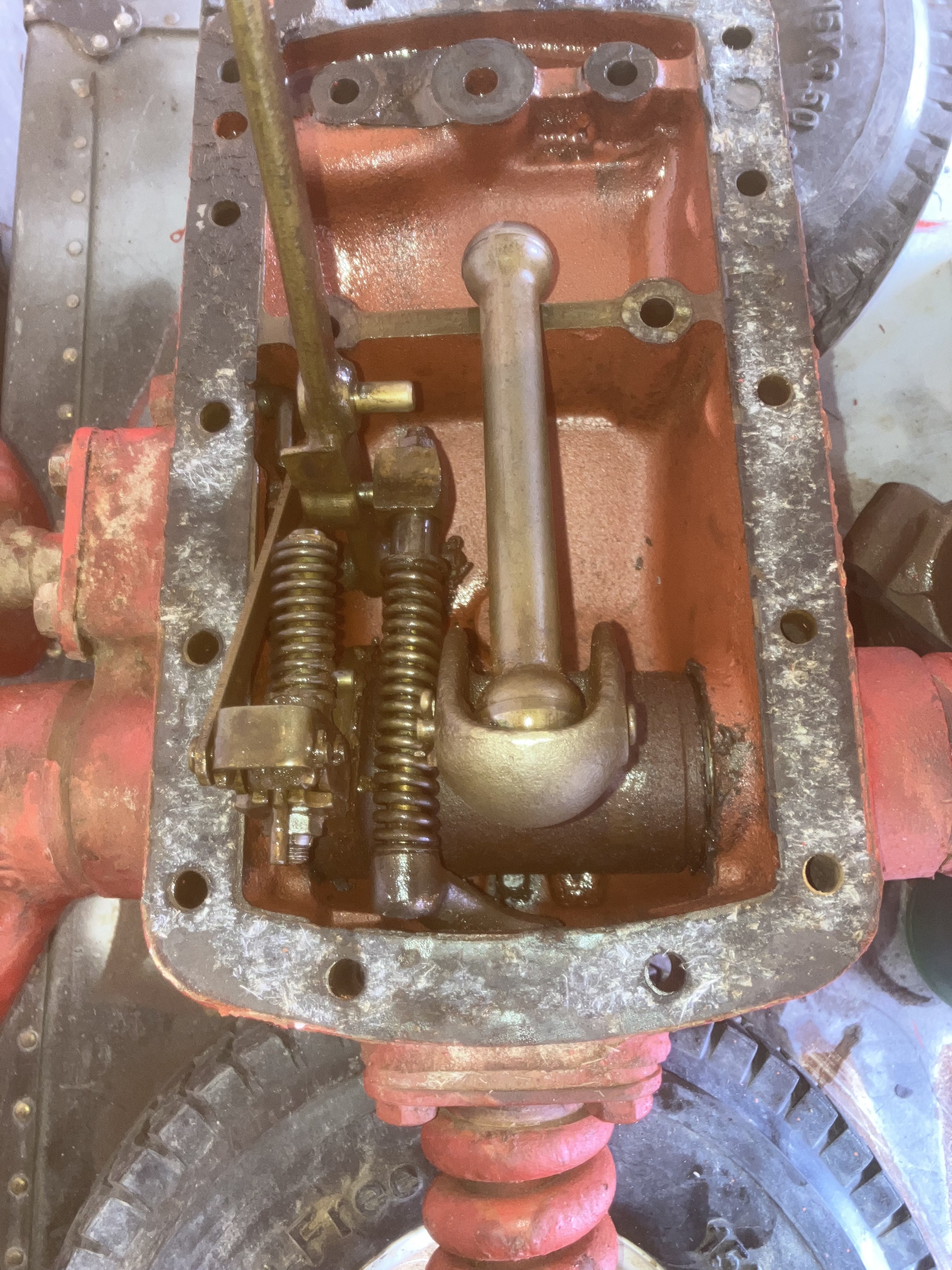

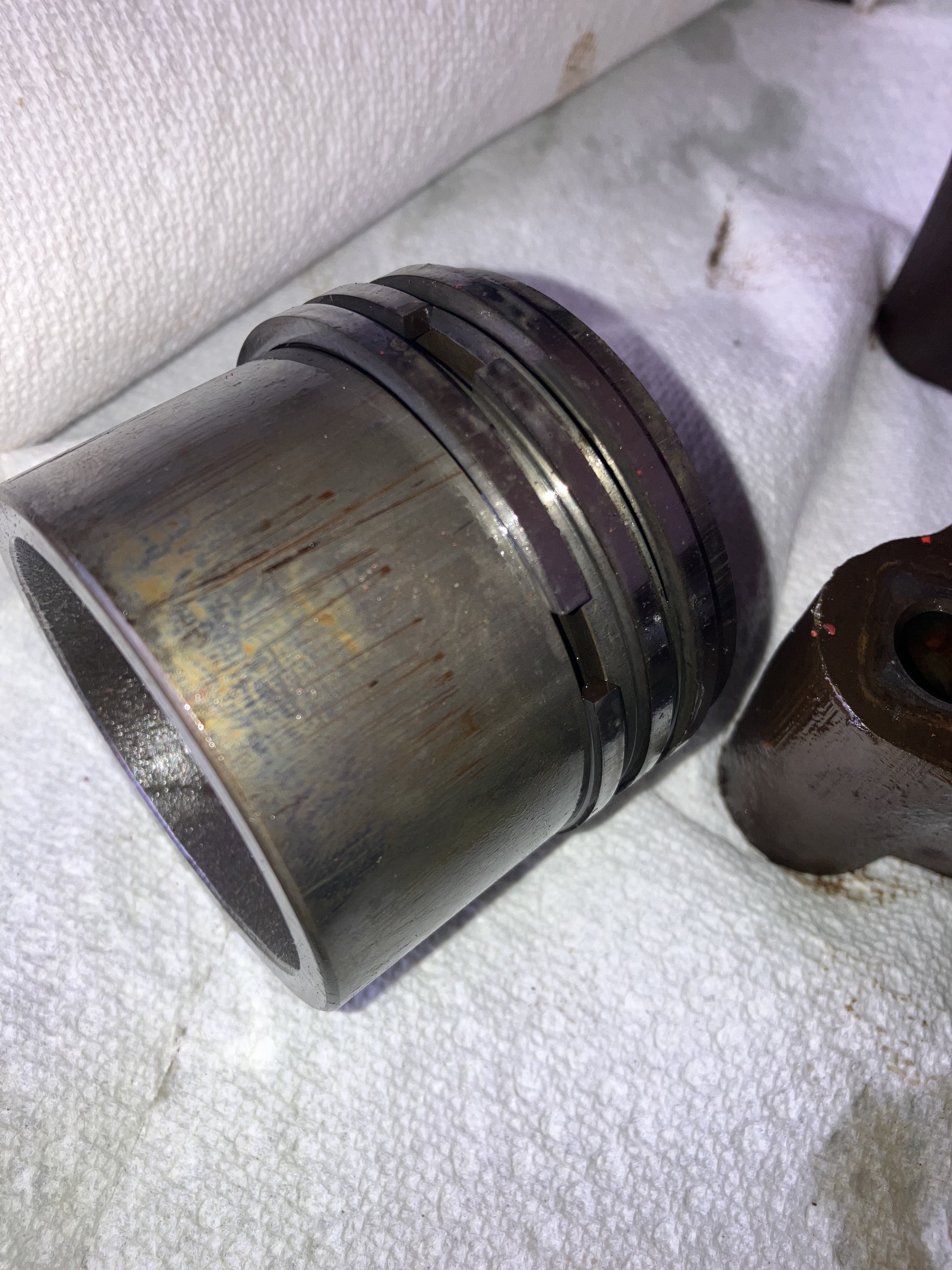

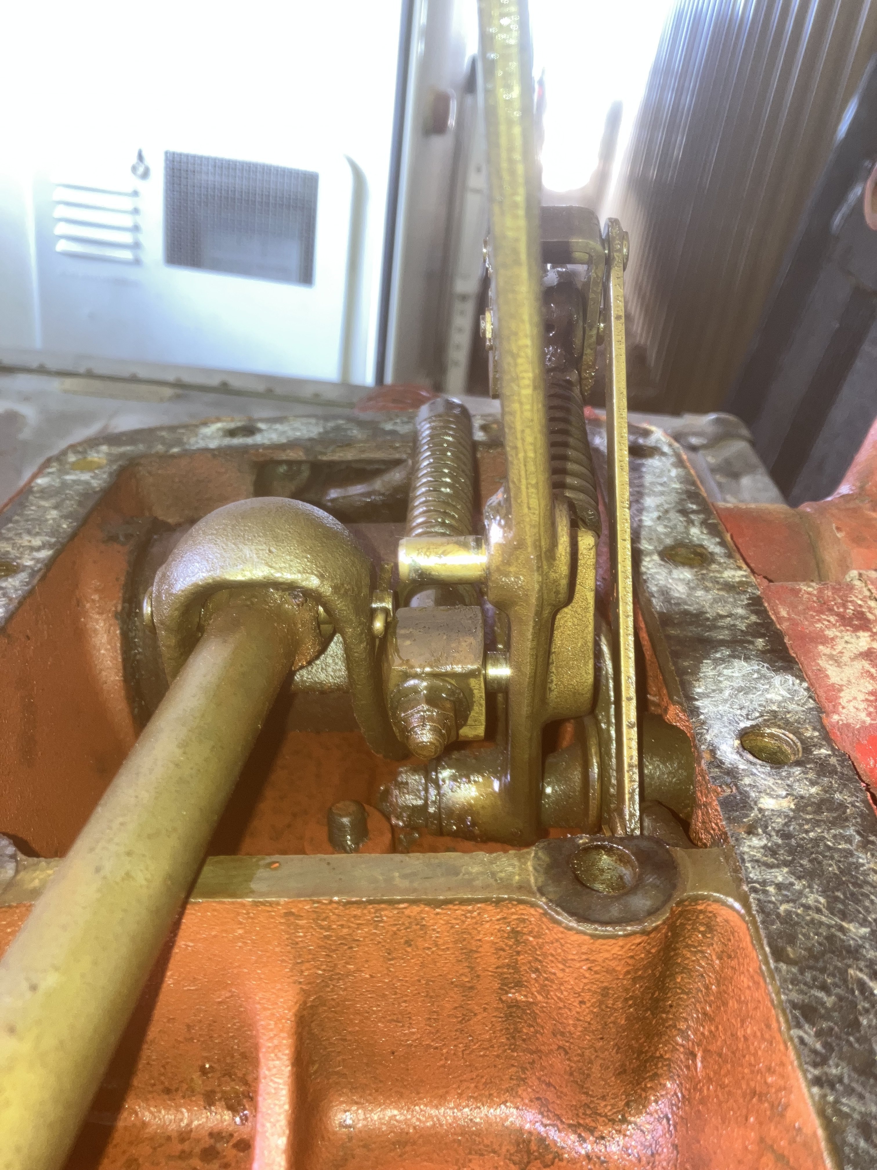

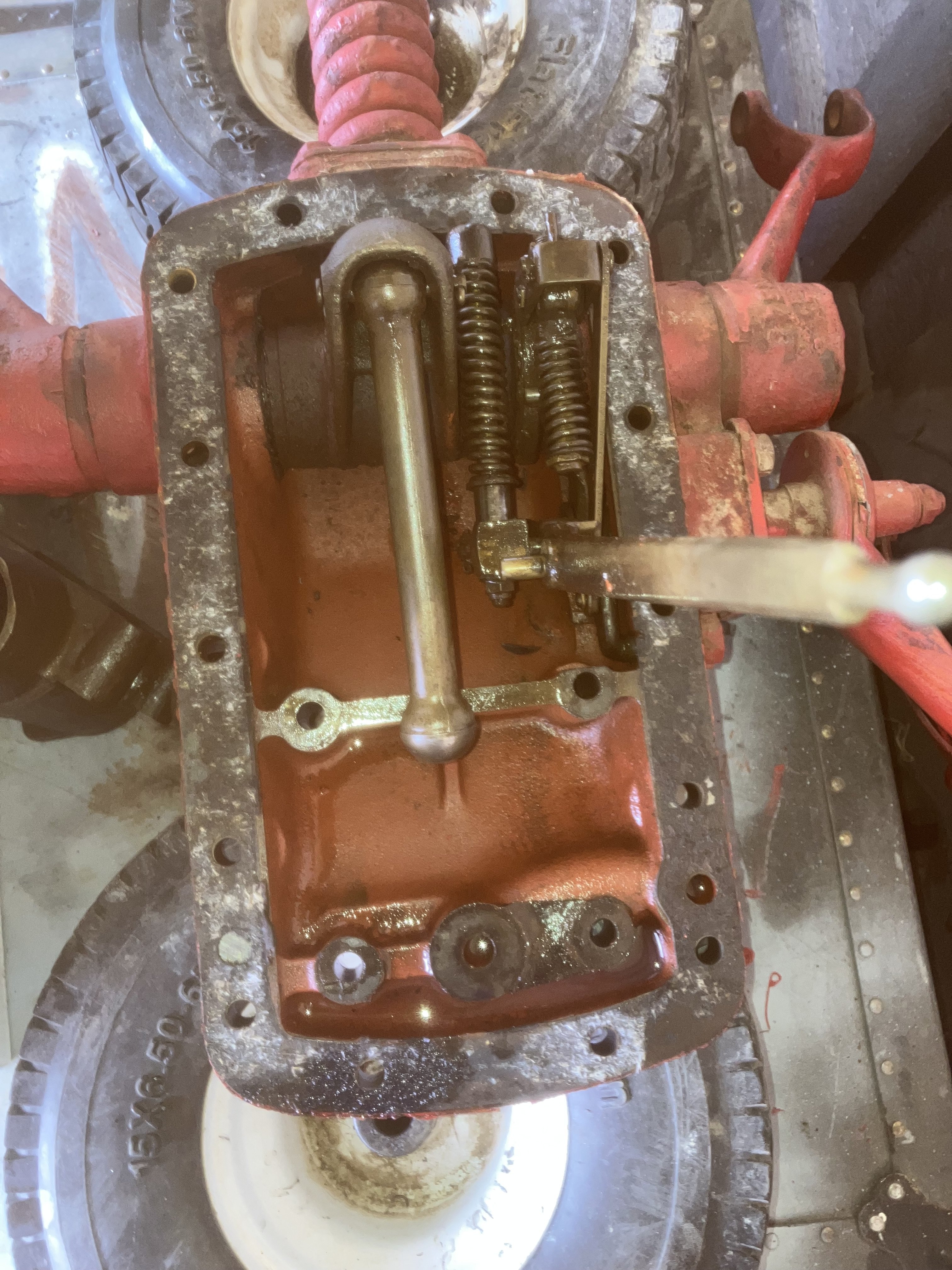

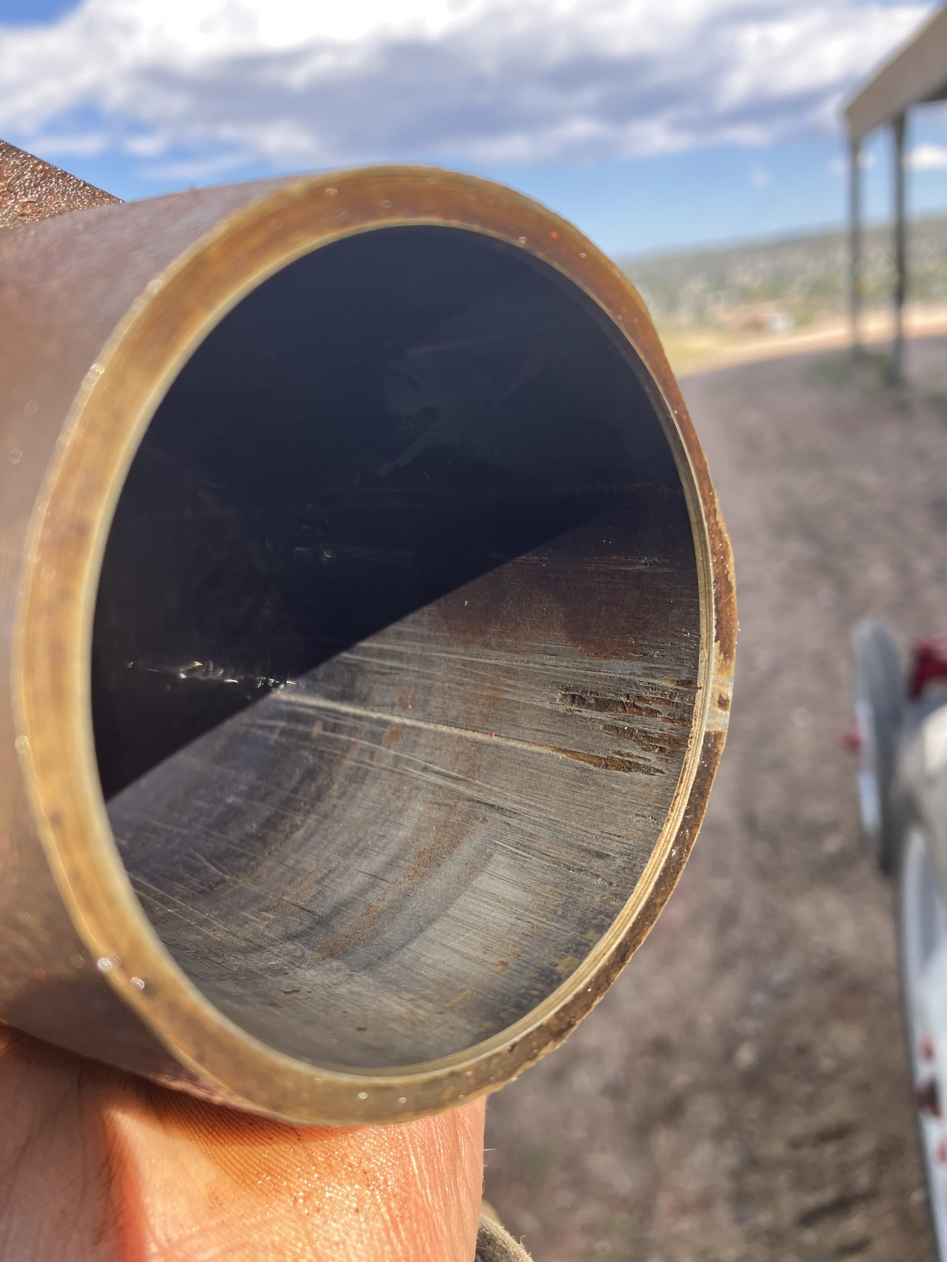

I got the top cover off today, and got a good look at the internals. I disassembled the cylinder/piston, following Rachel’s video and the Ford Tractor mechanic instructions. My piston and cylinder are both very badly scoured and will need to be replaced. I didn’t see any obviously bent or broken linkages, and the cam follower pin, while worn, wasn’t as bad as I thought it would be. I’ve attached some photos below- maybe I missed something. I’ve never had an 8N apart before, so I’m learning as I go.
I tried to remove the draft control spring, but I don’t think my little handheld plumbing torch could get it hot enough to free up. I stopped trying for fear of breaking something. It’s currently soaking in some penetrating oil. Do I need to remove the spring to be sure the linkages are intact?
I’ll plan to order a master rebuild kit, along with a cam follower pin and the adjuster jig from Just8Ns.

Update: got my top cover reassembled yesterday, and everything is working like it should. I now have 32” of lift height at the end of the arms. Thanks again for sharing the Ford Tractor mechanic instructions, Ed.
