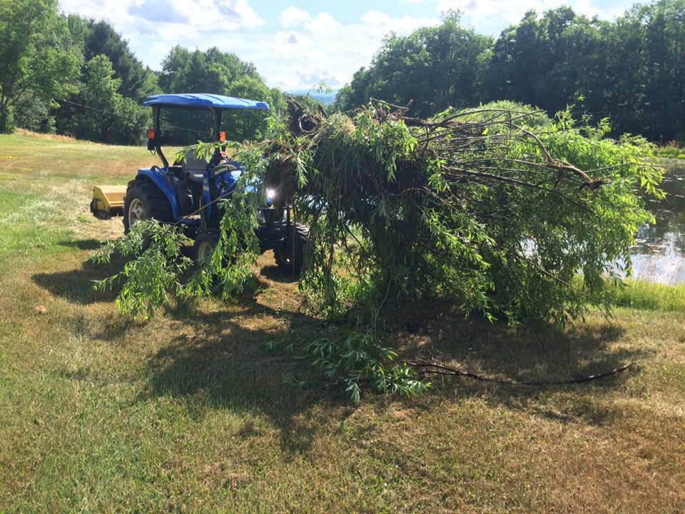

What do you have on the back of that machine in the second photo? looking like a flail. Which model ?
Still loving my grapple from you guys!!!!
It is a customer submitted photo, so I do not know any specifics, but it definitely looks like a flail mower.
I'm glad you like your Wicked Grapple. Rock on!!
Travis
/ The WICKED Root & Debris GRAPPLE!!!!!!! #1,432
Most likely a flail given the size and setting and what appear to be metal guards hanging in front. Second choice would be a tiller but I doubt it.

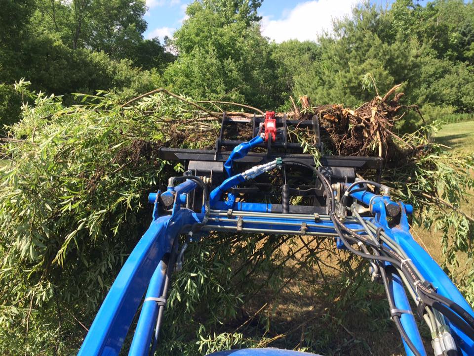

I thought I would have to use the backhoe to get this stump out, but the EA grapple just pulled it right out. The recent rains must have given me a hand.
/ The WICKED Root & Debris GRAPPLE!!!!!!! #1,439
Some sort of root rot on that tree if you pulled it out?
/ The WICKED Root & Debris GRAPPLE!!!!!!! #1,440
Agree. It's always a pleasant surprise when an old stump just surrenders without a fight. The other circumstance is when lateral roots have been ripped with BH ripper and there is a long enough section of trunk remaining to push the stump over before grabbing with the grapple.
