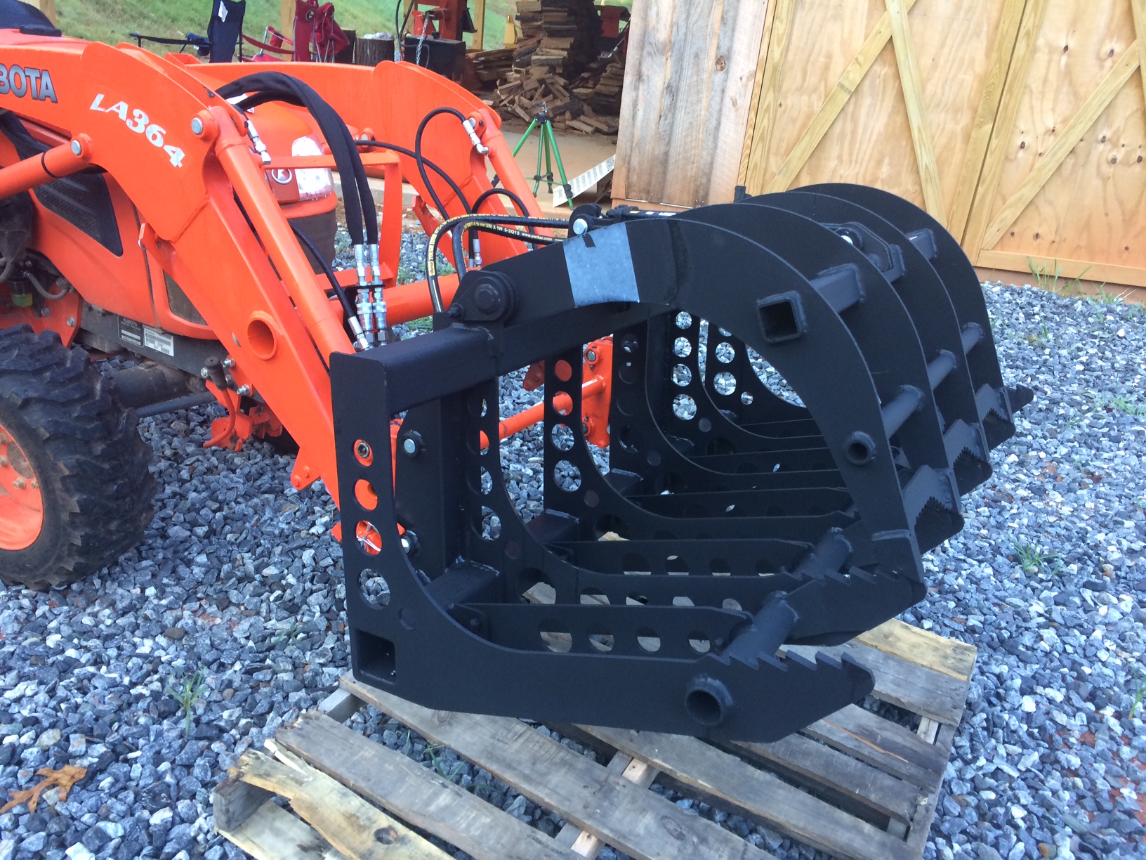

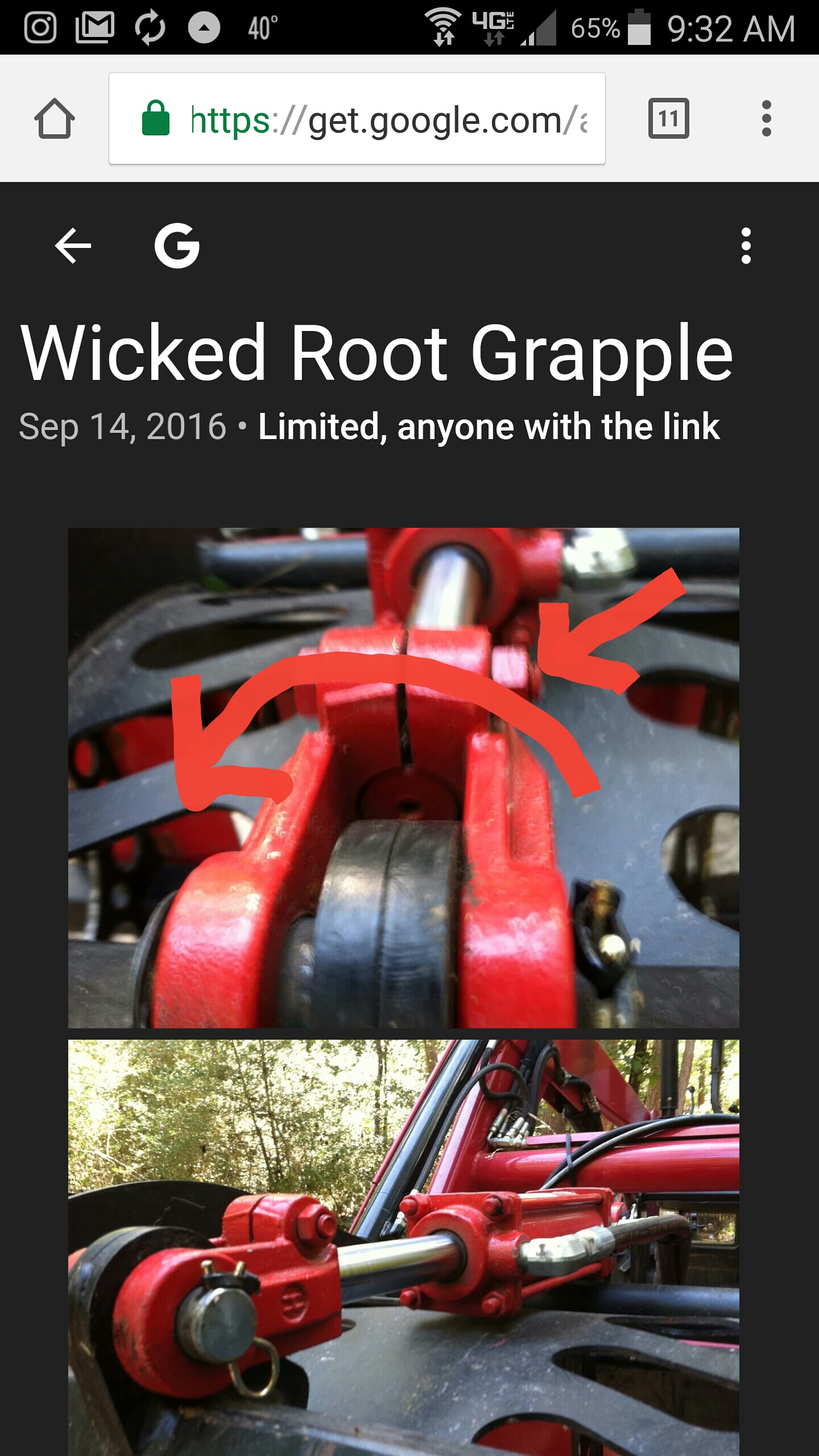

A small problem has come up with my grapple. The teeth no longer come together. EA looked into it and checked pictures I sent to them. Nothing is bent on the grapple. We restored the "bite" by chaining the lid shut and opening it four or five times, but now the teeth gap open again. Something must be wrong with the hydraulic cylinder.

Ted just sent me a PM and reminded me of a fix they had previously suggested.
Monday, we will adjust the rod end fitting and see if that solves the problem.

A simple adjustment should take care of the gap. I can't really explain why the cylinder would do this, but it has been an efficient fix. Out of 1000++ grapples, there's been maybe ~8-10 needing adjustment.
Just remove the pin that holds the cylinder to the lid, loosen the bolt(arrow pointing to it) and turn the clevis counter clockwise. It will not take much.

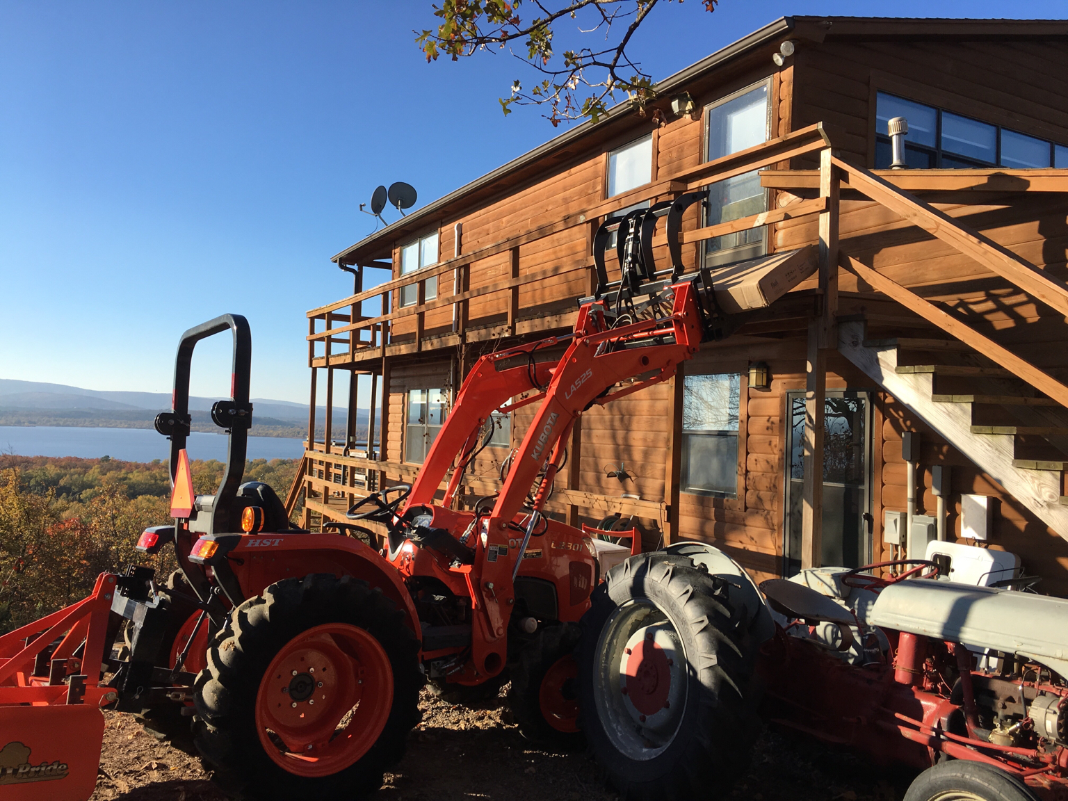

Mine did it also back in the first month. As soon as I said something wondering, Travis was all over it to let me know the adjustment procedure. Never have had to touch it since and finishing up first year with it. Great product and great company!
Using it this morning to set a new desk up to the 2nd story.

Wow, Lenny, your pics have the most amazing scenery!!
I like how the 8N is there for moral support. :laughing:

Okay, finally got around to adjusting the lid. Raised the grapple to a convenient height and closed the lid as much as possible. Loosened the nut on the clevis bolt with a 5/8 ths socket and closed end wrench. Removed the clip and pulled the pin out of the clevis while lifting up the lid to take the strain off of it. Let the teeth on the lid down to the grapple. Two turns of the clevis counter clockwise lined the holes up for the pin. Just like Ted said, a small adjustment on the clevis moves the teeth a lot. Pinned, clipped and nutted it down. Now we will see how it holds up.
A one eighth inch adjustment on the clevis somehow dropped the teeth half an inch or more.
