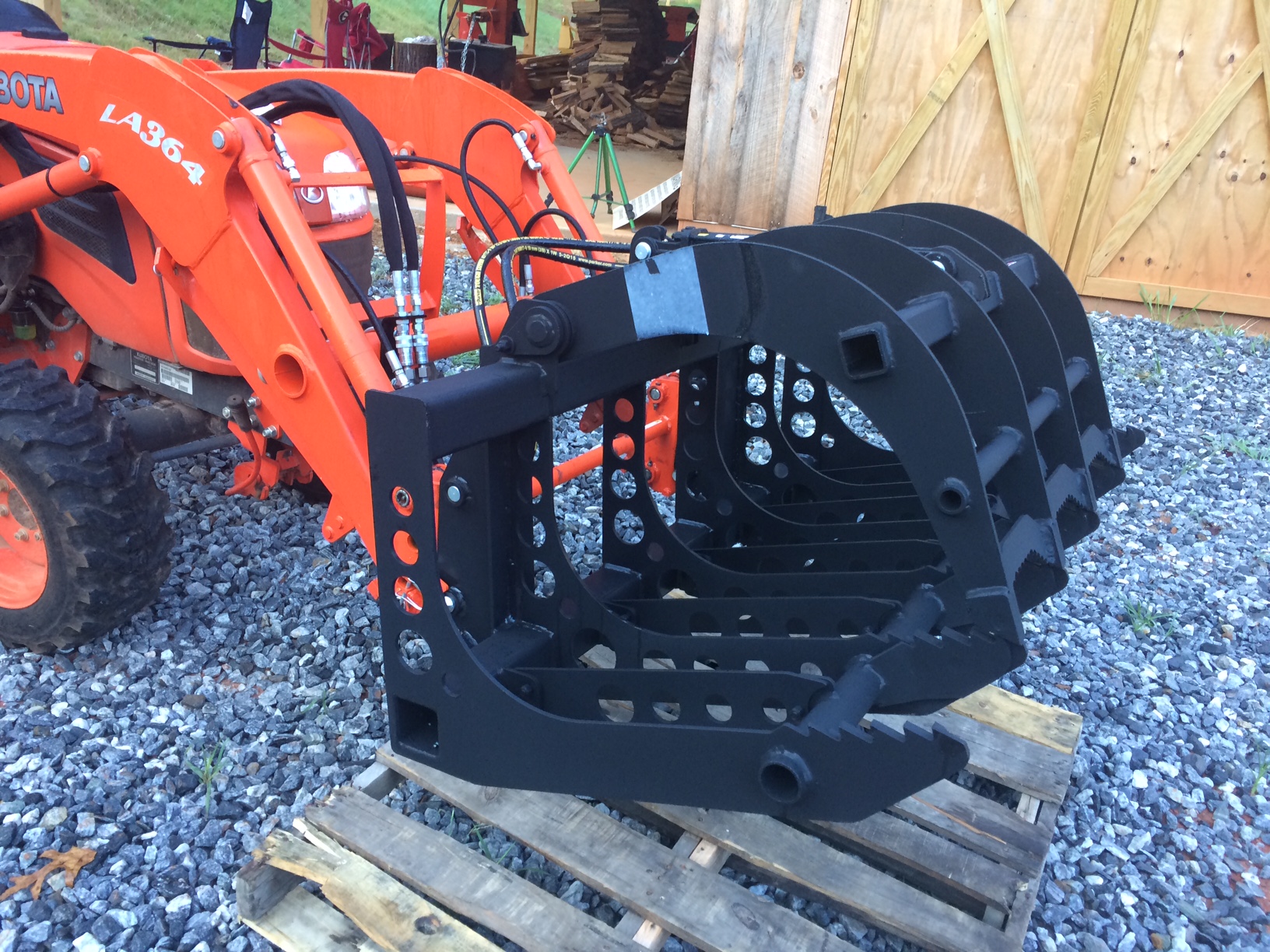

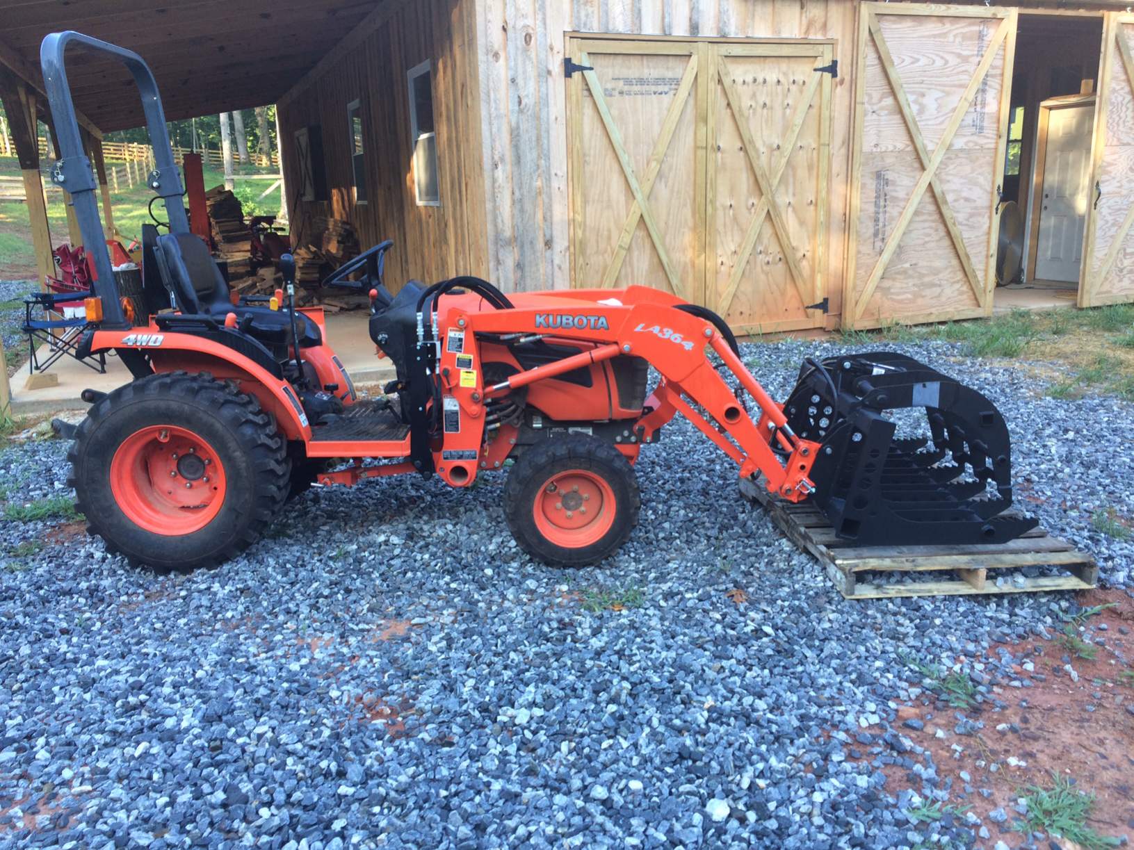

Here's a review I just received via email. Scott has our 50" Wicked Grapple on his Kubota B2601 tractor.
"I just wanted to send a shout out to you about the Wicked Root Grapple I purchased. It is freaking amazing. Your grapple is tough as nails just as shown in the videos. I have already used it to clear quite a bit of brush, trees and debris. My back is very thankful. I am ready to purchase your 48" brush cutter that you manufacture. Please send me an invoice for the brush cutter and when it can be available for pickup. Between your grapple and the brush cutter I have no doubt that I will have over three acres cleared and ready to plant come spring. It's too bad you guys don't manufacture tractors as well. Keep up the good work!"
--Scott from NC.
