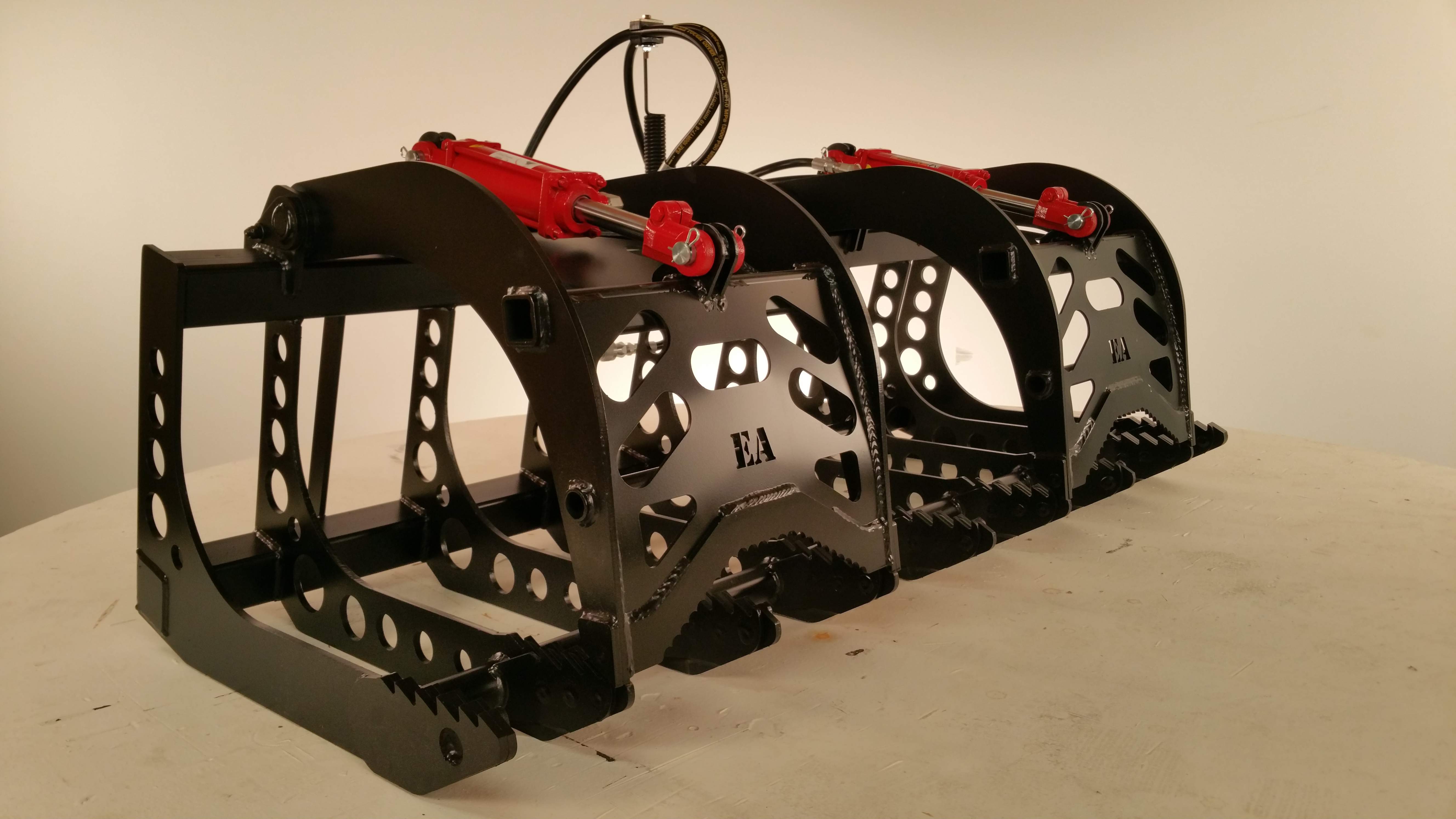

If more is desired, it doesn't add much $$ or weight to step up to the 54", which gives you a 37" opening.
I'll never get tired of sharing this awesome pic of the 54" single lid.

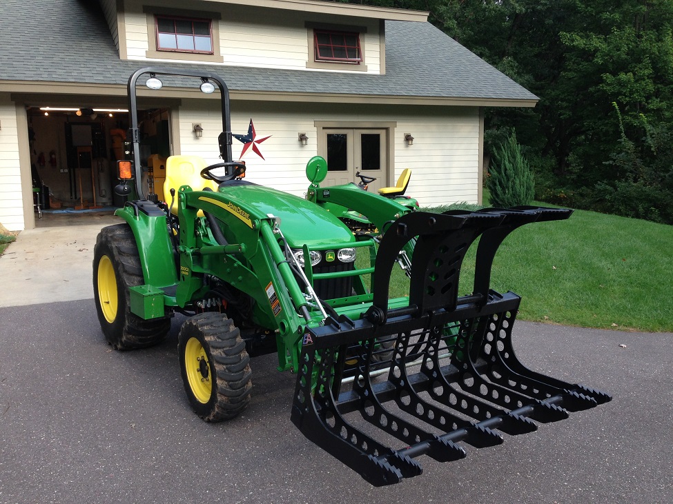

50" on the 1025R John Deere. Goldilocks!

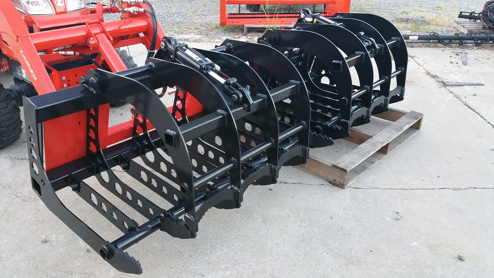

Agree that for the BX the 50 compact looks about right. I guess the question is aimed more at larger tractors with "lightduty" 48-60" single lid grapples. What is it that is different between the geometry of your 54" that ends up with 7" less opening than mine? It looks proportional but I wonder if my bottom tines might be longer and therefore the lid is also longer. From the back of my grapple to the tips of bottom tines is I think a bit shy of 34" (see yardstick photo below). I measured the distance from the bottom beam to the tips at about 28" (so a 28" log should just be at the tine tips). Is that dimension much smaller on your 54"?? I'm just not seeing where the 7" difference in opening is? I do note that your grapple upper tines touch your bottom tine tips (at least I recall James saying his 50 does that). Mine clearly has a couple inches of overbite so that could be part of it. I also notice that my lid pivot is an inch or two forward of the upper beam while yours is almost flush with the edge of the beam. That would certainly push the jaw forward (by about the amount of overbite) but not clear to me how that would make the opening bigger.

/ The WICKED Root & Debris GRAPPLE!!!!!!!
#1,386
The cylinder mounts are noticeably different.
The one on your grapple is taller. The one on your lid is also taller and pointed forward, away from the tractor.
Ours is lower and pointed toward the tractor.
Also, concerning the closing geometry....our cylinder is pushing down where yours is pushing out. This downward push will generate more clamping/pinching force if the cylinders and pressure is equal.
Travis

I agree with your points about the two grapples different geometry. However, I wonder how much closing pressure is really useful. The photos below that I've posted before shows a greater than one ton granite boulder being yanked out of the ground by my grapple with ONLY ONE UPPER TINE in contact with the rock (my mistake). The pressure was enough to bend/splay the tine out (since straightened and reinforced). It was enough pressure to hold the rock while lifting it from undisturbed ground.
I have never noticed a lack of closing pressure even though the geometry isn't as favorable for pressure as your EA upper lid. If that is the only reason your grapples are designed with smaller openings then you might reconsider that aspect of the design. I don't believe I've ever heard of anyone with any grapple complain about lack of closing pressure but there have been some complaints about less than 40" opening size.
