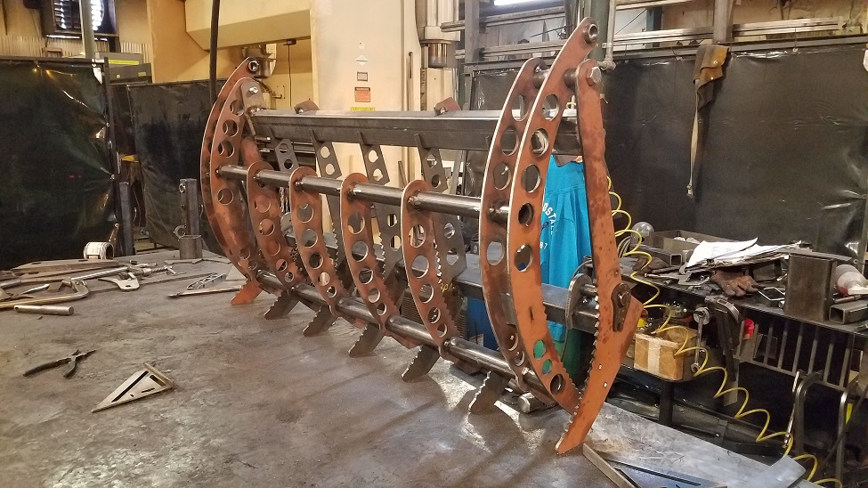

So, I'm thinking yours could be in these pics I took from the new factory floor last week.
Ready to be tacked...
Tacked and ready for some solid, continuous welds...
Solid welded and ready for a bath and some paint...

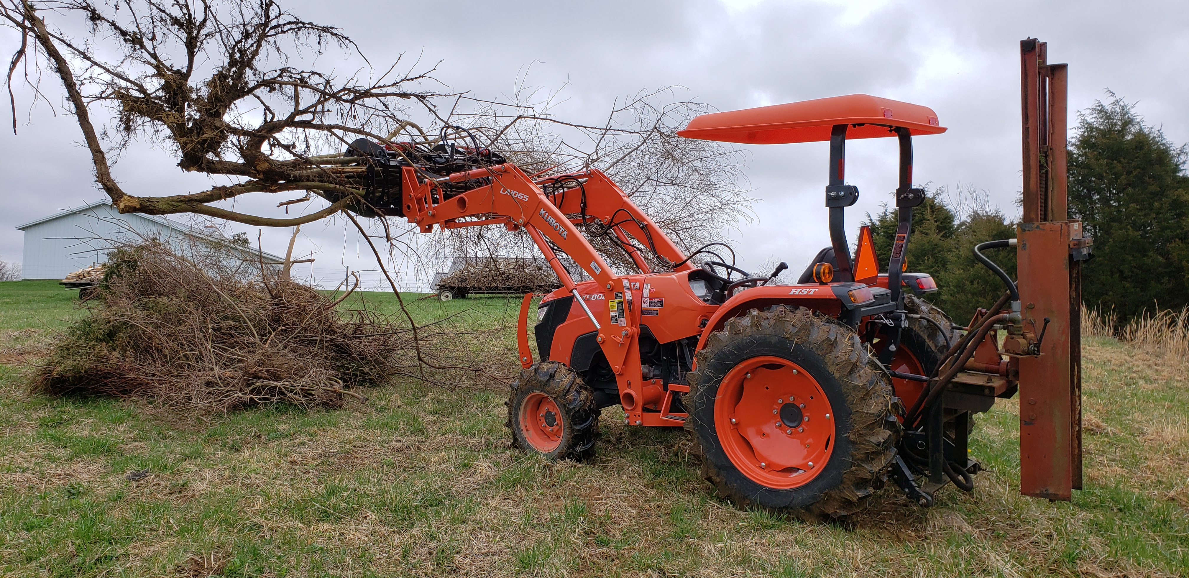

One thing everyone needs to keep in mind is that the grapples need to be greased before they are used. I'd used mine for a few minutes and went to pull a small branch that was stuck in the teeth and noticed the dry grease fittings. It may have been mentioned before but I figured a reminder wouldn't hurt.
