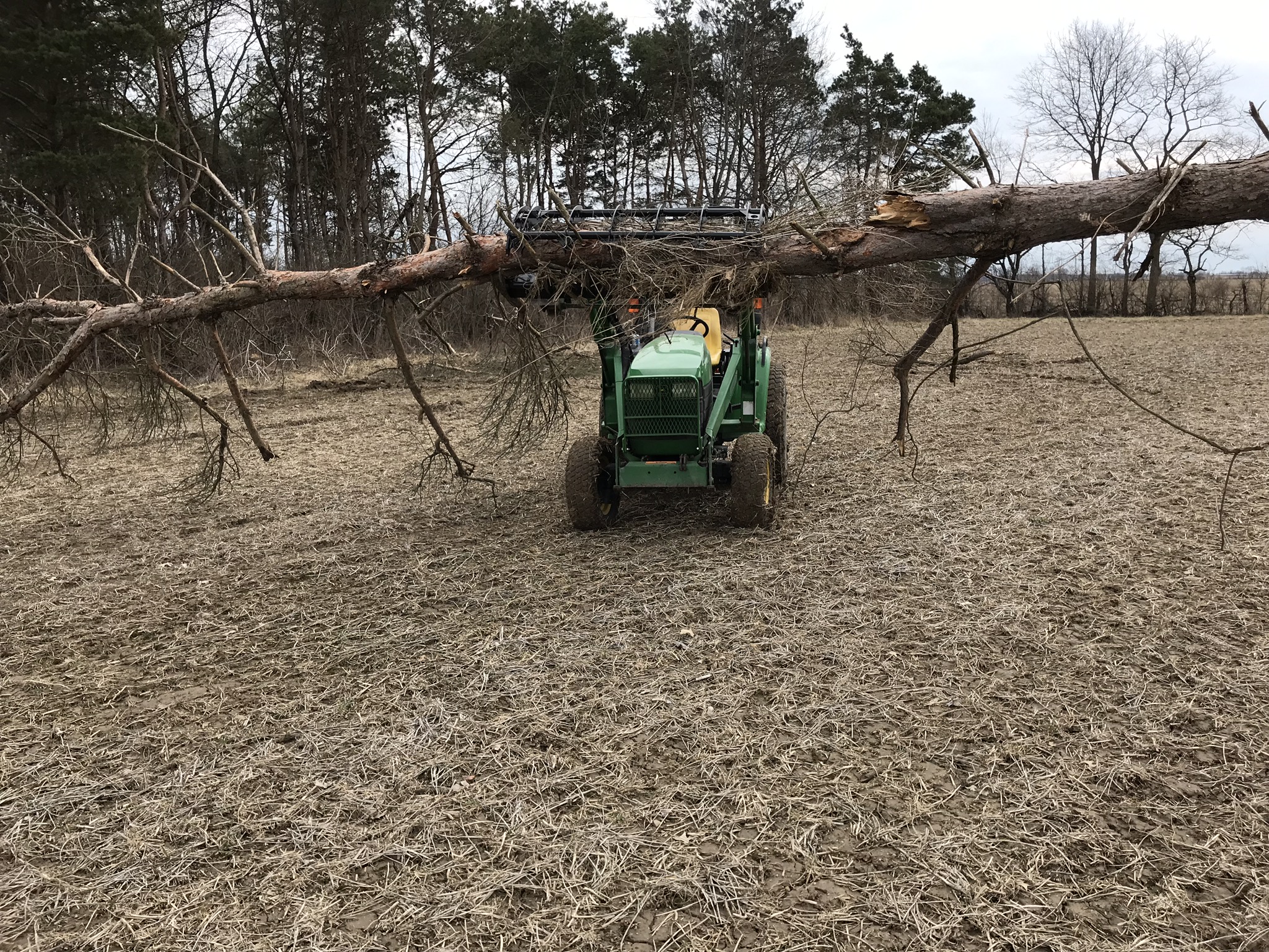

Makes it easier to catch deer before they can run away. :thumbsup:
