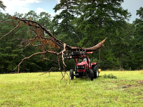

The wood pile was getting tall and needed pushed over to fill in the back side. I stuck a small log in the grapple to push it over. I took it easy since this was my first time doing this.
