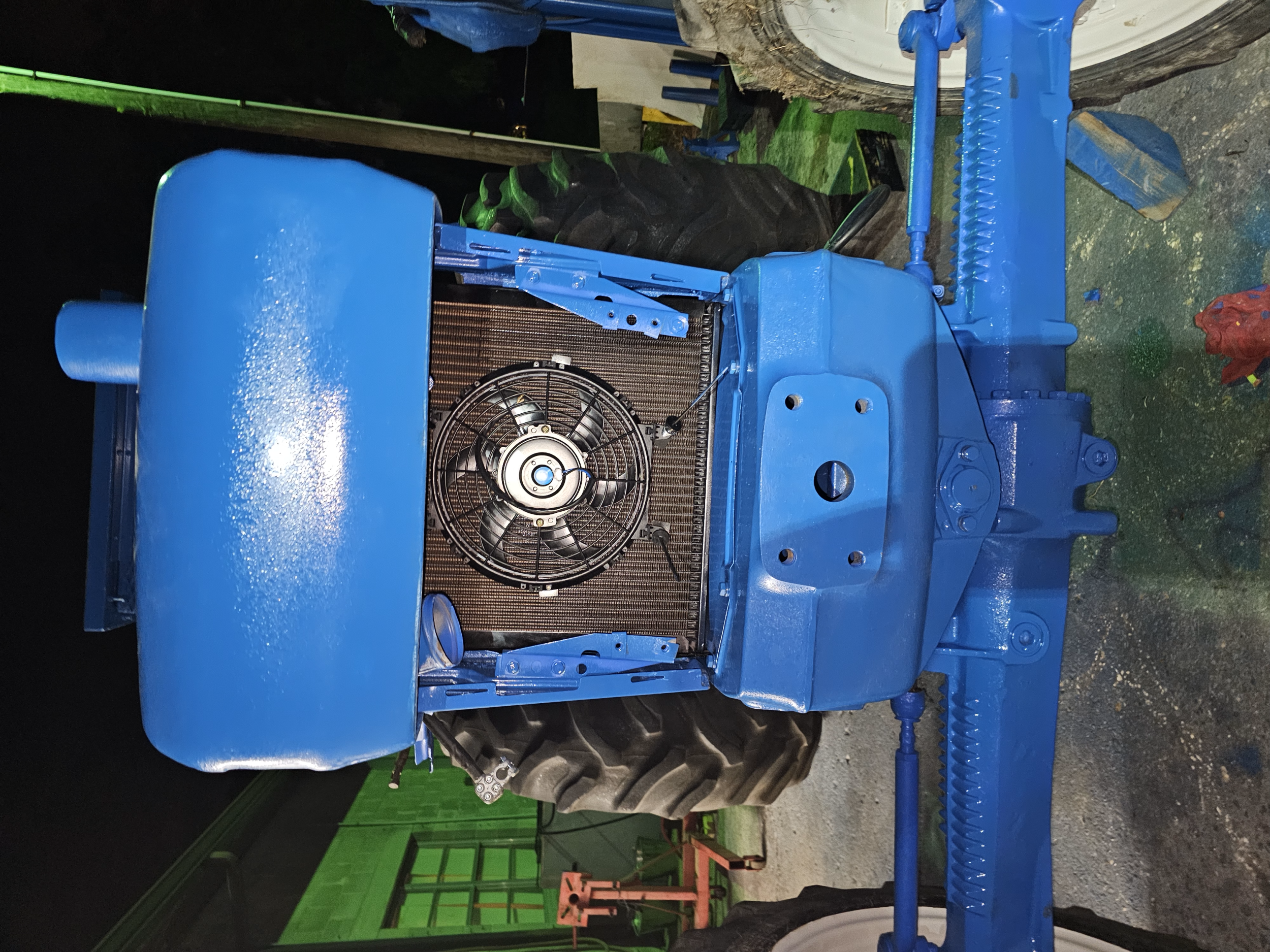

The guy that put the engine internals together says "The rings are not seated yet end the smoking is normal. Just give it a couple hours of work"

Overhauled literally thousands of engines never had one smoke like that have had bad sleeves and piston rings aftermarket ****.
Oil pressure bad oil pump or relief valve in pump or to
Much clearance in bearings
Did they cross hatch after boring
Are there seal on valve guides
My break in was start it up warm them up put on dyno and crank it up.
Check for leaks and run it for a few hours
I have had cranks break from shop not cutting a radius
I have had sleeves get sucked down again shop do not cut relief for sleeve
I have had water blow out from hole
In block and sleeve did not seal
Anything and everything can happen
Need to pull pan and palatinate crank pull pistons
And check for crosshatch
Also when assembling never use engine oil I used marvel
Mystery oil on all my over hauls
As soon as it gets hot is gone just enough lubricant for turning over
And starting. looks like the guy put assembly lube on pistons

I wish I had your experience to draw from.
-I saw him check the crank bearings and they were well within the tolerance listed in the manual. I do not remember the numbers
-It is a new Oil pump (I know that does not mean not defective) The oil pressure gets low at RPMs less than 800 and after the temperature reaches 160F 12-15PSI
-I do not remember an obvious cross hatching on the piston walls. I attached a picture and it looks like no to me.
-Would I be able to see the the valve seals on the guides by pulling the valve cover? I am not sure. The company that did the heads has a great reputation but I do not know.
-He used Clevite on all the bearings but I do not think he put it on the pistons or rings. I am not sure ...if he did it was not much since it is bright red and very obvious.
-I am not familiar with "Palantinate". What is that and what does it do or show?
I appreciate your time and input on this. The ultimate call on what to do is up to the owner. I am so relieved I decided not put the actual engine intrnals together myself. My fear was that something like this would happen and engine building is not my expertise.
The picture of the block is interesting. That does NOT look like a bore/hone done by a machine shop. That looks like no boring was done but instead just a clean-up with 400 grit sandpaper. Each bore looks different (odd) and the left one still has a vertical mark that wasn't cleaned up.

There were ridges and water damage. The shop said they did not need sleeves since 040 cleaned them up. Is all I know
That block does not appear to be surfaced, by a real surfacing stone grinding or a fly cutter.
The before rebuild shows a LOT of piston to wall clearance so the bores and or pistons were worn.
The one cylinder shows a vertical scratch that should not be there with a fresh re bore.
I hope somebody isn't using word salad to make a 400 grit hone job sound like boring .040" over after using a ridge reamer to remove pistons and a heavy hone job.
Are there any pictures of the fresh engine with new pistons and rings without the head on it yet?
How about a parts and labor bill showing new .040 over pistons and matching ring set etc.
Sorry, just a bit unsettled looking a bit closer at the pictures provided

In this case, the engine was apparently bored, and got new pistons (presumably .040 over).
Valves and guides were also supposed to have been replaced.
The bill added to the first post indicates everything that should have been done.
Stuff still might go wrong, and one can't tell the shop's experience without more info.

The engine only has about 30 or 45 minutes of runtime on it right now and that is basically been slow and fast idle. It is boiling black oil out of the exhaust manifold that runs down the engine. He said since it is Florida that it is not necessary to put a thermostat in it. I noticed that it never warmed up more than 110 or 120°. I put the thermostat in it and let it warm up to normal operating temperatures. When it warms up to normal temperatures the low oil pressure alarm goes off when the idle goes below 1000 RPMs. This coincides with a manual oil pressure gauge that I put on the side of the engine. We trailered it over to his shop and he said that the oil pressure is normal that it should be about 10 psi per 1000 RPMs. So at 1000 RPMs an oil pressure of 10 psi would be OK. He suggested using Lucas oil treatment and thicker oil. It currently has 15 W 40 oil in it. In his defense he ran the tractor around the property for a short time while riding the brakes to put some stress on the engine and it did seem like it was smoking less. The oil pressure issue remains the same. So my question is what is a good oil pressure at an idle on a brand new engine. I understand that a new engine will smoke when it is first started. How much is too much how long before it should stop or go down to the minimum. I am certainly not an engine rebuilder but I have done everything on this tractor except for actually assembling the internals of the engine. I feel a little bit uncomfortable about putting a big bush hog on it and running it for a couple hours without checking with someone else to see how they feel. What do you think. Thanks for your time and attention. OK
Sorry I should have included that information from the beginning.
-Bored 040 over
-Machined Crank
-New Pistons all
-New Rods all (one was bent)
-New Rings
-New Injectors
-New Valves
-New Guides
-New Oil Pump
-New Cam Bearings
-Lifters looked perfect just cleaned
-Push rods checked and re-used
-New Idler timing Gear
-New Water Pump
-New Radiator
I dealt with the machine shop dropped and picked up. The machine shop got the Reliant rebuild kit and did the cam bearings, the rings were installed when I got the pistons in the boxes. They said everything was correct and ready for assembly. I have done mechanical work since I can remember and do pretty well on any project BUT, I wanted an experience builder to actually put it together. I have put engines together but I am NOT "The Engine Guy"
The guy that put the internals together came to my shop with his father and put it together. I had everything cleaned, labeled, and laid out on a table like a surgery before the doctor gets there. I watched them and waited on his every request (tools, bolts, supplies...etc). He seemed to know what he was doing. No big red flags on the build.

The cylinder bores look lousy from what I can see of the picture. Not honed or cross hatched in the least little bit.

The oil pressure is too low; no amount of break in is going to make this get better. I suspect clearances with all the machine work were not properly checked & standard size parts found their way in there. (Oversize bearings, etc) Putting thick or magic oil in here isn’t the answer and oil addatives will many times prevent proper break in. The behavior of suggesting no thermostat / Lucas gives me a zero confidence vote in the person who assembled your engine.
My push -
Start by talking to the machineshop. Did they order the parts? Ask them to check if something standard size got mixed up. Find out what they did to the valves and what remaining steps still needed to be done (were the valve seats ground?). Did your guy lap / seat the valves?
Do a compression & leak down check and record results.
I dont think you are going to get away with not pulling the engine. Said reassembler should be familiar with dial bore guages, have a large set of micrometers, plastiguage, something to measure runout with, & be able to show you plenty of evidence of other rebuilds.

Something is not right here. Number one you need a thermostat so that all the internal parts work at the same temperature. The oil pressure is too low that indicates rod bearing, main bearing or Cam Bearing clearances or excessive. I recently rebuilt a 268 Ford engine and they had three different sets of main bearings and rod bearings for my engine I only had 20 lb of oil pressure at idle so I ended up putting the bigger oil pump in that was for the turbocharged 268. Now my oil pressure is 60 at idle when cold and 40 when hot.
I've never rebuild an engine that had smoke like you were showing in your photos above which indicates something is not right.
