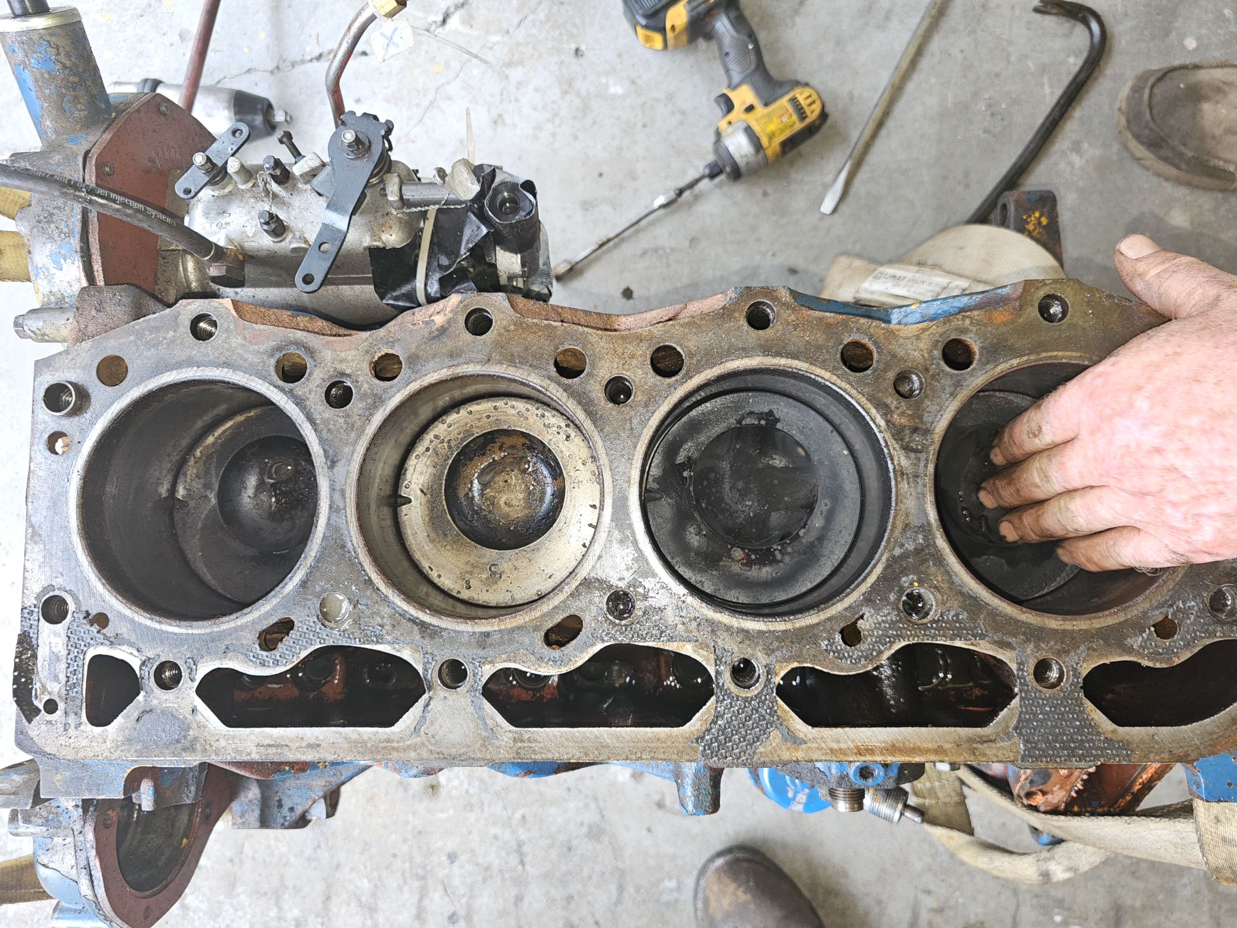

The guy that put the engine internals together says "The rings are not seated yet end the smoking is normal. Just give it a couple hours of work"
   / The guy that put the engine internals together says "The rings are not seated yet end the smoking is normal. Just give it a couple hours of work" #81
It sounds like one of the rings is either broken or wasn't installed at all.
   / The guy that put the engine internals together says "The rings are not seated yet end the smoking is normal. Just give it a couple hours of work" #82
All I can say to that is most shops want the oversize pistons ON Hand Before they bore a block, that way they can final hone to put it on the money spec wise as far as piston to wall clearance.
. So the block was bored .040 over and then a set of .040 pistons in a kit was sourced?
   / The guy that put the engine internals together says "The rings are not seated yet end the smoking is normal. Just give it a couple hours of work" #83
He installed the oil scraper ring upside down or failed to install the valve seals.
Check the crankcase breather to see if its plugged, the head could have been warped and the oil is leaking from the oil passage to one of the cylinders.

I am a retired automotive machinist and there definitely is something wrong.

Does the tractor start easily or does it have to crank a bit to start? One possibility is that the rings are upside down. Others have mentioned doing a compression and leak-down test. Unless you do those, you are looking at tearing down to find the problem. The one person that mentioned the oil filter might have an easy fix.
   / The guy that put the engine internals together says "The rings are not seated yet end the smoking is normal. Just give it a couple hours of work" #86
Could be upside down oil control rings, yes. Or, it could be the excessive clearance on the rods and/or mains is leaking and slinging so much oil no scraper ring could control it, upside down or not. And/or the bores are oval... Add these to the list of a dozen other possibilities that you'll never verify, unless you pull it apart.

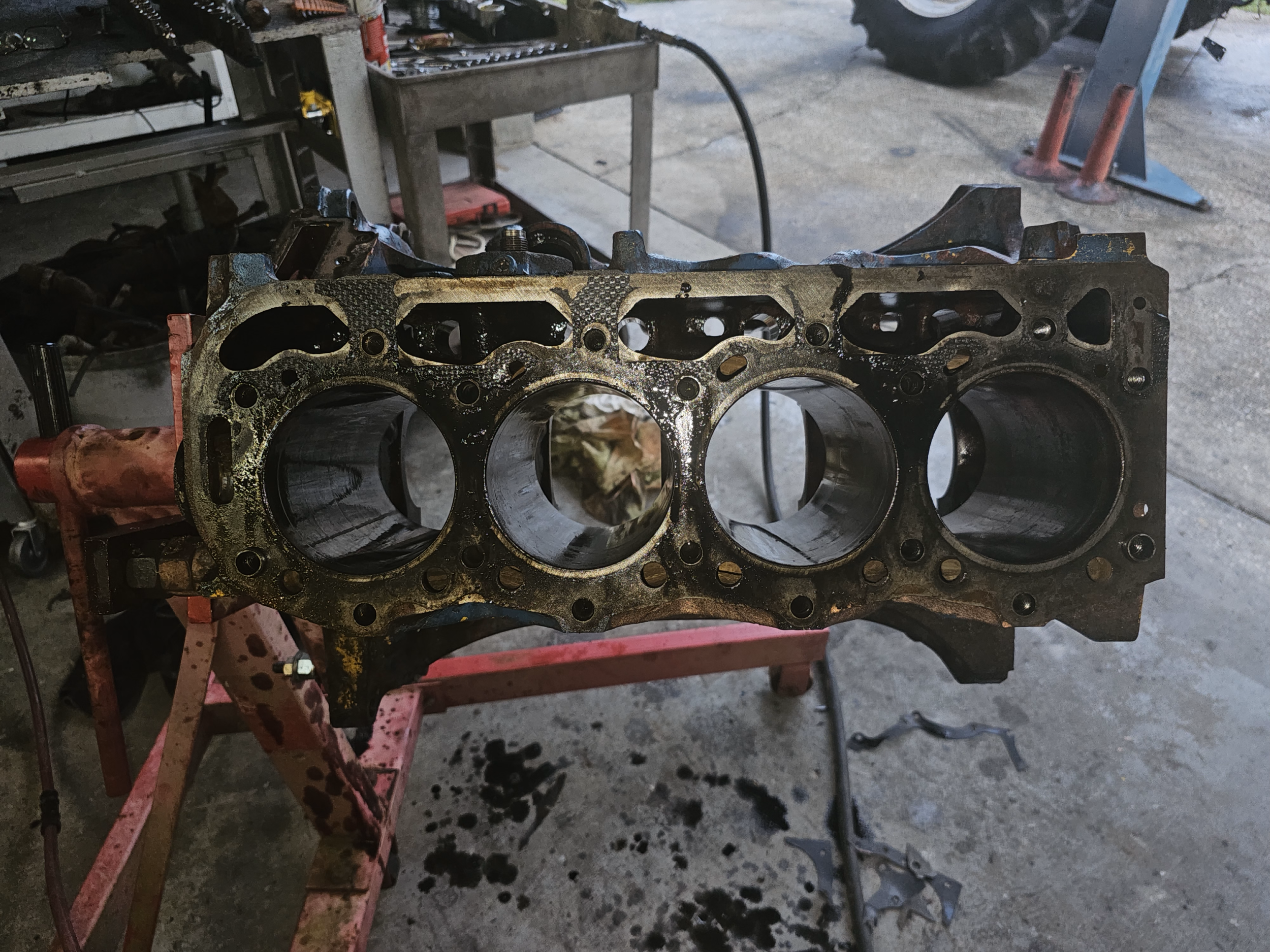

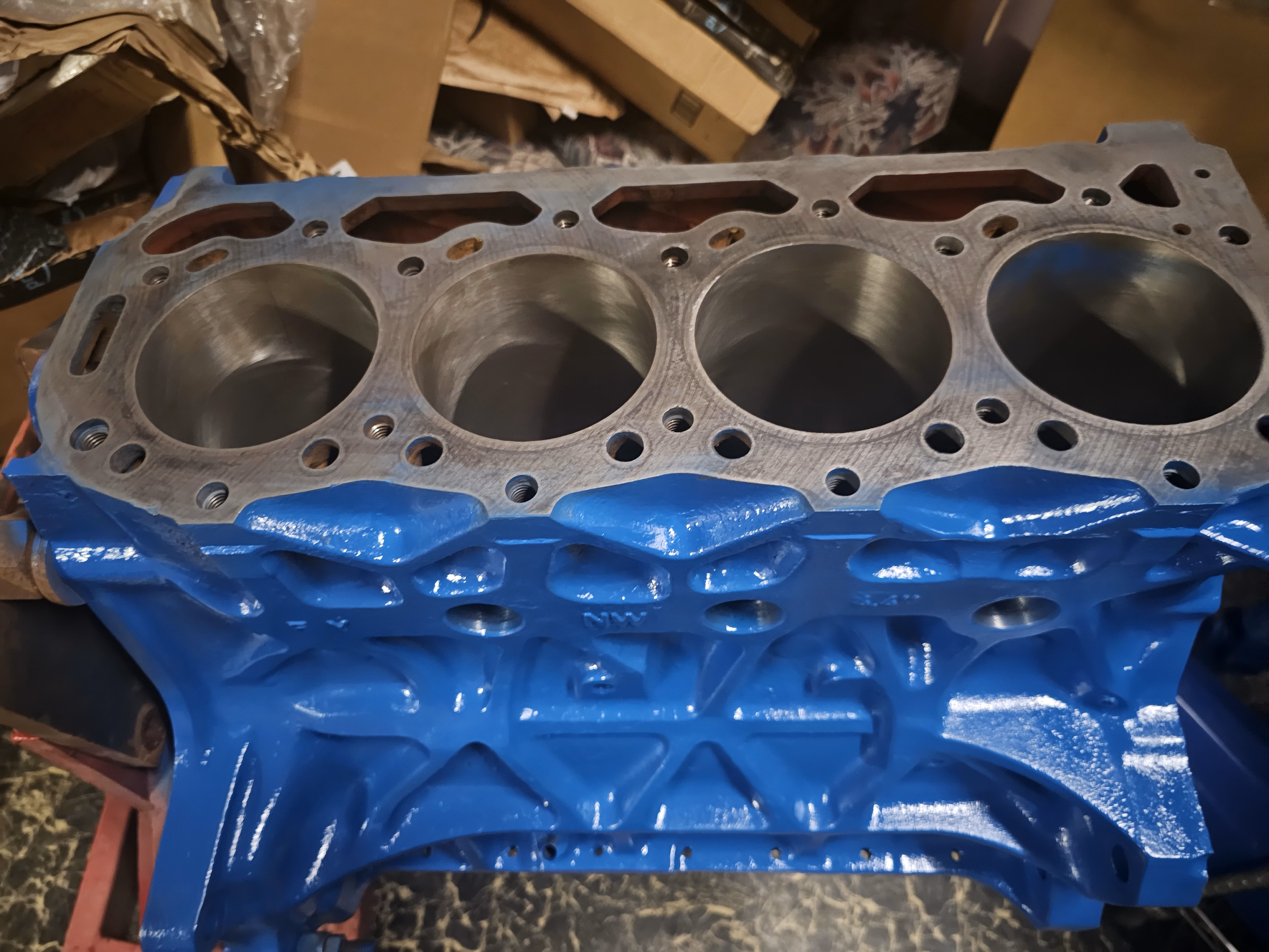

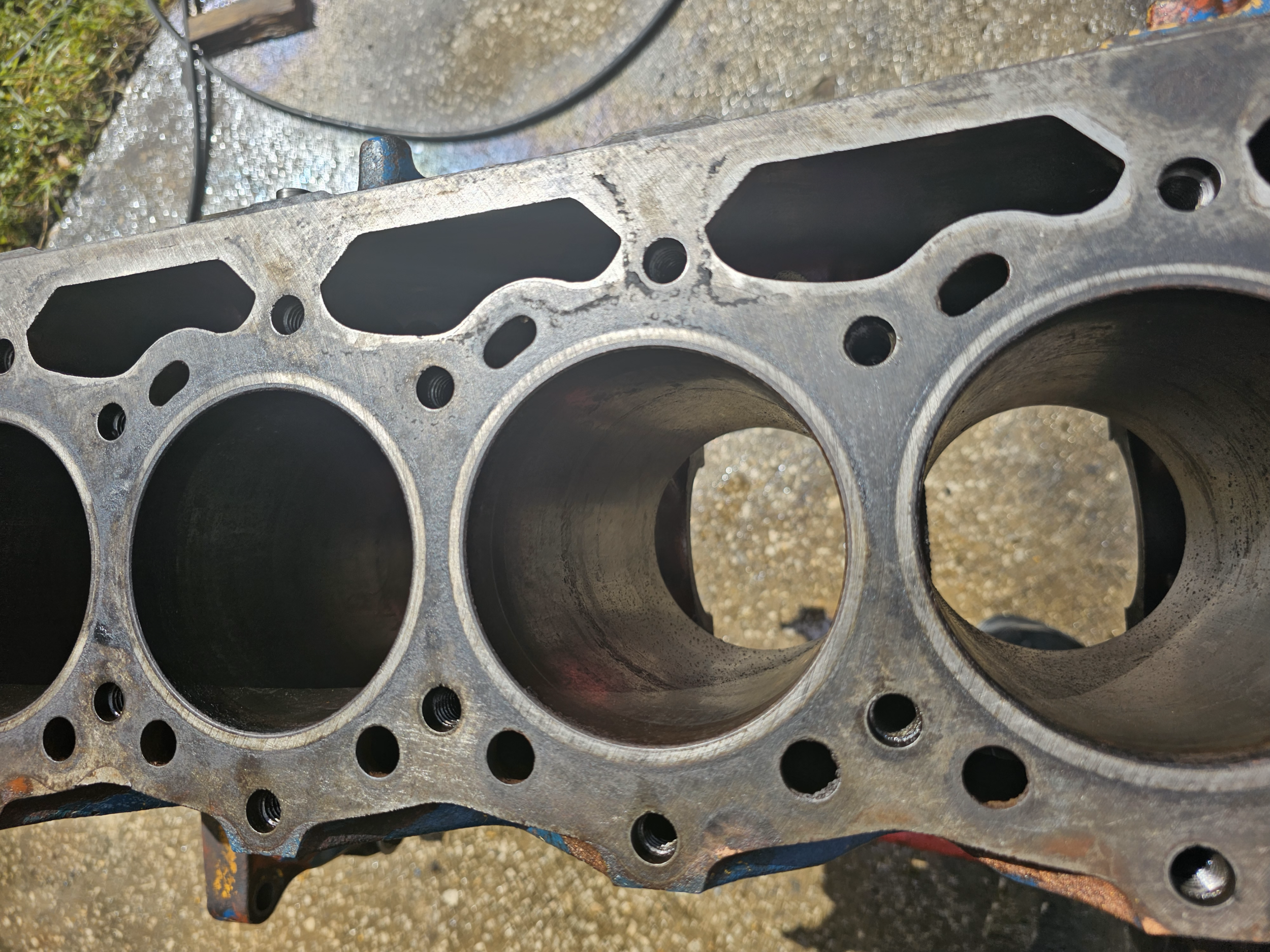

   / The guy that put the engine internals together says "The rings are not seated yet end the smoking is normal. Just give it a couple hours of work" #87
That picture was before I sent the block out.
Sorry I should have included that information from the beginning.
-Bored 040 over
-Machined Crank
-New Pistons all
-New Rods all (one was bent)
-New Rings
-New Injectors
-New Valves
-New Guides
-New Oil Pump
-New Cam Bearings
-Lifters looked perfect just cleaned
-Push rods checked and re-used
-New Idler timing Gear
I dealt with the machine shop dropped and picked up. The machine shop got the Reliant rebuild kit and did the cam bearings, the rings were installed when I got the pistons in the boxes. They said everything was correct and ready for assembly. I have done mechanical work since I can remember and do pretty well on any project BUT, I wanted an experience builder to actually put it together. I have put engines together but I am NOT "The Engine Guy"
The guy that put the internals together came to my shop with his father and put it together. I had everything cleaned, labeled, and laid out on a table like a surgery before the doctor gets there. I watched them and waited on his every request (tools, bolts, supplies...etc). He seemed to know what he was doing. No big red flags on the build.
The owner had it at a repair shop for 3 months. It is a dirty mess to say the least with unfinished tractors sitting everywhere. The shop was probably good 20 years ago. The owner is in his 80's now. . It was never going to get done. The owner wants it done completely and correct. I volunteered to take the project. (not my best decision ever...lol) The owner is a friend of mine with no engine experience and was overwhelmed. He plans on keeping for the long haul and using it on his ranch for baling, and general work after adding a loader.
Thanks for your help
