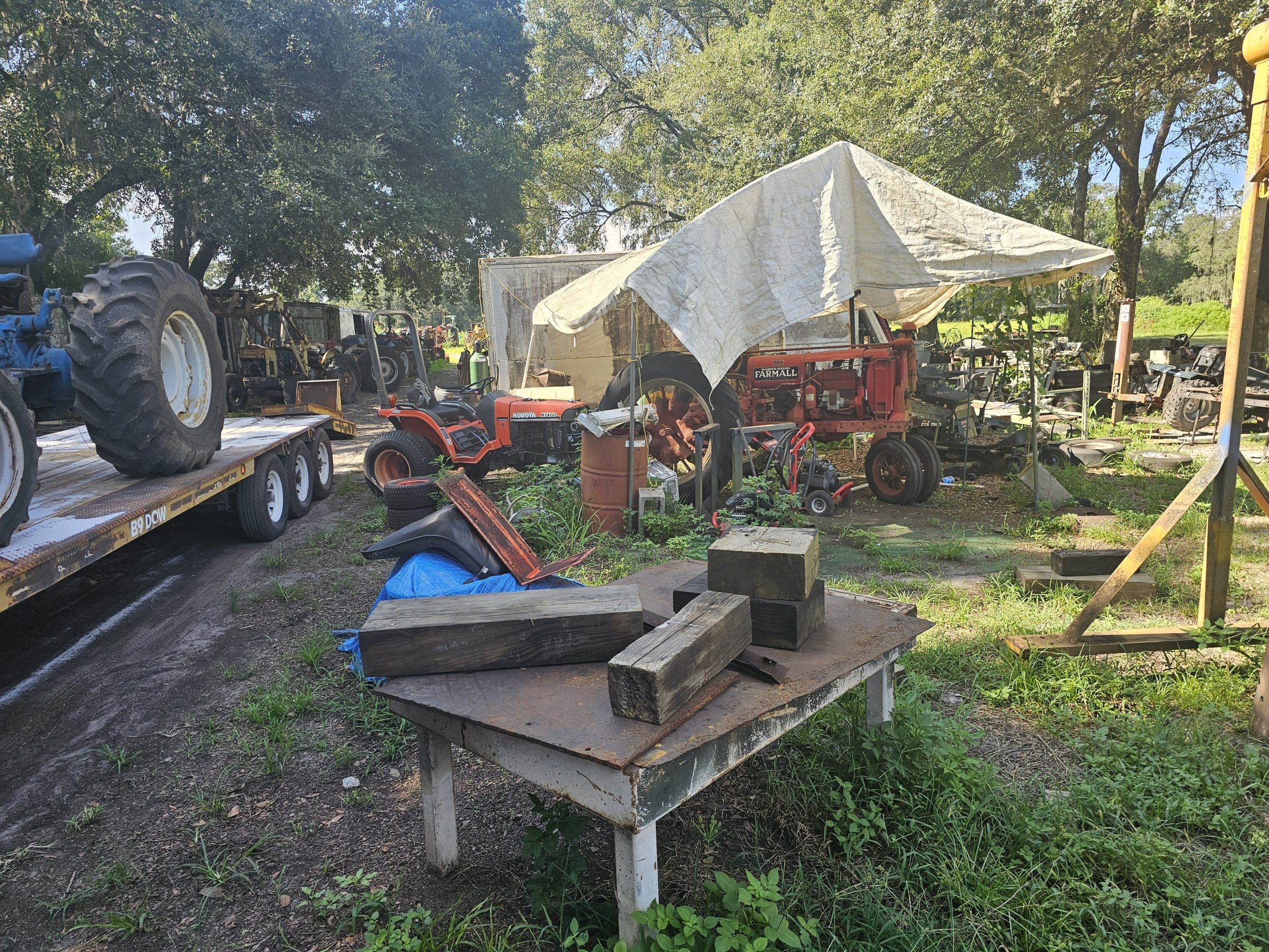

The valve seats were reground. It smells like Oil for sure. No it did not smoke that much that but it had a dead very low compression cylinder (Broken Ring) and water damage in 3 cylinder walls. The tractor shop replaced the head gasket and put in back together like that without a torque wrench evidently....EEEK Yes! it will run on three cylinders with the the injector pump one tooth off...in case anyone is wondering

I bet the Orange tractor that was lifting the motor didn't smoke.. Looks like a Kubota to me. If it was good choice.
   / The guy that put the engine internals together says "The rings are not seated yet end the smoking is normal. Just give it a couple hours of work"
#40
it is a MX5800 I am very happy with it Thanks
