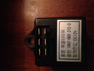

She's dead Jim. . .
Removed the cover. . . well more accurately destroyed the cover. I took a picture of the components on an old school bread board and it's pretty obvious that the timer is dead. Measured several resistors that are now open, and at least one cap that's bad too. Even if I was able to replace the components, which I'm not since they're embedded in epoxy, it'd probably cost me more in parts than the replacement at $40. The crappy thing is the part is designed to be sealed, but yet there is a pretty large hole near the blade connector. Oregon moisture (or mouse pee) clearly got inside and corroded the parts.
Bummer. . .
P

Jigs, I know this is an old post but - can you tell me what part number you used to get your Mitsubisi s3l timer? My 273 should be the exact same as what you used, I looked it up on google and see bunches of timers but not the exact same as my dead one. Mine old one has 6 prongs, those listed show only 5? It will be "much" simpler to order what you used! Please give me a number. Thanks, Greg
/ T273 Glow Plug Timer? #34

Jigs, I've got the Tym part number - what I'm wanting to get from you is the Mitsubishi SL3 number that you found so I can try to find one on Amazon - I'm wanting to find a source that is other than Tym!
You posted that you found a substitute Glow Plug relay and used it. That's the part number that I want. I've found relays on Amazon but they don't "look" like they will fit/work. You say you did; what was "that" number that you used please! I'm not in a rush, so whenever you get home and find time to look it up is fine.
Thanks again, Greg

Thanks, I found that one but it's different from mine. I've got 6 tabs (3 in a row ---) above each other. That timer "may" work but I'm not messing with my wires!
I've found replacement relays - but at about $85.00 each and I was just looking for a cheaper route. Guess it's not out there anywhere!
I've got my replacement (spare) coming in the mail. I just like to have a spare on hand cause you never know when it might fail again. Even here in Ca I find my tractor starts much better, faster, & easier the first start of the day when glow is used so I use it almost all the time. It lasted about 16 years so not to bad!
Thanks again for looking yours up. You must have a slightly different style than my 273. Greg
