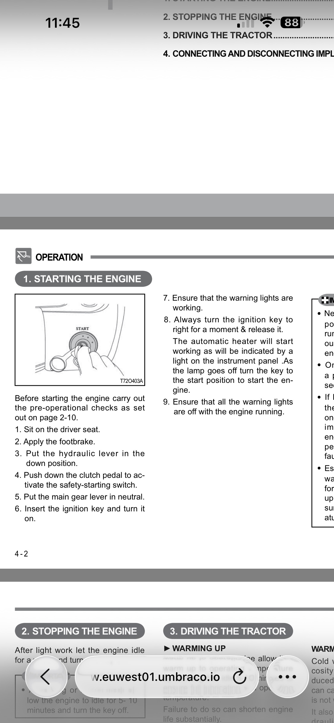

I've got a TYM 654. Anybody got one? I'm wondering how to turn on the glow plugs. I've got the icon on the dash, but nothing I seem to do turns it on other than when I cycle the key and it comes on with every other light in the bulb test cycle. Even at 0 degrees, the Duetz starts.

on mine I turn the key on and all the lights turn on, then they turn off and then they glow plug light turns on for 10 seconds.
/ TYM 654 glow plugs
Mine doesn't do that, they all turn on, they all turn off. But, the tractor always starts.
/ TYM 654 glow plugs #6

Some of the glow plug relay setups have thermal switch built into them, and they won't latch unless it gets cold enough.

If 0 isn't enough to trigger such a thermal switch, I don't know what is.

/ TYM 654 glow plugs #12
This is from the owners manual
https://tym-new.euwest[emoji[emoji6][emoji6]].umbraco.io/media/qoikvc/t[emoji6][emoji6]_operator_manual_en_may_[emoji[emoji6][emoji6]][emoji[emoji6][emoji6]].pdf
Thank you for that. Nothing happens, but again, it always starts.
/ TYM 654 glow plugs #14
What model is this for? I don't recall it in my manual for the T754
/ TYM 654 glow plugs #15
I found it in the owners manual for the T654 on the TYM website. They list most if not all current owners manuals there
This is the procedure from the T754 manual. It looks basically the same as the T654.
Just enter model number for manuals. They will have several different years.
#16
Thank you for the link. Mine definately does not do that.
