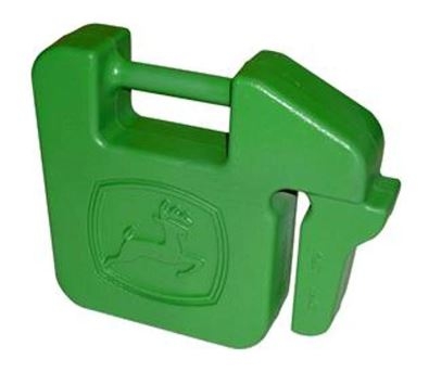

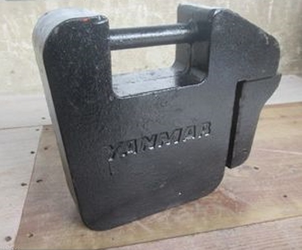

Like @rScotty mentioned, get some weight on the back end.
You can get wheel weights or add a drawbar lock and use front weights on the back.
Either brand works.
