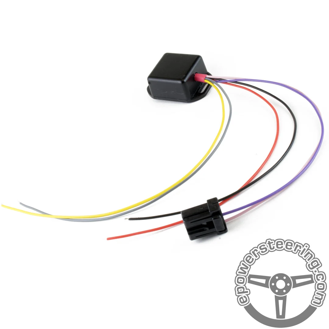

As far as power steering there have been many conversions done to Electric Power Steering a popular part is the 02-07 Saturn Vue unit with an aftermarket control unit, such as;
02-07 Saturn Vue/Chevy Equinox Electric Power Steering Motor Complete EPAS/EPS | eBay
with something like this added, it can be done without this though;
These were put on some yanmars?
/ Stuck yanmar 165D #206
People who DIY, yes.
Some of the MTD Cub Cadets tractors have them too. This works for the SCUT machines as they are smaller.
Even old small tractors like this Farmall.
