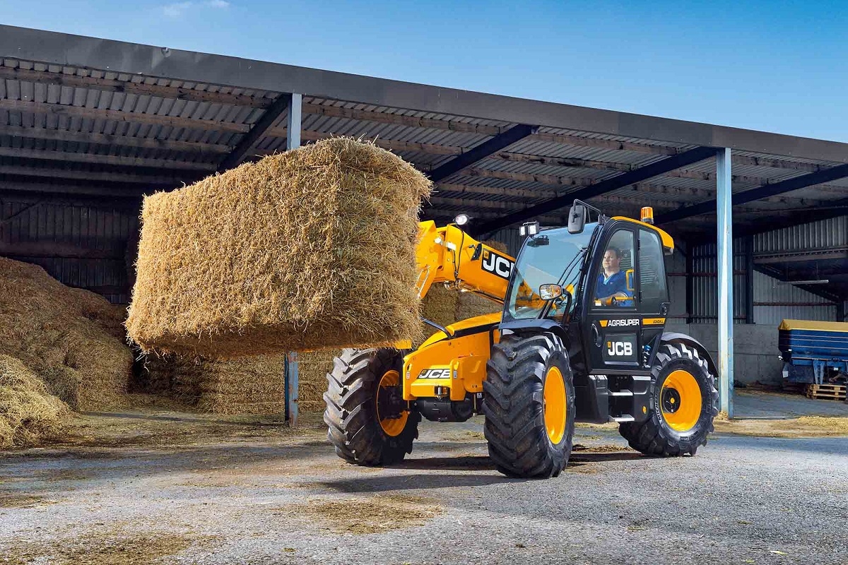

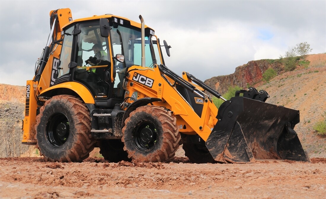

Even full size backhoes just run R1 tread these days. Same for Ag telehandlers.
View attachment 827773 View attachment 827774
I am not sure those are R1 tires.
My rear BTK RT 747 tires look like R1 tires, but they are R4 with a R1 tread pattern.
Michelin is another tire manufacture that has a R4 tire with the R1 pattern lugs, but they were way more $,$$$.

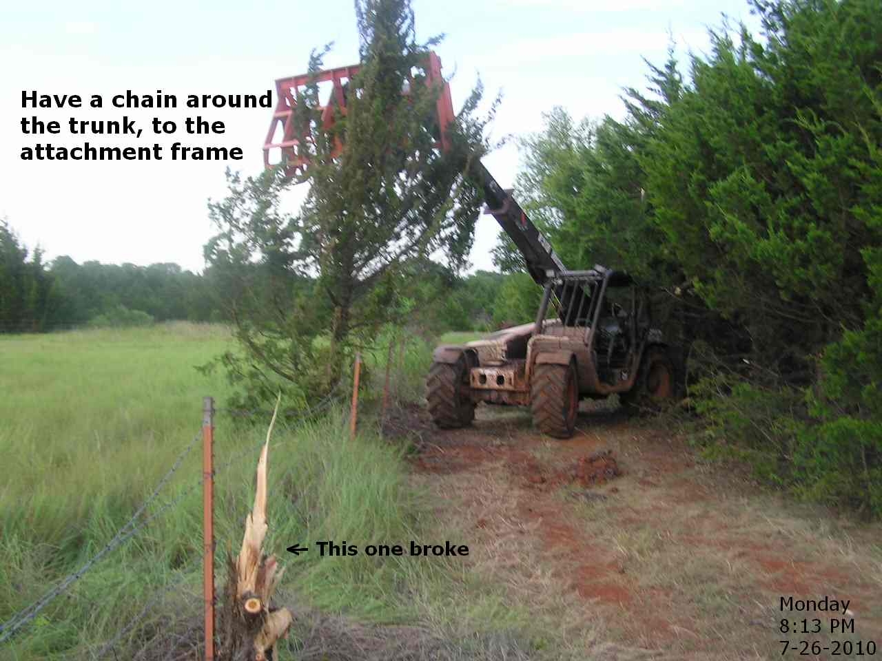

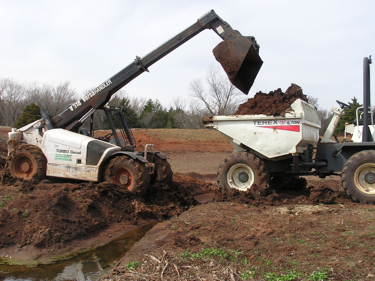

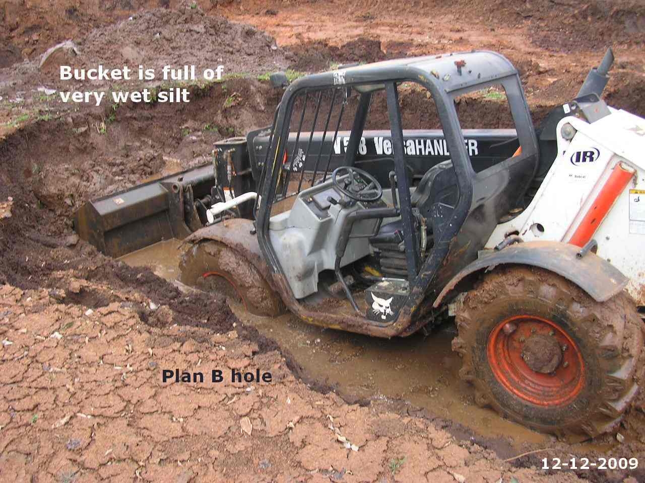

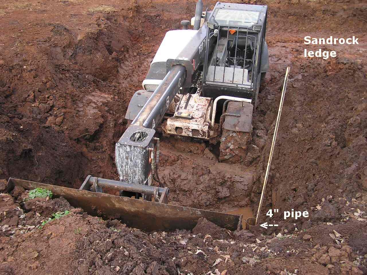

Would love to have an AG telehandler!!! ;)
I swapped the front tires side to side, reversing the tread, on my V518 when I was removing silt from my pond.
It gave me more traction backing up, I could really tell the difference.
From 2013 my first compact telehandler.
Notice the tread direction of the front tires:
