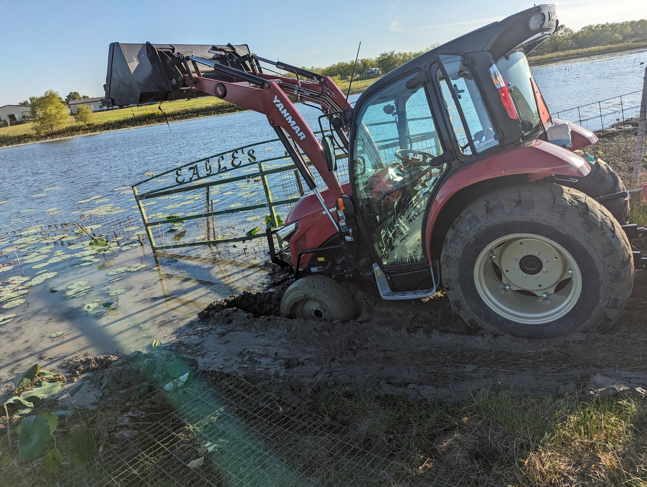

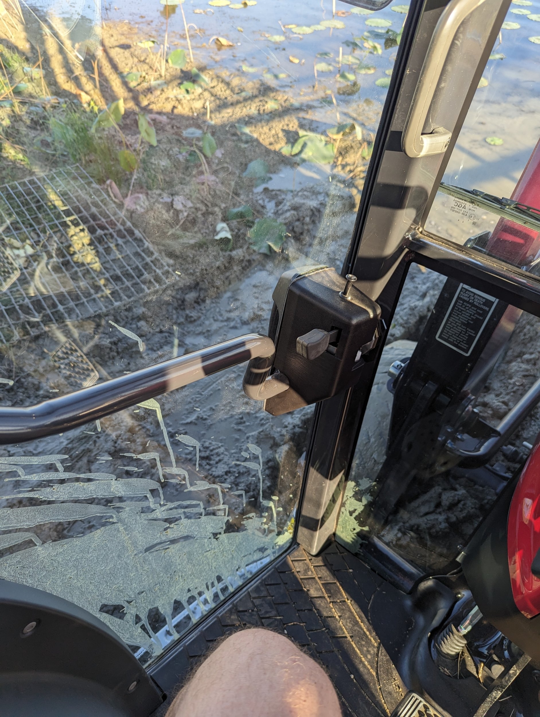

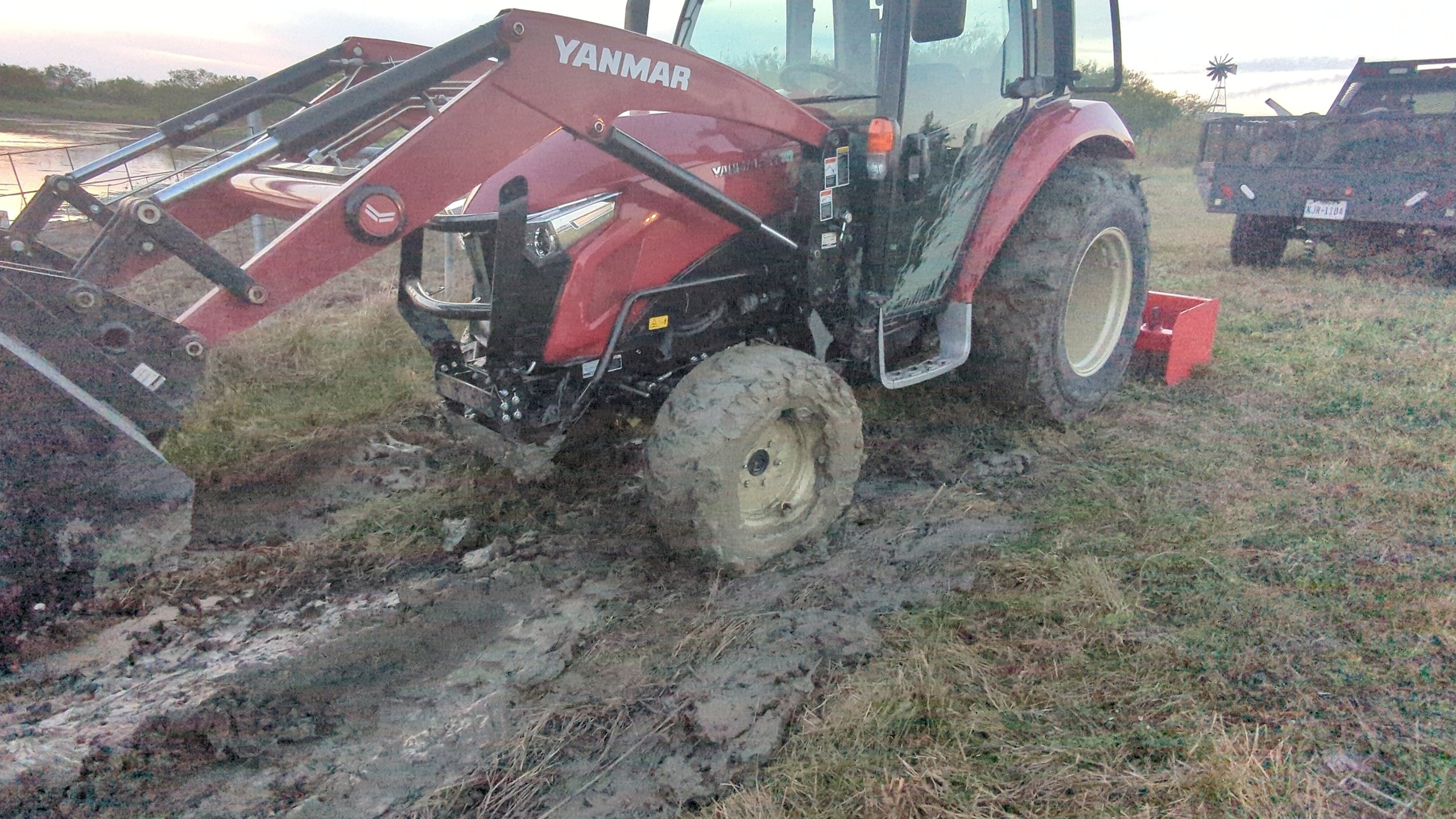

Well, it finally happened. I've only got about 100 hours on my yanmar YT 359 tractor. Just long enough to feel comfortable and try and do something I probably shouldn't have.
I was adding a run for my meat pigs to have access to the pond for water. I got a little too aggressive on how far I could drive out and scrape backwards with the bucket. My pond has a lot of that super sticky, gross, squishy, black muck, and I sure enough got stuck.
I tried all of the tricks with pushing the bucket down and lifting the front and going backwards and everything I could possibly do. I had it in four-wheel drive and the diff lock engaged, everything to no avail.
I ended up getting my farm truck out with a long chain to help move the tractor backwards. The wife was kind enough to steer the truck while I worked the tractor backwards.
Moral of the story, don't bite off more than you can chew, or dig!!

I don't recommend that way to wash your tractor :unsure:
Glad you got unstuck!

I think probably most of us with tractors/equipment have “been there/done that”…….
That kind of mud is like driving on ice.
As long as you have another vehicle and tow strap like you did, then it’s just an issue of taking the time to pull it out.
If you had had more weight on your 3 pt (and therefore the rear tires), you possibly could have had a better chance, but hindsight is 20/20…….

AG TIRES!
Those R-4’s are useless

A small winch with 3 snatch blocks would help too. But your pictures don't look like there's many trees. Glad you got out. I got stuck in the same type of pond with the left front and rear. Lucking a neighbor has a bigger tractor and massive cahones to drive in the spot he to pull me out.
I'm investing in a winch that can mount on a 2 inch hitch I have on the front and back of my little tractor. My new big tractor will have one bolted on. All my land is steep and slick.
