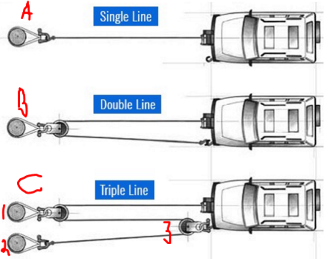

Be aware if you are using snatch blocks - you can end up putting double the load on an anchor in some situations. Combine a snatch block with a deeply mired load and you can accidently destroy your anchor which if it is your bumper could be costly and dangerous!
Using the diagram above I ran some numbers (I think I am correct but there are folks smarter than I am on this forum who I am sure will weigh in if I am not)
Variables:
Load 4 Tons (8,000 lbs)
Tackle resistance (10% of load per snatch block sheave)
Max Winch pull (6 tons, 12,000 lbs)
Pull per line = total load with resistance / # of lines
Load per anchor = load per line * # of lines to anchor
Situation 1: Single Line:
Mechanical Advantage = 1:1
Load on Winch: 8,000 lbs
Load on Anchor: 8,000 lbs
Situation 2: Double Line:
Mechanical Advantage = 2:1
# of snatch blocks: 1
Total load: 8,000 +800 {10% tackle resistance} = 8,800 lbs
Load per line: 4,400 lbs
Load on the Anchor: 8,800 lbs
Load on the winch: 4,400
Load on the truck anchor shackle: 4,400
Total load on the truck itself across all anchor points: 8,800
Situation 3 Triple Line:
# of snatch blocks: 2
Total load 8,000+1,600 {20% tackle resistance} = 9600
Load per line: 9,600/3=3,200
Load on Winch: 3,200 lbs
Load on Anchor 1: 6,400 lbs
Load on Anchor 2: 3,200 lbs
Load on Anchor 3: 6,400 lbs
Total load on vehicle (3,200+6,400)=9,600
Consequently, if you move anchors 1 and 2 to the same tree, the tree will see 9,600 lbs of pull (3,200 of the pull being felt by Anchor 2 and 6,400 being felt by anchor 1)

All good information BUT.... Is just single vehicle information using solid anchor point to pull against (self rescue) ... IF stuck tractor and pulling with 4WD or "other" rescue vehicle, both vehicles lack a solid anchor to pull from (assisted rescue) ..... Which vehicle moves first is how much weight or tire friction the "pulling" vehicle has, to wit, 4,500 pound Jeep pulling out a 2,600 pound SCUT stuck up to chassis in muddy creek bottom.... Guess which vehicle was first to move..... Yep it was the JEEP!....
Then there is scenario of how many tractors have "recovery " winches and convent tree nearby...

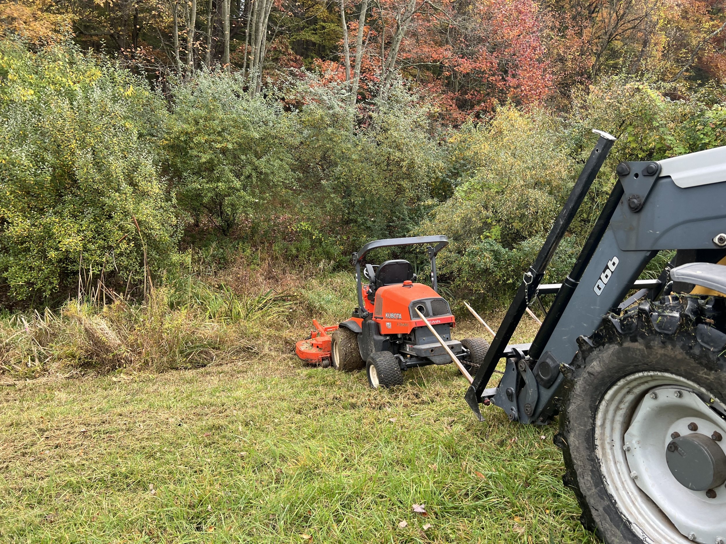

I got stuck in the pond (actually a swamp) today!
Tried to get too close.
Good thing I had the R-1 equipped tractor there, too.
Got stuck 3 more times after this picture. I figure its better than weed wacking.

I got stuck in the pond.
This makes me smile.
I’ve gotten stuck multiple times in one mowing session and always thought “what a fool I am - not learning that it’s muddy near those pools of water”!!!
Glad others hate weed whipping.
