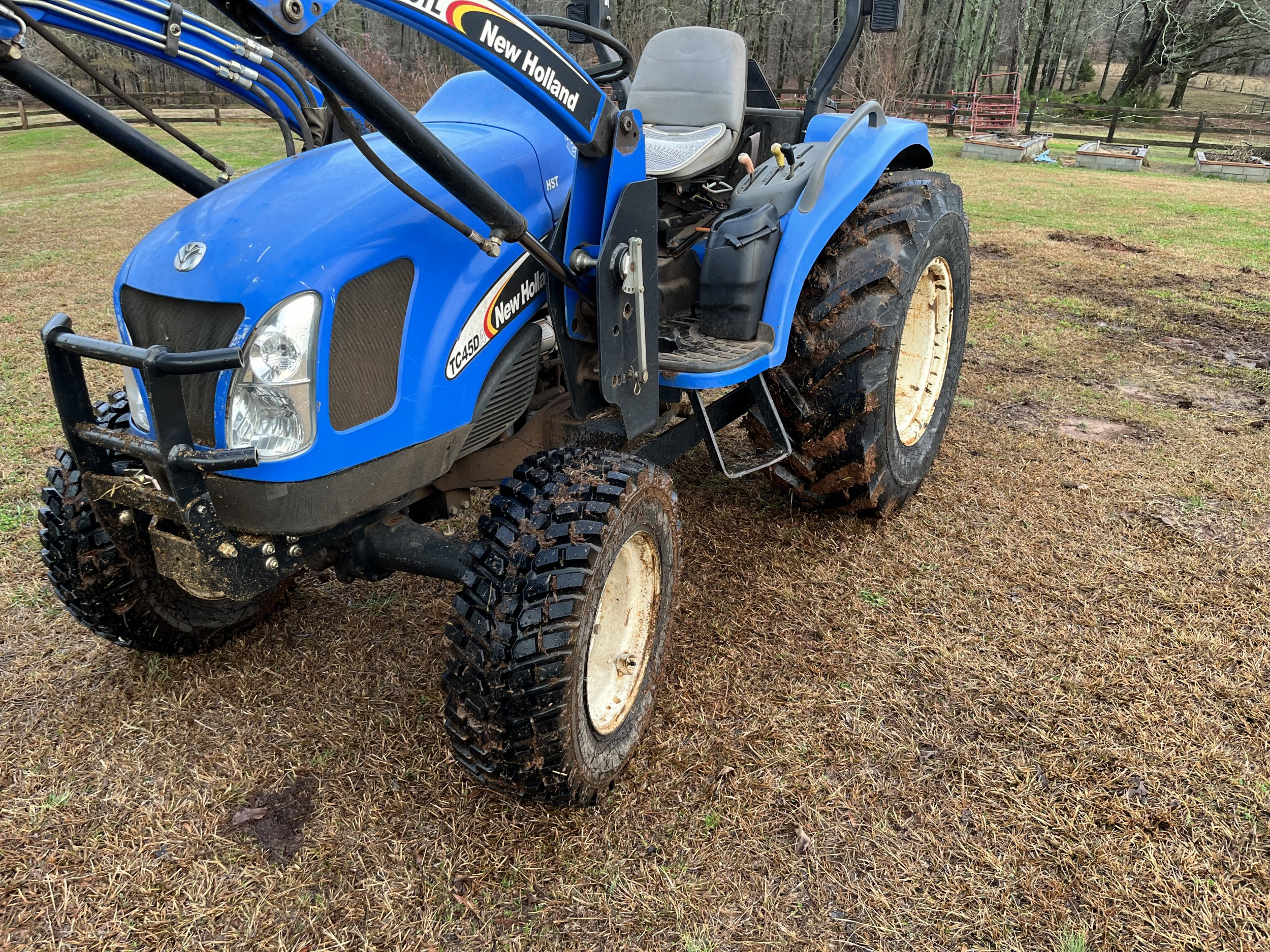

Many may laugh at me, but I actually have turf tires on my tractor.
Why - because the vast majority of my work is mowing, mulching, brushing, hard scape and other chores for yards and gardens and general landscape. They work fine and do no damage to the grass or ground. The zero turn does more damage!
I really have little on my acreage where I could get stuck. I don’t take the tractor into the woods or down by the river. Really no reason.
I’ve gotten my 4 wheeler stuck a time or two in mud but that is what the winch is for.
Then again - I don’t use the tractor for large scale farming like many on this forum.
I have R4's for the same reasons - less damage to the grass. I mostly do brush hogging, loader work with rock and gravel, box blade on rocky driveways, and very little work in loose dirt. I do have places I could get stuck (and had some close calls), but for the most part I wanted the extra thick ruggedness of the R4 tires so the brush stobs and rocks would be less likely to wreak havoc. I'm happy with that decision so far.
