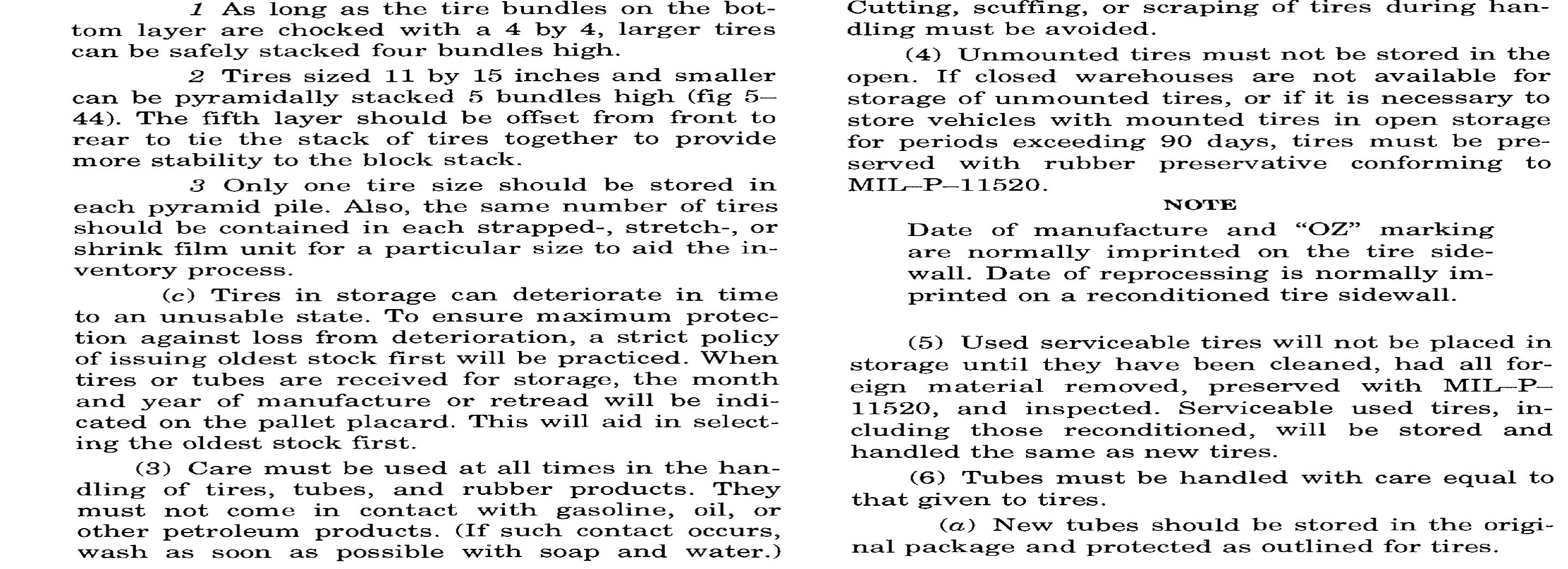

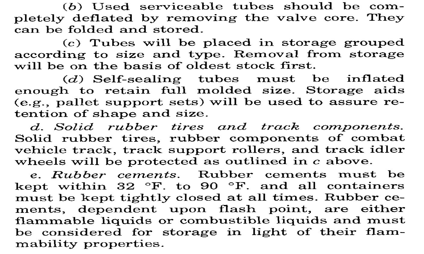

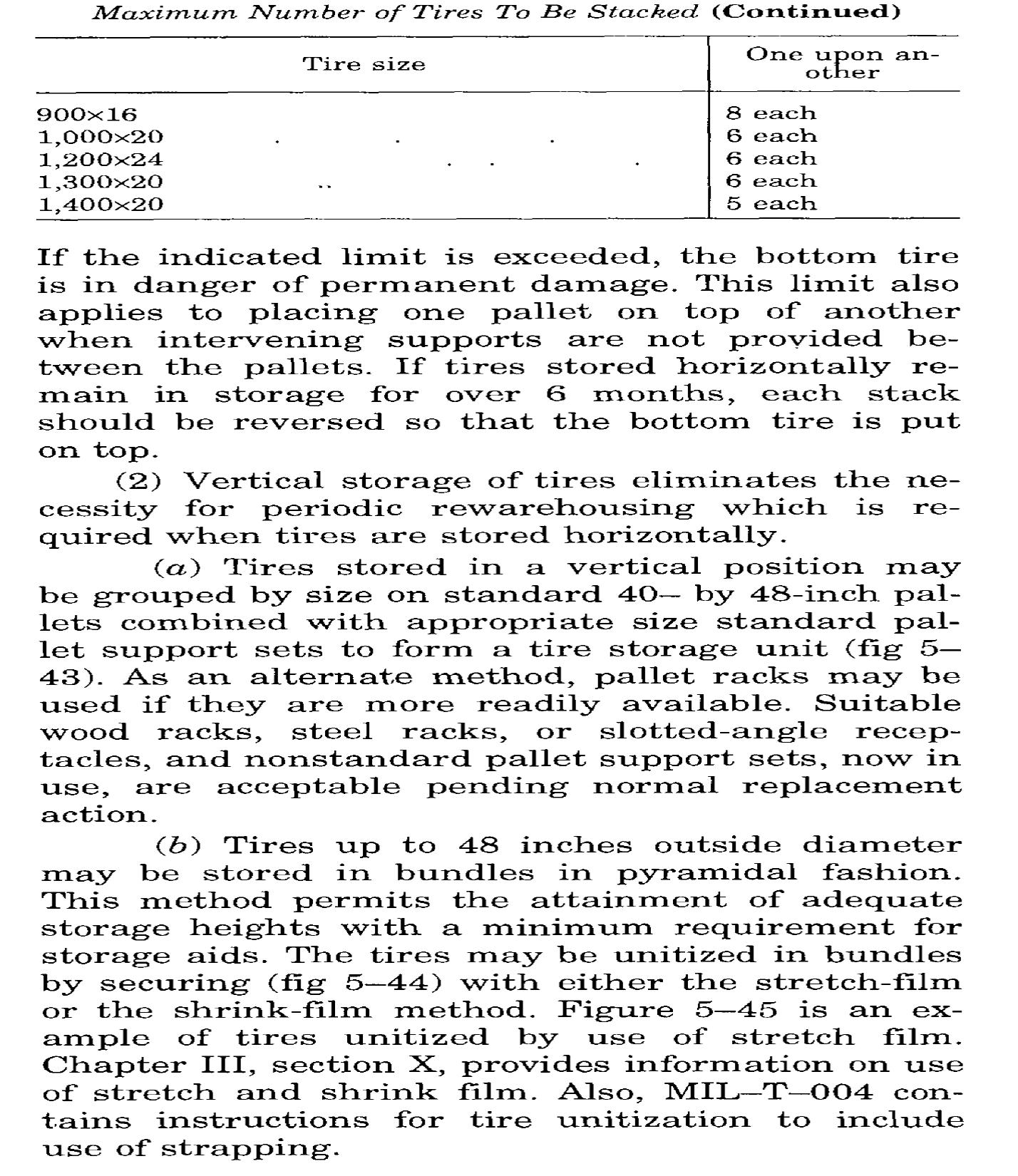

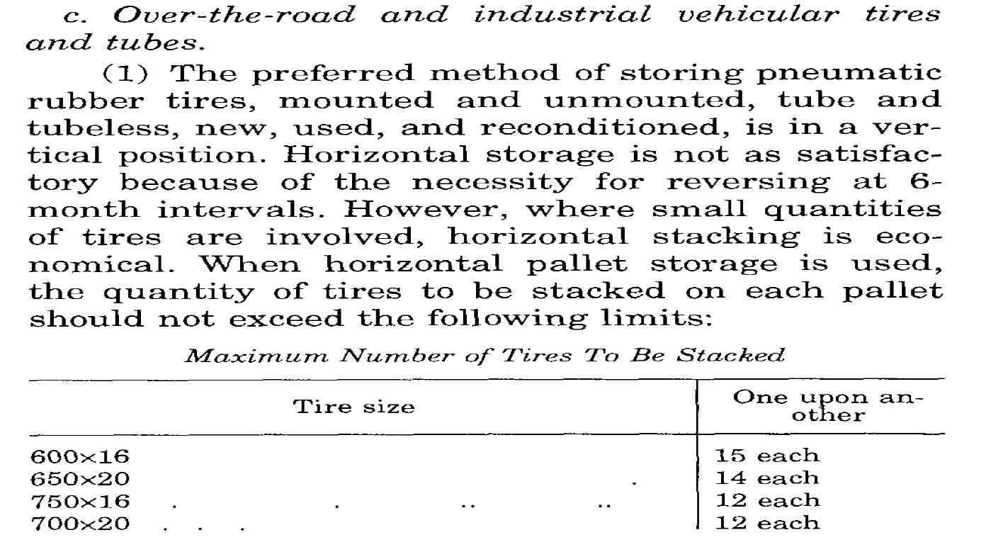

I work for the government and we store just about everything you can think of for all branches of the military. Lots of tires. Attatched is a copy of the storage procedure we have to go by and a lot of our stuff sits in the warehouses for many years before being used. Look at page 5-79 section 5-35 where it begins to dicuss storage of tires. On page 5-80 paragragh 1 it tells you the recommended storage procedures for industrial tires.
Well I tried to attach the whole manual, but the files size is too big (15MB). So I'll try and see if it lets me attach them this way.
