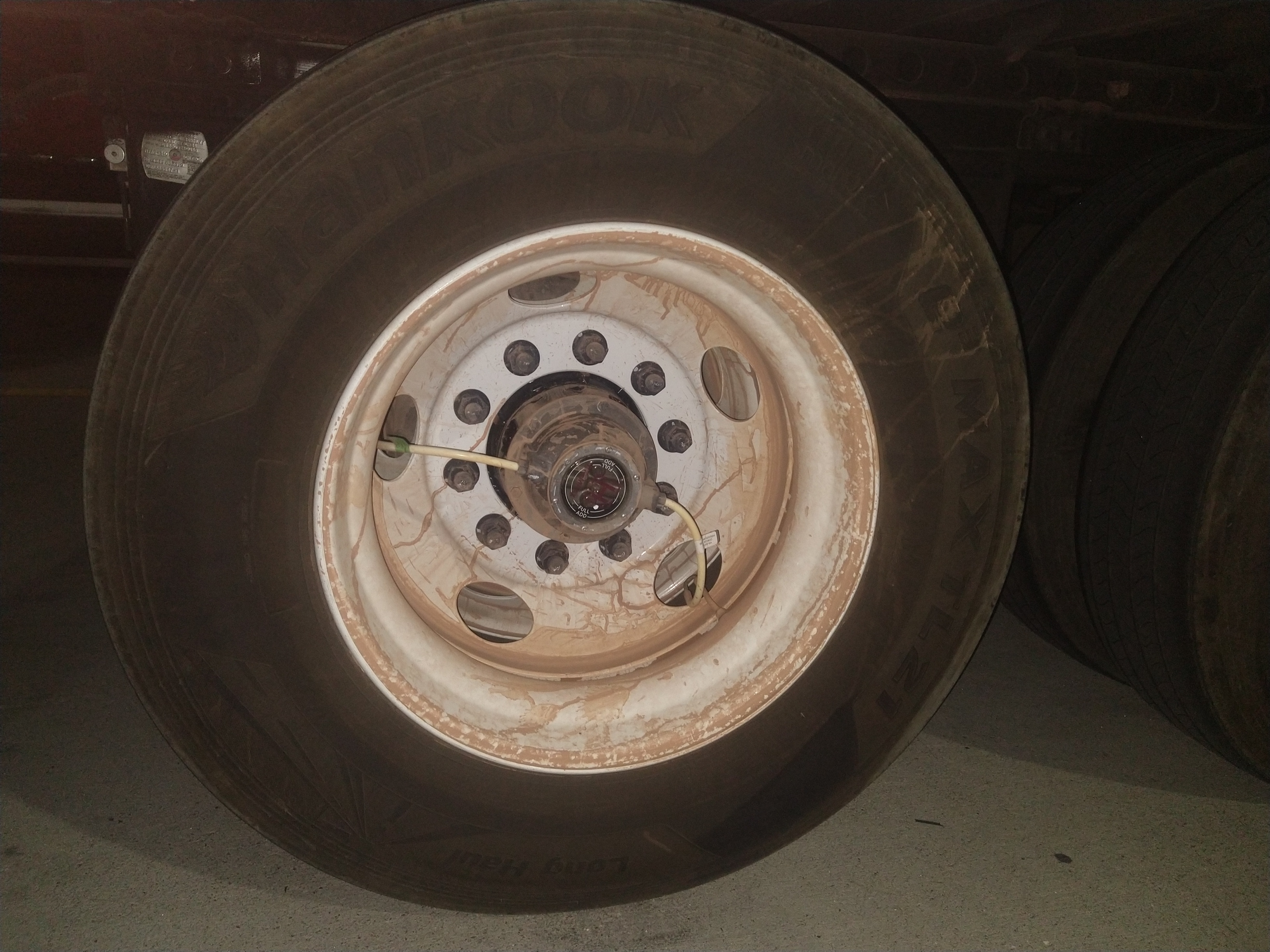

Yes, the SW has lots of tire failures ... I experience mostly trailer tires, which usually are recaps, and usually in the summer ... We run a system on our trailers that maintain 110 psi, and will keep up with a leak from nail/screw puncture, with a light on the front corner of trailer indicating a leak ...
While someone, probably a Mexican driver ... Ran this through the mud .. it's a "new" tire and trailer built in February of this year ... Since we drop our trailers at customers or they cross the border, we install the system to monitor and maintain the air pressure ... We always wash our trucks and trailers before coming to California where I got this trailer from in Saturday.
Blacktop roads ... 100+ degrees air temperature ... Tires get hot just from driving ... Under inflated is also problem if they are not monitored ...
