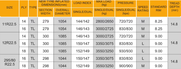

If you considered a more common size, like what I and most 18 wheelers run down the road ... A 295/75R22.5 ... There are many more choices and generally better prices ...
That is interesting, but I don't know if there are any implications or potential issues from changing an 80R tire size to a 75R tire size?
I looked at the tires in the link, and noticed the weight rating of most were about 800# less load per tire. Times 8 tires, thats over 6,000# if I read that right.
The existing 80R's have something I am not familiar with-- a different weight rating whether used as singles or duals.

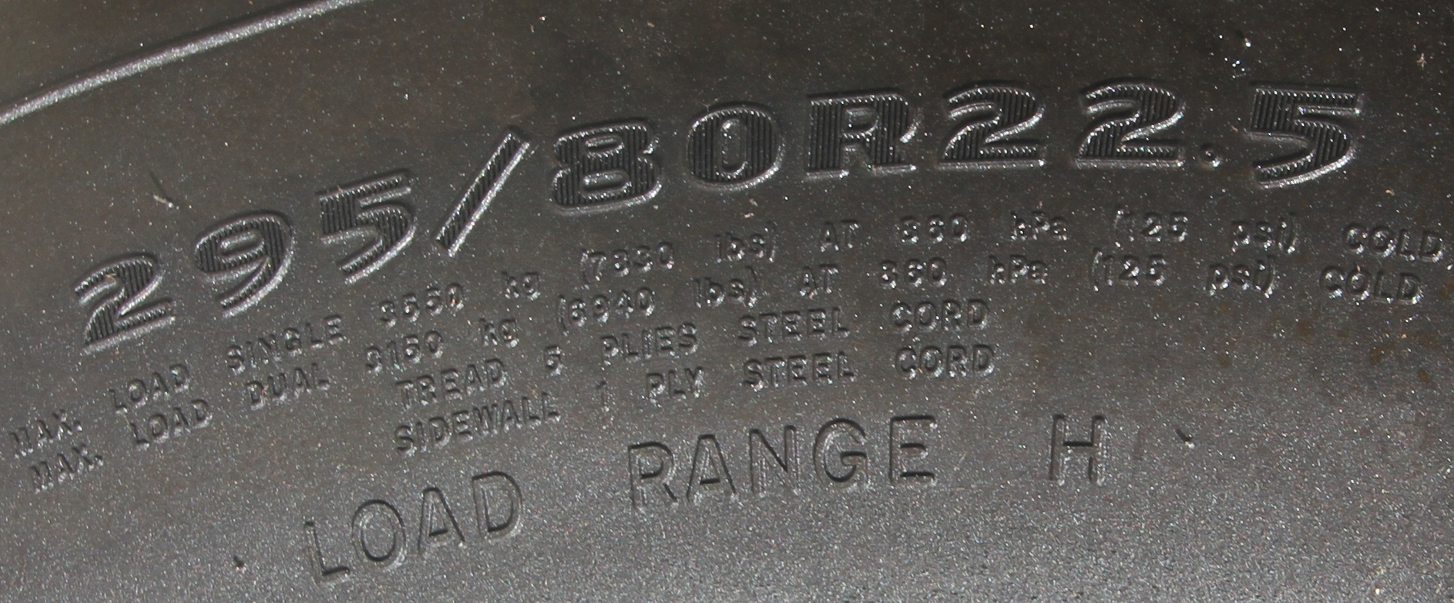

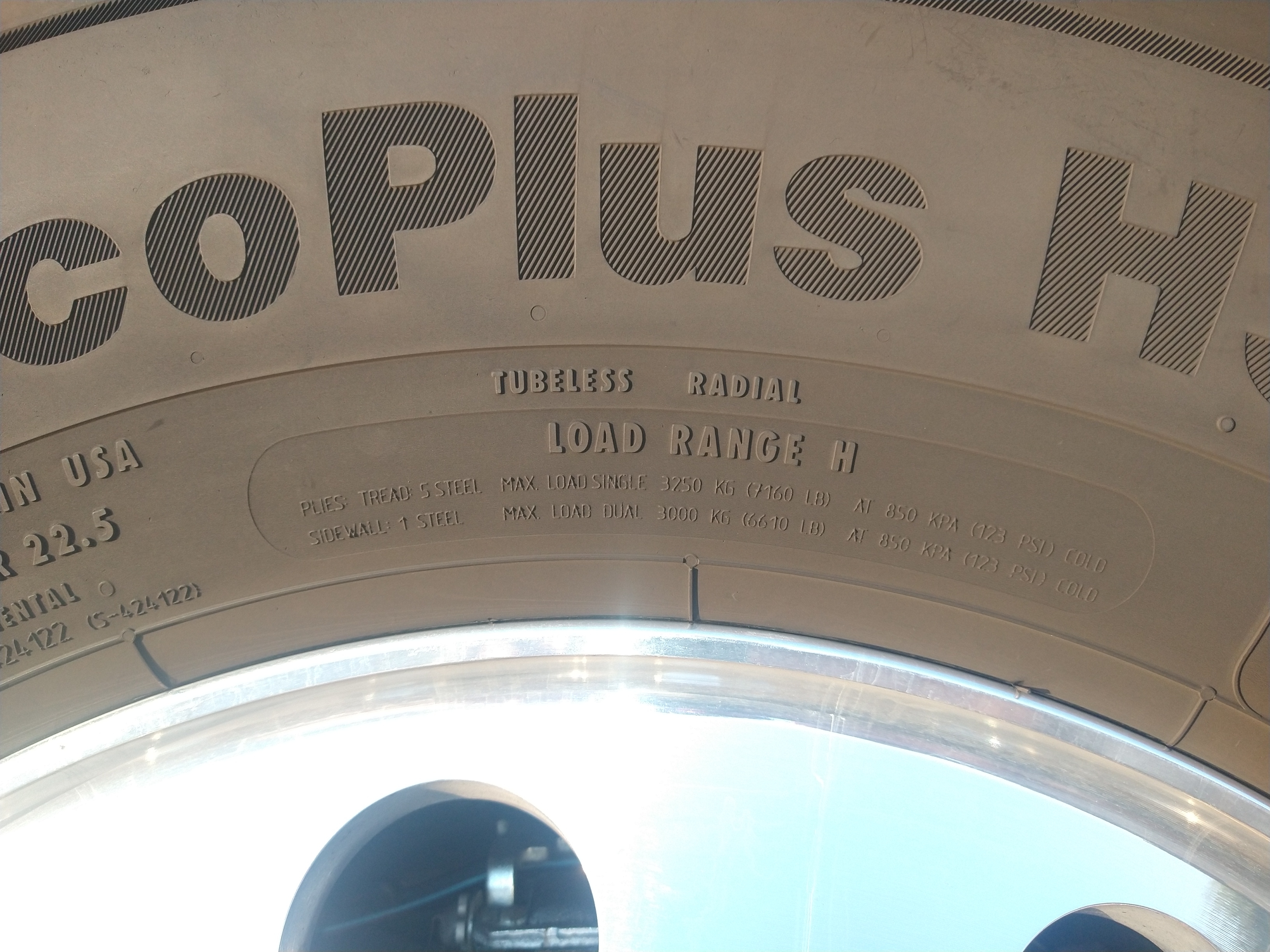

Most all tires of this size have a separate rating for single or duals ...
Here is mine ...
At 6600 Lbs per tire in a dual set up ...is 26,400 Lbs per axle ... Most axles are only rated for 20,000 Lbs, and a tandem axle group with duals (8 tires) is only rated for 34,000 Lbs going down the road, unless you axles are spec'd higher, AND you pay for an overweight permit ...
Going from a 75R to an 80R changes the aspect ratio (tire height to width as a percentage). So the tire would be 11.25mm taller in an 80, from the axle to the ground and from the axle to mudguards, etc. on the RV. The 80 will be stiffer, which translates to a stiffer ride and and more vibration.
