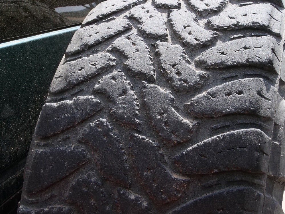

Looks like a Rubicon that has never been off pavement! Because of where I live my rigs drive mostly dirt and gravel roads and those rocks really chew up the tires. Here's a shot of my Toyos at just over 24,000 miles:

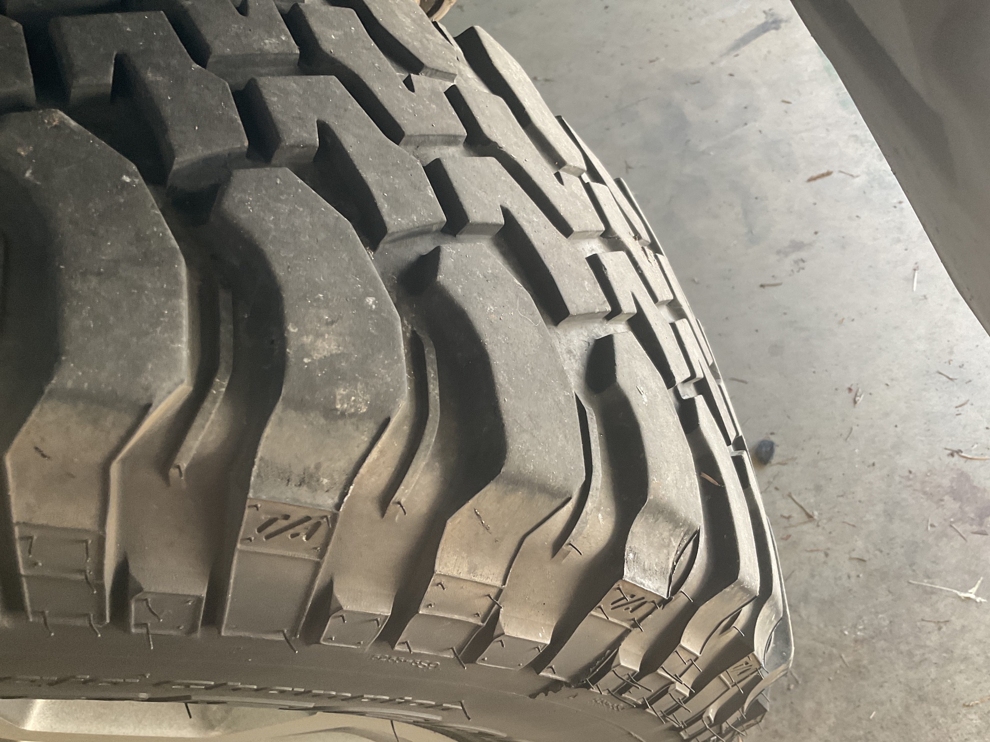

We have a 300+ft. Gravel driveway if that counts!😂😂
