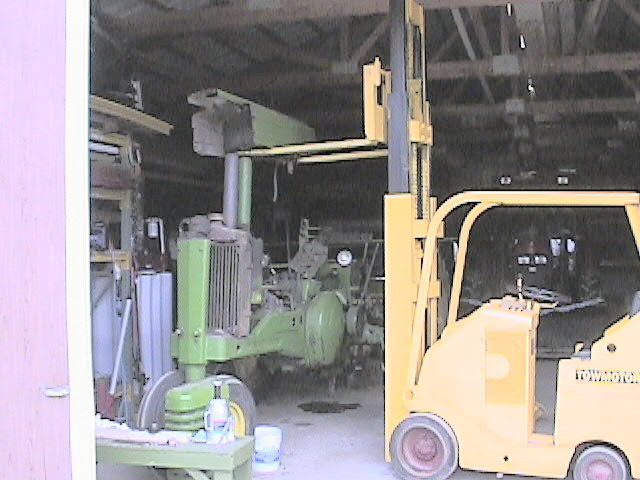

No direct photo's. Here is a JD A being fixed; on left is a rack with 4 shelves, top is the snowmobile rt front spring/ski is visible...
My layout is all materials palletized & racked including lumber 20' feet long. Bottom shelves are min 6" above the floor around perimeter.
Ended up with most shelf spacing 4' for furniture etc. So have a skid of extra 8' beams and decking from my original paper layout.
Everything else is on wheels. tool boxes, eq, work benches, carts. Makes for fast maintenance, no hiden corners. Acquired a 4hp gas powered floor sweeper with hepa filters.
Some caveats: 8' span fits 2 #2 48x40 skids - ok if nothing hangs over!! The higher you go the worse the visibility. Stepladders are dangerous, I acquired wheeled stairs to access small stuff overhead. Also have a boomlift to fly sideways say over a parked dumptruck to pick some copper pipe.
