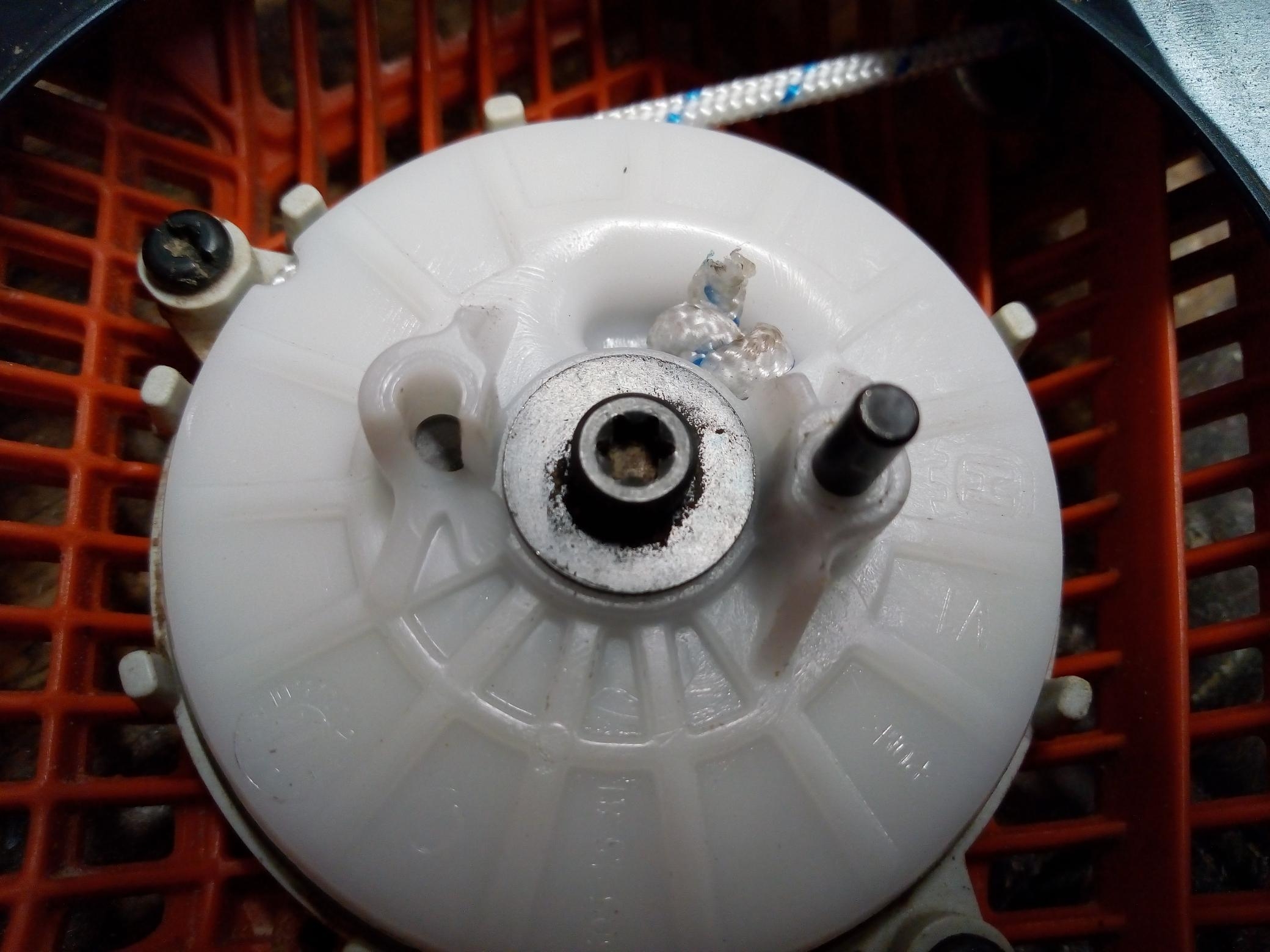

What's a "crank stuffer"?
Goes around crank sort of like a full circle used to be.
Crank I had for 5000 at one time. You get the idea.
357xp used them back in the day too. 359 didnt.
Pic of 562 gen1 that used them.
They actually wear out and can come loose.

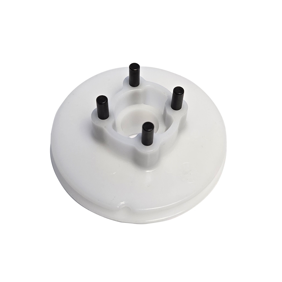

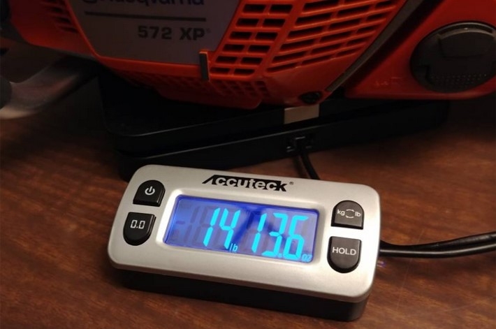

I havent even heard of a MKII 572. If there is should be on decal on recoil like the rest. ?
Dont see any 572 listed as mkII? 572 XP® Gas Chainsaw
PHO weight of 572.
572 has a updated pulley now for those weak 2 prong ones that came out in beginning.
