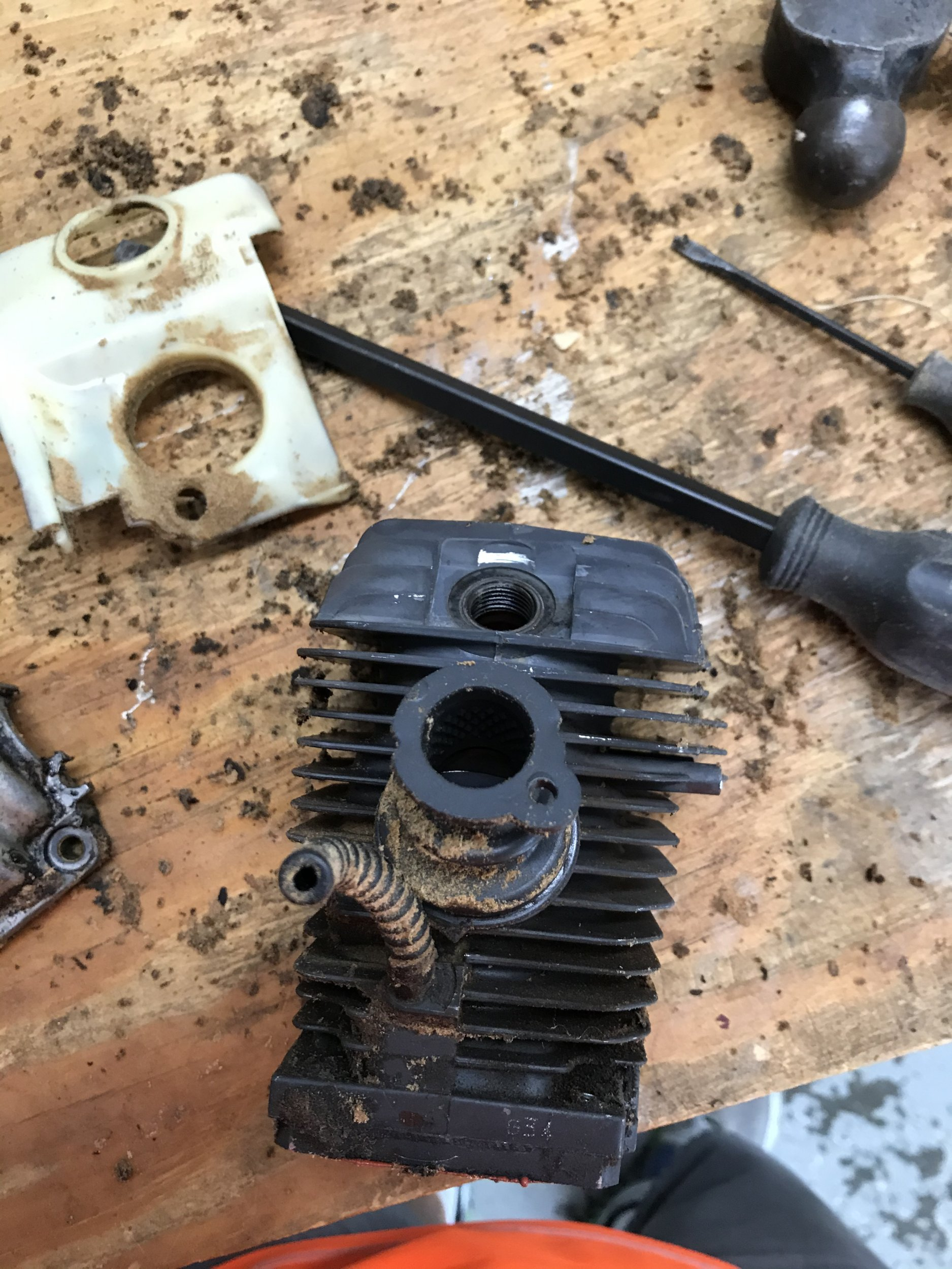

I don’t think you hone them. They have a Nikosol(spelling?) lining, kind of a hardened chrome like substance. You can get a replacement jug and piston for them off of Amazon. I rebuilt my MS250 for $100. I could have got by for half that but bought the “good junk” off Amazon.
I have a MS250 and a MS261. They are to much alike to recommend a 250 for you. Roughly the same weight but the 250 has less power. Why do you want two saws? I’d probably recommend a smaller lighter trimming saw for a second saw. The only reason I have the 250 and the 261 is I bought the 261 when I had a scored piston on the 250, most likely from running straight gas.

Yea you can't hone the plated cylinder linings. But they are hard and durable and sometimes you can clean the aluminum off them and they're fine. People use muriatic acid or some form of abrasive to do this, both very carefully.
The 241 is a sweet saw. I like mine a lot. If it were me I would not give up just because it's seized. I'd tear it down and find out how bad the damage is. If you're lucky you'll only need a new piston and rings. AFAIK there are not any cheap clone parts for the current model CM saws. The clone people tend to stick to obsolete models. If the cylinder is damaged then you'd need to buy one from Stihl.

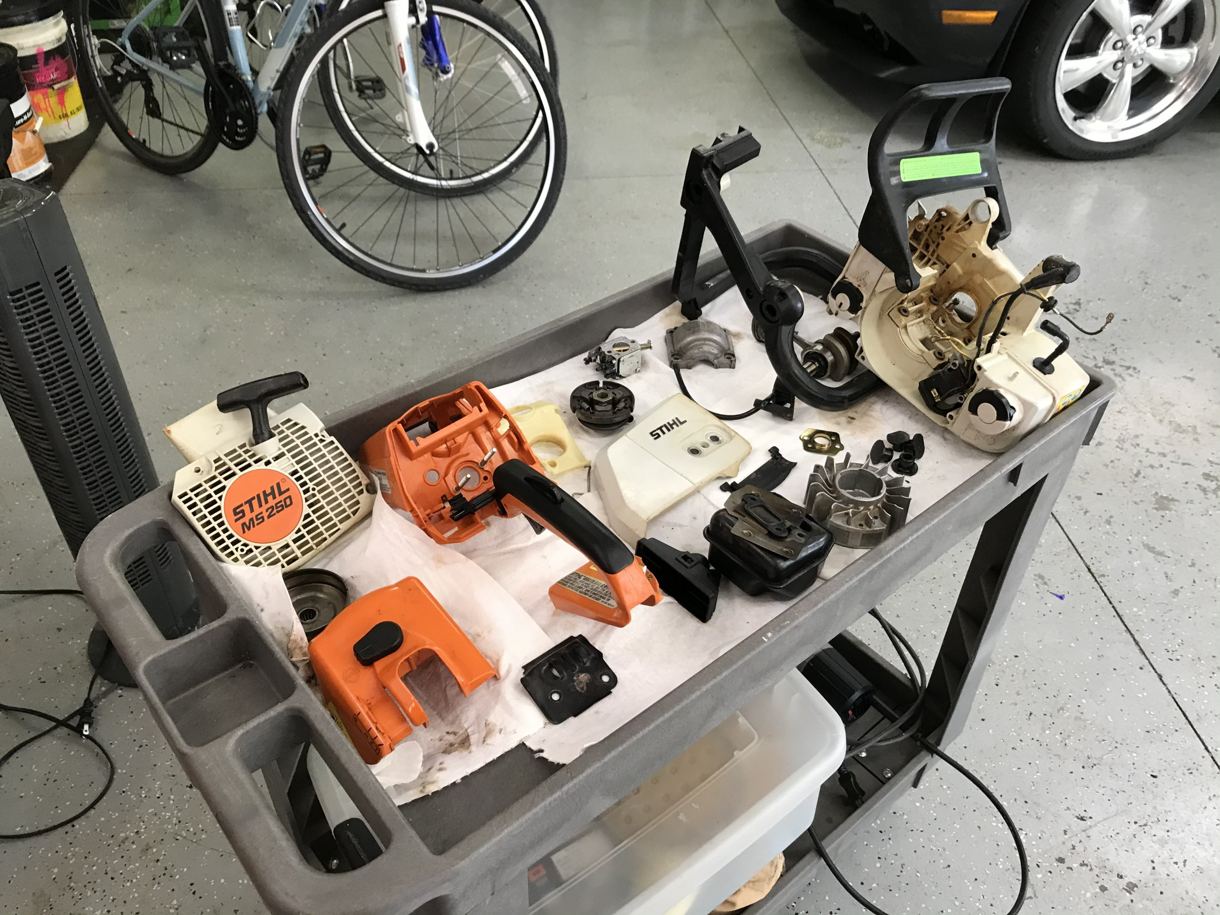

They are pretty simple to rebuild. It always seems intimidating but it’s really not. This is most of the parts from when I rebuilt my MS250. Eric on this board helped me some picking out higher quality parts. I spent much more time cleaning oil and saw dust off than actually taking it apart and putting it back together.
View attachment 771100View attachment 771101
I agree. The smaller Stihls are not really problem to take apart
I rebuilt my 250 when the plastic caged bearings let go.
