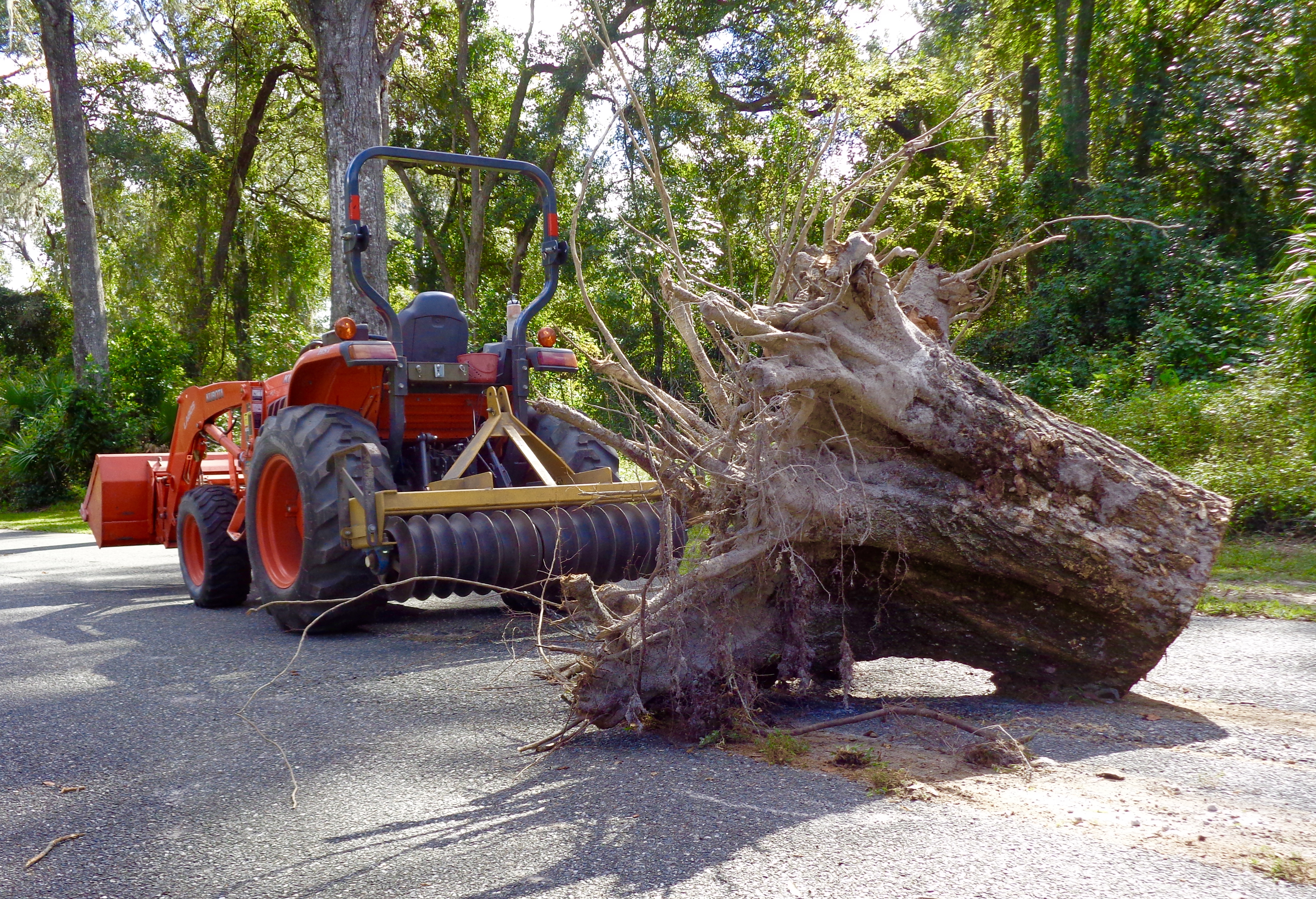

I took delivery of Stihl MS 461 yesterday, with Stihl recommended #3624 (33 RS3 84) OILOMATIC saw chain and 25" 3003 000 4030 Ematic guide bar combination.
At age 70 I can start it OK. My Stihl professional MS 261 saw, purchased new in 2013, became easier to start after wearing in. I expect the MS 461 will be the same.
Bar and chain combination is a little front heavy. It is fine for cutting the 36" to 48" diameter, grounded Water Oak tree trunks I need to section, so I can move them with the tractor FEL.
I will not be using the MS 461 unless most of the bar is in a tree.
Too cumbersome and potentially hazardous for trim work, with my strength.
I have been using chainsaws for 30 years without injury, a record I wish to maintain.
