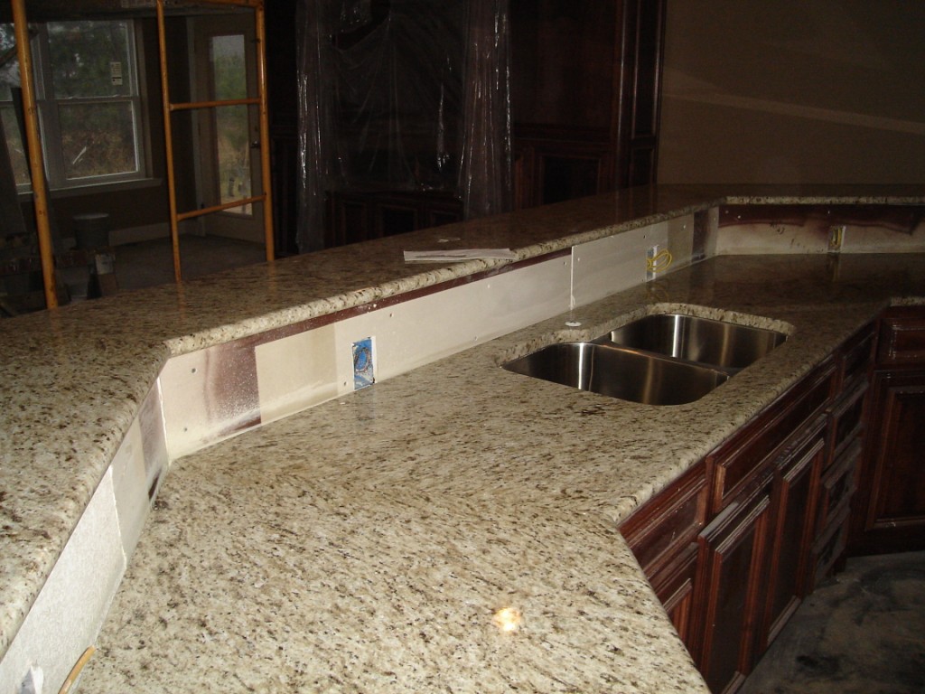

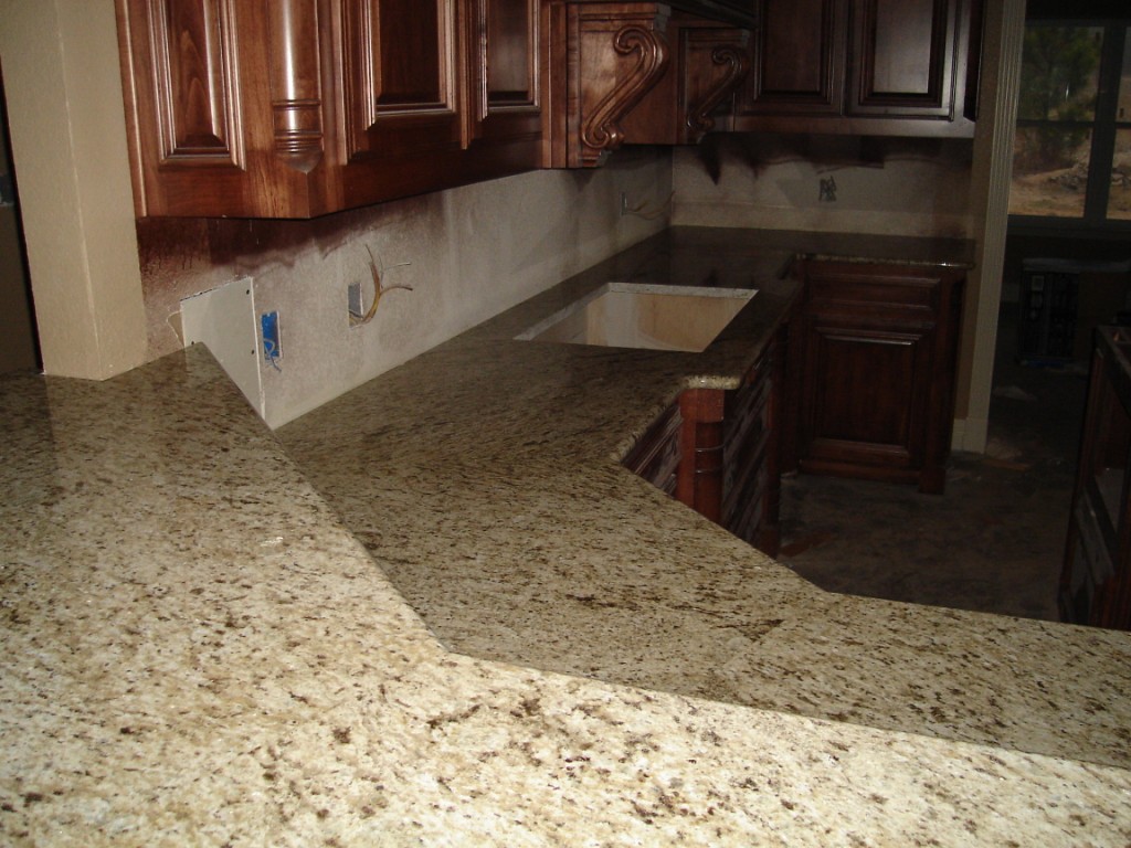

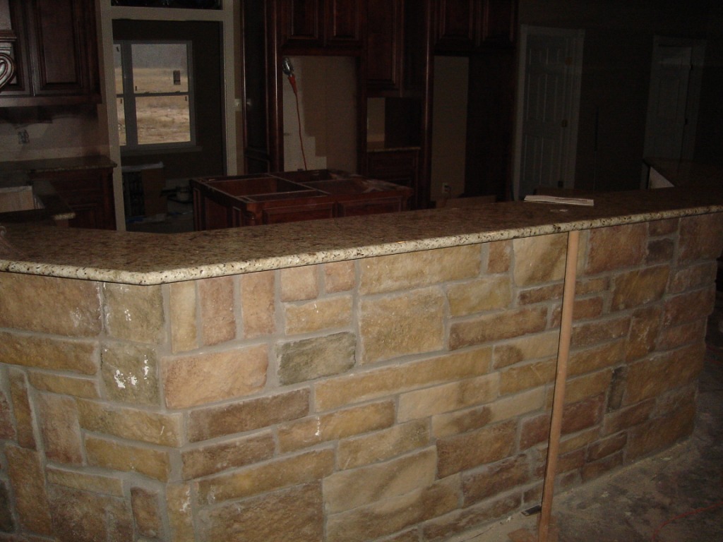

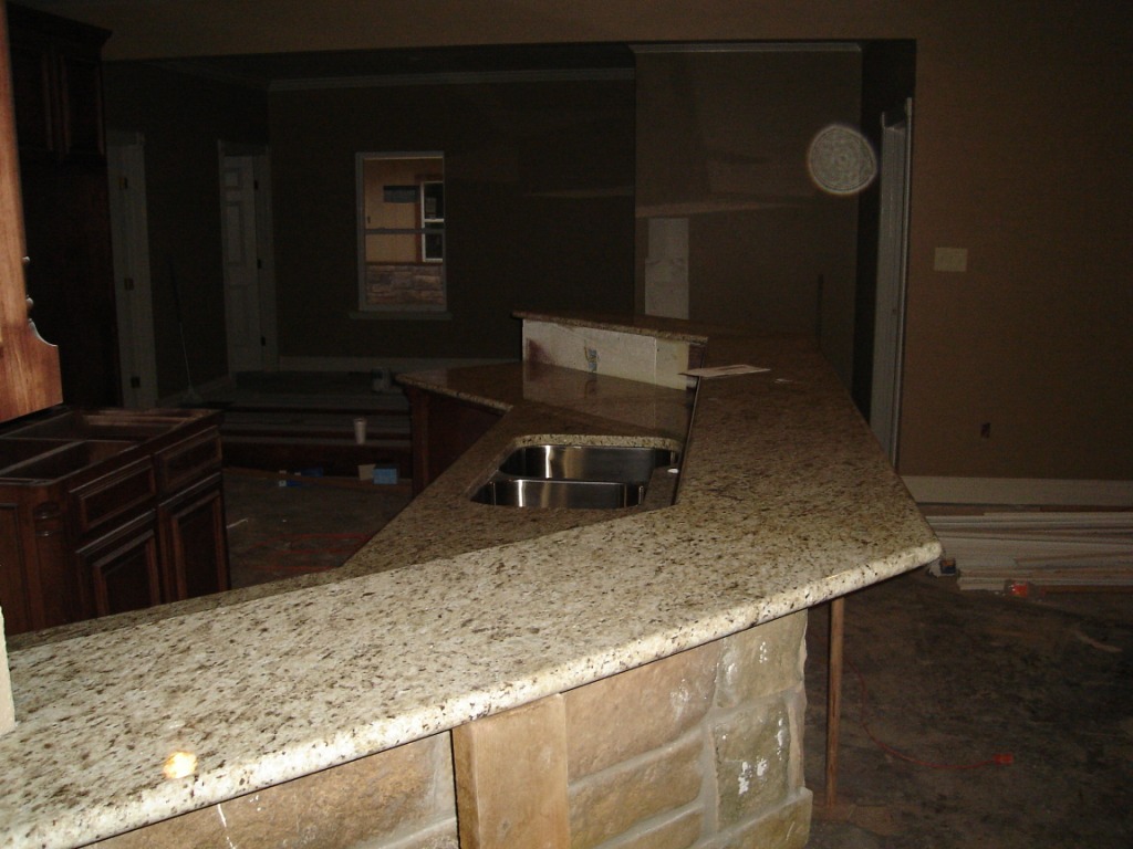

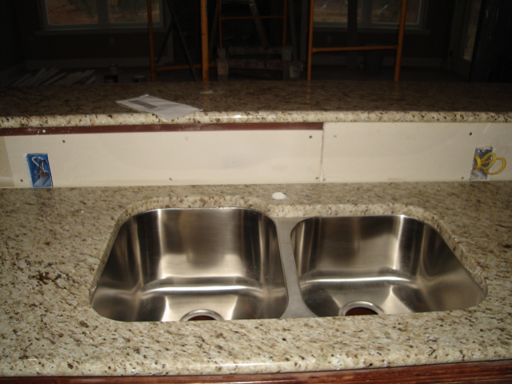

Well they have installed the countertops, I had to go look this morning to see what they looked like. So here are the pics.

WOW!!! It has been a while since I have caught up on the progress. It looks amazing. I agree that the colors in your kitchen look awesome. Would you mind telling me what the color is on your cabinets? Did you stain them yourself? They look great. I think the color of your granite contrasts very well with the cabinets.
