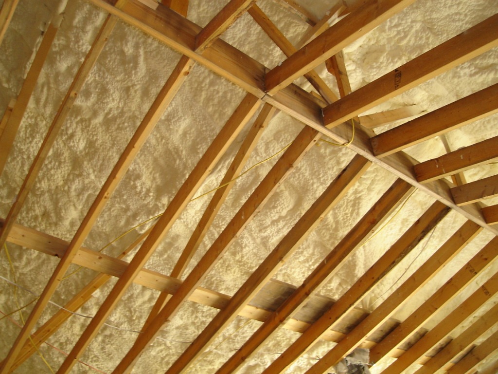

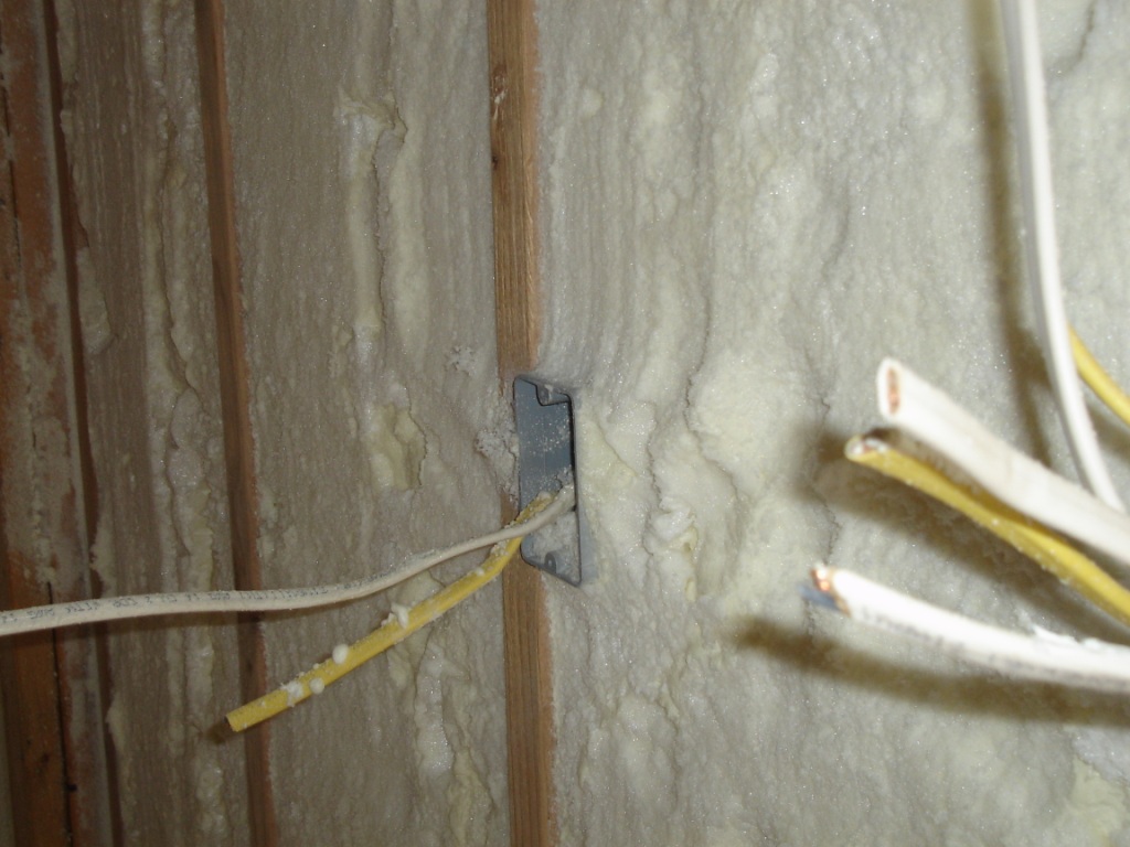

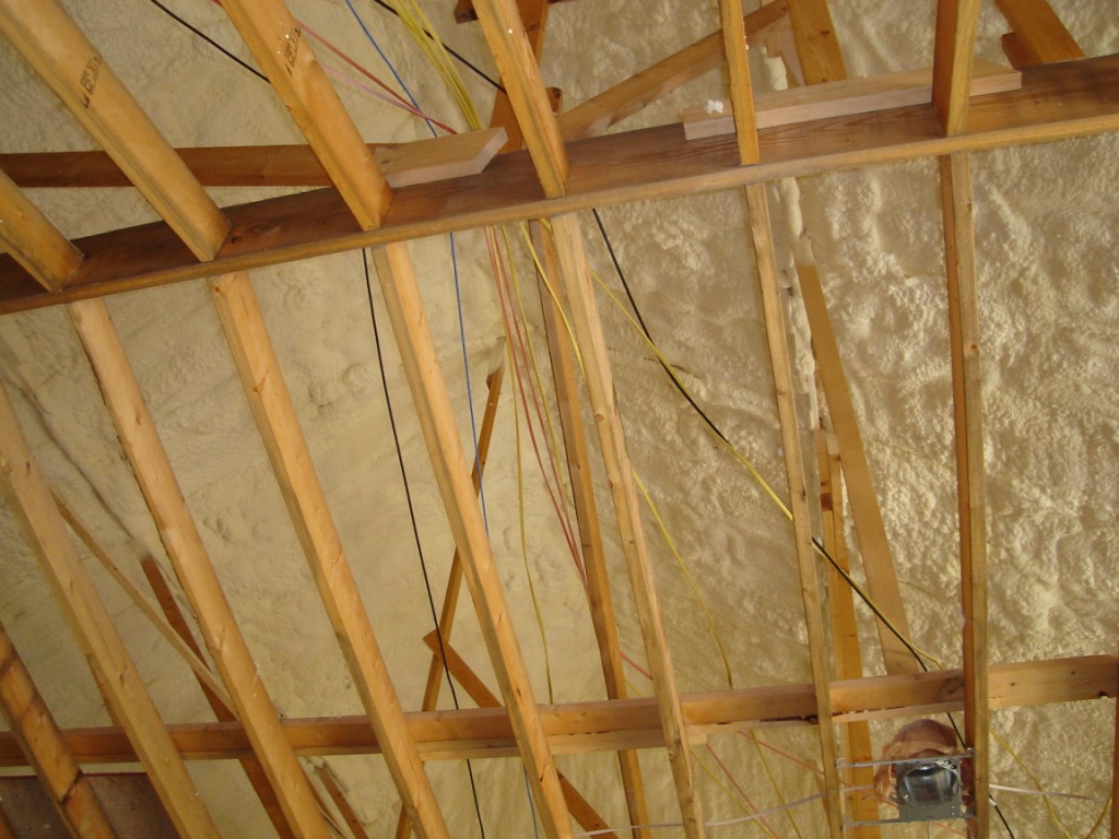

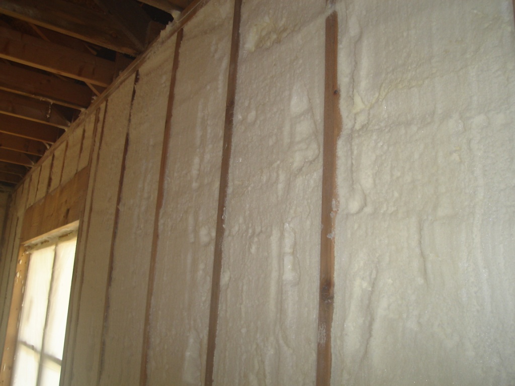

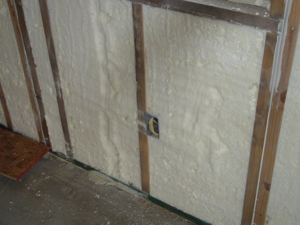

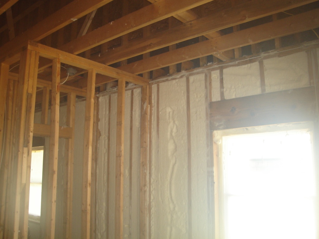

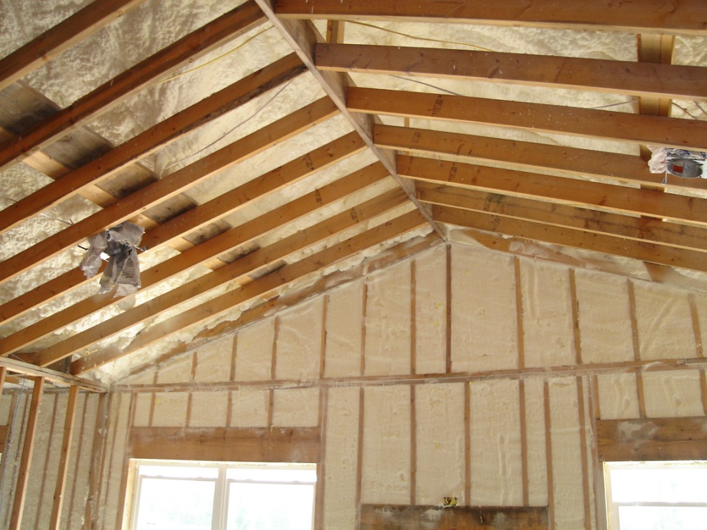

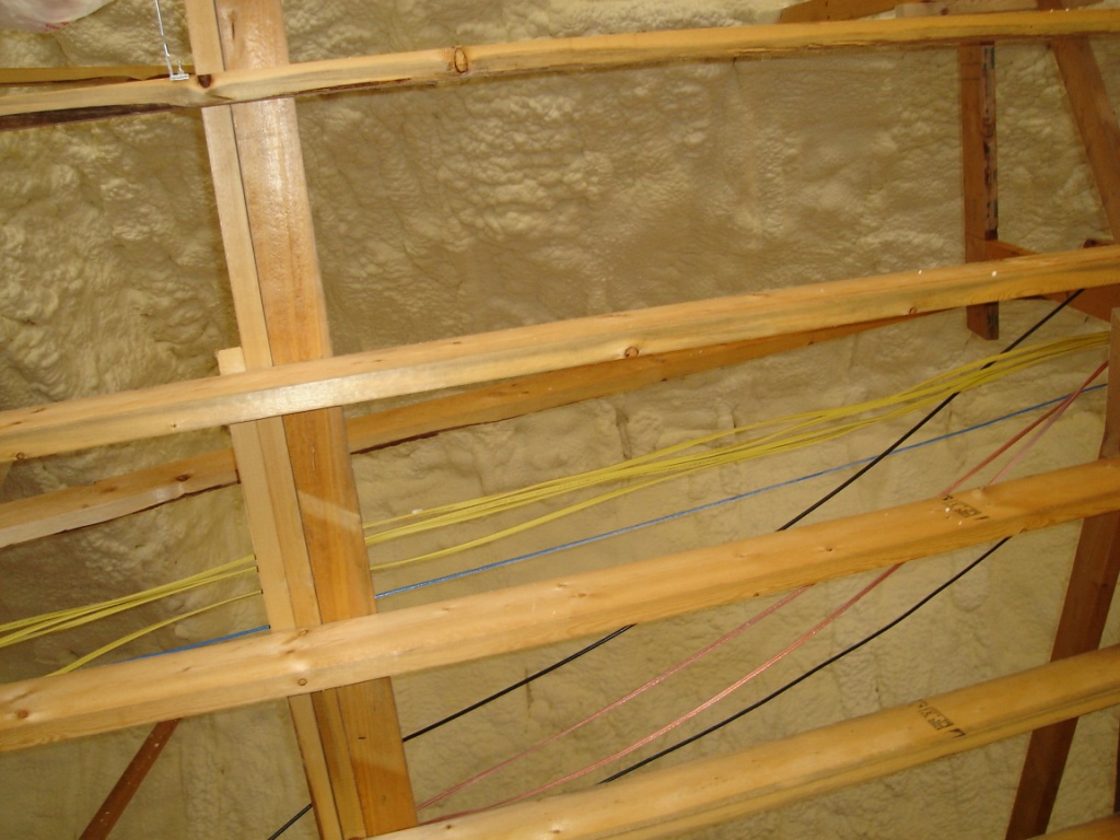

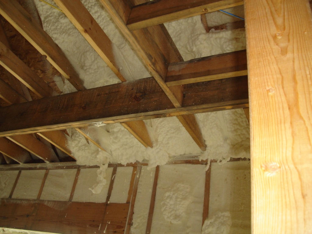

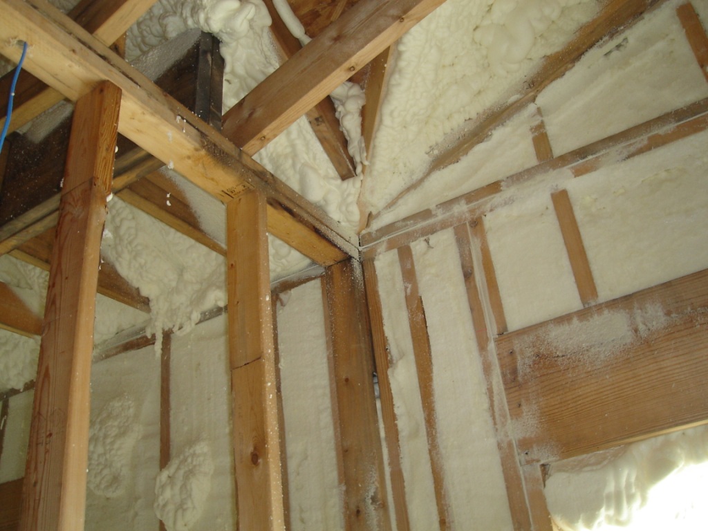

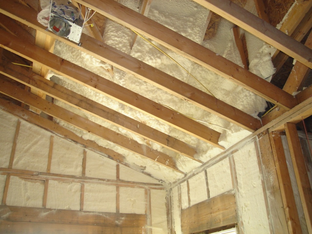

Well the Insulation Guys have started to spray the foam isulation. I am doing the sealed attic with no ventiation, which keeps the A/C unit under a controled enviroment. I am also filling up the wall space which is a 2x6 exterior walls. The Foam has a R value of 3.82 per inch, so the walls are going to be a little more than R21 and under the roof may be a little more than that because he is covering the rafters. They have almost finished the walls and are going to start on the roof today. Here is a couple of pics I took yesterday.

The insulation has been finished, and I am very pleased. I was up there on Sunday and we had all of the windows opened and it was very cool in the house. It was cooler in the house than it was on the porch. Here is a few pics of the foam insulation.

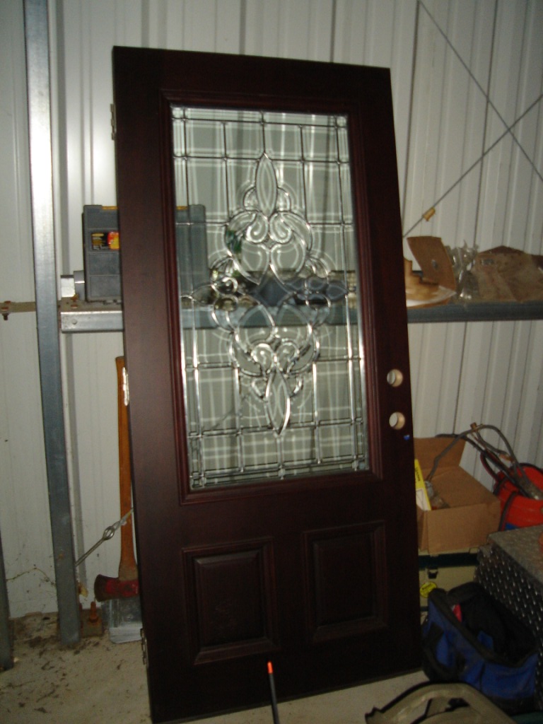

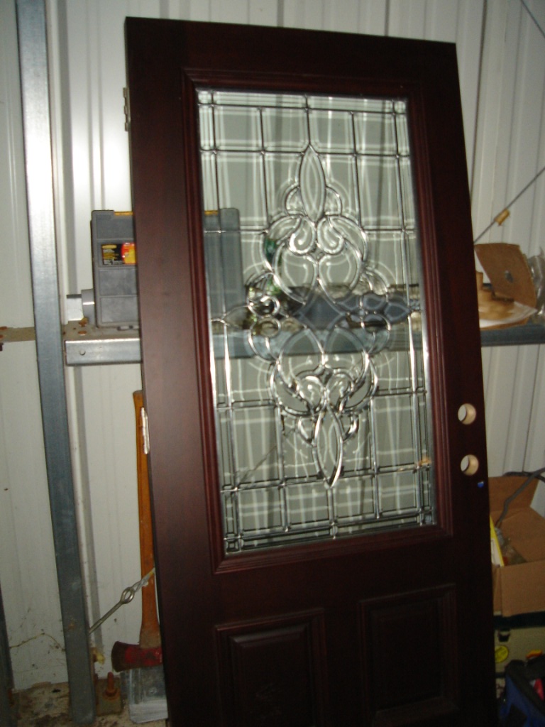

Also we have found a front door that my wife likes, it is a mohogany wood door. We got a steal on it as well, we paid $699. for this door. All of the mohogany doors we looked at started at $2000.00. We have not installed it yet, we are going to put another door on the house for right now because we do not want to damage this door with all of the construction going on. Here is a pic of it

SR16009,
your home looks fantastic!!!! That foam insulation looks awsome. And I totally, totally love the front door. That was really a steal! I noticed how nice your stone matches the roof and the short roof connectiong the garage to the hosue also gives a very smooth transition.
Notice how few comments you get similar to "have your contractor change this or that etc" It is a credit to your builder that noone here is offering improvement/rework suggestions.
We are all jsut along for the ride and honestly your home is coming out great. Can't wait for more progress and pics actually.

I've been reading some reports about whole house insulation and encloseing the attic space with the living area. From what I've read and understand, it's cheaper to heat and cool a home this way. It's allot more money, but it also looks like the way things might go. I haven't done it myself, or even seen it done in person, so I'd be very curious to hear what you think about it after you've lived there awhile.
Do you know the difference in price compared to if you'd have insulated with fiberglass?

I am kinda curious myself to see how everything is going to work. I read up about this type of system and finally convenced myself this is the way to go. The price really was not as bad as I first thought. The Foam cost $10,600 and my contractor told me it would cost about $4200 with the fiberglass. Also consider I am going to use a 4 ton A/C unit with the foam and I would have to use a 6 ton unit with the fiberglass. That is saving me about $3500. Yes foam is still more expensive, but if you are planning on living in the house for very long I believe this is the way to go.
I guess we will find out how well this system works.
/ Starting a new home #110
Thanks. I never thought about using a smaller AC unit with foam compared to fiberglass. That price difference really puts the two systems closer together.
Eddie

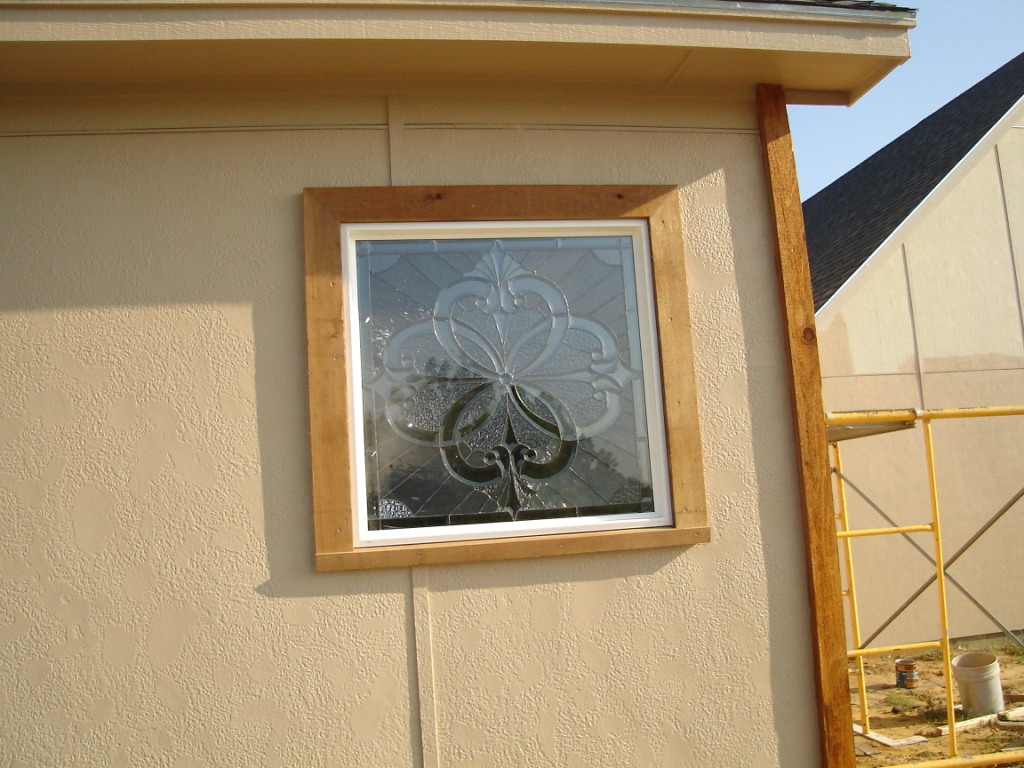

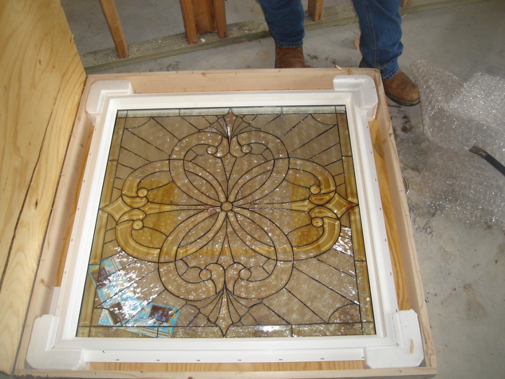

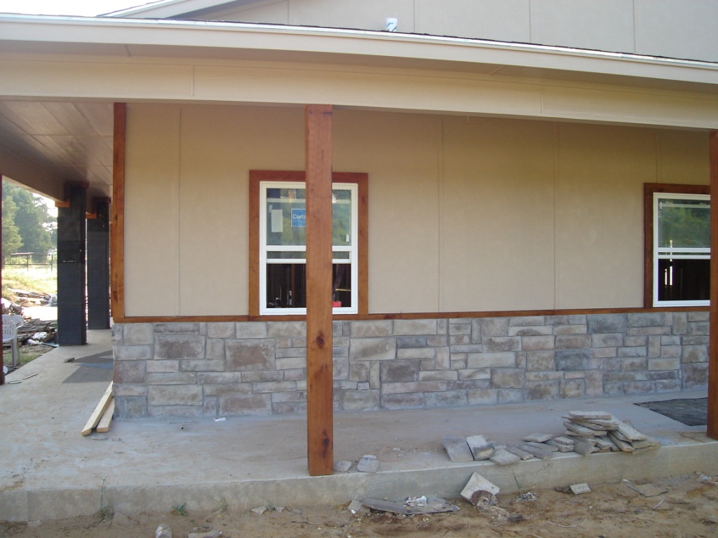

Update,
We finally received our bathroom window and the transom window that will go in the kitchen. They look very good, we are really happy with them. Also the garge doors are hung and the garage is pretty much done. The rock people are coming back this week to finish up on the outside and the fireplace. Also we are going to dry wall it in this week, so everything is going to look a lot different.
Also we have painted most of the house, the cedar we just sealed for a more natural look.
Here is a few more pics.

sr160009,
Its coming around. That window is beautiful! Did you get it locally or order it somewhere? Keep the pictures coming, they are great.

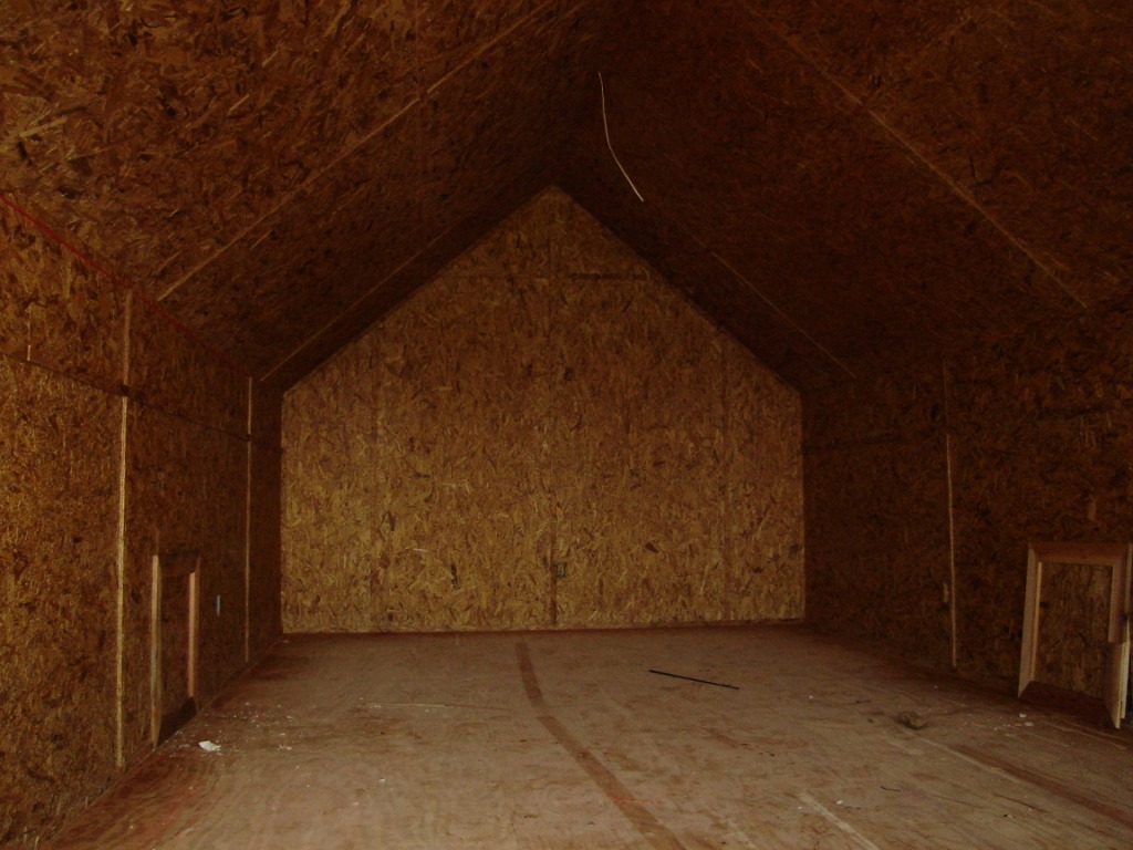

We are going with the recessed lights in the living room and kitchen, but that is it. We do have a room above the garge that we are going to use as storage right now. We may turn it into a game room for the kids later on. I like the idea of a drive though garage but the layout of my place just was not right for one, but I do have the drive though on my 40'x40' shop.
