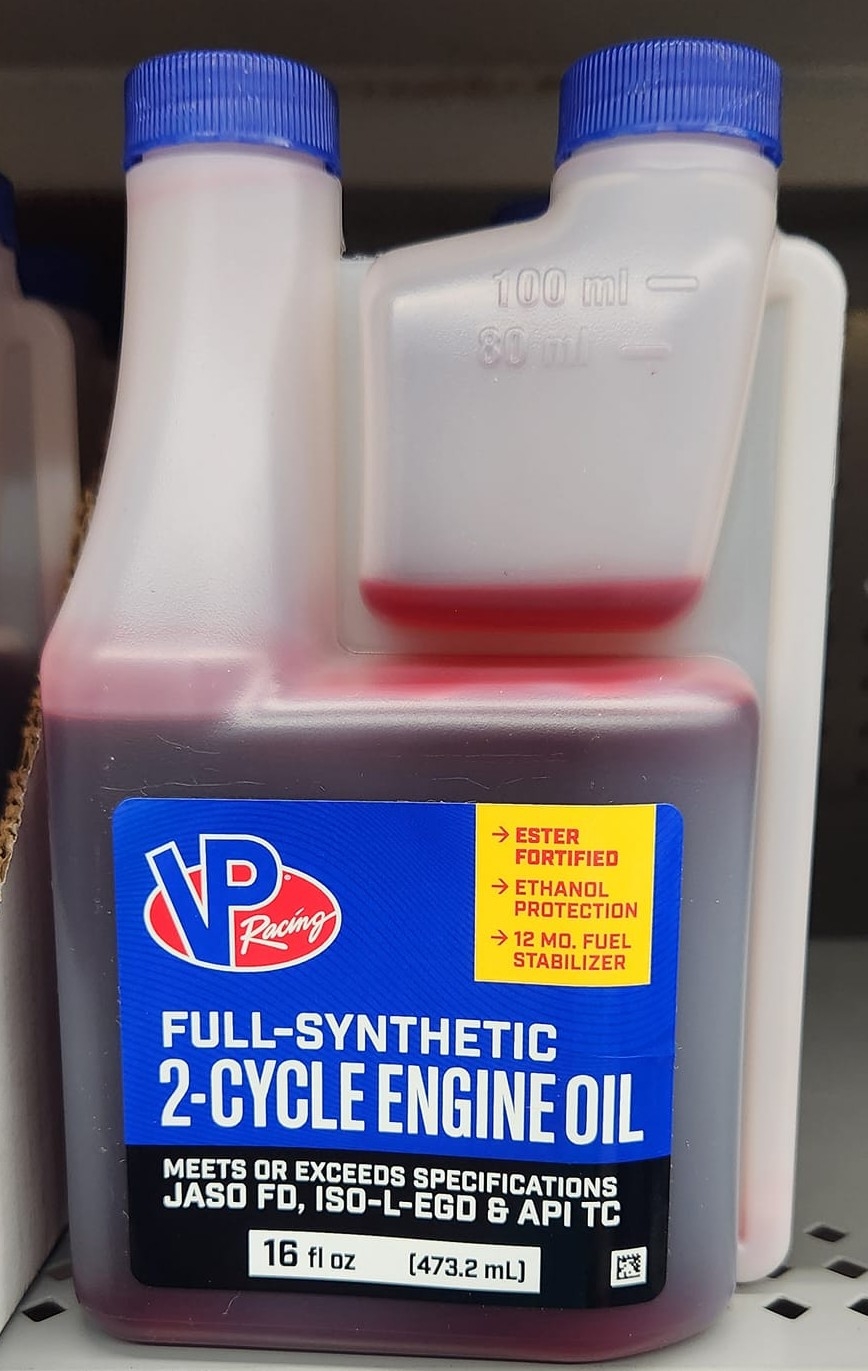

Most of the name brand mix oils also contain a fuel stabilizer (at least all of the ones I have ever used do). I certainly agree that E0 fuel is he way to go, if you can get it. I have no hard evidence, but I suspect that has a far larger effect on engine and carb longevity than whether someone uses a stabilizer or not. The shelf life of E0 is longer than E10 or E15 gas. I add stabilizer in every 5 gallon can of E0 I buy for my small engines, mainly because I'm never sure how quickly I will use it up. I only mix a gallon at a time of fuel for my 2 cycle engines. Yes, the stabilizer in the mix oil is probably redundant. On the other hand, the only 2 cycle engine I've had fuel/mix-related problem with is the brush saw I lent to a friend who straight-gassed it.

Echo Red Armor (red dyed, not the base Echo oil that is blue) and the Stihl HP (orange Bottle, not the cheaper grey bottle) both contain your fuel stabilizer in the oil.
Actually, the Stihl orange bottle is the cheaper stuff. They claim the gray bottle is their “high end” 2 cycle oil.
I used the Stihl gray bottle stuff for a while, since it is one of the easiest to find in my area. I stopped using it when I started seeing a lot of reviews panning it on a couple of chainsaw and Forestry websites.
Switched to the Husqvarna XP+ oil (gray bottle). It’s been working well for me for years now. My only complaint is that I wish their larger bottles had a built-in measuring system for measuring 2.6 ounces accurately. I prefer to mix a gallon at a time, but it just seems wasteful to keep buying those individual 2.6 ounce bottles. (I did order one of those “RatioRite” measuring cups, but it’s not very convenient for me.)
/ Stabil in the mix? #60
Used to use Stihl in gray bottle but started having carbon issues in exhaust plugging up. Switched to Echo Red Armour and problem disappeared. Have used Red Armour for around 6 years now with zero problems.
