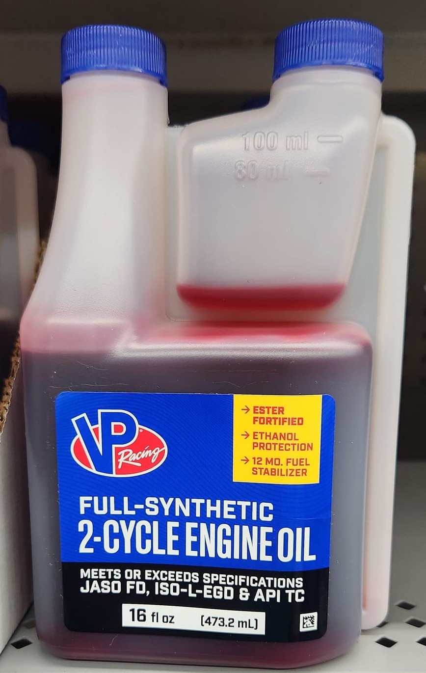

If you can find this VPracing. Buy it. Has built in measurer.
It's 100% synthetic and does what RA used to do when original formula. RA is still semi syn but changed to cheaper formula.
Seems to be everywhere here. Cheaper to buy then RA too.

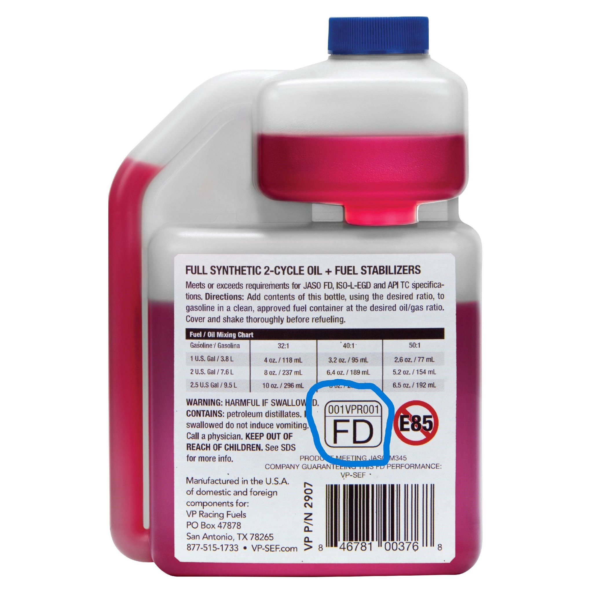

I went and looked at a 2023 thread and there is 100's of FD rated oils that past the testing. Stihl ultra is only a FB rated oil and stated by stihl=
JASO 2 stroke oil ratings as of 1 August 2023
555 oils tested. Stihl only has one oil FD rated but not sold in US.
JASO FD oils are defined for higher detergency and engine cleanliness performance as well as meeting the lubricity and low smoke requirements. JASO FD oils deliver superior performance to both JASO FB and JASO FC in all the evaluated areas. They are designed for use in two-stroke motorcycles and small engine equipment.

Just buy a FD rated oil. If you want it to clean too.
It is same as FB FC but has the cleaning detergents.
I have not seen a bad FD oil myself. They all do what they were designed for.
FD corresponds to higher detergency properties than the other two grades, meets the lubricity requirements and has low smoke requirements.

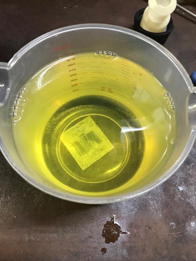

The only drawback to me on VP is they dont sell in quarts or gallons to date for some reason.
So I just mix a whole 16oz to 5 gallons at a time or 3.2 to a gal if not going to use it up.
