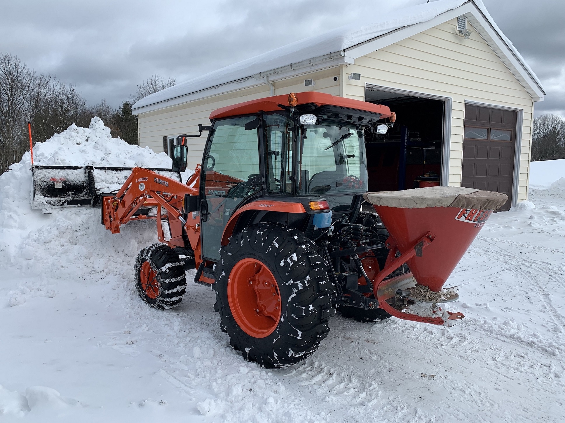

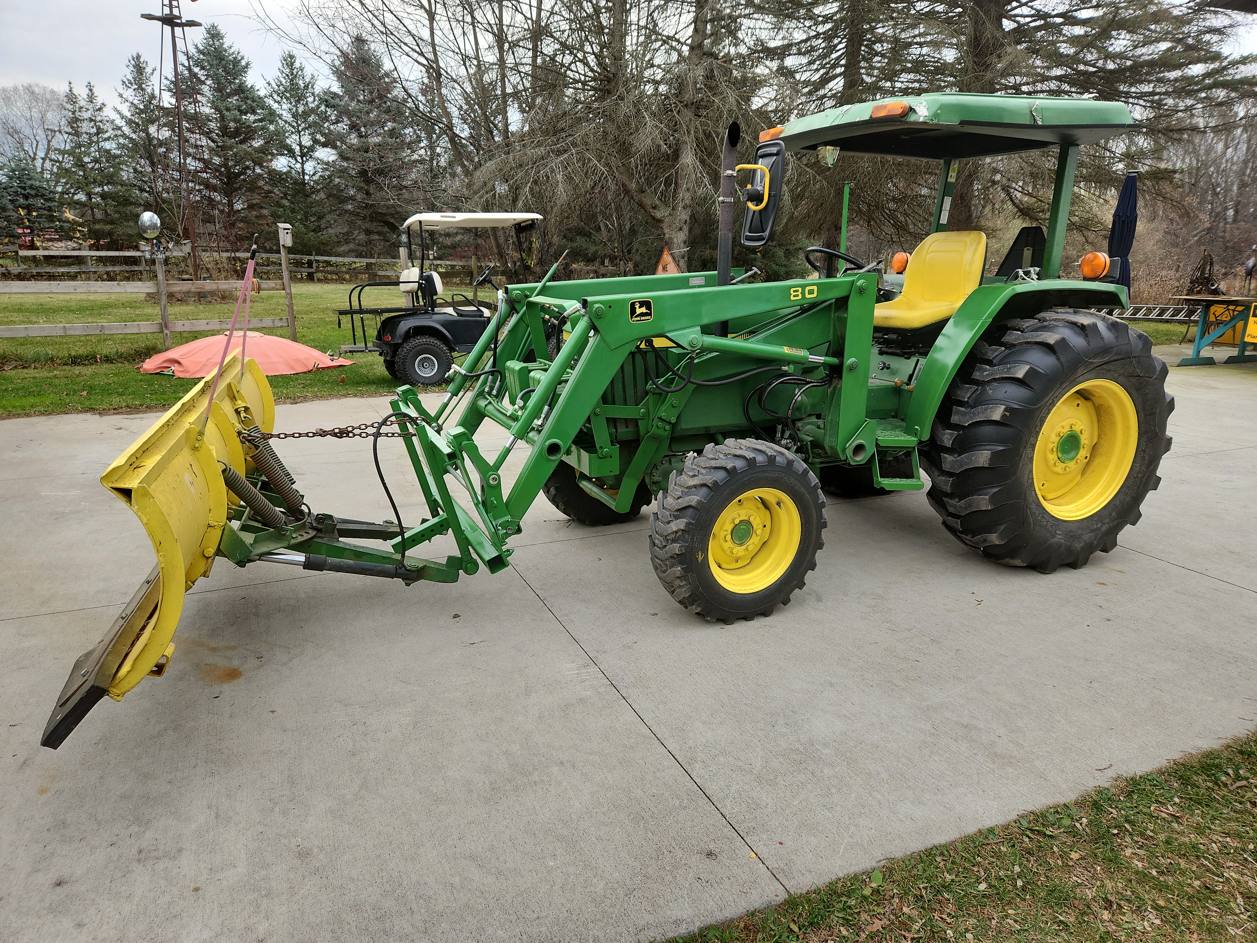

Made my own using an ancient PU truck plow. Yes I have the JD QA plates, but the skid steer plates are cheap, then just add some pins. I don't even use the 3rd function anymore. I borrow the curl circuit one a specific angle is planted. I had to get used to the length out front.

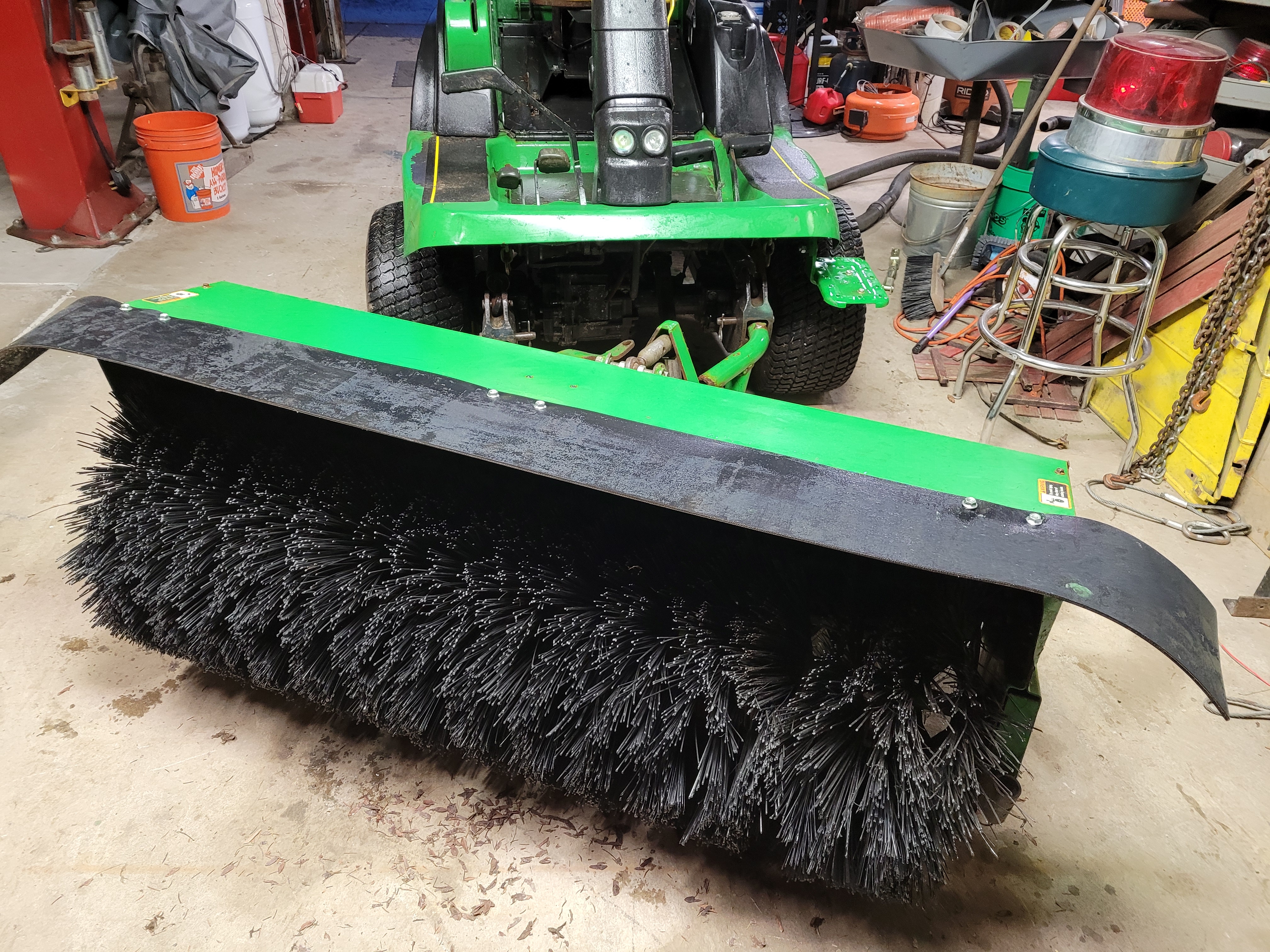

Since then, I've gone to using a 60" broom for snow on my lawnmower (JD-1435) 90402086.jpgIMG_20221111_095321_01.jpg20231231_171927.jpg

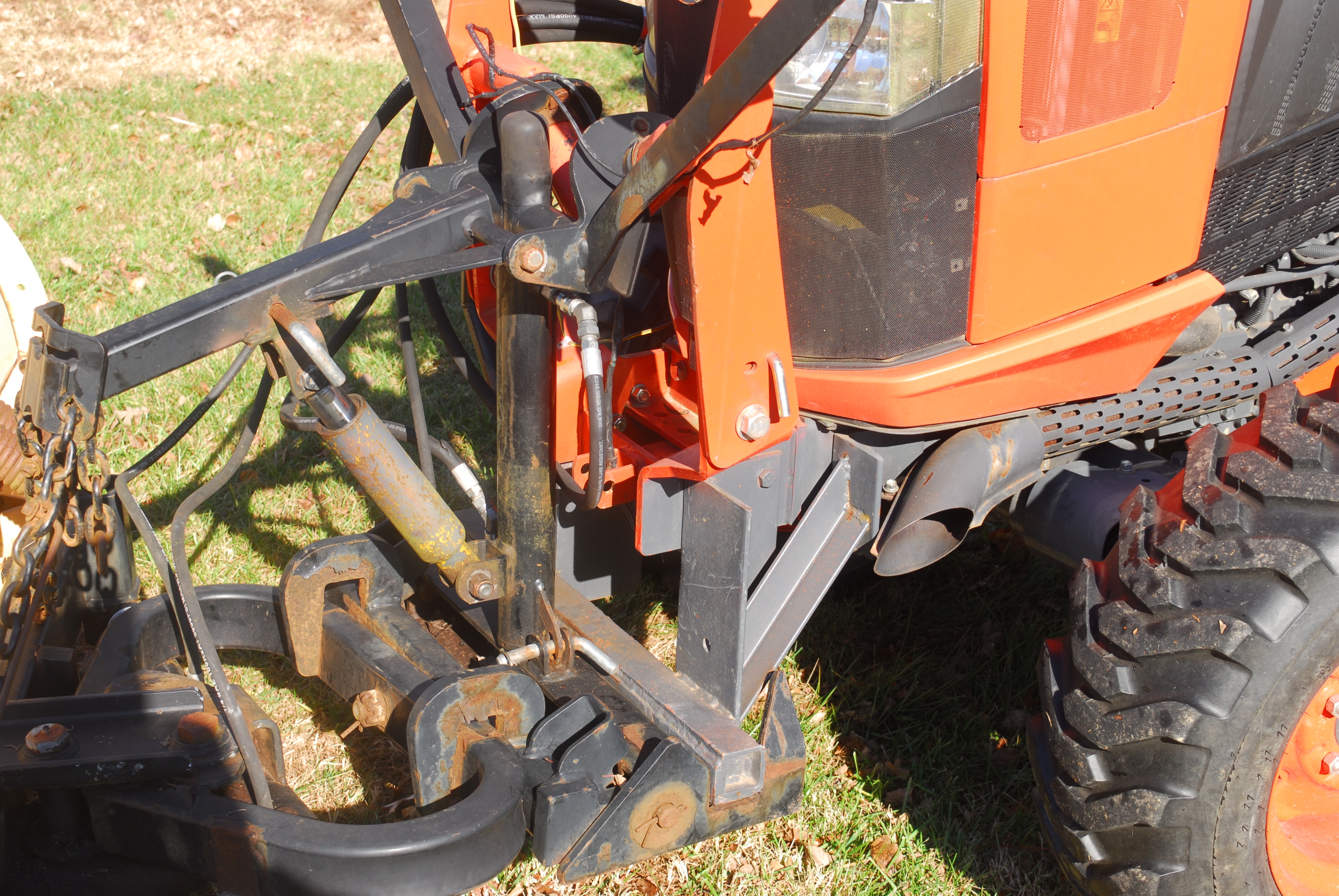

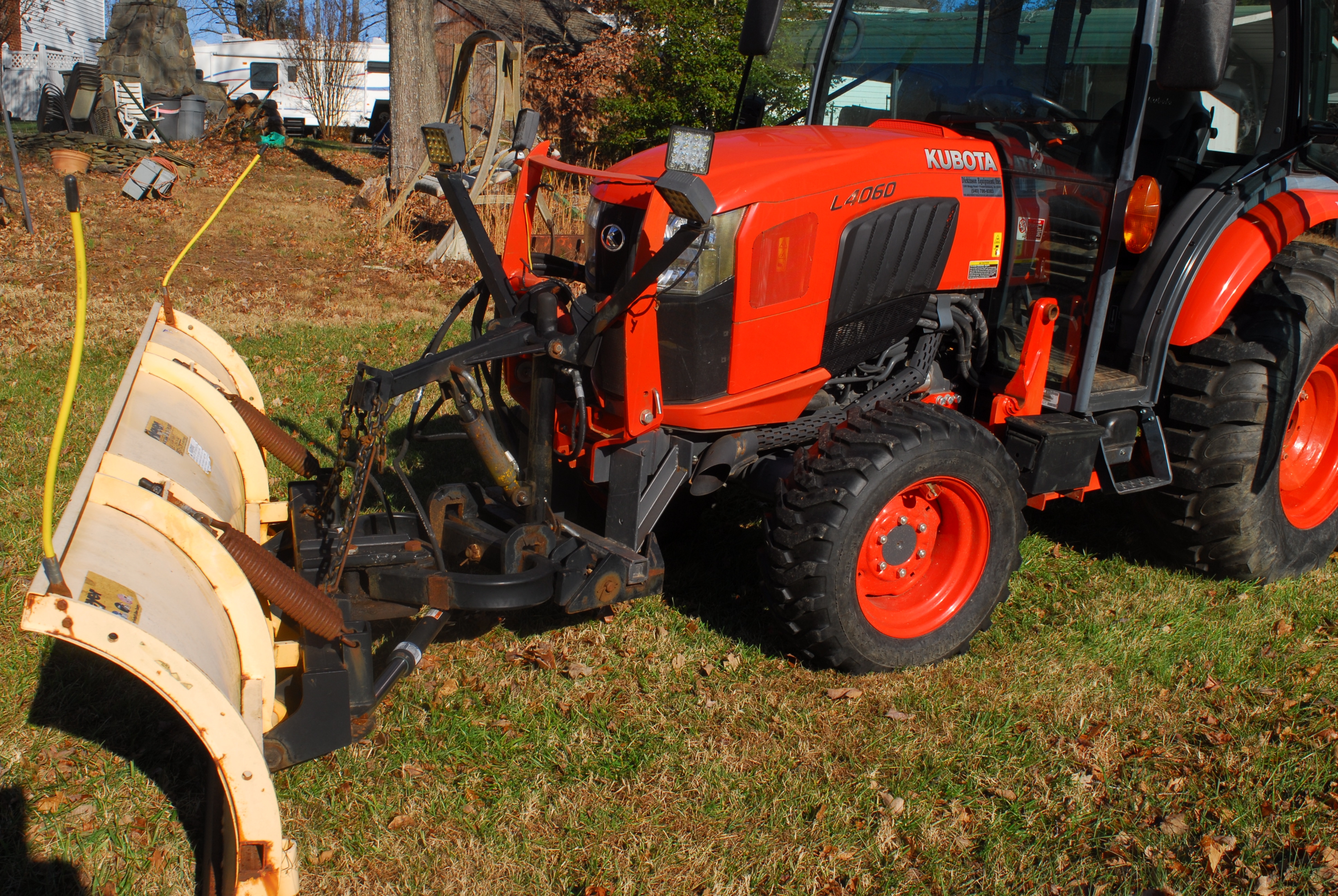

I have used both style mounts and I really prefer a direct mount on the tractor instead of a loader mount. As another responder said the long set up on a loader tends to push the tractor around.
I bought a used 9' blade in good condition for around $400.00 and made my own mount. I use the loader valve to control the lift and power angle.
