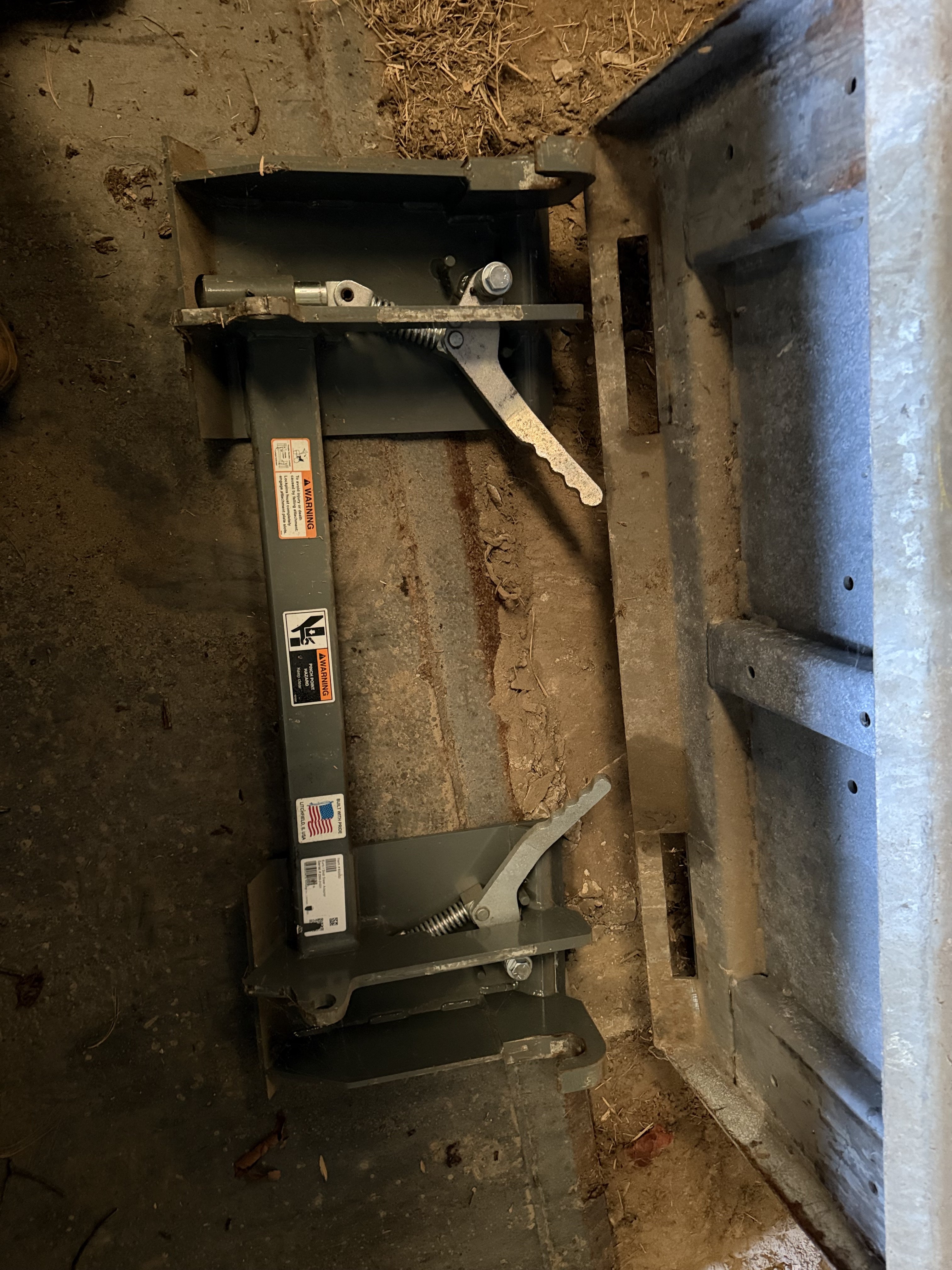

Here was mine. Converts Euro/Global to SSQA.

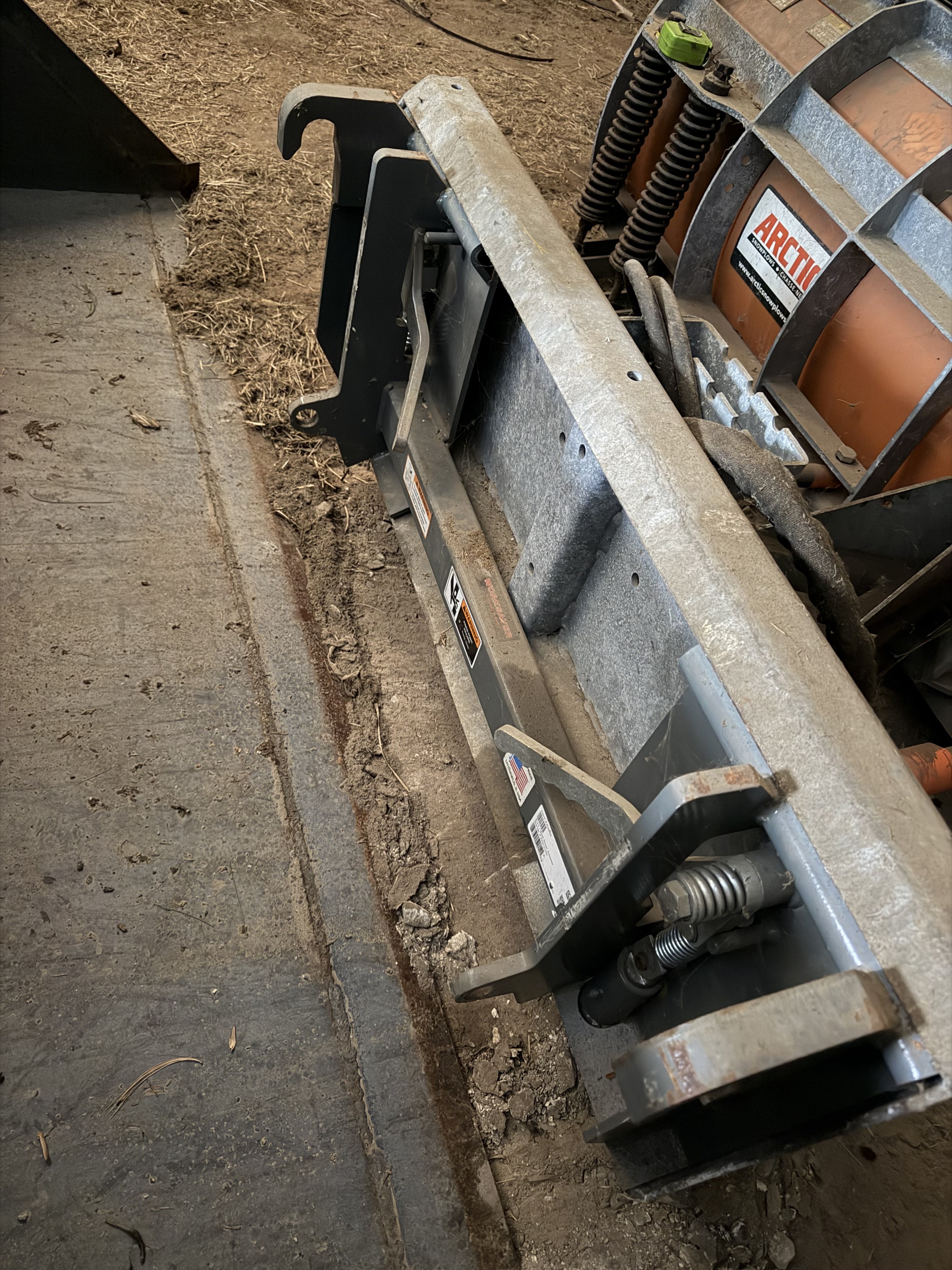

The last SSQA I had was my snowplow, I have sold that one.

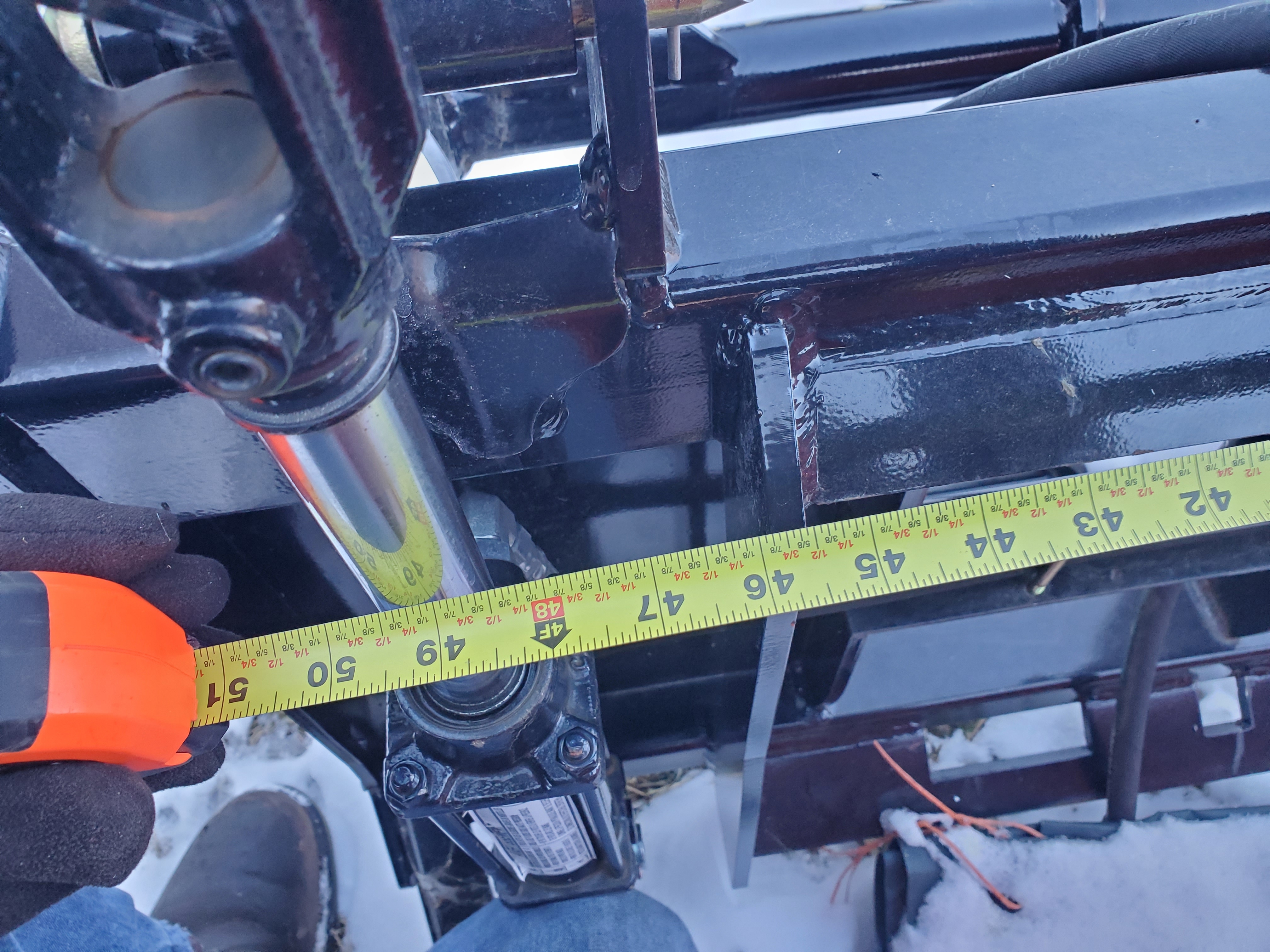

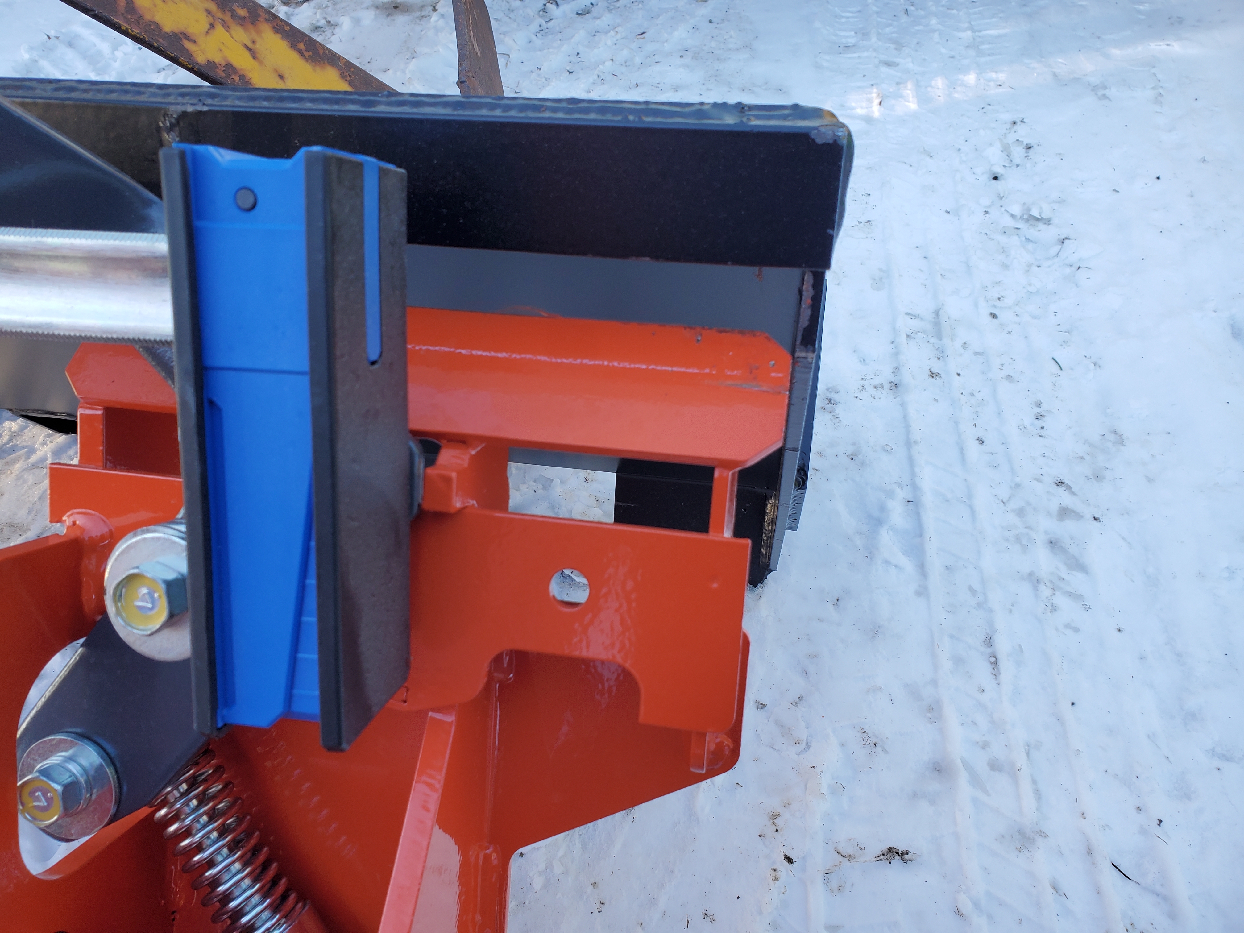

I was swapping front end equipment this afternoon so I did some measuring. Aside from being still pretty cold (temp in the teens) we had a nice day here.
First up is my fork set.
This measures about 45-1/8". This is a Land Pride fork set.

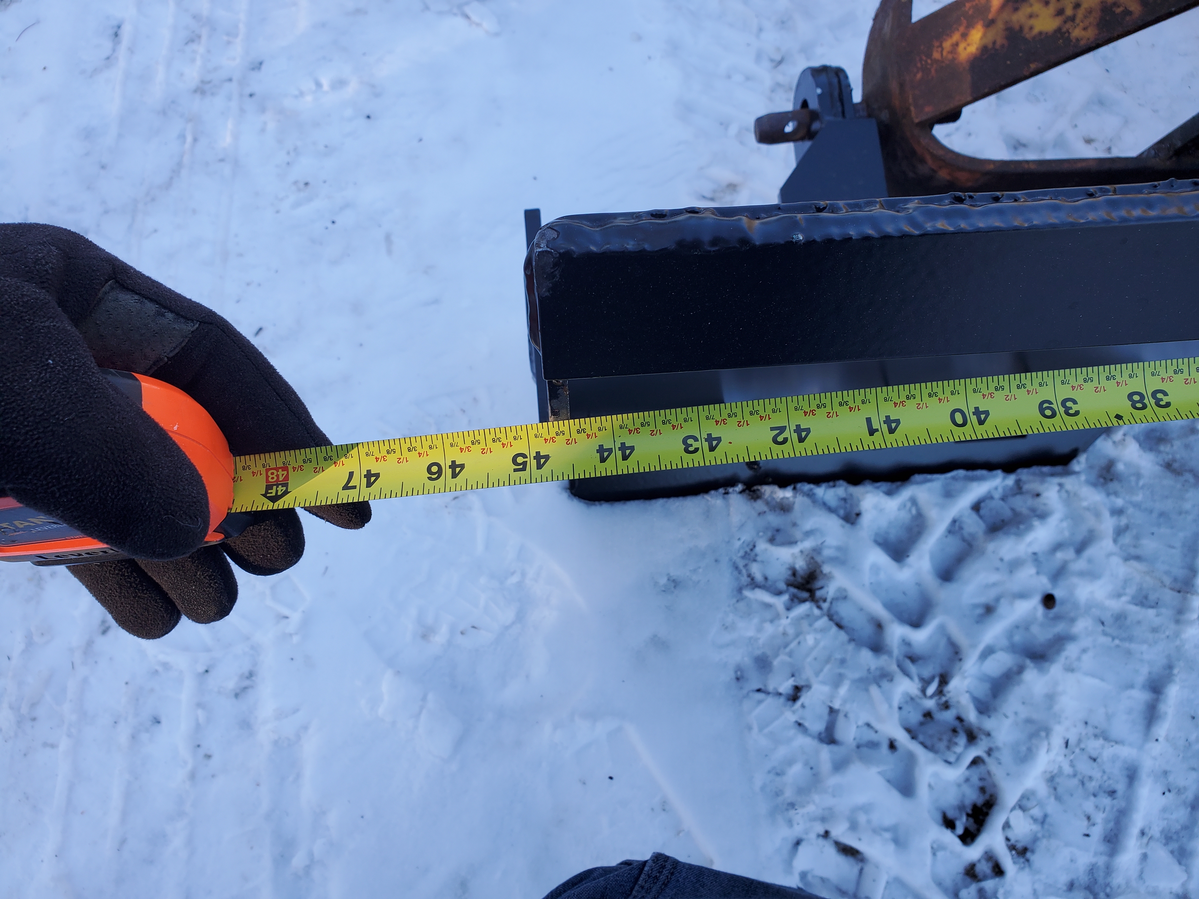

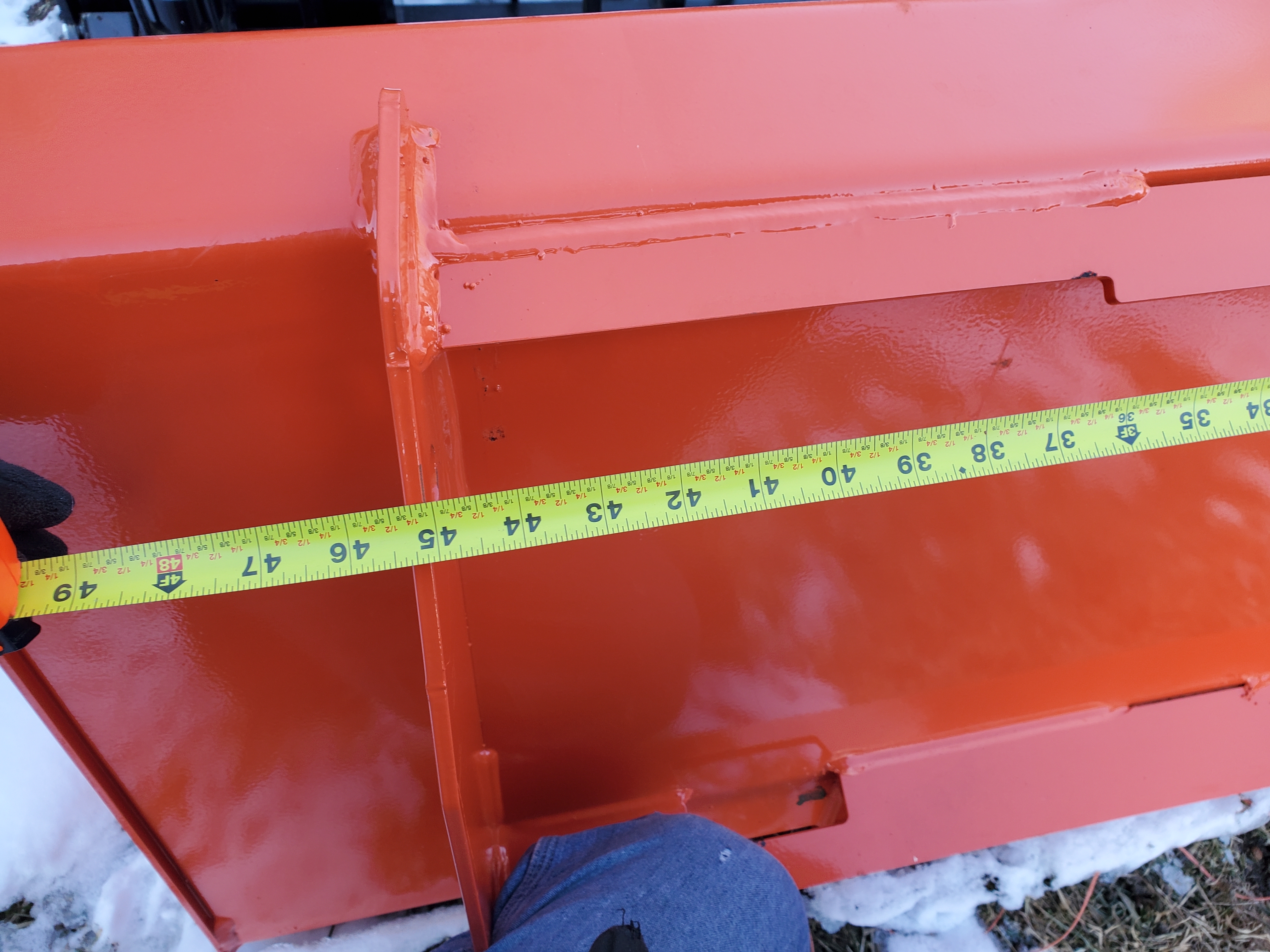

Next is the bucket.
This measures about 45-1/16".

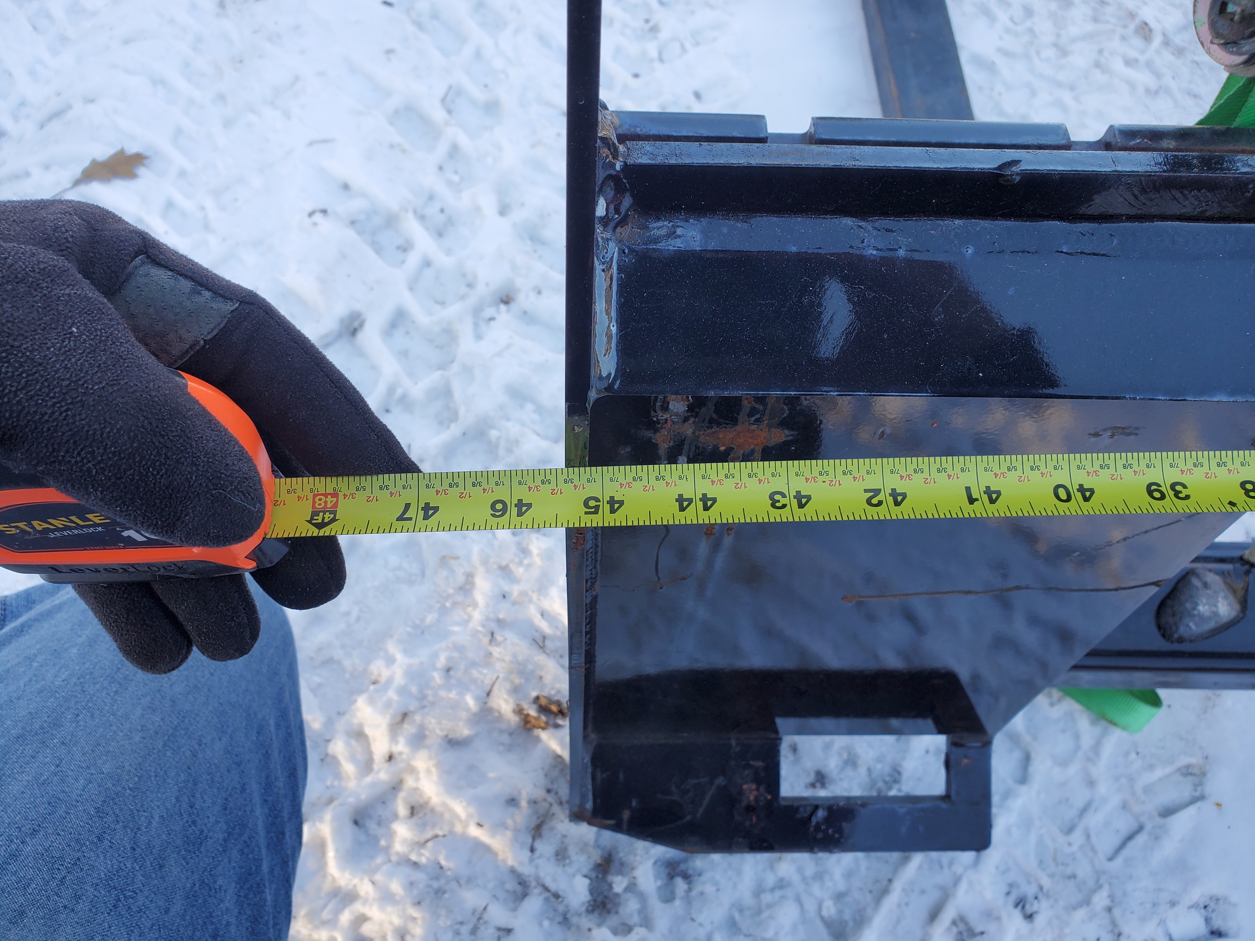

Next is the grapple. This one I had trouble getting the tape to cooperare for the measurement.
This comes out to about 45-1/2".

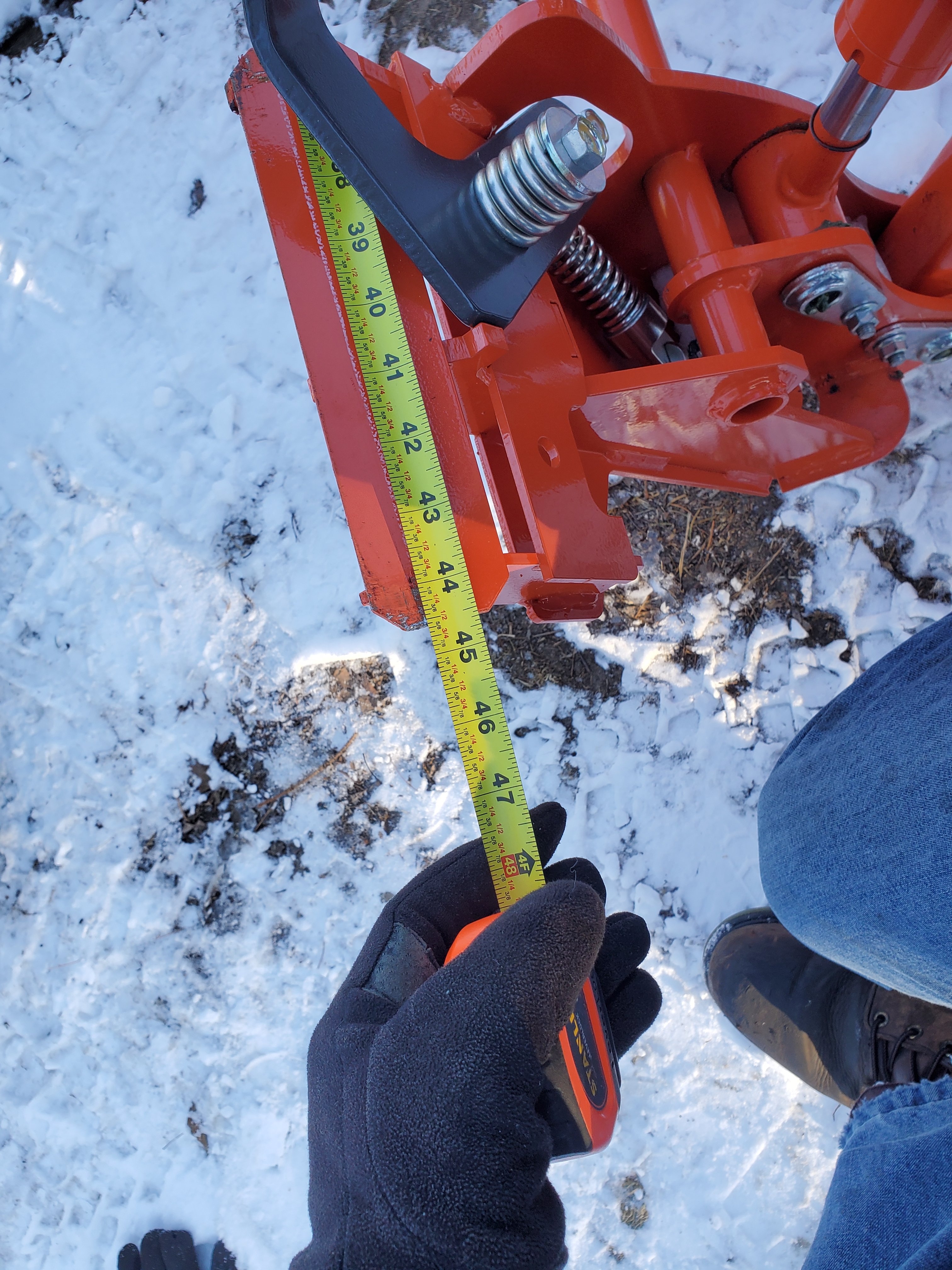

Next is the loader arms on the tractor that mate to the SSQA receivers on the implements.
This measures about 44-5/8". See more detail below regarding this number and the associated clearance.

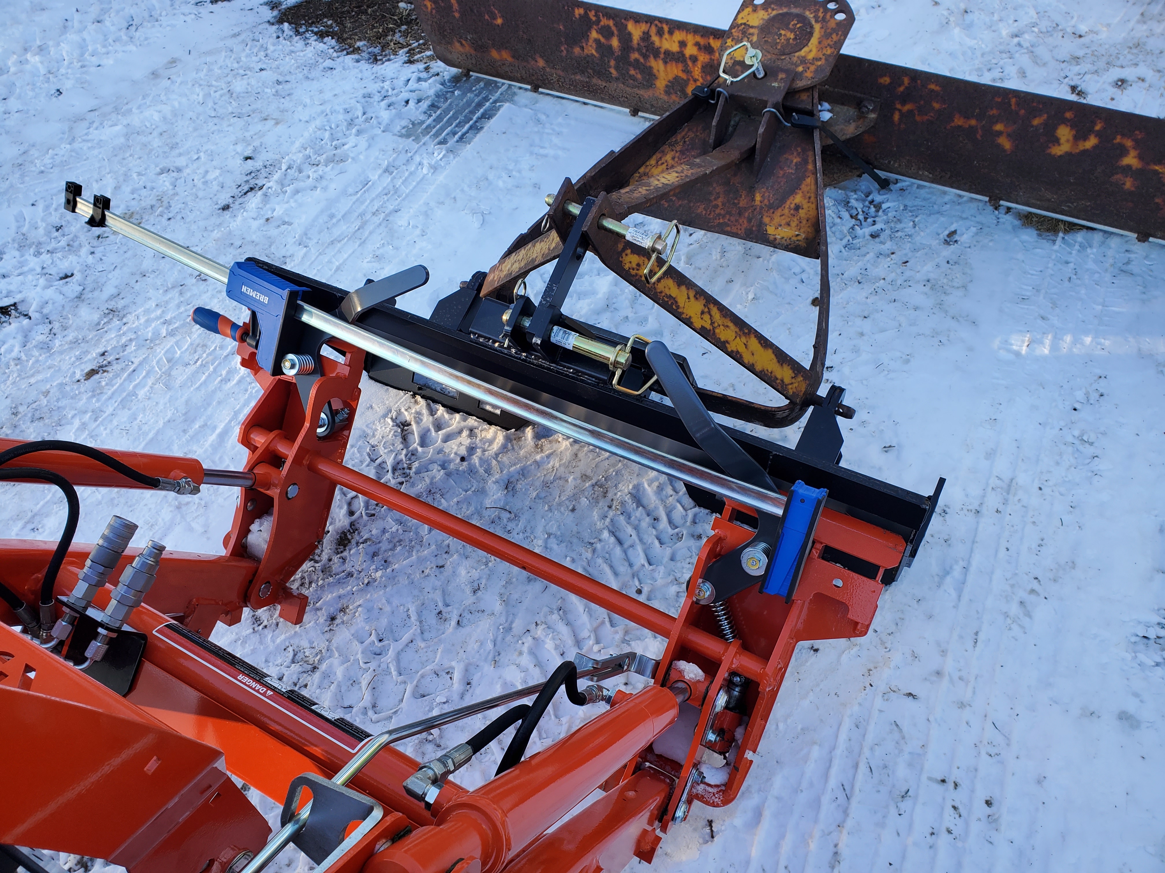

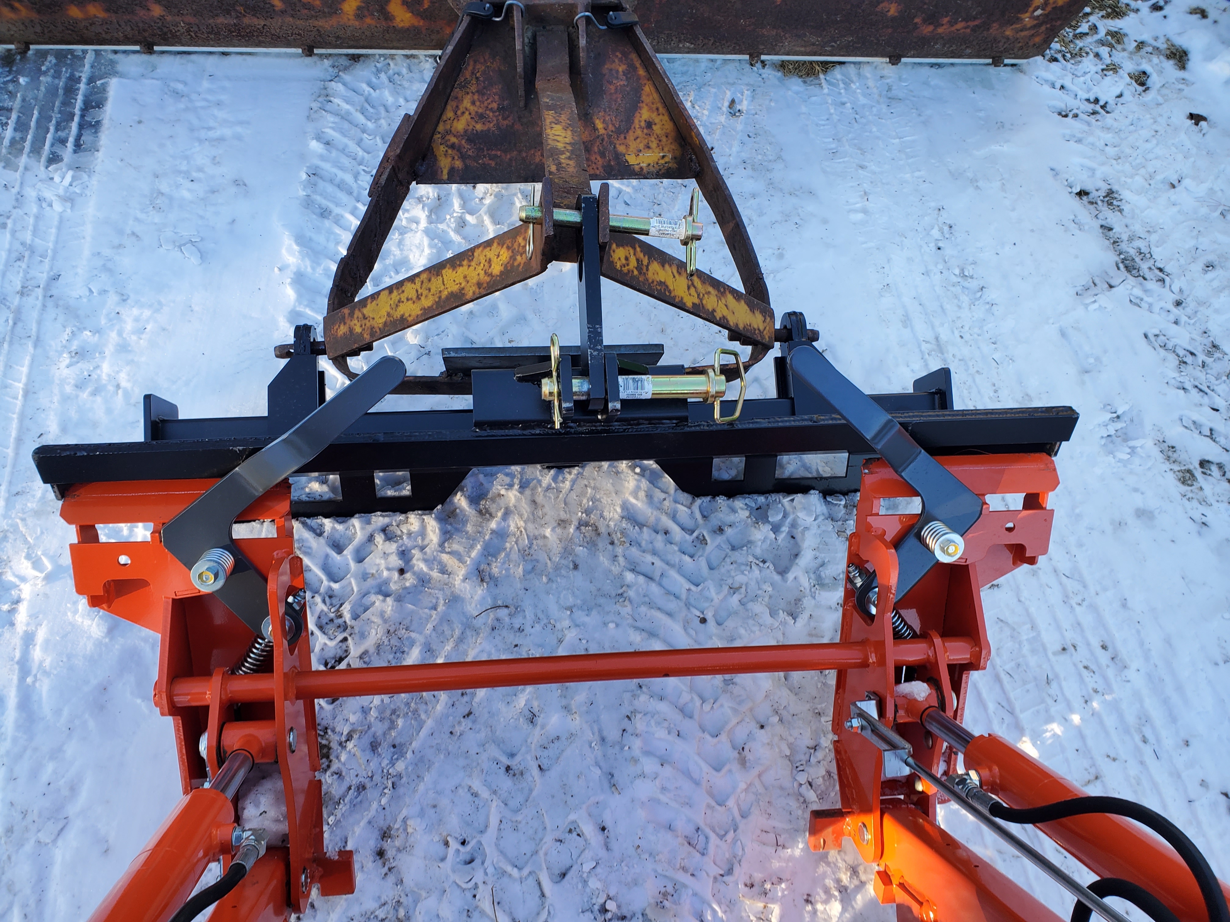

Next is the SSQA to 3pt adapter we have.
This measures right about 44-1/2".

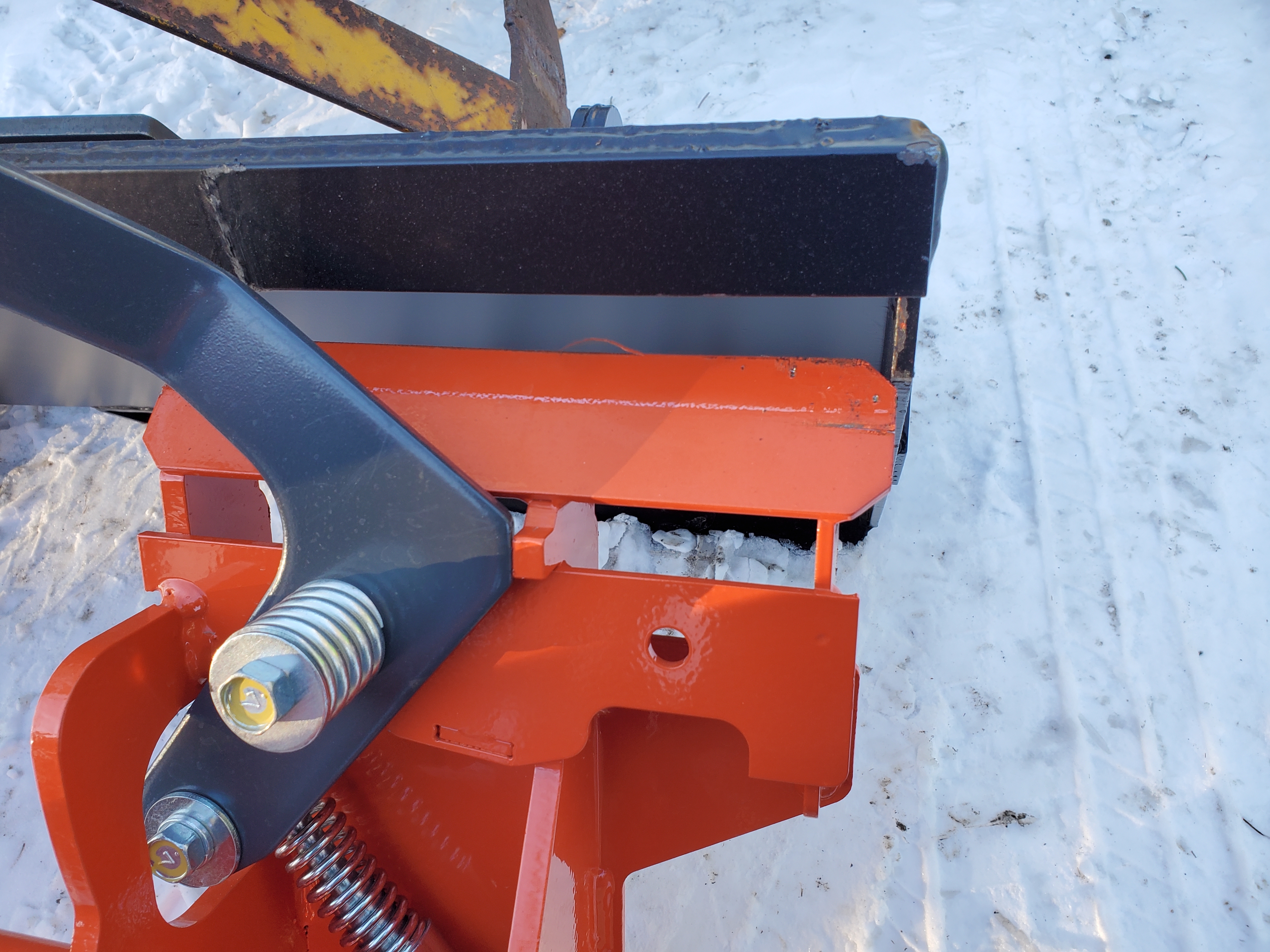

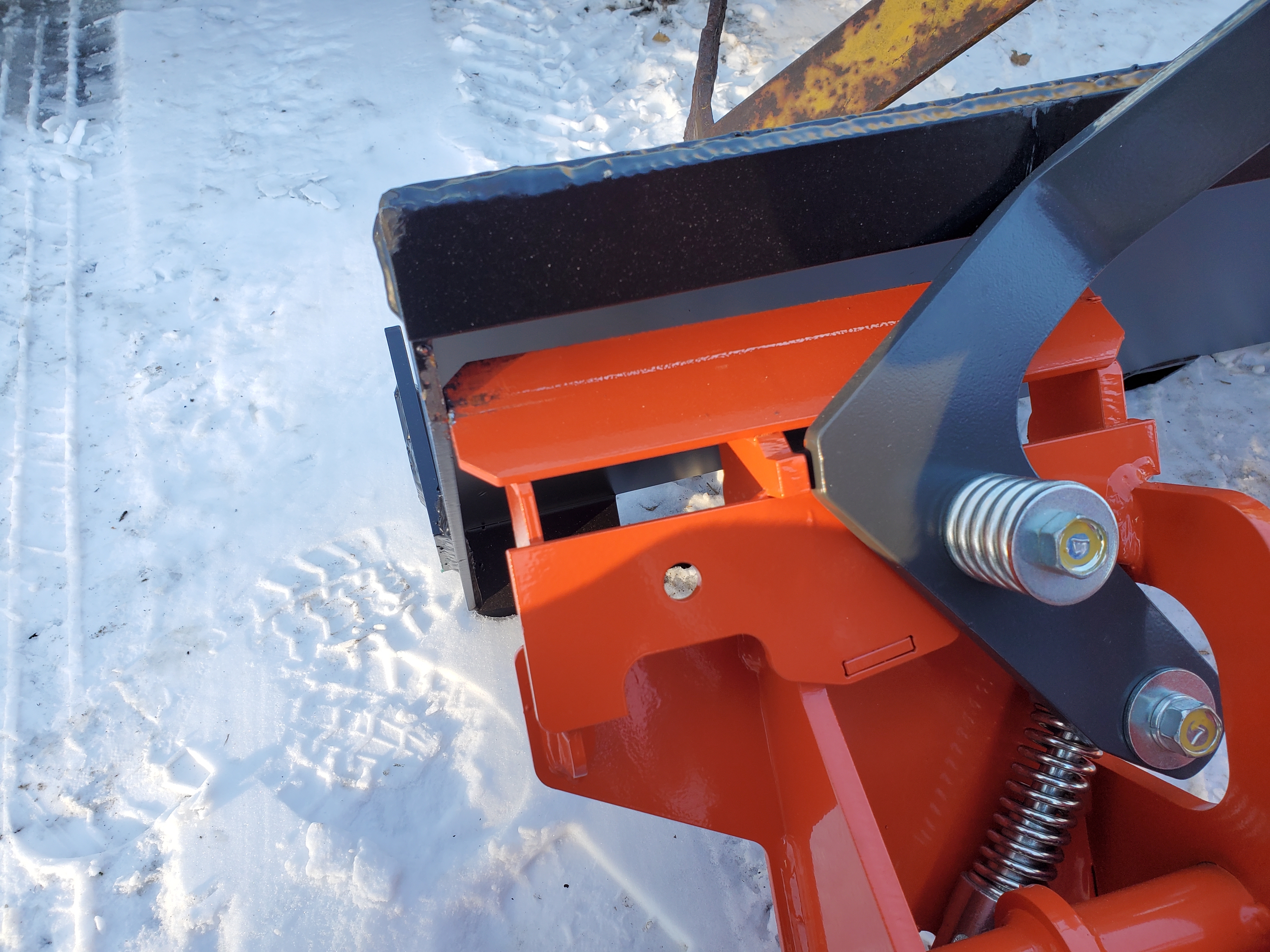

When I try to hook up to this adapter this is the result:
Left side -
Right side -
So for now what I do is squeeze the loader with a large bar clamp:
That gives me just enough "squeeze" to clear the adapter and connect:
Needless to say, the clamp method on the loader like this is a pain in the butt. But it works.
When the weather warms Ill cut the sides of the adapter pate and lay more metal over that to open up another 1/4" on each side (1/2" total).
My gut tells me much less than 3/8" clearance total would make mating the loader arms unnecessarily difficult.
I bought the same exact adapter from Ebay and have had no problems connecting it. I'm going to measure mine and compare, I measured the adapter plate today 44 3/8 but no problems. Very happy with the quality.

Yeah, not everything is to specs.
Seriously just grind a quarter inch off the edges and you're good to go. I had to do a similar thing to my brand new hyd bucket. It sucks doing it to a new item but it is what it is on farm equipment./
On my '21 LS Mt235 when connecting to my new el-cheapo forks it fits fine at the top but the plunger locks are just barely touching the edge of the holes and the brand spanking new LandPride (Kubota) 4in1 hyd bucket I bought I had to grind at least 1/4 inch from the bottom of the holes of the bottom lock pin plate as the plunger locks wouldn't fit. It's like the slots in the plate are too shallow on the bucket.

You can see the extra steel on the “ear” on the side of the SSQA plate. There’s plenty of steel that can be ground off without compromising anything.
The clamp he’s using is hilarious. We would have ground off the plate, or bought a properly fitting adapter after about the first minute of that nonsense.

I don't understand the OP's concerns about grinding a bit of useless steel away while apparently thinking that blade setup is OK. I don't see any trip mechanism and it appears the only "float" that can happen is with the weight of the loader frame on the blade.
/ SSQA - is there a standard/conventional width? #32
Likes been mentioned if you look at the edge of the loader plate you can see it's tapered so it has no weight bearing on it at all on the edge so there's no issue with grinding it down a 1/4 inch on each outer edge on each side. Imagine what's going to happen when it get's to 80+ degrees as the metal will expand that much further so you would have had to do it in the summer anyways if it was a tight fit in the winter.
I fully understand the OP and not wanting to grind and bang on a new expensive machine but he has to understand it also is not a car with nice fit and finish.
Once the loader is out of the jig, how many times has it been hit, dropped, banged, oops slightly hit it going in the crate, oops dropped it getting it out of the crate. So yeah things happen. Just use common sense and all is good.
