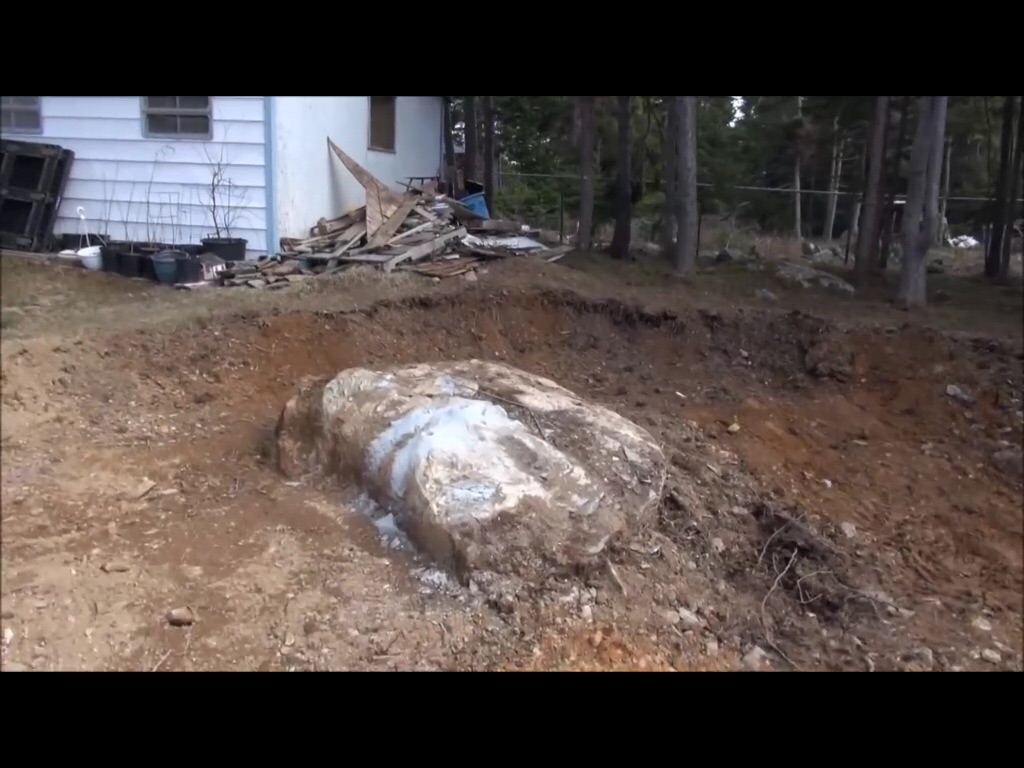

I used a product called Ecobust and it works. I did a two part video on it. Here's the link to part 1
http://youtu.be/JlTgjnglHng
Here's the product: https://www.lowes.ca/mortar/ecobust-expansive-rock-and-concrete-demolition-mortar_g1559554.html

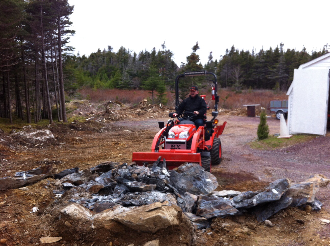

I was hoping you would chime in, Paul. Now I don't have to hunt down your video to post! I enjoyed it except for the drilling part... I recall you drilled a fair number of holes. Maybe the SDS system first would save some hard labor time?
/ splitting rock #31
I drilled 30 1.25" holes with the SDS Bosch hammer drill then poured the Ecobust in. Let it set for 24 hours and you could here it splitting the whole time. After I got the BX and cleaned up the pieces but the rock was still a little above grade so I did it again and the battle was won.

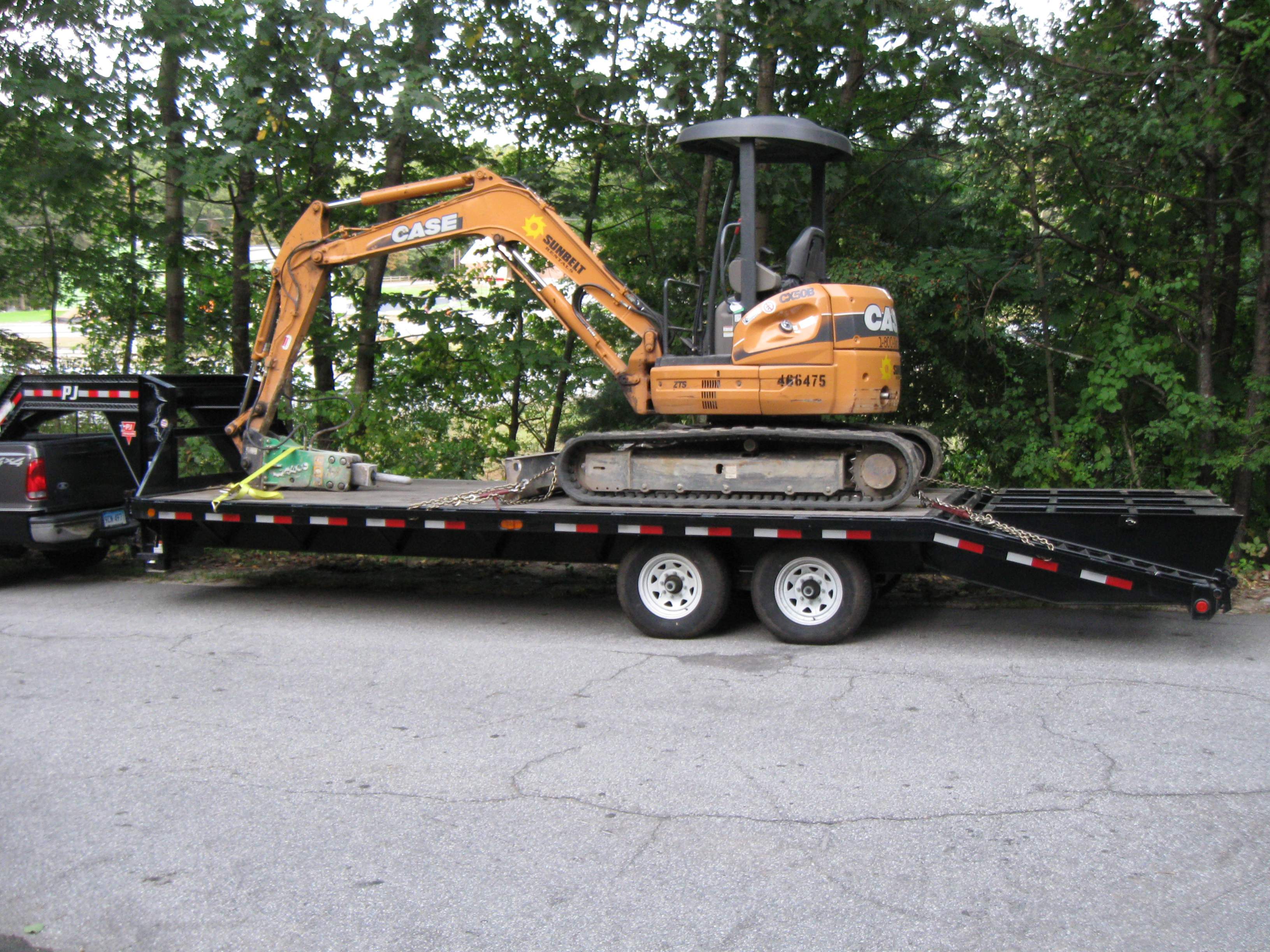

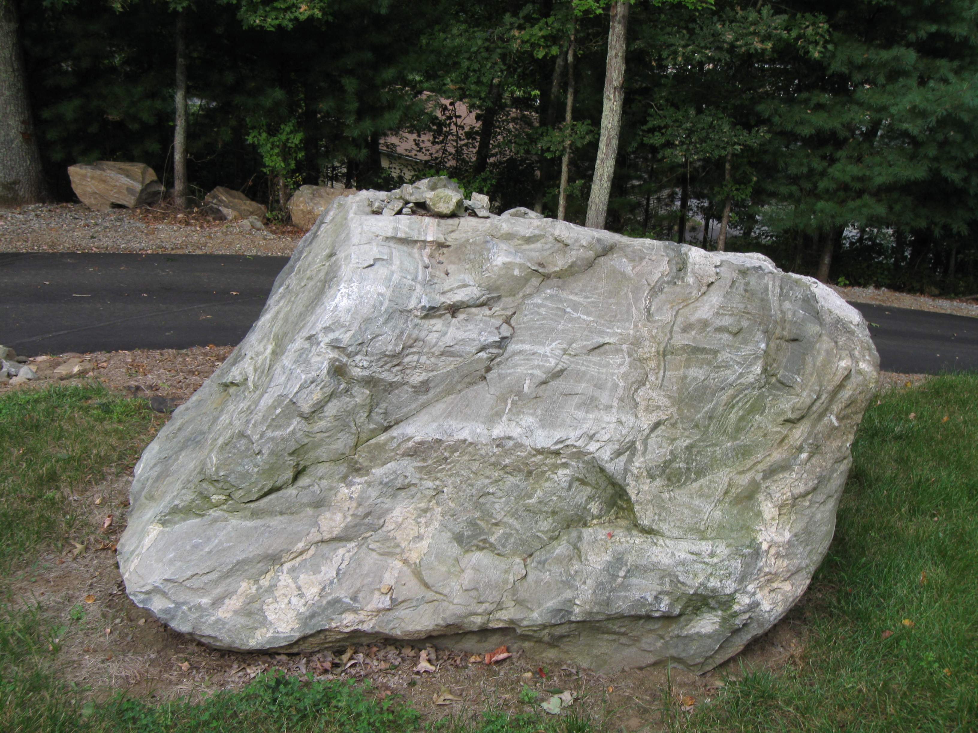

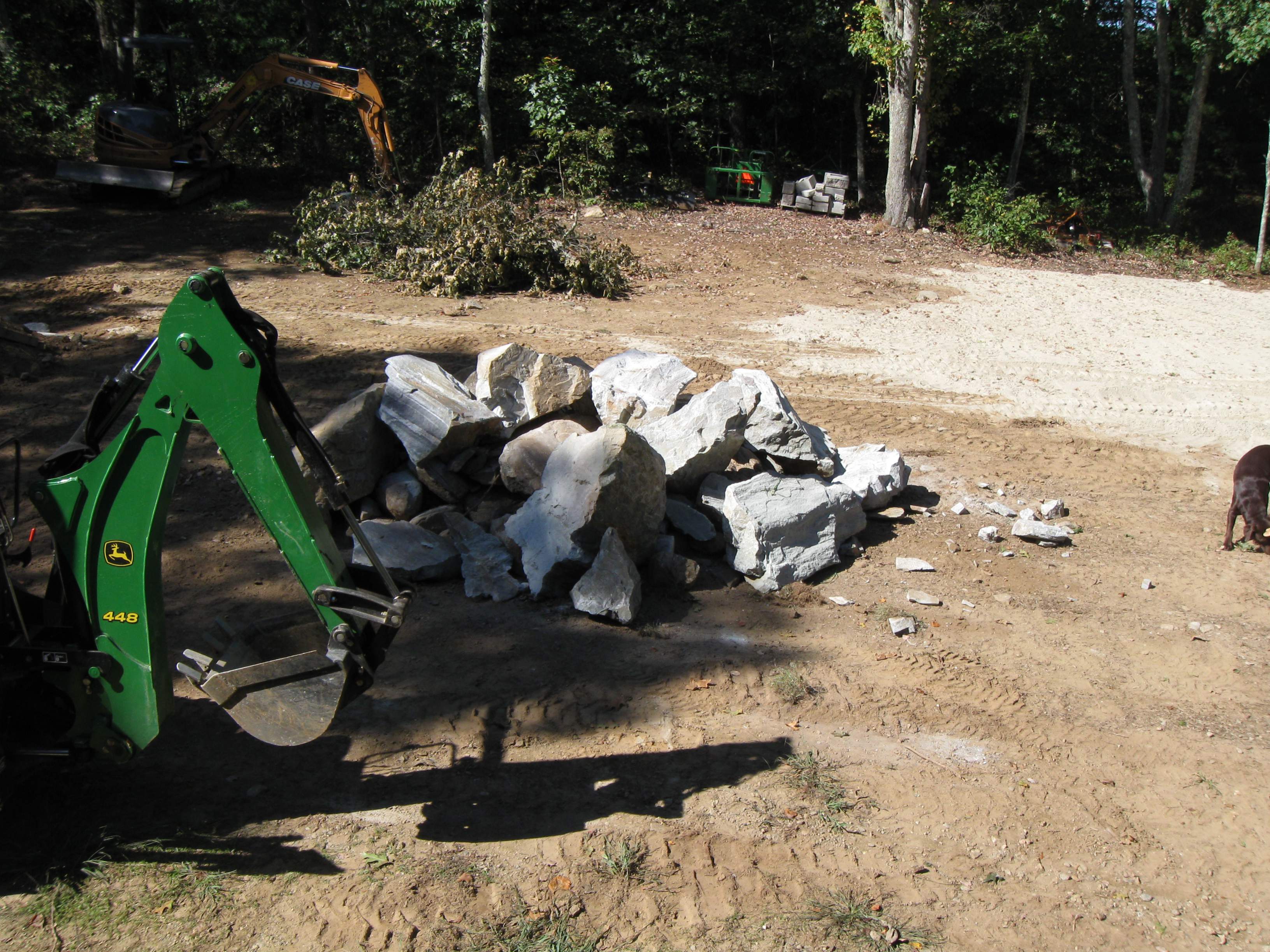

Can you post pics of the rocks in question? I had some compact car size granite rocks in my property. I was doing the drilling and feathering thing but it was a slow process. I ended up renting a 5 ton mini ex with hammer for around $700. The rock was smashed to pieces in about 20 min. I was shocked how well it worked out.
/ splitting rock
#36
MattView attachment 441746View attachment 441747View attachment 441748
Some pictures to come later. I have several large rocks different sizes from bigger to smaller of what you have. That EX can do some damage. Wow, I may have to spring for that route, the HF sds isn't bad at drilling but if I want to get rid of all these it is gonna take a kot of time.
