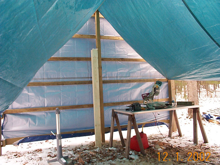

Hi Danny - I'm starting to get the same impression. Does the idea of stacking and tarping those trusses for the Winter bum you out, Spence? Take a look at MY progress if it does. That's fourteen yards of gravel and four bent metal stakes pounded in a 20' square. Of course, that's not the plan anymore, but it still indicates my progress.
Someone mentioned Ondura. I have seen several barns, shops and garages around here that use a fiberglass/synthetic roofing, and some include transluscent panels in strips for added light. I even saw one with the whole roof done in transluscent panels and it was really bright inside! Maybe too hot in the Summer, even. If those trees around your site provide Summer shade, and if that synthetic panel type stuff is a good choice (UV resistance? Impact strength?), I really think having natural light inside is a great idea. The first thing I have noticed in visiting modern, mostly windowless barns, is that they are as dark as a barn. /w3tcompact/icons/grin.gif
I liked the Ondura site, too. Does it make you feel better that several of your TBN buds are talking about not doing the roof? Do you feel empowered to wait? /w3tcompact/icons/grin.gif/w3tcompact/icons/grin.gif

Oops! That was pre gravel. Guess I'd better check my photos more carefully. Anyway, I have been encouraged by your pace, Spence - by your apparent patience. I've been downright intimidated by some of these palaces I've seen guys put up, too. So you've been a leavening agent, a reality check for me in your project. I am glad to hear you have a balanced approach to family & stuff. Maybe this isn't what you want to hear, but maybe you should more seriously consider waiting until Spring. I'd scope out that Ondura site, too. I know I'm going to do so. The idea of natural lighting is really appealing.
As we all say, just my 2 cents.
