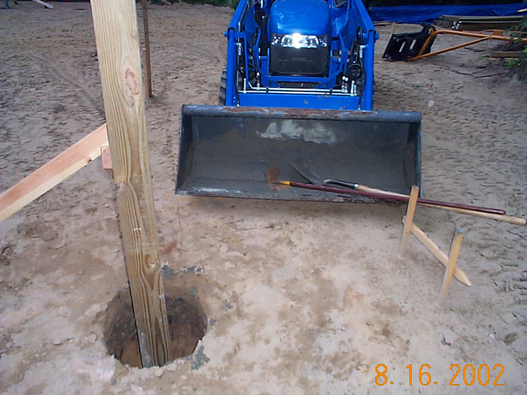

Mosey, I had the fill sand delivered 14 tons per dumptruck load and usually 3 loads at a time. I just had him put it in different piles around the building site. To start spreading it out from the piles I used my rear blade but I used it on my loader thanks to my Kasco Switch-Hitch. The attached photo shows me using the same setup to spread out some crushed concrete on my driveway. It was incredible the amount of reach I had with the blade on front. I could raise it up and grab sand from the top of the pile and drag it backwards. It would have taken me forever to pick up bucket fulls and spread it around that way. I talked about the setup in <A target="_blank" HREF=http://www.tractorbynet.com/cgi-bin/compact/showflat.pl?Cat=&Board=projects&Number=153770&page=&view=&sb=&o=&vc=1>this</A> thread. After I got the sand roughly spread out with the blade on the front I put the bucket back on and mounted the blade back on the rear of the tractor. It took quite a while to finish it up but it got faster with more practice. I would spread it all out, then compact it with my lawn roller. Then I sprinkled it for hours and then compacted it again before I had the next loads of fill brought in.

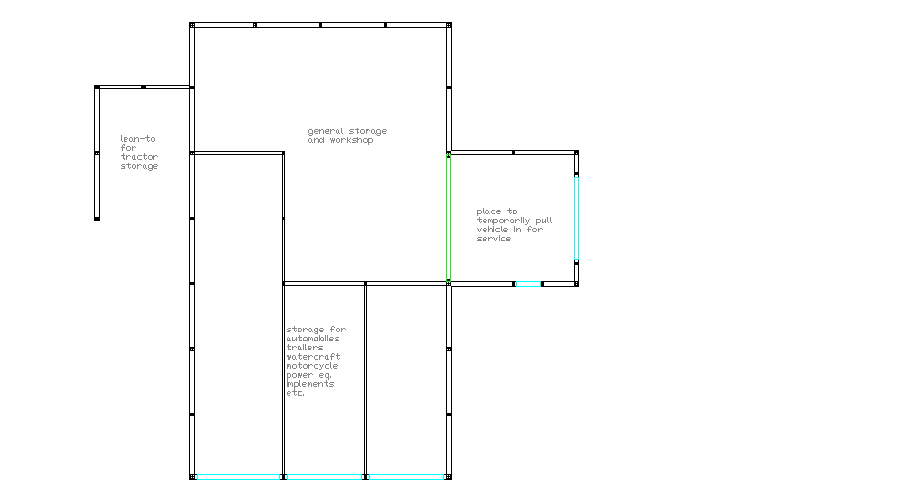

Here is the top view of the pole barn. The only thing that has changed is the lean-to dimensions. I originally thought I could only make it 16' long due to some trees. I am happy to say that it is a full 24' long with plenty of room to get in and out of it with the tractor.

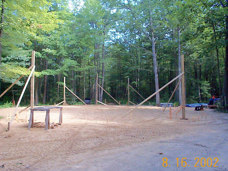

Moving ahead I have 10 or 11 poles up in this picture. There is actually 11 poles but 10 holes. I am setting a shorter 4" by 6" right next to a taller 6" by 6". I am doing this on either side of the 16' by 16' opening for the shop. Because of the 16' span I will have a glulam beam across the span for the trusses in that section. The glulam beam will sit on the 4" by 6"s and it will be sandwiched between two 16 ' 2" by 12"s which will attach to the taller 6" by 6"s.

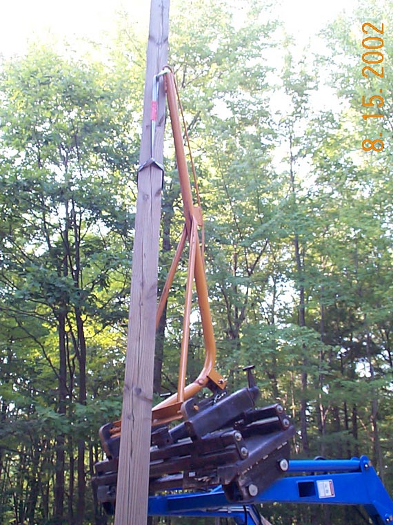

Just when I started making some real progress mother nature steps in. I was just getting ready to put up the first of the 16 foot 2" by 12" truss carriers when it started to snow. Luckily the lift that I had made for my loader worked perfectly to lift these monsters up to the proper height. I talked about the lift in <A target="_blank" HREF=http://www.tractorbynet.com/cgi-bin/compact/showflat.pl?Cat=&Board=buildit&Number=212009&page=0&view=collapsed&sb=5&o=0&fpart=>this</A> thread.
